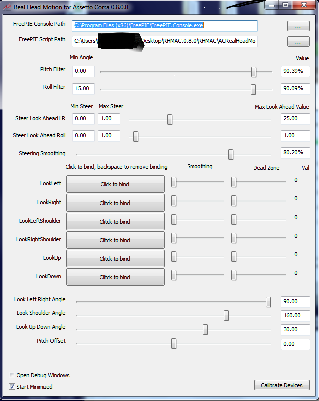

    Well I'm happy to report that the new plugin has made all the difference.....I've probably spent 30-40 hrs trying to get it to work all because last week I downloaded a program called " Real Head Motion" and it's changed AC for me. So I guess it's been awhile since I fired up this game with my rig.

    Curious how Real Head motion "changed" AC for you, In a good way or bad way ?

    The game was basically unplayable for me before I installed RHM. The 2 options that AC gives you "Locked to the horizon and not locked, were just too limited of a choice. The camera in the locked position didn't move with the cars pitch when going up and down hills and in the unlocked position the car stays still and the world bounces/moves instead. But with RHM I can put AC in the unlocked camera option and make the car move to the bumps and react to the enviroment instead of the other way around. Maybe the unlocked camera doesn't bother a lot of people but it would make me ill feeling in just minutes.

    Interesting Hobbs, I played with rhm a little back when it was first released and did a few of the updates, but it was in its infancy and lacked a few thing's imo. I see its come quite a long way in the month's and might be worth taking a look at again, Does it still require the pie program or w/e ? and is the "pitch" setting still not available in the in car view setup app ? That was rather annoying to be honest.

    I just messed around with it until I was happy with the results...... I included my settings . Yes I needed to run FreePie with it. I made a startup short cut of RHM and place it on my desktop next to my AC startup for convenience and as a reminder to start it first.
