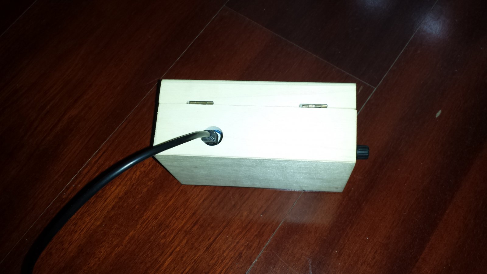

    WIP

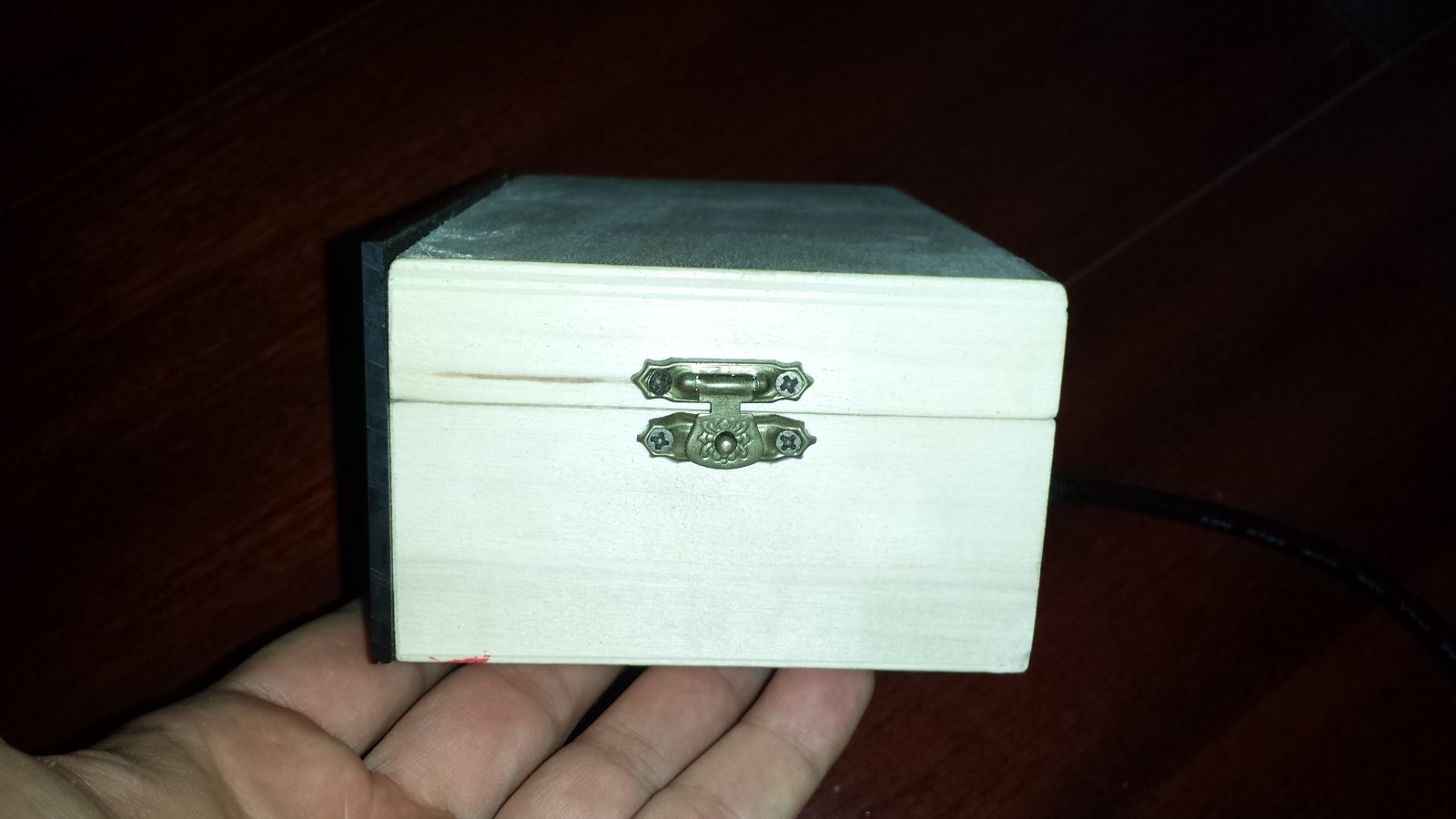

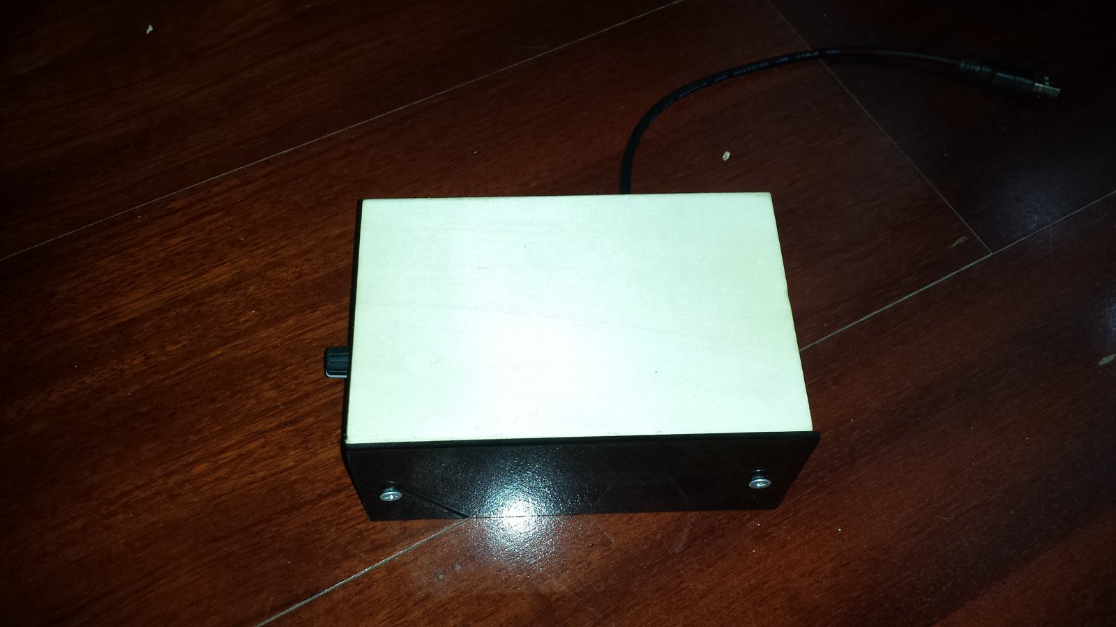

    Last year i decided to get back again into SimRacing, and one of the things i decided to go for was a dashboard.
    After looking into comercial ones, i found that at the price they were asking i could go for the arduino way and save some money.
    After some time researching, instead of going the way people usually go (TM1638) i went for a more modular approach.

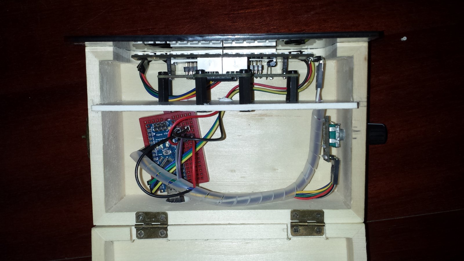

    Part list:
    (Electronics)
    Arduino Uno (official, bought for testing and for the case of the nano not coming with bootloader)
    Arduino Nano (cheap ones, not official)
    2 digit 7 segment module
    8 digit 7 segment module
    2 x neopixel sticks (8 RGB LEDs each)
    1 x rotary encoder module
    (Other)
    Wooden Box
    Tinted Acrylic
    Screws

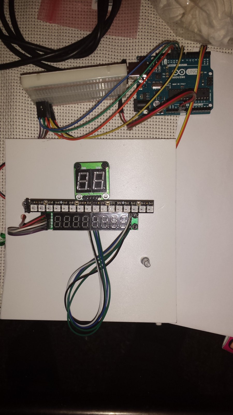

    Both the 2 digit and the 8 digit module are connected together, since they are MAX7219 they can become 1 by connecting each other.
    The neopixel sticks are alone on that matter as is the knob module.

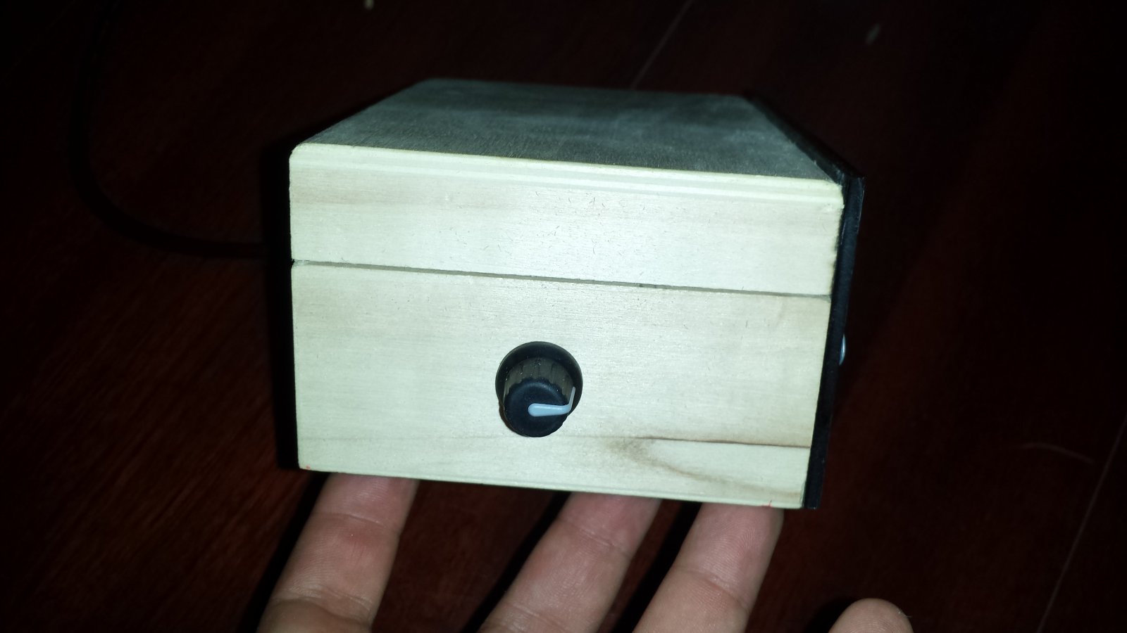

    First started testing arduino so i could see how it worked, and then envolved to make it show data from rfactor.
    Even after i get it to work more like i wanted, tried some different directions, mainly with python (not done yet with it) as i wanted to show some optional data (trying to make real-time delta show up,have some breaktroughts on it already)
    After i got it +/- working went ahead and made it fit into the wooden box, first without the acrylic, but now with it. All its left on the aspect of the dashboard is black matte paint, inside and outside :)

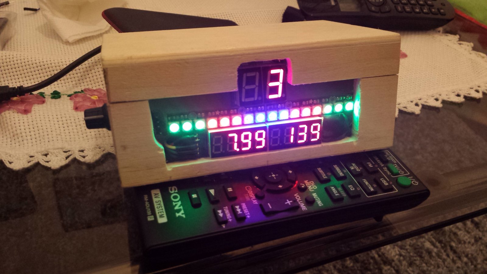

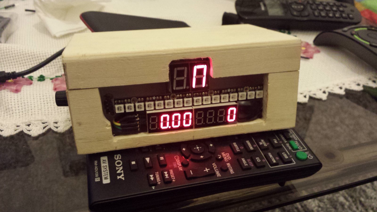

    Right now its working like this:
    - 1 digit of the 2 digit module for the gears;
    - 8 digit module, half for the RPM (ex: instead of 10000 rpm it shows 10.00, so i can fit it in 4 digits), the other half for speed;
    - Neopixel sticks are for the shift lights, atm they are with a fixed color but i plan on doing some coding to make it configurable on the go, with the knob module;
    - The knob module as i said above, will help on user configuration (will have a menu for it) but also on changing dashboard data, for example, one with RPM and speed, other with oil and water temp, etc etc
    One of the digits from the 2 digit module will eventually have some info, will test more things on that later.
    ATM im using a software made by a member of another comunity.
    Have it fully working with rFactor, still not with everything i want, there are alot of ideas on my head for it but firstly would need some other software to trasmit data to the arduino, and thats where SimTools comes in with the many plugins availabe. That way i can have it working on evey title i play, and will eventually play.
    I didnt have any enough coins to buy them, but since now i have will start soon working on making the dashboard usable with GameDash.
    Will leave you with some pictures and a video showing the dashboard working. Will add more when i do some more progress. Enjoy!
    PS: This is one of my DIY, have modded the G27 wheel as well as you migh see on the video, but will leave it for other thread, as its a seperated thing

    Ok, fixed the weird data, turns out i need some variable to tell the rotines when there is new data so they only process data that is retreive from the serial. Tought it wouldnt be needed but having that it fixed the weird data...Now the only thing left is the beep sound, over and over again until i close the game. Any help?

    Somehow, after a while it was fixed.
    Been busy as i have a race this week, will get to the coding after the race.
    I have been able to get the data to be sent correctly to the arduino, had a couple of issues but will get to that later. The thing that is annoying me atm is that the Speed variable showed in the GameDash window flickers when the car is stopped, wich makes it show on the display that the car is at x speed when it is stopped, its weird and i dont know what the problem might be.
    Another thing is the speed variable is an integer, so the speed in KPH on the arduino increments as the ms (meters per second) increments, i get 3kph, 7kph, 11kph etc. Its not flowing correctly. I would want it to increment correctly, but for that the speed variable within the GameDash would need to be a float type perhaps?
    Anyway suggestions, opinions, advice are welcome ;)

    Heard the beep too and if i remember right it was beeping when i had wrong interface settings or wrong settings in game dash - command editor (output rules).
    Seen the floating values in rFactor too with @soraz dashboard code. if you watch the game dash when the car is stopped you will see the floating values there too.
    i think the floating values and the arduino increments are from the game or the plugin nothing to do with arduino code.
    BTW really like your dashboard
