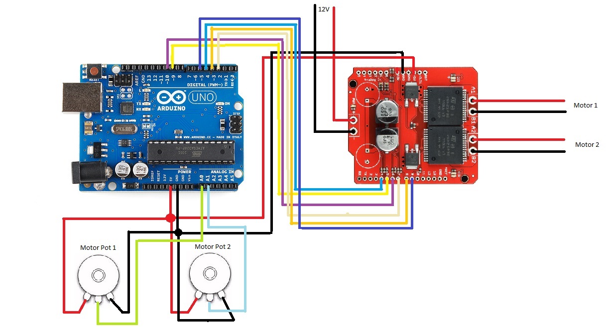

    Just wondering if: I will be using the Arduino UNO R3 along with the Monster Moto motor shield for my project. (like this one) Question is will I need to write a code/sketch for the IDE if I am using a Game Plugin module?
    Thanks in advance,
    Terry

    Let me make sure you and I mean the same thing first; with IDE you mean the Arduino upload utility correct? If so than yes you will need a sketch for the Arduino. You are in luck, there are several here to choose from. I have used three with great results, they were submitted by RacingMat, Prilad and RufusDufus. I am currently using the sketch by RufusDufus as his will control 3 axis and has a windows utility for tuning the motors.
    http://www.xsimulator.net/community...3dof-motor-driver-and-windows-utilities.4957/
    EDIT: By the way, I am using the same electronic hardware that you listed.

    Sorry about that, I should explain just what I did to make it work. (after both zip files have been installed)
    1. connect Arduino board to computer via USB cable.
    2. Open the Arduino IDE on your computer and check your board type and port #.
    3. Run the "BLINK" program to make sure that the board is working with the port.
    4. Open the SMC3 sketch in the IDE, verify and upload.
    5. Open the SMCutils program screen.
    That's it, was able to make changes to whatever.
    Thanks again for your help, I am sure that I will have more problems.
    Terry W
