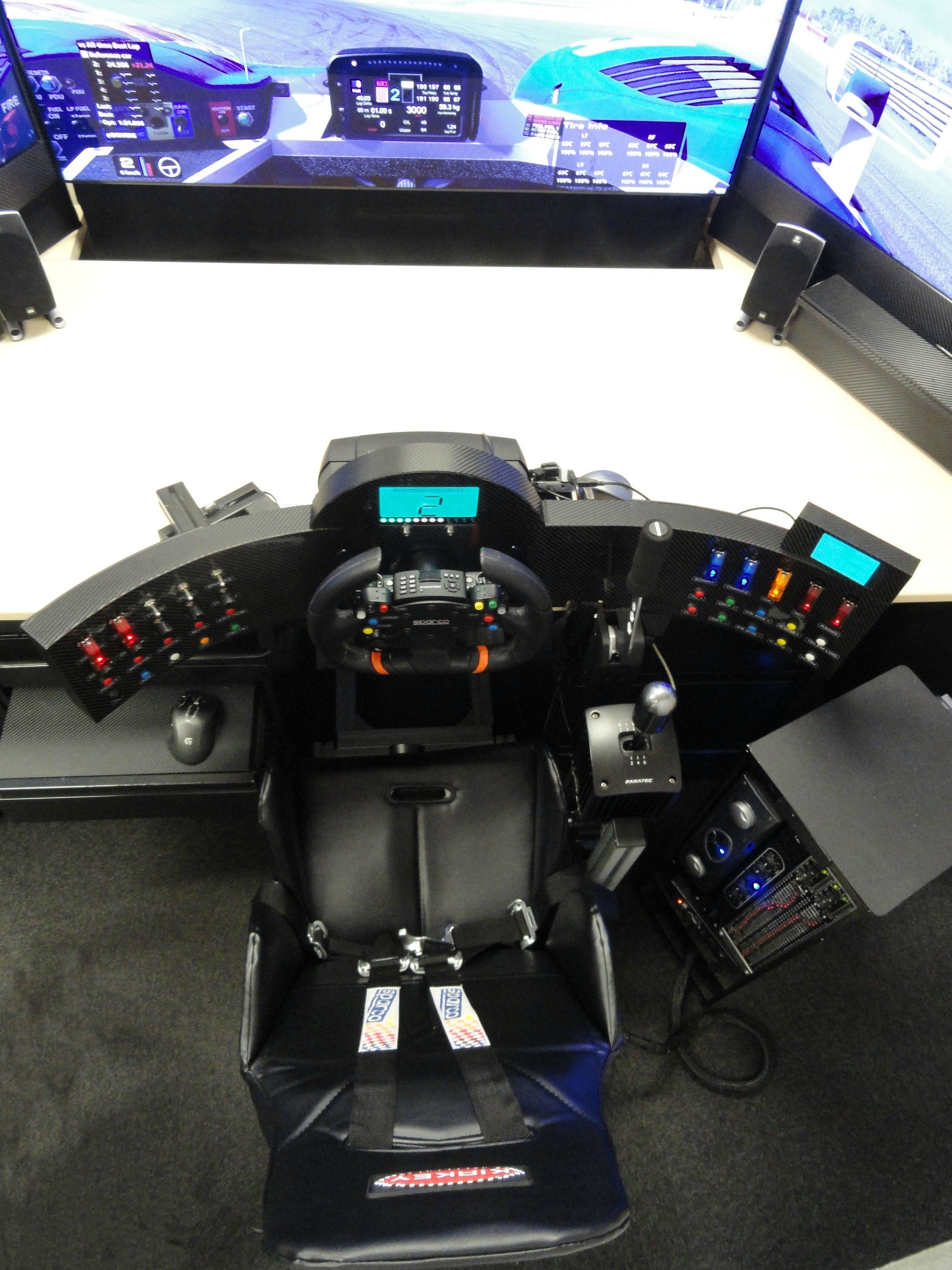

    I saw the CXC Bathurst training video and immediately noticed how simular the angle of the acculators is compared to what i'm planning to build
    I analised the two "how its made video's" from CXC simulatons and made some screenshots from the intresting parts
    Picture 1
    photo storage
    As you can see they are definately using SCN6 acculators. I can't seem to find out how the bottom bar is mounted to the acculator housing. Are they using a damper or is it just a rod connected with a rubber isolator?
    photo upload
    They are only using a small universal joint as pivot.
    image hosting free no registration
    How they mounted the acculator to the seat. Is the acculator only mounted with those four bolts on top?
    gifs upload
    Here you can see that they are also running with a very small angle.
    image uploading site
    Here you can see that they are using a stabiliser. Is this needed. Are the acculators fixed or loose when powered off.
    image hosting without registration
    I'm probably gonna try to re-create the CXC solution and build my own bracket for the SCN6.
    I have a few questions though:
    -Does anybody have an idea wether they are using dampers or just a vibration damper?
    -Are the SCN6 acculators fixed or loose when power off?
    Thx
    Henk

    Yeah, I would say your build would be very similar.
    It does look like they are using SCN6 (from photo the SCN6's have a black lower half of the actuator and the SCN5's don't)
    I think the extra stabilizer is to stop twist because the outwards angle of their actuators isn't that much. I have my arms at 15 degrees outwards and I don't have any problem with stability. I am guessing that they tried to make there simulator as narrow as possible so they had it add this extra support in there because they didn't have enough of an angle on the actuators. It does look pretty narrow compared to what you are building so it looks like it will be fine on your rig.
    It looks like the are just using a rubber buffer under the actuator. This would act like a damper because the actuator will be squishing it. Doesn't look like anything too fancy, I suspect this is the same as what SimXperience uses, I know Frex just use a rubber buffer like that on their simulators.
    I am not sure if the SCN6's can hold weight when powered off.
  8. bsft
    They use SCN6 yes, however, your GS4 seat is heavier than the seat they use.
    Still , properly balancing it should be still ok. Id suggest mounting them at the back as high as you can. At the shoulders if there is room.
    SCN might hold a bit when they are off, @nclabs , I think you use SCN. Do you know?
    Again, I could be wrong, the rubber bush is there to help dampening a bit. As far as I know to help stop breakages in eh actuator.
    @eaorobbie and or @nclabs may know more than me.

    Thx guys :),
    Just want to be sure i have the damping part right. Don't wanny destroy those very expensive SCN6
    Could i use something as simple as this for the damping:
    Hope that @eaorobbie or @nclabs can comment on how fixed the SCN acculators are when power off.

    Fwiw Actuator's have a Fragile drive pin that has the possibility of failing, which is why SimX uses the gas shocks to absorb a lot of the shock on the actuator....Those bushings you linked wouldn't help much for the vertical forces being applied.

    I'm hoping the acculators don't make more noise than the GS4
    Possibility of a failing acculator due to improper mounting or damping is my main concern.
    I believe the SCN6 are a lot stronger though, but i'm not really sure.
    You can see a lot DIY builds that run without dampers and only have the damper bar at the back.
    The SCN6 are 40Kfg, what kind damper, meaning strength in N would i need :sos

    I can answer the question about SCN5, they don't hold when powered of, you can extend the levers by hand. But they hold when powered on, so you can center your seat and turn the power on or your safety switch and the SCN will hold still. I assume the same would be for SCN6, but can't confirm.
    As for the SCN sound, I actually did the soundproof boxes for them, I just need to upload the videos, but it turned their high pitched sound for about 50-60% down at least. Now they are very enjoyable.

    The SCN6 are quite heavy to move even with no power on. I don't use a dampening system on it, the only dampening parts are the rubber feet that touch the ground, but up from there I use only steel and nothing else.
  20. nclabs
    nclabs Active Member Gold Contributor
    Jun 22, 2012
    165
    196Coins
    +146 / 0 / -0
    For the small angle that SCN6 are mounted on that cxc rig, insn't matter on wich angle you mount those, they are so powerful that even with a negative angle they still are unstoppable. On SCN5 you have to calibrate it and the position of the cardanic joint, but with the SCN6 it really doesn't matter.
