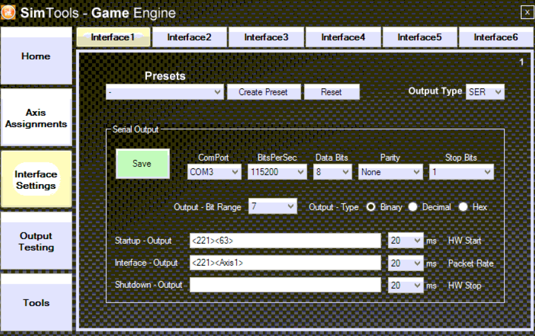

    @kopper - Just in case mate, here are my settings:
    Ignore the fact that I run the 7-bit JRK profile - It's specific to my setup. (Crap USB ports!)
    The default is:
    Startup: <221><63>
    Interface: <221><Axis1> (or Axis2 etc)
    Shutdown: <255>
    What these settings do is:
    Startup: <221> Tell JRK a "Position" is coming. <63> Set JRK to 63 which is half of 127. (well 63.5, but round down) (Centres the motor)
    Interface: <221>Tell JRK a "Position" is coming. <Axis1> Variable value between 0 and 127 (Gives the movement)
    Shutdown: <255> Send shutdown. (turn off motors)
    If you want you sim to "centre" on shutdown, just put <221><63> in that field.
    I just left mine blank because pCars and AC actually exit nicely, but if you have a game that leaves your motors in different positions on exit, then do as Nick says and run the <221><63> on exit to re-centre the motors.
    Hope that helps.

    When you "exit" the track in Assetto loses "connection" with the Engine so im kind of confused as to why Your AC is holding with No shut down command and mine wouldn't.
  11. Archie
    Archie Eternal tinkerer
    Dec 31, 2014
    1,081
    Wollongong, NSW, AU
    3,796Coins
    +1,379 / 4 / -0
    @Nick Moxley - No idea mate. I noticed on mine that when I exit a track from the pits, my sim returns to Centre. My exit command is blank, so maybe AC repeats the startup command??
    Same happens on pCars, and come to think of it ETS2 as well, but as you can see my exit command is definitely blank....

    Thanks guys! Tried it tonight and works well. Learn something here everyday! :cheers

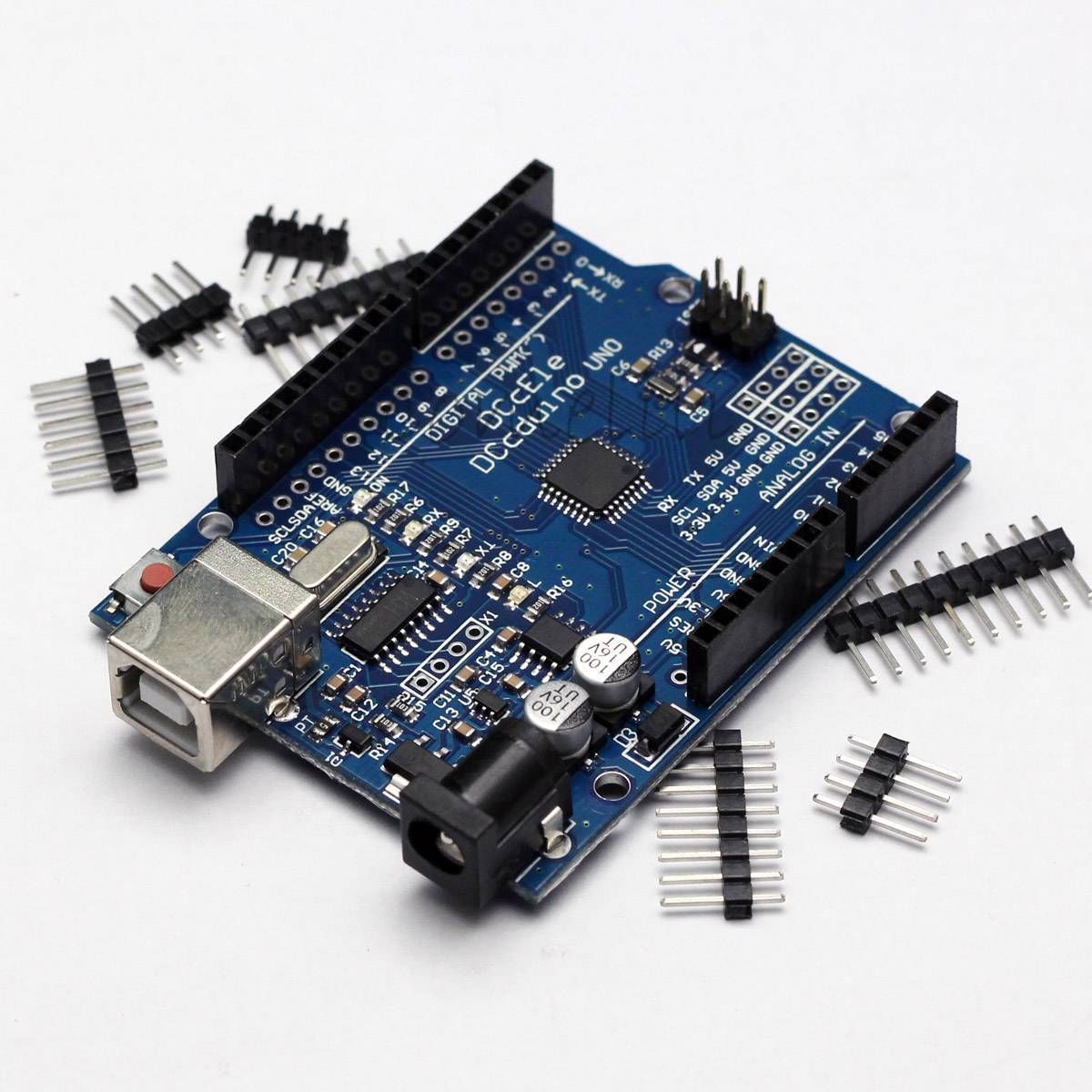

    This board is from ebay will it work? Thinking about starting off with the cheaper alternatives and then later I can upgrade.
      File size:
      148.9 KB
      Views:
      534
  17. noorbeast
    20,570
    145,292Coins
    +10,786 / 52 / -2
    It should.
