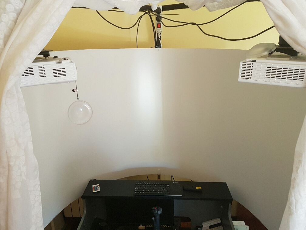

    Hi ALL,
    My Name is Marco (Aka LUPUS), 42yrs old, from ROME (ITALY).
    I always had the big passion for Flyin, even if I’m not a real pilot.
    I love to Fly in simulation (Prepar3d) and I’m part of the the Virtual group 102°v (http://www.vaafse.org/virtual102/) and VASFEE (http://www.vaafse.org/html/index.php) , flying with my virtual group with Starfighter F104 from SSW (http://www.simskunkworks.com/store/index.php).

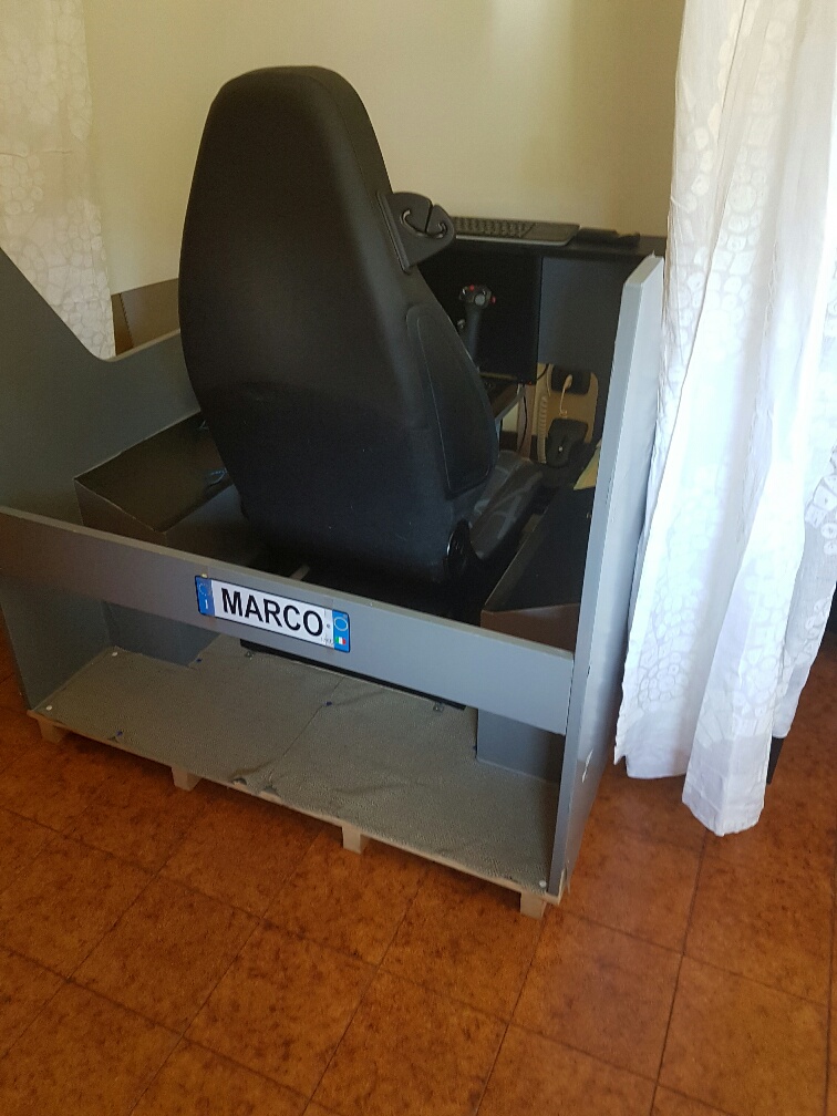

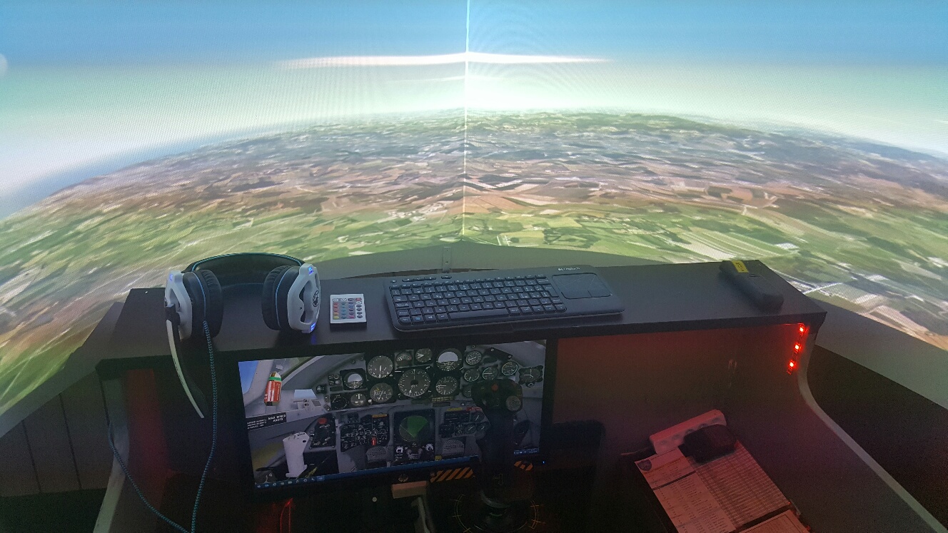

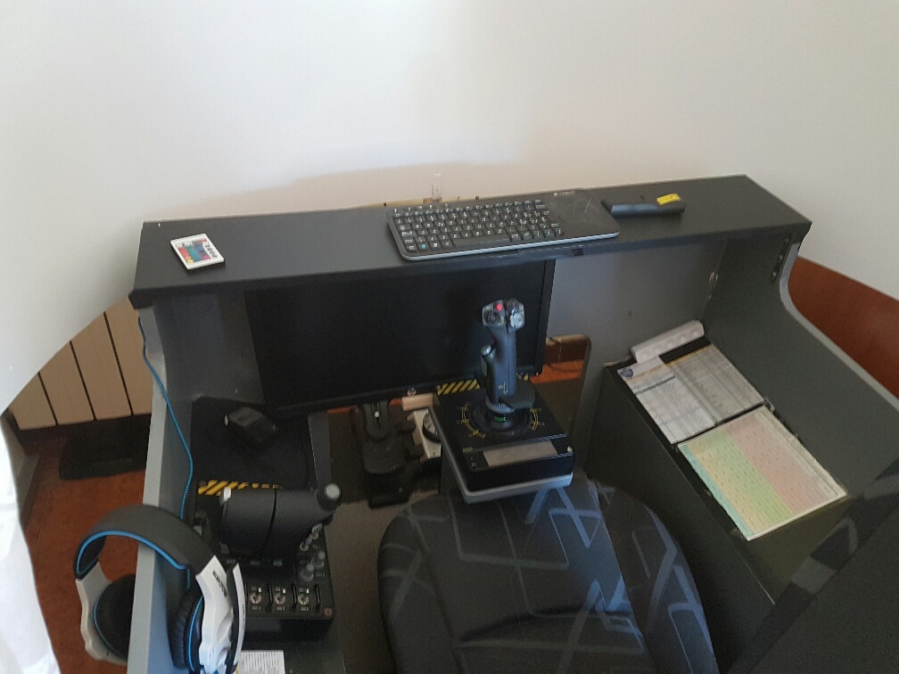

    Recently I completed my v2 of my 3D cockpit to fly with my group
    I build , with the help of oine friend of my , a cockpit in wood, with 3 (later with 2 + 1 monitor) projectors that project images in a rounded MDF wall, and wrapped the simulator image with a wrapping software called IMMERSIVE DISPLAY PRO ( I have some documentation for it , if you may be interested) .. very easy to do
    I read some about the Stewart platform , and I think that the next step (v3) may be to put all this stuff up on a Stewart platform to and a more real immersion. (more or less as DoctorD did http://www.x-sim.de/forum/viewtopic.php?f=37&t=1599&start=70#p15012 )

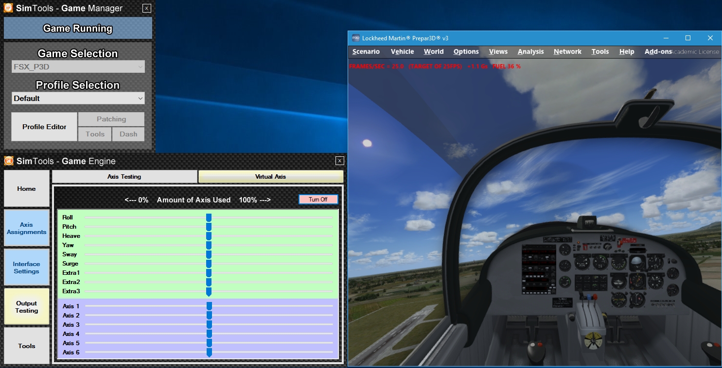

    Hello every one, i started studied some projects here and i got some ideas.
    I have been particularly inspired from Silent chill's .
    I also tryied to start a Sketchup concept (Never used before and it move very badly , still have to undestand why :) , before connect to GameEngine). see my mess attached :p
    How did silent hill connected the bar between upper platform and motor ? Using the ball going ?
    When i run physics it fall down e no big force is available in the motors....

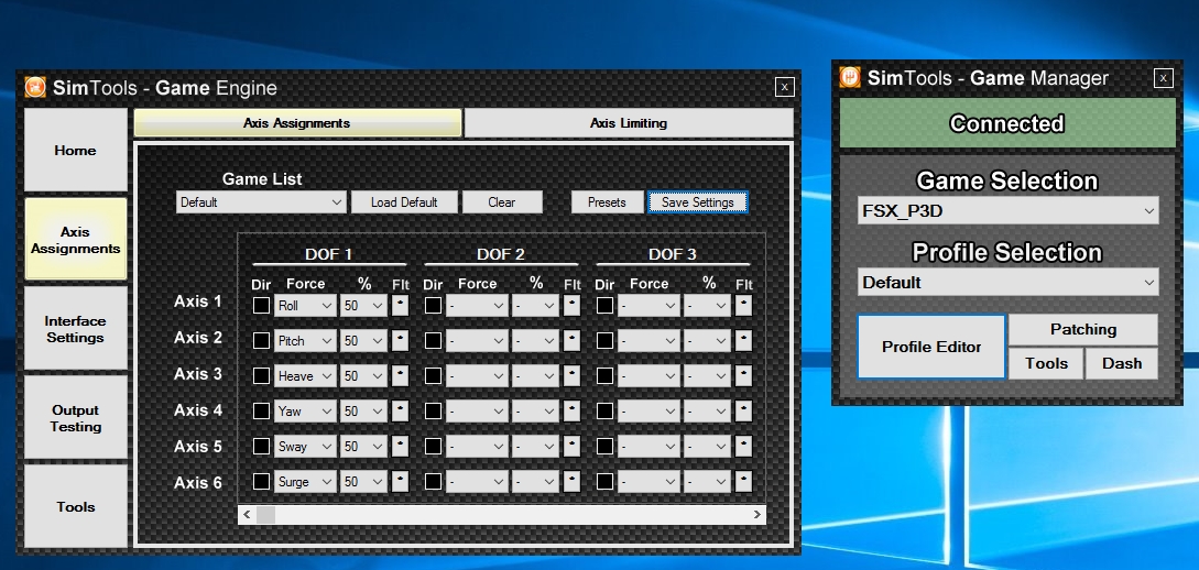

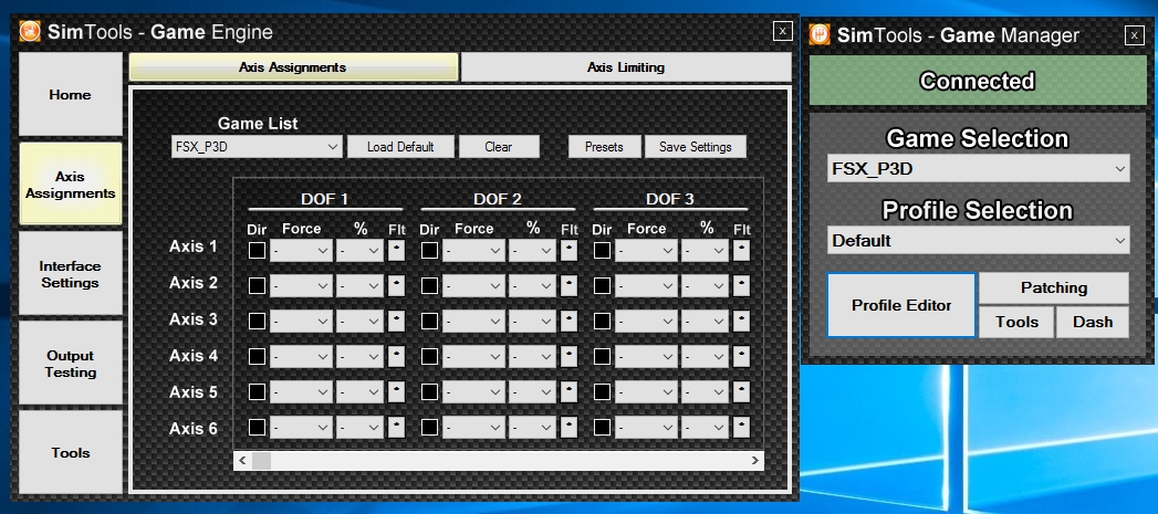

    By the way i downloaded the Plugin for prepar3d for game engine, but i have the following problems :
    1) I got No Default setting in Axis assignment for profile FSX_P3D
    2) I try to connect to game , in the output setting / virtual axis , there is no slider movements at all.
    So looks like Game engine doesn't speaks to P3D.
    Did i made something wrong , or plugin have a bug ?
    Thanks for help

    With the Prepar3D Axis Assignments it is normal to be blank, you can import the default profile with the Load Default button then save it.
    However, if your default is set up for racing then it is best to manually enter P3D Axis allocations from scratch, as they will be quite different. You will also need to use filters to get the mot out of a flight motion profile. Use @Archie's guide as a starting point and tweak from there: https://www.xsimulator.net/community/faq/prepar3d-guide-to-realistic-motion-settings.144/
    The same steps apply to developing and refining a motion profile: https://www.xsimulator.net/community/faq/steps-to-create-a-motion-profile.228/
    There is a known .net error that can occur with P3D, you run these files to fix it: https://www.xsimulator.net/community/faq/fsx-prepar3d-net-error.156/

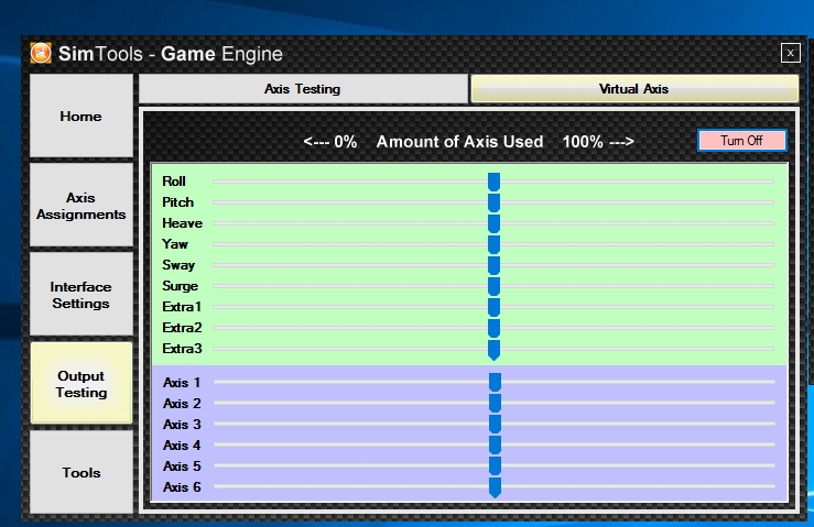

    thank you noorbeast, i will try to invent some setting then looking around if anyone suggested any good setting.
    I already have installed SIMconnect correclty but thesting the axis still no movement / connection.
    Any other suggestion ?
    (As you may see on the uploaded image , flyin' no movement of slides at all)
    I will try to figure out.
    21,487
    150,542Coins
    +11,017 / 55 / -2
    Please post pictures of all your settings and confirm that you ran the files to ensure there is no .NET errors.

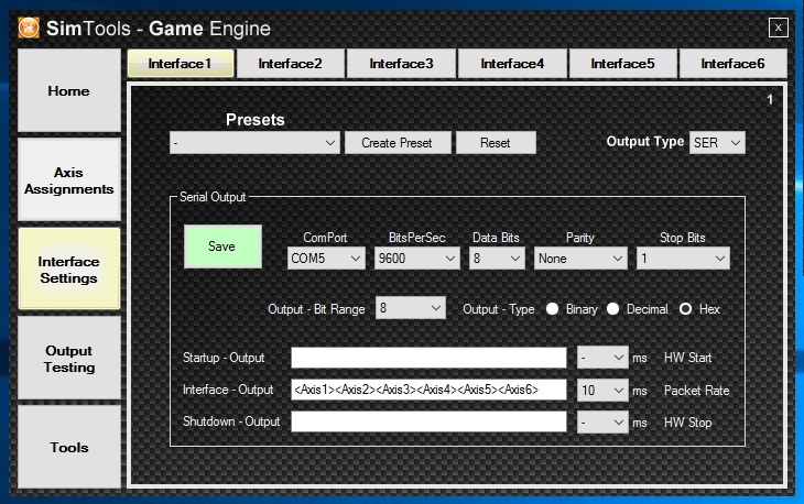

    Hi noor, sorry for late reply, i was at work .

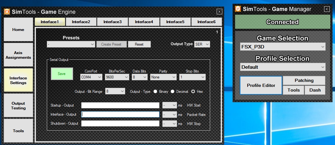

    I attach the other screenshot of my Simtool config.
    I am also quite sure that simconnect is correctly installed as i need it to fly online with virtual group , as we have many external component that need it correctly installed.
    I also confirm that no popup message about .NET errors appears.
    Is there any other setting i may check ?

    Simtool is connected to an arduino card, so far with no motors or MMs.
    Now actual configuration i'm using is ALL OUT
    <axis1>;<axis2>;....<axis6>;
    See the last updated screenshot (Sorry i upload an old one).
    Arduino just get the serial data .
    I tryied to review the code on arduino and now everythink work.
    Thank you for your help !!
