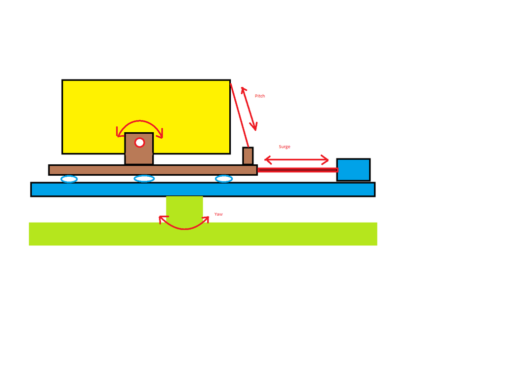

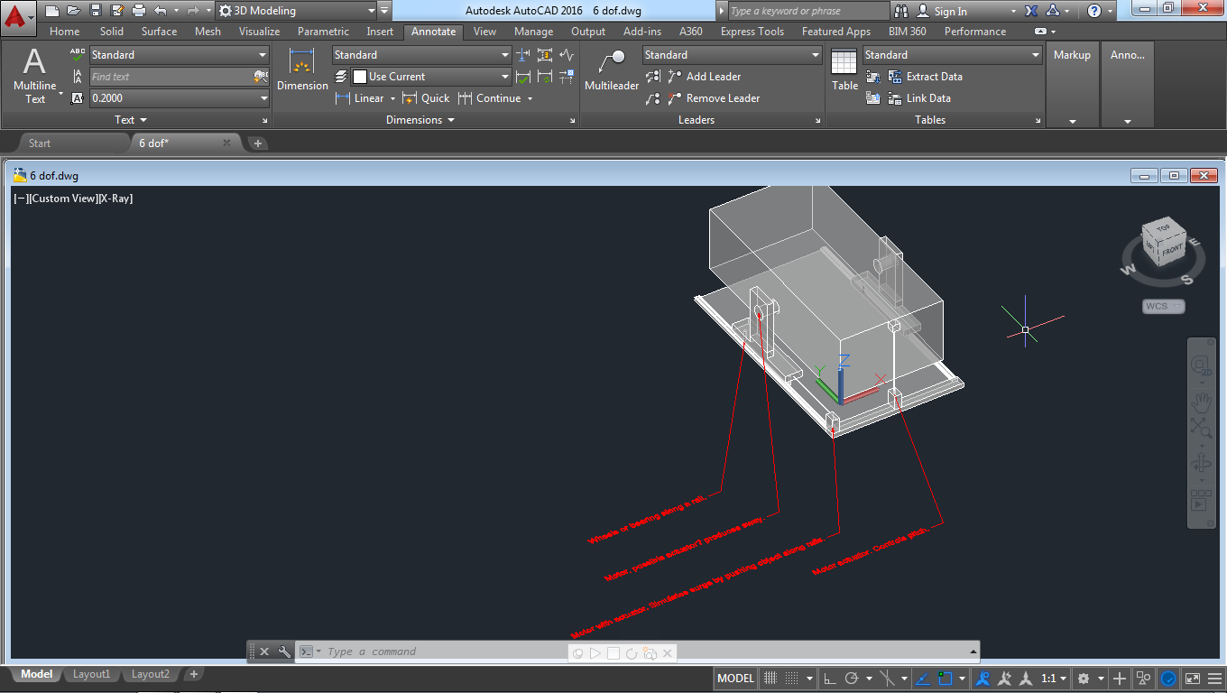

    @RacingMat and @noorbeast Been working on my drawing. I have probably an elementary understanding of motors at best so there are a few hang ups. For example. I have drawn a motor/accuator pushing along the y axis to simulate surge, and the object being moved sits on a rail to be slid forward and backward. I have another motor/accuator pushing along the z axis for pitch, the problem is, as surge moves forward, it would pull on the accuator for pitch, and as it moves back, it once again moves the accuator. Are there ways to address this with fittings or do I need to change the design?

    Here is my progress. Dimensions are not right and some things are even just sloppy. But its meant to be more of a visual aid anyhow. april 30th.png

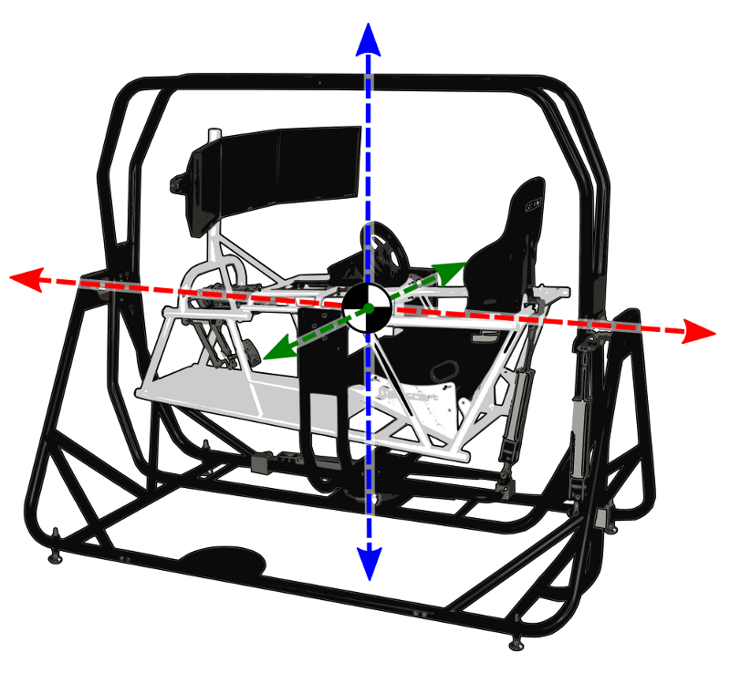

    Isolate the axis, so think about a multi story building. The top floor houses your seat, pedals, wheel and the roll/pitch axis. Then the floor underneath that controls surge. The floor under that floor then controls sway. That's is for a 4dof simulator, a 6dof would be a little more complex and require out of the square thinking.
    In your case you can leave the pitch axis on a frame that controls roll, with surge being a separate frame that pushes the main frame.
    As shown in this professionally drawn CAD model:
    I use MS paint for all my modeling needs but it is somewhat limited as a CAD tool in like, everything.
    Whilst the idea will not be in your best interests to copy it will at least give you an idea on how to separate layers of axis. Some axis can be combined with others to make more compact frames. it all comes down to your mechanical imagination but most importantly, your budget. If this is going to be home built and you don't have a huge budget I would forgo full 360 roll.
    Don't forget that your electrical connections will need to spin around. Imagine holding a shoe by its laces, now spin that shoe around 30 times. What happens to the laces? They turn into a crumpled mess. Doing that to wiring will be 10 times worse. One way around this problem is to pre coil a length of wire that is far longer than you would normally require but even that only helps for a bout 15 turns in either direction. Next comes rotary couplers, which will be the most expensive part of the sim as they need to have many connections and also heavy duty. I'm sure there are other solutions but I'm not aware of them.
    With the current cost of things these days I'm not sure what you want from the sim is attainable. I would seriously recommend building a 4 dof sim first or at least something simpler than what you currently want. Then you will have the skills and knowledge to proceed with something more ambitious.

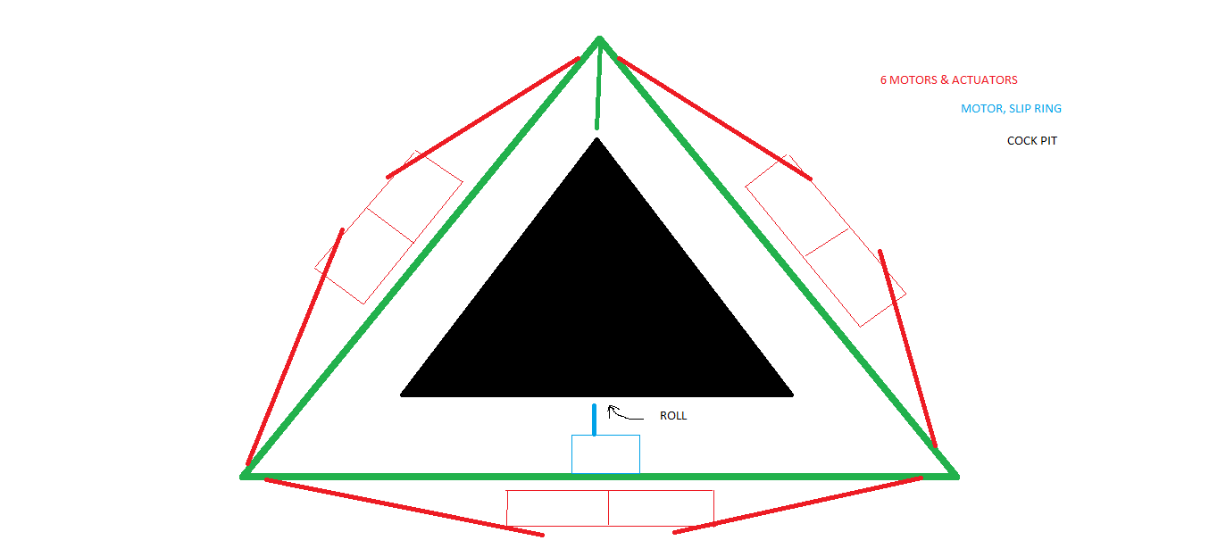

    I was thinking maybe a slightly modified Stewart Platform would work better. Would only require 1 slip ring for the peripherals.
  19. SeatTime
    28,370Coins
    +2,844 / 39 / -0
    Go hard or go home:D . But seriously, its challenging (and costly) enough for most to build a working stewart platform, let alone a modified version with a 360 roll component:eek:. I like many would recommend for your first sim something simpler (Ie. 2dof seatmover) so you get a grasp on the complexities/cost of building a working sim which can support a large mass in motion, but it is your money and time so all the best. Just for information SimTools does not support 360+ degree sims, or the math for a true stewart platform.
