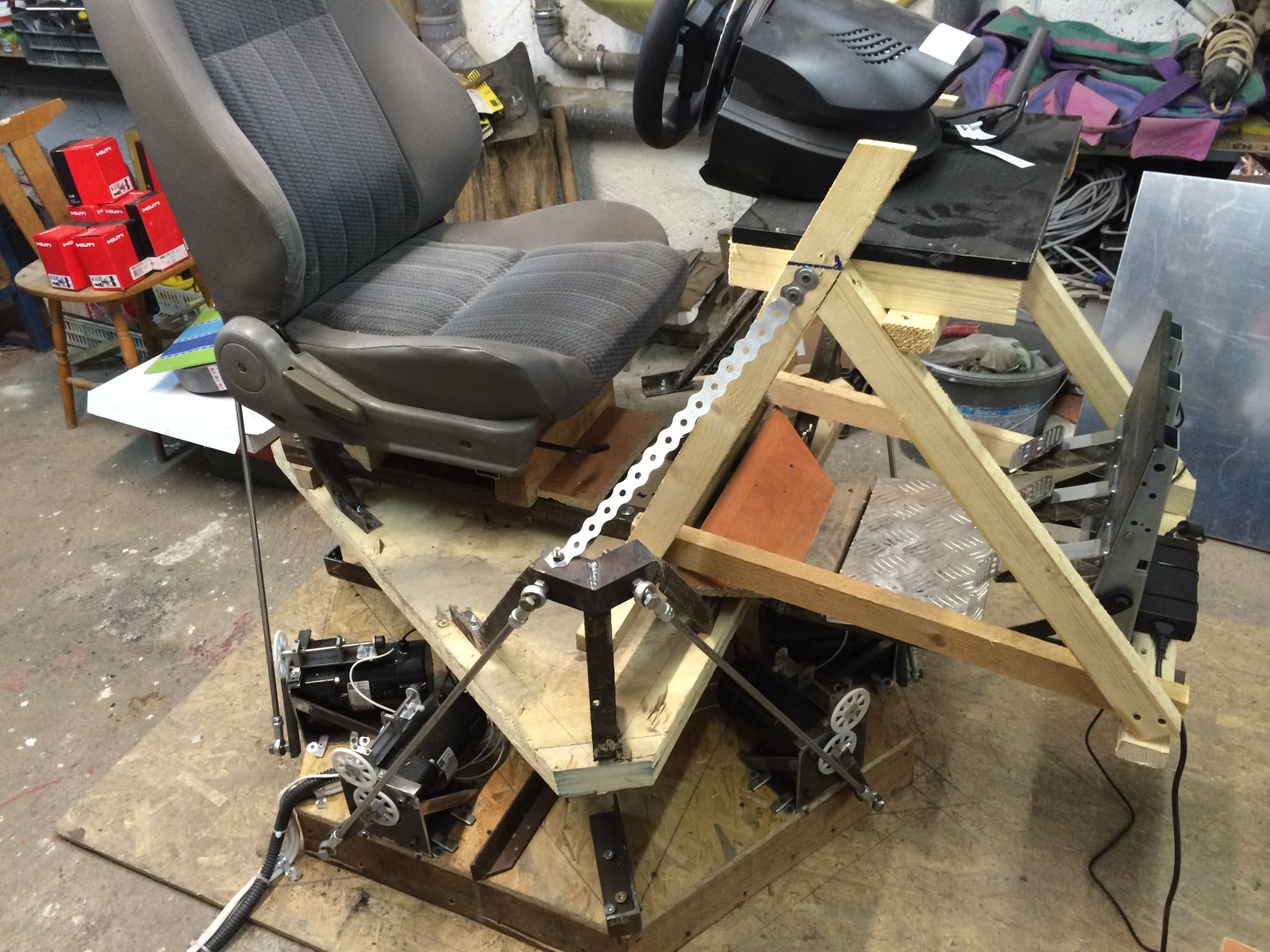

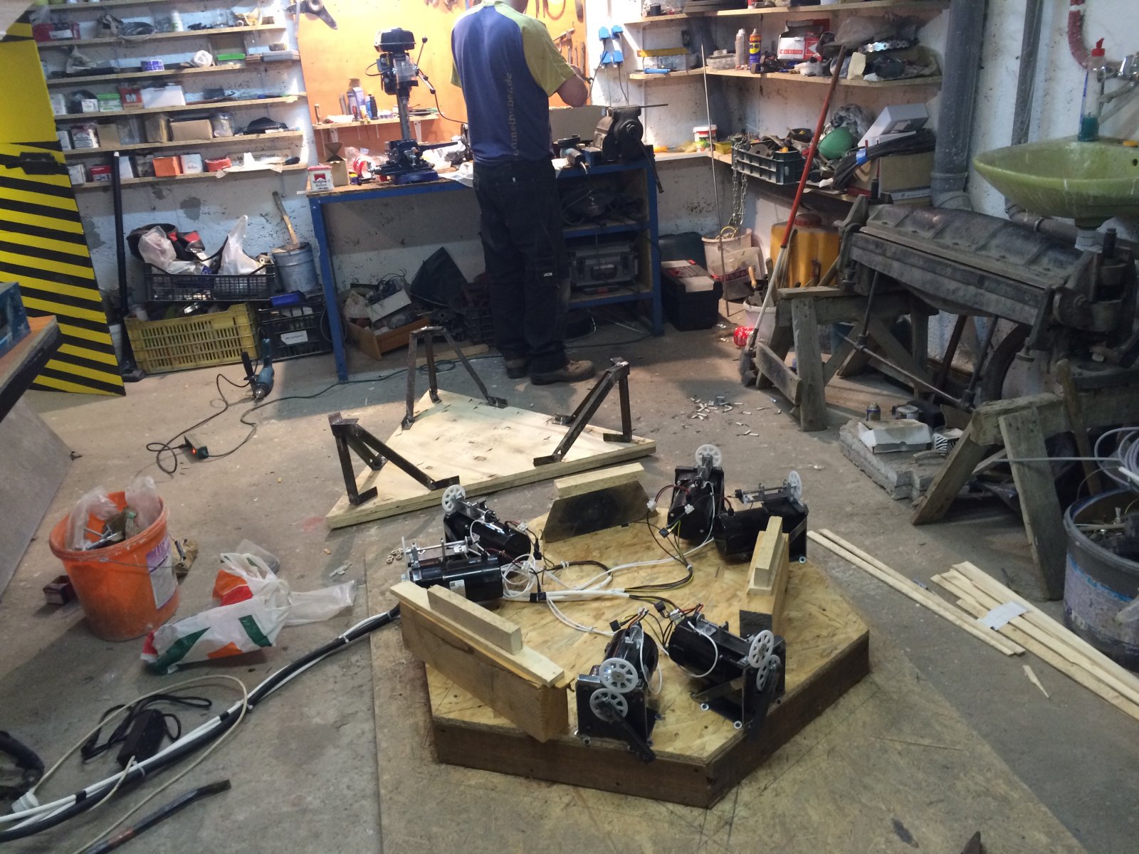

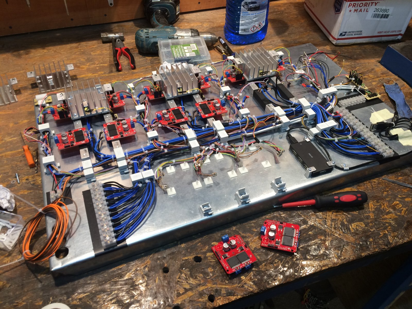

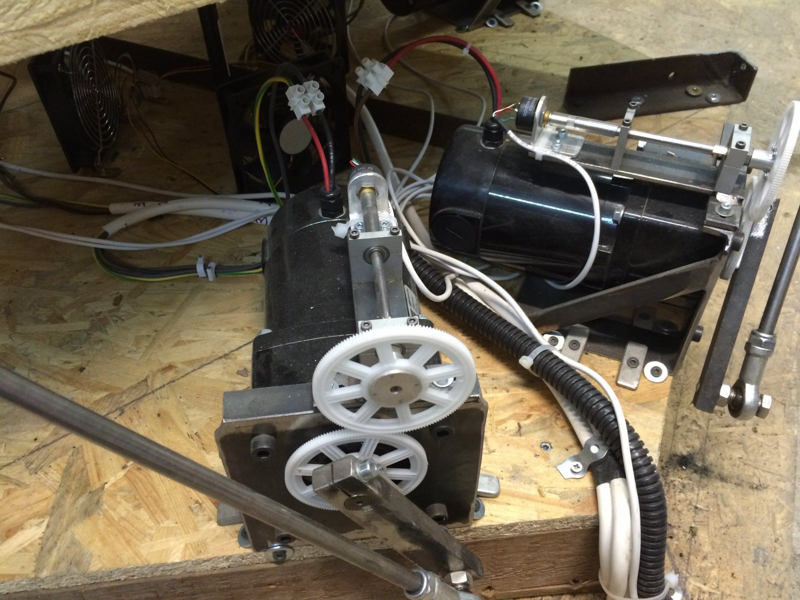

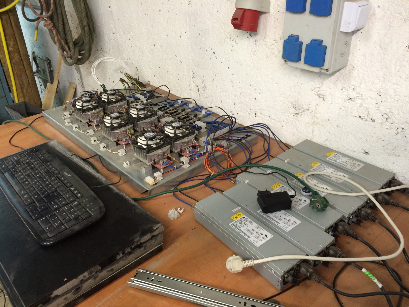

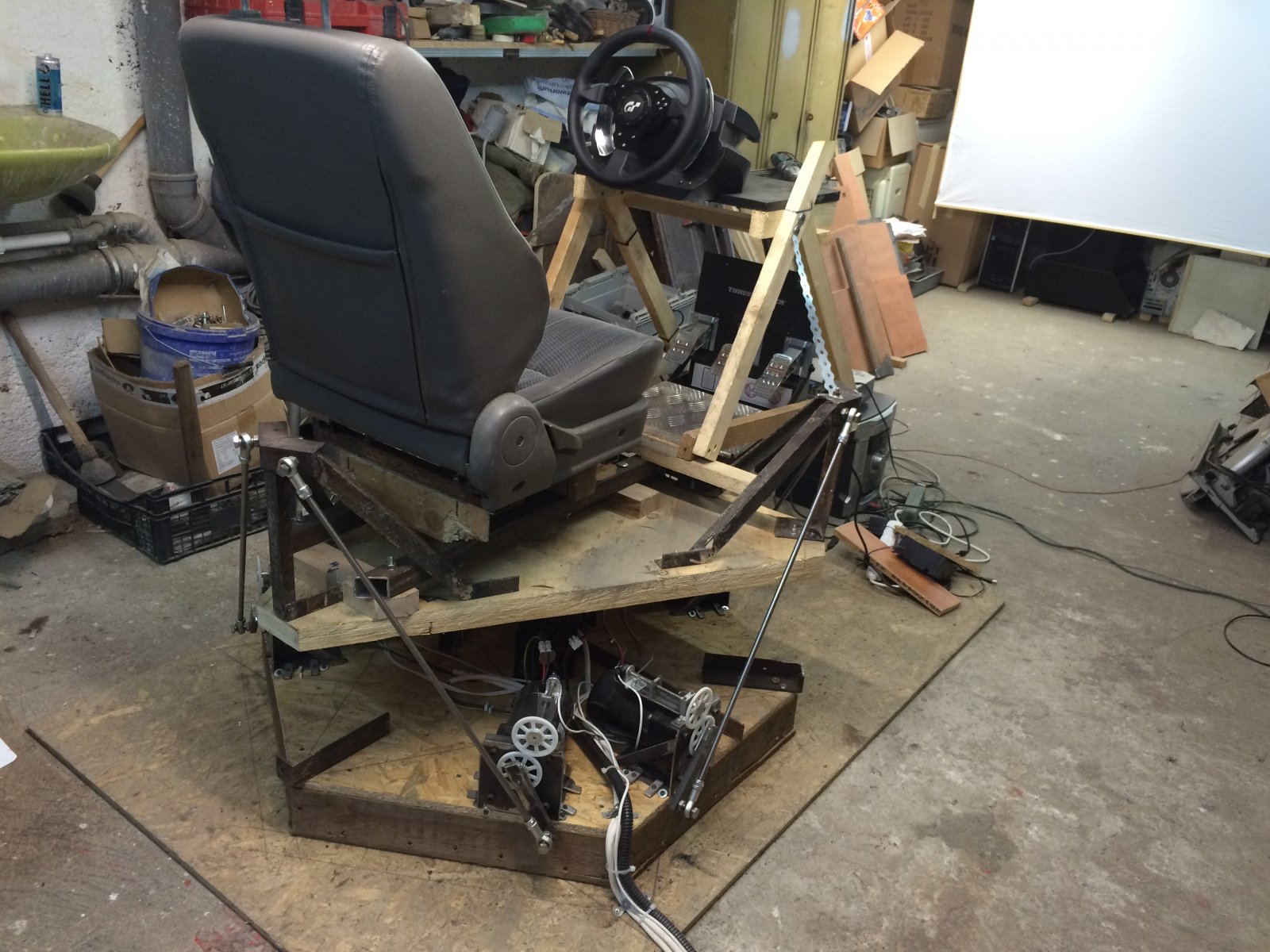

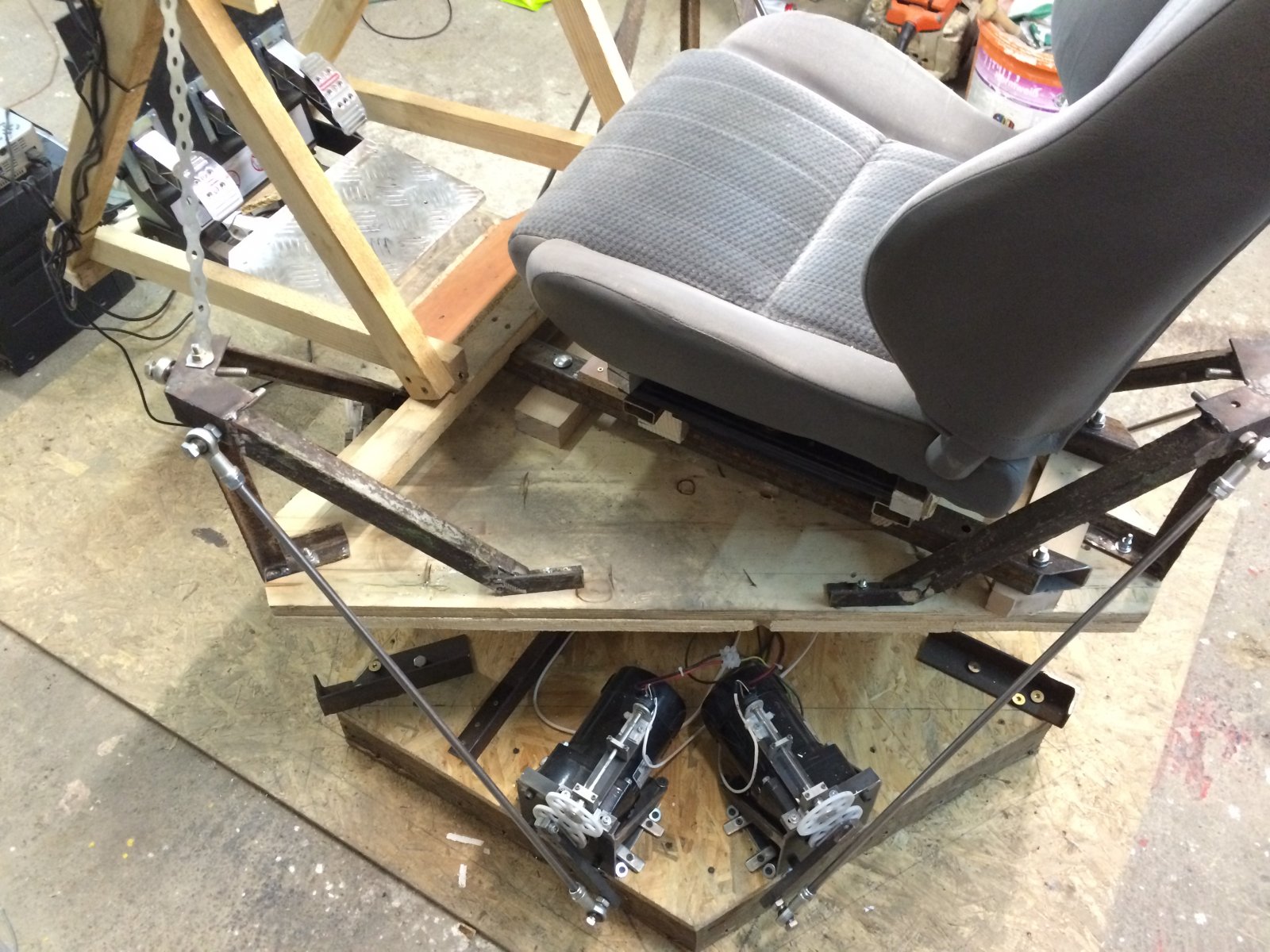

    Hello from Hungary. Sorry for my poor English. The moment has come to open the simulators was my topic . A year ago, I found out this fantastic forum , but so far I've only read-only mode. I want to thank all the members of the forum a lot of inspiration and a description of what I read on this forum and I saw it. This is a fantastic and a great forum members make up this community. I'm glad that I found this forum and become a member . :)
    Some things in the simulator : This is still only a prototype , made of wood . The preparation of the final structure of steel and aluminum is in progress. The preparation has really helped my brother .
    The components used :
    12 pieces MotoMonster
    3 piece Arduino Uno
    6 pieces Bodine 42A3BEPM -E3
    6 pieces DELTA DPS - 835AB PSU
    6 pieces BI TECHNOLOGIES Hall Effect sensor
    The previous two months, is approximately 200 hours playing with it. No problem occurred . The Bodine motors falling perfectly withstand very strong robust .
    A lot of my plan , and it will be a lot of work before they are finalized , but in the meantime some pictures and
    a video . Soon uploading additional videos.
    greeting
    aljaschief

    Great to see another 6DOF up and running, I look forward to you adding more details about it.
    If you shoot another video from a fixed position, where we can see the sim movement and the screen at the same time, then members can suggest refinements to your motion profile.

    Nice 6DOF (from what I can seen in the dark room :)). Although from the little I can see, hitting the guard rail did not seem to be reflected too much if at all in the rig o_O.

    You really need to sort the profile out as the movements don't seem to reflect anything that's going on in game a whole lot of up and down going on :D

    Thank you all for the congratulations . The above video has been made in the past. Since then refined settings , but still not very good. So I accept any help and advice on setting up the game 's profile . Thanks in advance. Currently I play the Project Cars and Dirt Rally games. I made two fresh videos from it. ( Unfortunately, the light is still not the best, but more light I can not do it, because then the projector is not shown . ) This will copy the current profile settings.

    Wow dunno where to start here :D
    I personally always have the main level set to 100%. You have 6DOF so you should be using at least 20% in every DOF. I use 30%-50% on every DOF in pretty much every game I use it on.
    You should be using Extra1 instead of YAW when ever possible or else you get thrown from one side to the other when you reach the 180/-180 point.
    Set all the DOF's to 20% and if the movements are too much make the tuning settings higher so they aren't as violent. Also you can add some smoothing to the DOF aswell

    Latest videos are allot better. With the roll centre so low, likely a good idea not to have too much movement in the roll and pitch DOFs.

    This makes me happy like a pig in sh!t. What is the weight of the top part with the rider? An estimate is ok. Very good see the bodines on yet another rig.

    I'm 103 , the upper part is approximately 40 , so it is 143 kilograms . I use one piece of gas telescope in the middle of the structure. Two gearmotor cooling with one piece of 12 cm fan from the rear . He never went above 40-45 Celsius. Have we continually played to 10 hours . But without a fan and a gas telescope after only one hour at about 70 celsius were the engines ...

    Ok thank you @Aljas Chief. I'm aiming for 115 kilos and no gas strut. I think I will need them after reading a lot of threads. it seems it's struts or ac motors and ac motors isn't very cost effective.

    My mistake, you have actually raise the roll centre , did not originally see that in the dark video :).
