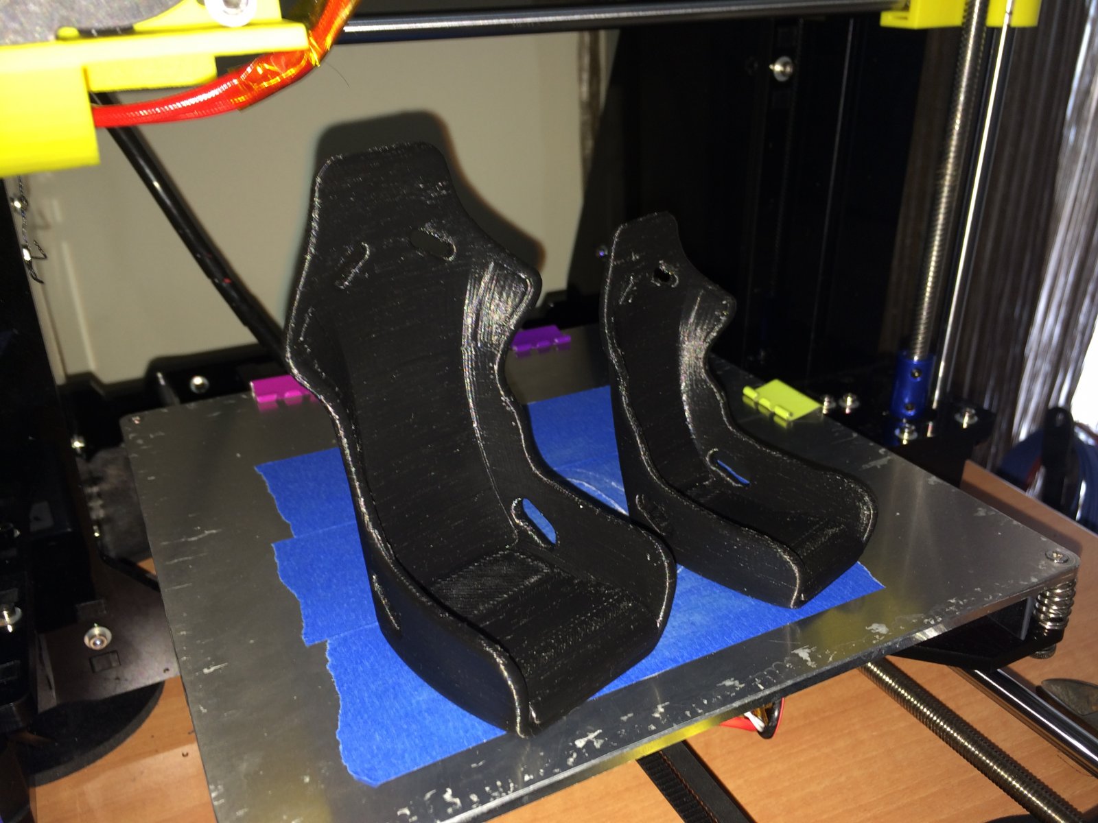

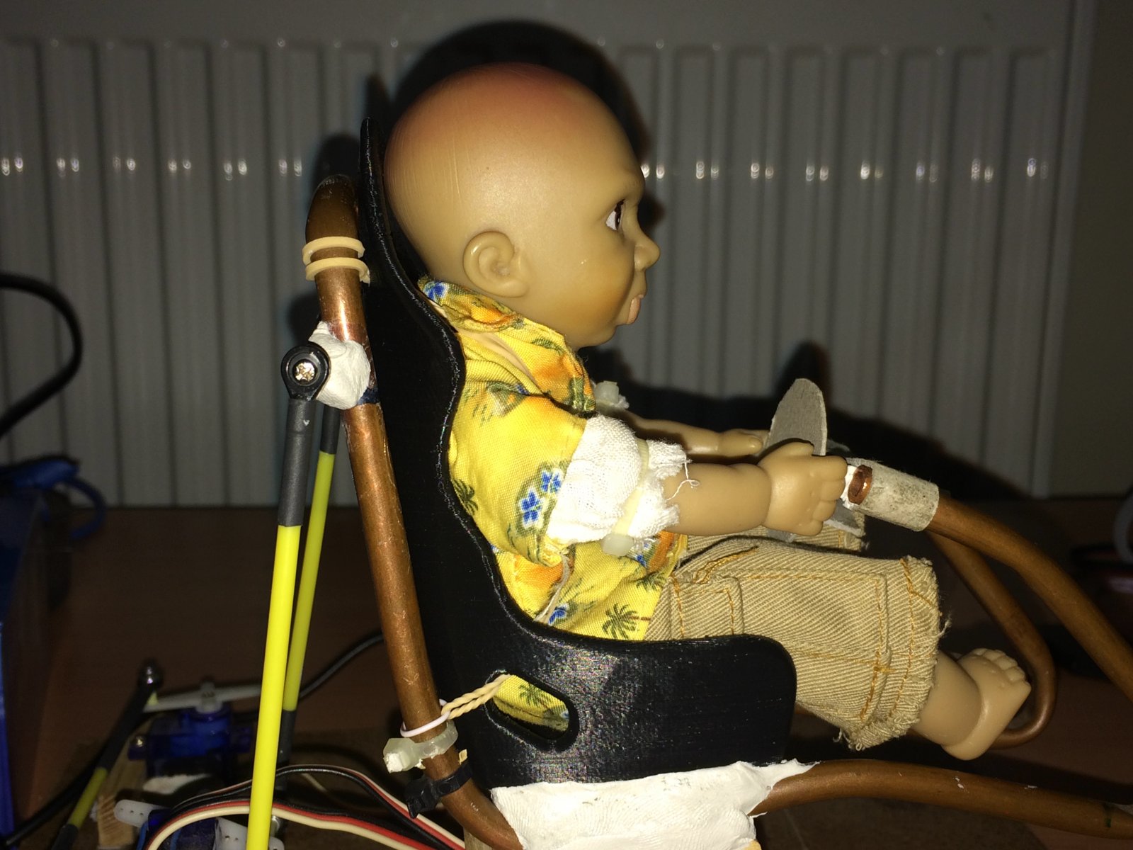

    after watching @stevemontuno RC model i couldn't resist not printing a new seat for my RC model too.
    http://www.thingiverse.com/thing:32318
    it will be nice to gather some info for 3D printing here as we can get one really cheap from china (with the known risks) and make things for our rigs.

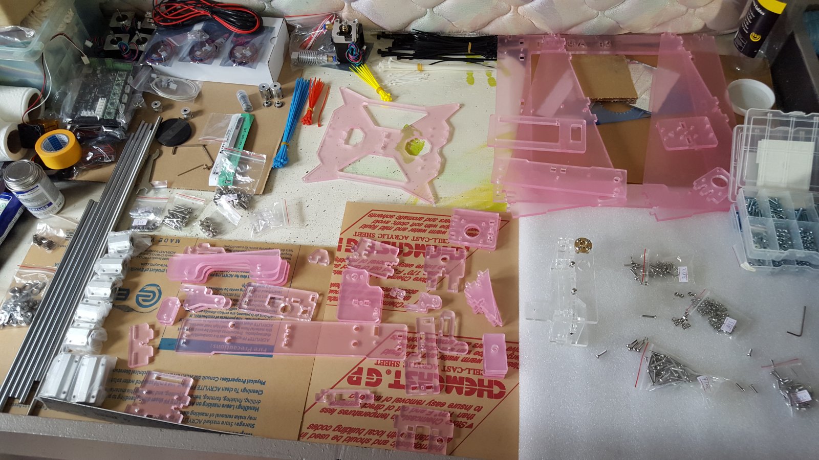

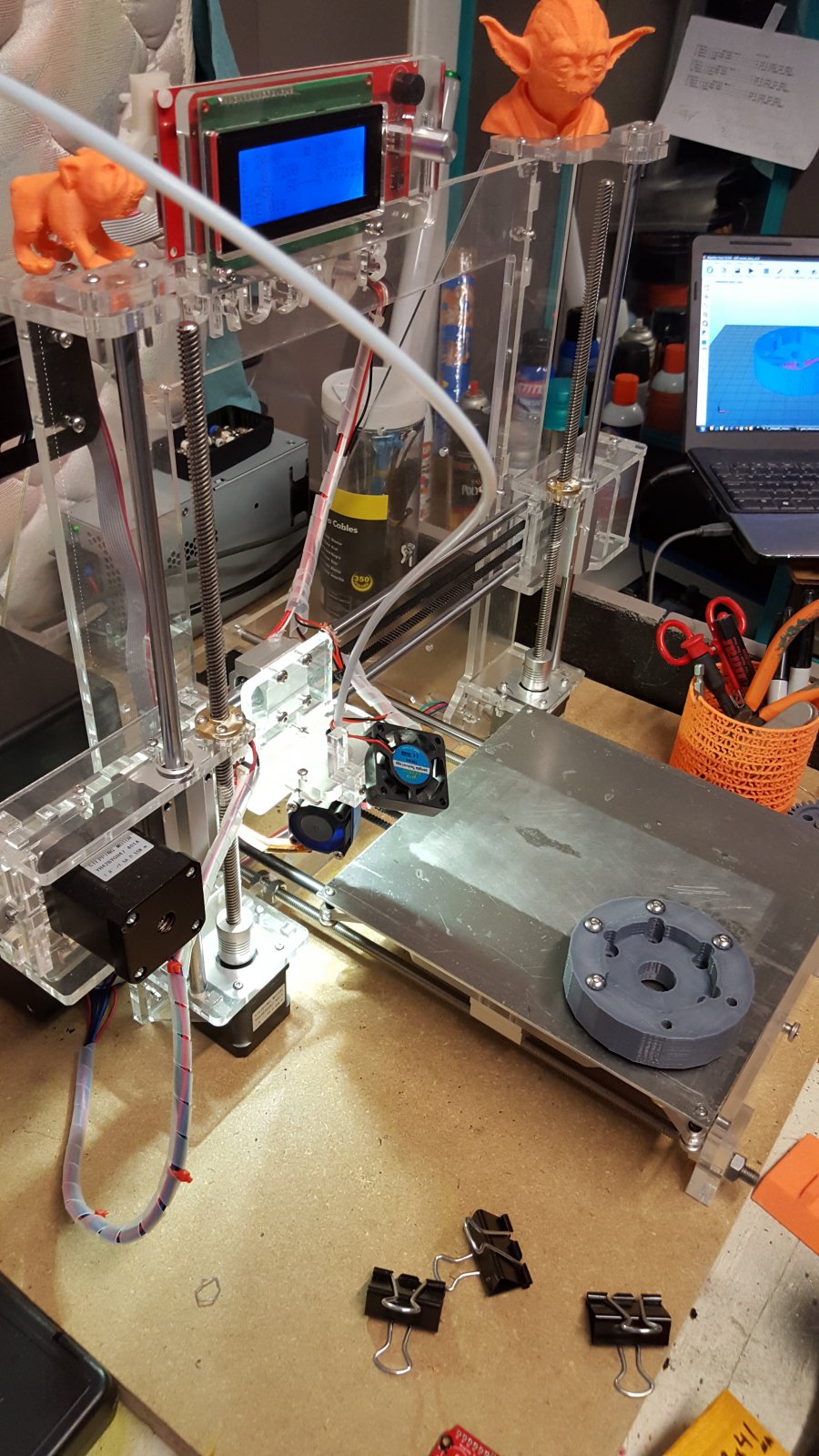

    20160207_102459.jpg 20151219_114503.jpg ty @insanegr . I just printed the hub adapter for my g25. ill be going to the flea market today to try to find a suitable wheel.
    I use a prusa I3 reworkhttp://cgi.ebay.com/ws/eBayISAPI.dll?ViewItemVersion&item=181946177631&view=all&tid=1443317210008. Mk8 bowden extruder E3dv6 head. I print mostly pla as it is easiest. messed with abs and polycarb a little but not a whole lot of success with those yet. they curl as they cool so still figuring that stuff out.
    I also printed some project boxes using a parametric script and openscad. i use repeteir with cura. to slice and print.

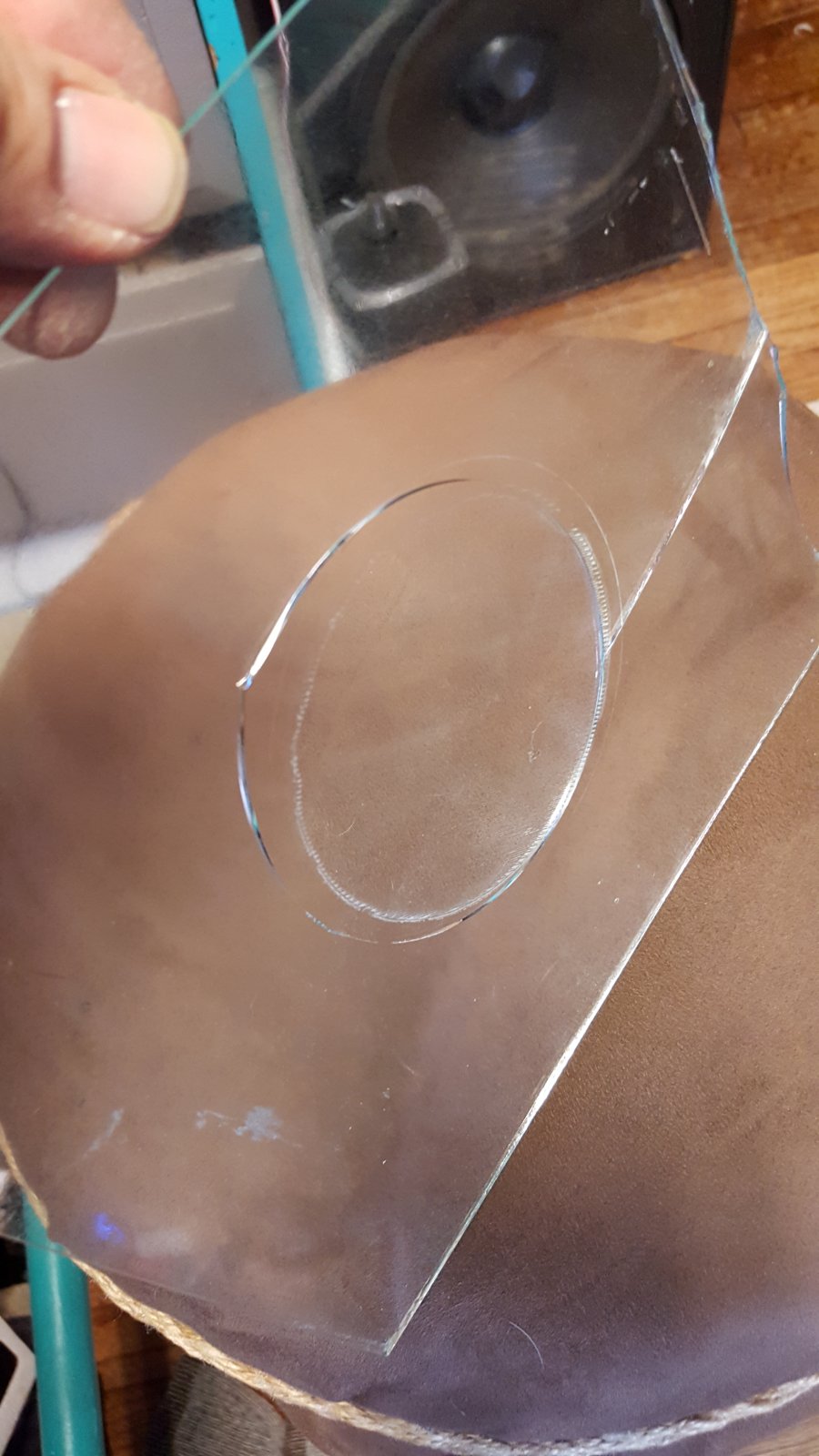

    I use home depot 8x10 glass. 2.00 a sheet. i switched out the psu that came with the printer for one like i use on my sim 12v 50amps plenty of power now. bed was weak at first with the psu supplied. blue tape pulls off the bed for me. I mostly use hair spray for pla as it dries super smooth for an awsome finish. ca glue on glass worked best so far for abs but had to bust out respirator for the fumes so that one is nixed. wanted to try the abs juice for sure. glass is best, you can quick cool and also have a few sheets around. just be careful about too much adhesion lol. check out this pic.
    Left a print going and came home to find this on the bed

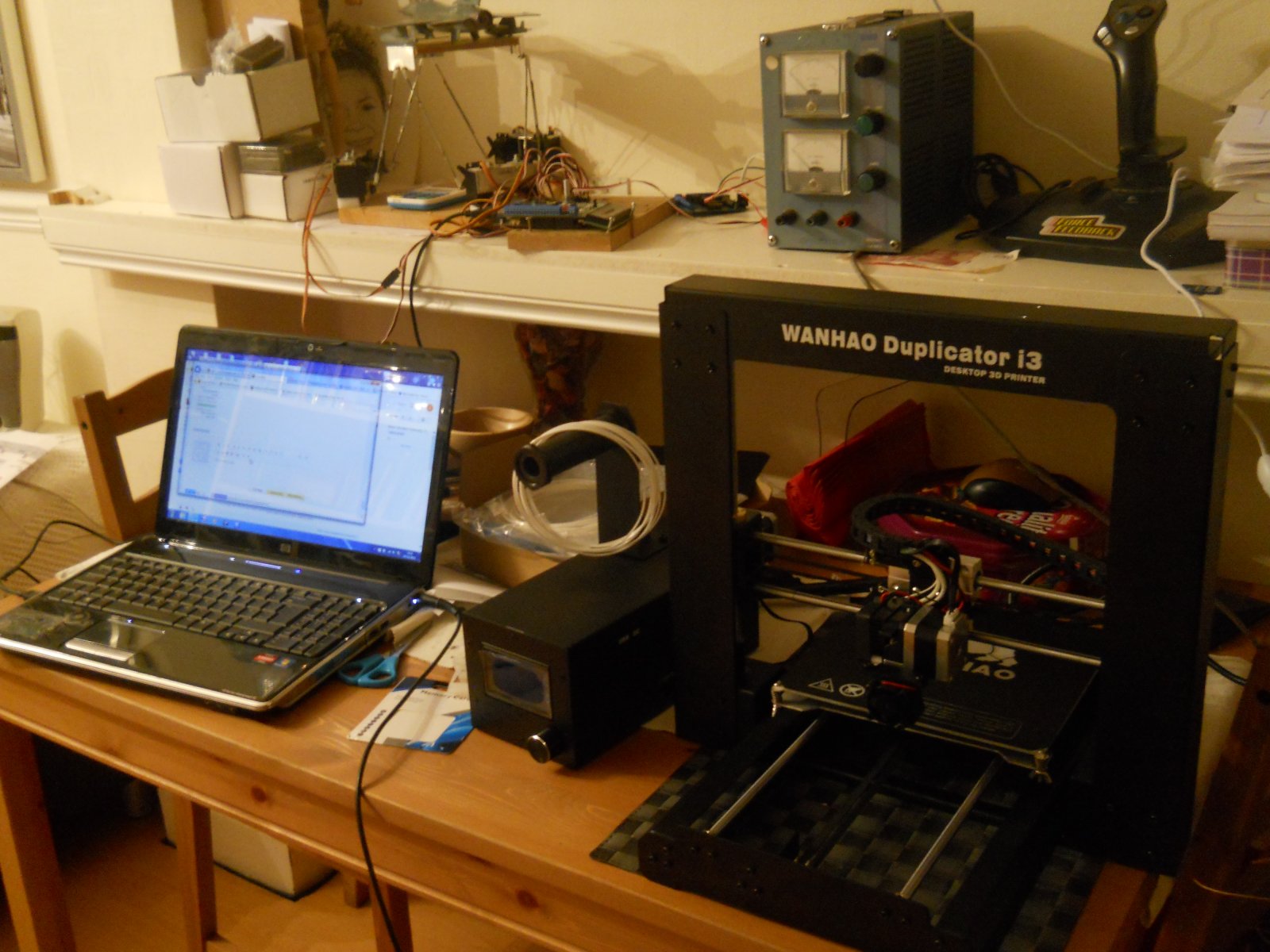

    LOL funny you guys should start this post , I think it will be a great melting pot for ideas, Treated myself to a post Xmas present ( well that was my slant on it anyways) and bought this 3d Printer ,WANHAO Duplicator 3... took all of 20 minutes to assemble and so far seems to work fine , Not printed anything yet but hoping to do so tomorrow once I print out the user guide, If this lives upto expectations then bang for bucks thjs will be a great way to get into 3d printing ,, I had already built a MENDEL 90 version 3D printer , but never got round to messing about with all the stuff needed to fine tuneit and get printing ,
    Just decided to bite the bullet and get an almost ready to run unit , £289.00 direct from UK distributer delivered within 3 days , Sat unopened for 2 Weeks LOL , Had a blitz day yesterday and it was a doddle to assemble (if you can call fitting 4 screws assembly :) connect Mains lead and switch on ....JOB DONE ... im liking that sparco seat model you guys posted ,so safe to say that will be on the list for testing
    the 6DOF RC servo model in the background will also get a remake to be driven by simtools and ARD , thanks to the new Printer so watch this space for updates

    the glass i am waiting is tempered and for sure i will not see only a crack if things go bad.
