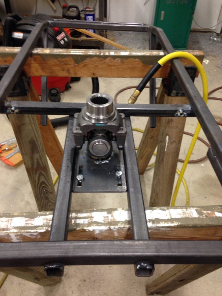

    Progress has been slow but fruitful. Here are some pics to show where I am at. I am very close to starting on motors and electronics. My plan is to build a "modular" setup for them that bolts to the rear section of the base frame as I have a feeling I may be swapping the motors out. These things seem to be pretty robust and I am afraid the JRK's will not handle them. I have ordered the parts (Arduino and pair of MM) to try SMC3 with each MM driving a motor like @Pit is doing with his winch motors in case the JRKs do not work out. If that doesn't work I'm not sure what I will do but want to be able to start over easily without having to cut/grind hence the reason for the "motor module". Hopefully it will make more sense later.
    So, I pic of the joint setup. I built a small amount of adjustment in. If you noticed and wonder why the bolts are not centered in the slots on both sides it is because I forgot to move 0.1" and re-zero the axis after using the edge finder when I used the mill to drill the holes on the upper plate and had to redrill them (the were not centered in the slots). doh!

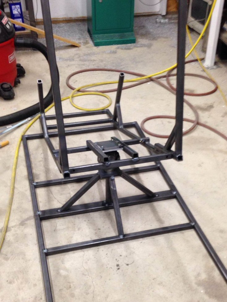

    The frame/base setup:

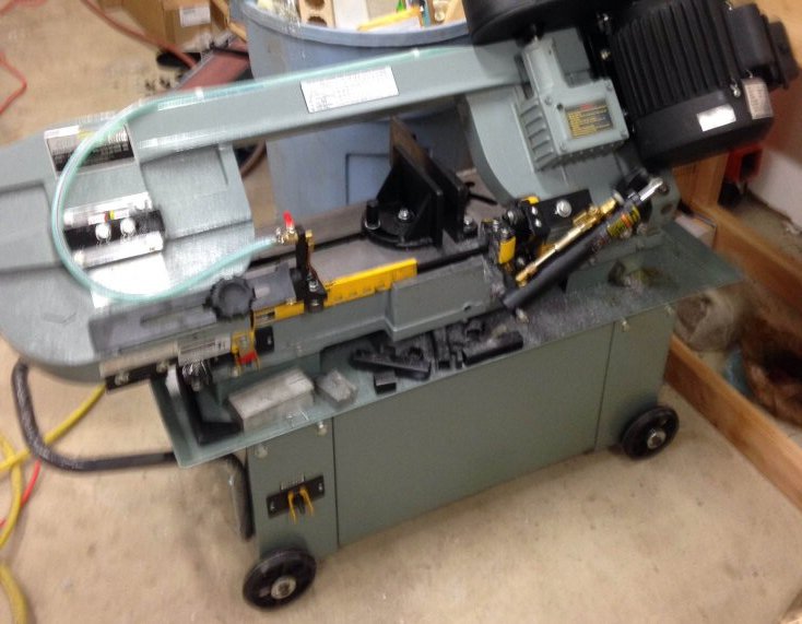

    And lastly I picked this up on sale around Christmas and it has been invaluable. I do not know how I went so long without one.
    More to come later!
    20,569
    145,286Coins
    +10,783 / 52 / -2
    The frame looks very solid.
    I see you have made the pivot point adjustable. Have you established the center of gravity yet, including with yourself and any peripherals?

    Yes, I mounted everything up and found the COG but added a little adjustment in just in case. The steering wheel brkt is aluminum and slides over the uprights you see up front. It is adjustable up and down and also has a slide setup for front to back. My alum TIG skills are not as good as what I can do on iron so I'm too embarrassed to show the pic!-lol Actually, didn't think to take a pic when it was all put together but I'll get some soon.

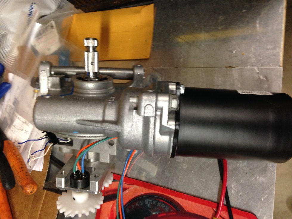

    Here is the motors I'm experimenting with:

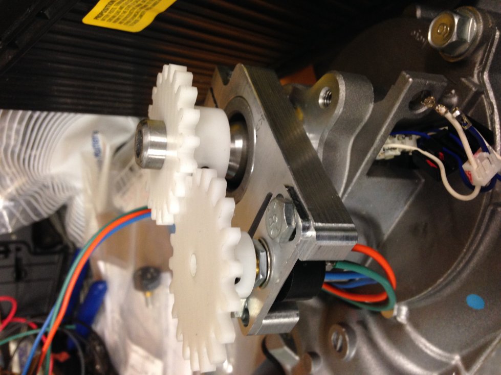

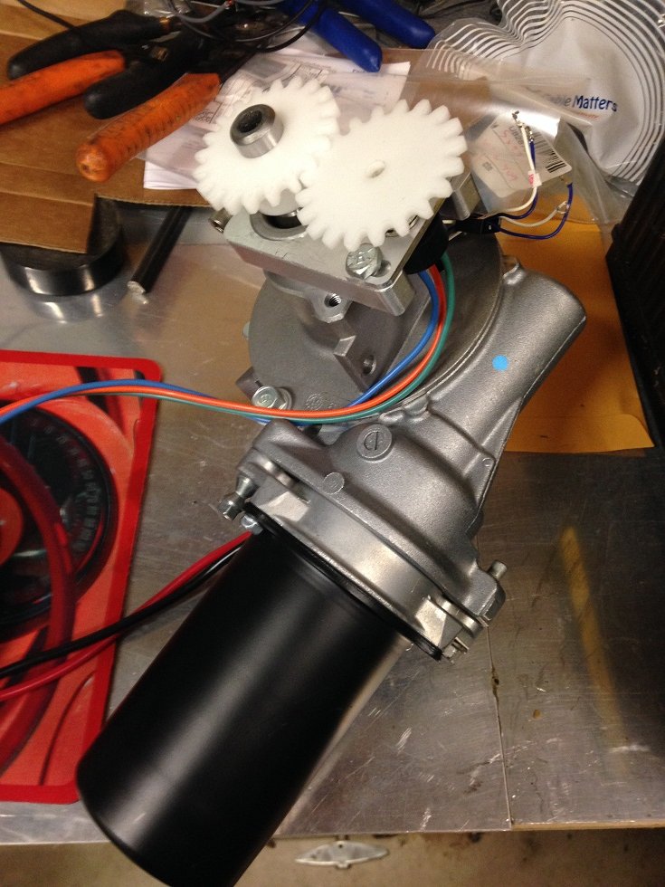

    The fancy pot brkt and gears I made:

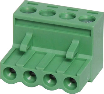

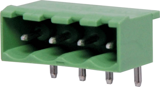

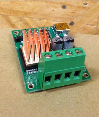

    I was going to solder the power and motor wires directly to the JRK but picked these larger terminal blocks up from the place I got the hall effect pots from (Digikey). The are rated for 12ga wires with the same 5mm pitch pins as the ones that come with the JRK. Even 10ga wire fits in them although tightly. Figured I'd try them first since I could be changing things around and such.
    20,569
    145,286Coins
    +10,783 / 52 / -2
    Having just struggled to reconnect a dislodged JRK wire this morning, which is no easy feat on my compact sim, I can really appreciate the tip about using a larger block for the JRKs. I had never even considered that as I cursed the motor wire gauge!

    @kopper do you have a link or Digikey product number for the connectors, I do want to try them out.

    @noorbeast
    Will these do?
    These are what I am going to be using....
    There is a socket and plug effect so removal is easy if need be.
    The socket is rated 10A @ 300v
    and the plug is Rated 10A at 300V.
    Cable hole entry size up to 4mm2 or 12AWG.

    The ones I linked are rated at 24A. I'm not sure if the ones @kanuk linked will handle the load we need but I do like the socket and plug idea.

    Not my area of expertise @kanuk, but I am not sure how the amp rating would go. A JRK is rated as:
    Operating voltage: 6 – 16 V
    Continuous output current: 12 A
    Peak output current: 30 A
