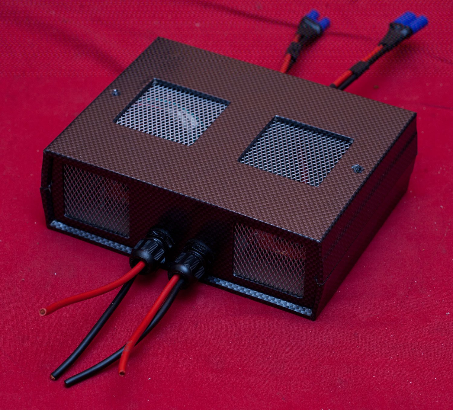

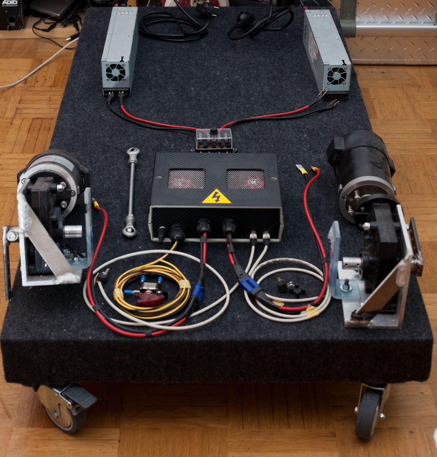

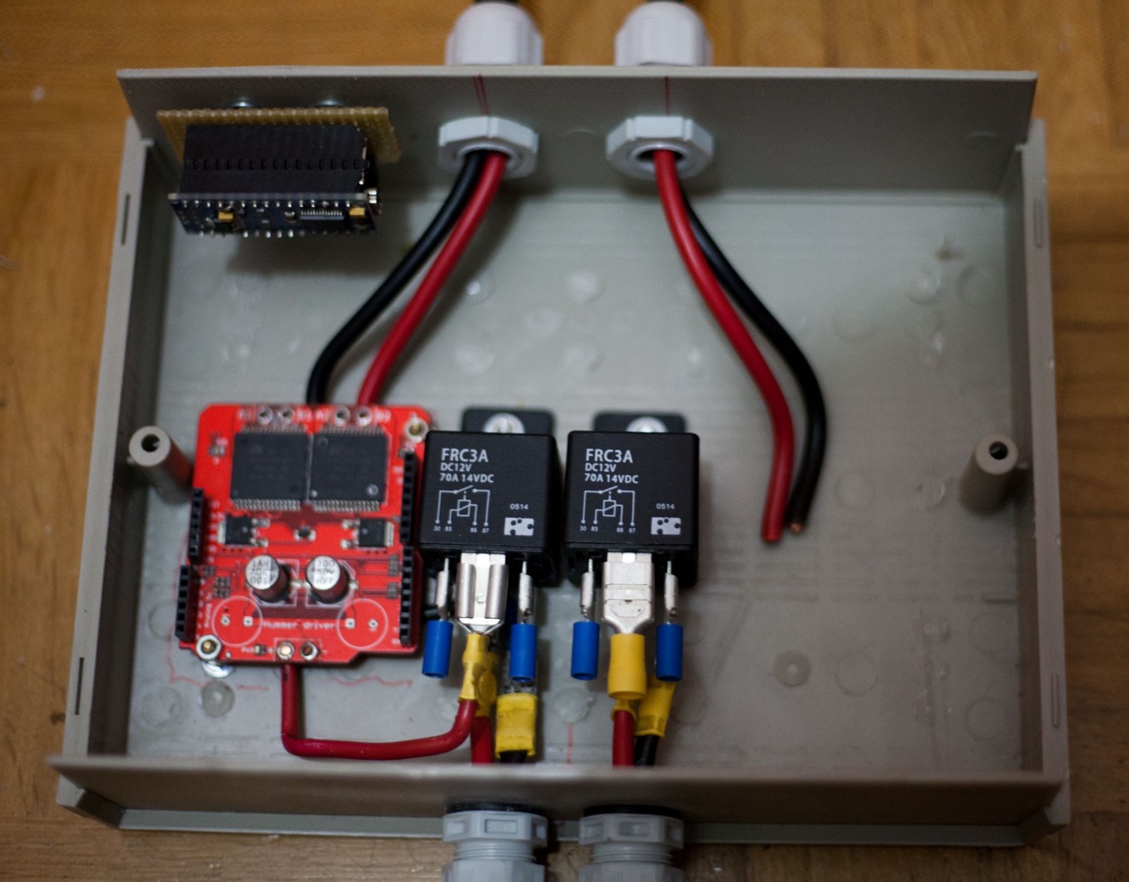

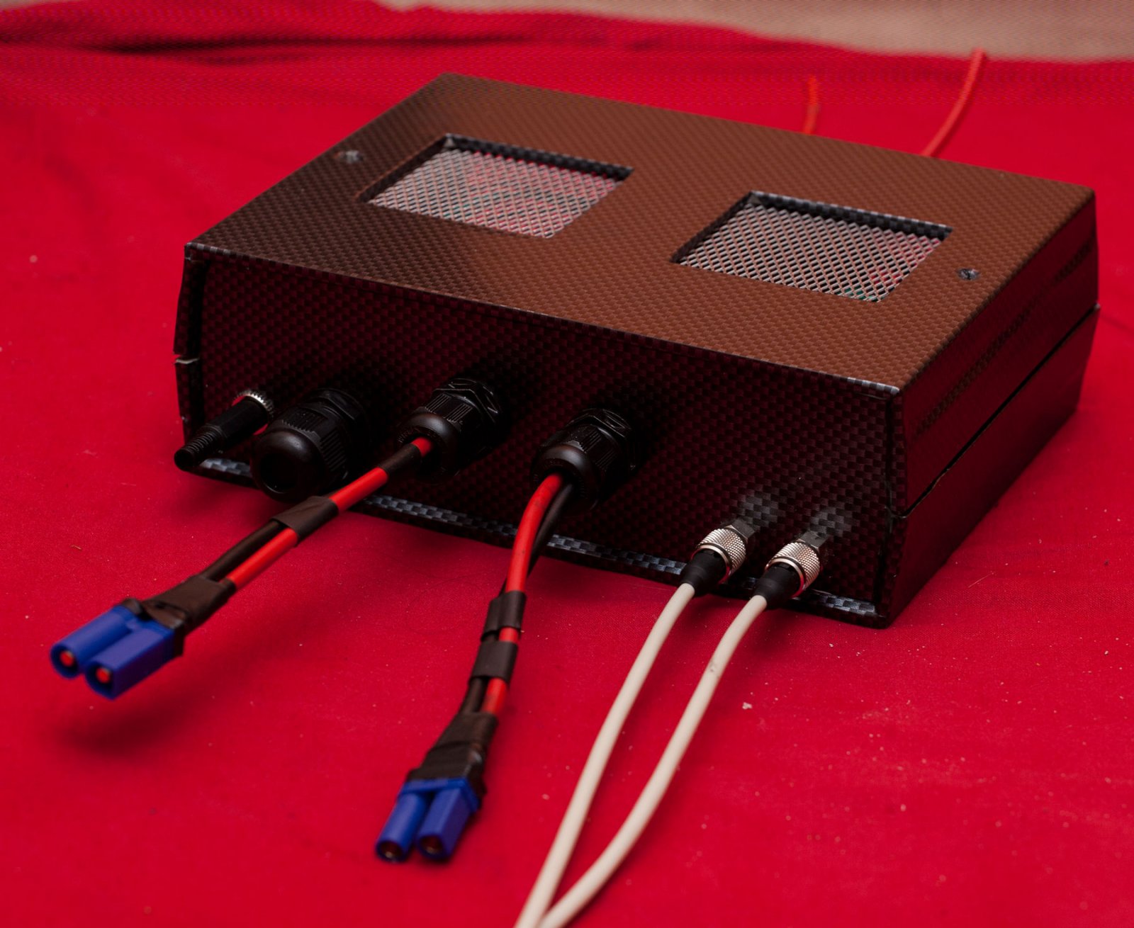

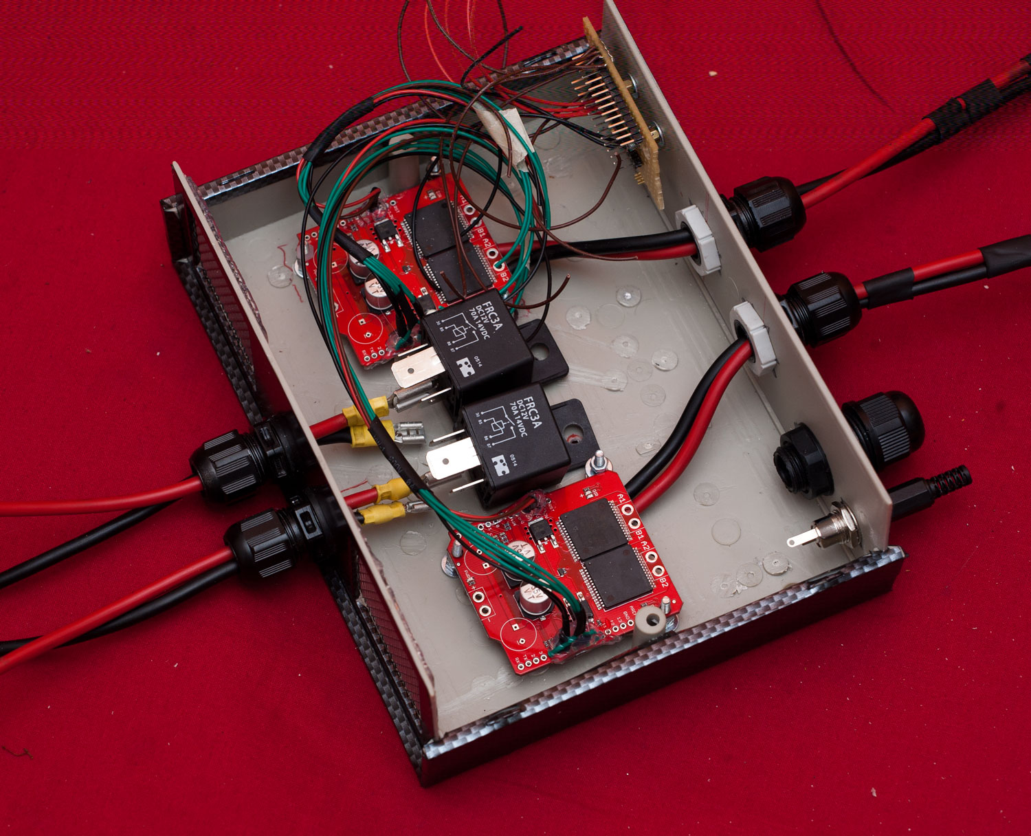

    I soldered the cables with a higher wattage solderin iron and it loks good now.
    Building the electrics did take a little longer as expectet, but i have nearly all parts.
    I finished the housing at weekend and only waiting for some connectos for the inner wires.
    Below are some pictures.
    Sorry for the wireing, but the cabels are not connected now so they are not in place and shortened to length.
    On the second Picture you can see the input power cables which are going to the fuseholder later. On the last Picture you can see the two Motor output cables, two Pot cables, Little Dc Plug for 12v for fans and a plug for usb cable and emergency switch cables.
    I made some openings for the air to come in and out and wrapped it all in some carbon foil. Maybe i need to get some better foil, because this one is very bad.

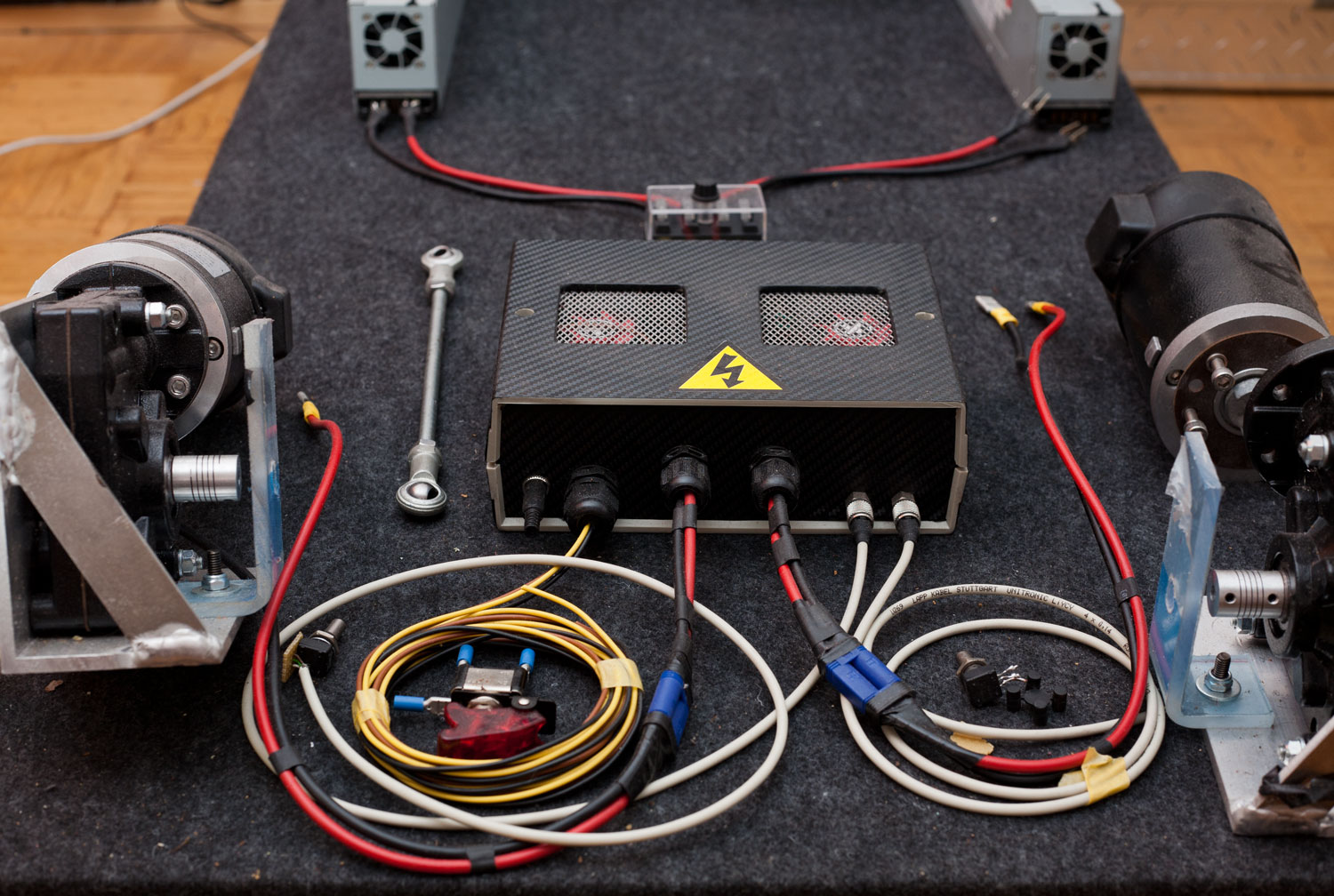

    here are some pictures.
    Nothing is screwed to the platform yet, it's just for get an idea of placing the parts.
    The box is nearly complete. Only the Usbport and powersupply for arduino and fans is missing.
    In the front the killswitch you see is for triggering the Relays and stop the Motors.
    I used shielded cables for the pots.

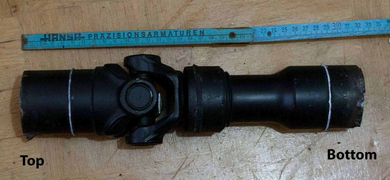

    This week i got some time to make the ujoint new. Like mentioned before in this thread i had id cut wrong last time. Today i removed the baseplate but i was very unshure where to cut.
    Belwo i pastet an image of the actual part. The white lines indicate my cutting lines. After cutting it has an overall length of 23.5mm. I'm afraid to make it to short, and the plate is touching the ground in the front. But i also wan't to make it as short as possible, so there is no ladder needed to get in my sim :)
    Maybe someone can give me an advice?
  17. eaorobbie
    20,503Coins
    +1,687 / 23 / -2
    For the best movements and the less strain on the electronics, you need to place the Knuckle(uni) as close to the base of the chair as possible , Rule of thumb is as close to the CG point of the rig.
    The lower the joint is will cause the sim to have more motion but now becomes a top heavy sim, always wanting to roll over.
  18. noorbeast
    22,048
    153,884Coins
    +11,154 / 57 / -2
    As per @eaorobbie's advice and the FAQs, the universal joint should go as close to the seat base plate COG as possible: www.xsimulator.net/community/faq/universal-joint-placement.108/
    I wanted to add that if it is the wrong way around, near the base, then what you are doing is creating a pivot point that constantly moves the COG as it tilts from the perpendicular in any direction and that puts a huge strain on motors.

    thanks for your usefull Input. I had this problem on my first Simulator where i left the upper part to long and hat the roll over problems like descriped by eaorobbie. Today i cuttet the joint at the white marks. Did you think i net to cut the upper part a little bit more or it is in the acceptable range? Because cutting more will not be so easy because material gets very heavy.
  20. noorbeast
    22,048
    153,884Coins
    +11,154 / 57 / -2
    Cutting it flush with the top white line where the material gets heavy will be fine, and gives strength to the mount joint.
