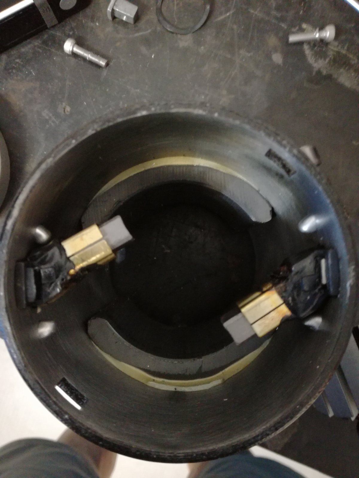

    Hallo !
    Today I had a problem with one of my ZYT90-155-12 MCP4
    One engine was blocked while it was under voltage and overheated. As you can see in the photo, the plastic brush holders went.
    So I need 2 new plastic support.
    Do you know if and where I can find these parts?
    thank you
    Gigi

    Suppliers often carry spares like brushes, who did you purchase yours through?

    I bought them to motioncontrolproducts.uk
    Many suppliers offer brushes but i need holders brushes

    You can generally buy brushes and brushes with plates from suppliers, it is worth making contact with motioncontrolproducts.uk and asking.
