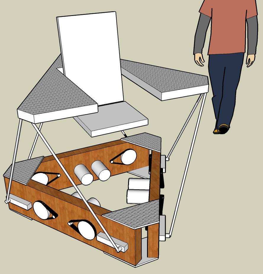

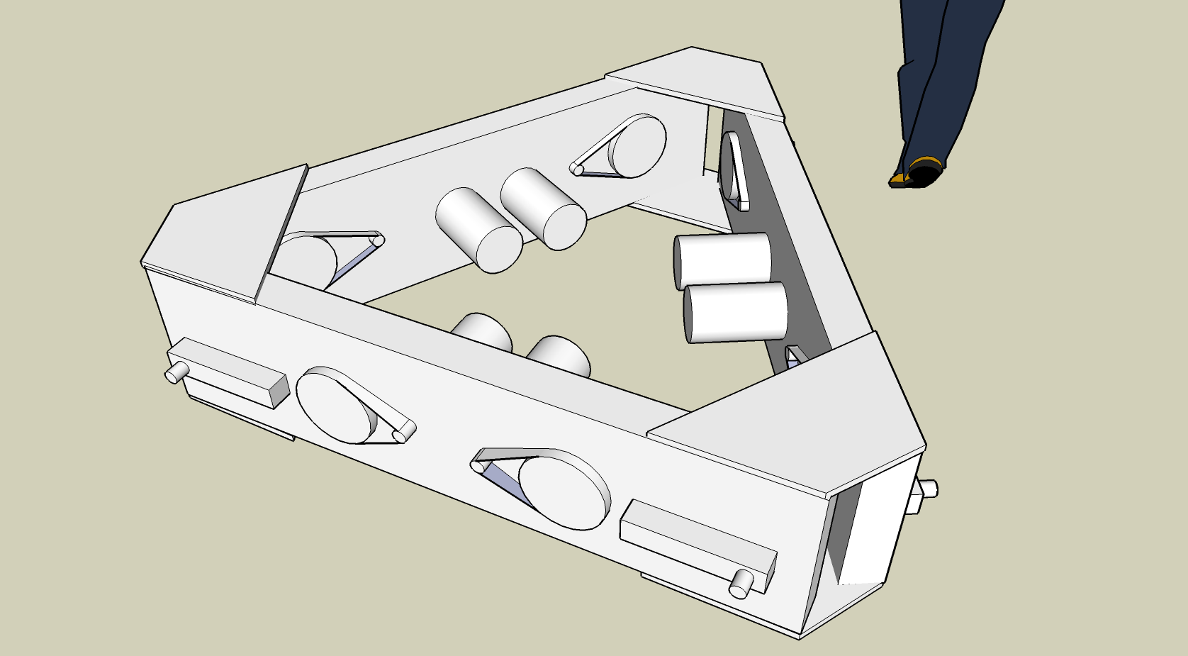

    A simple base could be built out of 6 metal 60deg corner pieces, and wooden boards for the sides.
    And like ego said, belts for the gearing. Something like this:
    What do you guys think?
  2. egoexpress
    egoexpress Active Member
    Dec 13, 2006
    3,839
    Germany - Frankfurt/M
    421Coins
    +10 / 1 / -0
    Re: 1000Watt DC motors for platforms?
    @yobuddy
    nice to read something from you again :)
    Thats a really great idea imho! Are you familiar with this CAD application? Would it be possible for you to draw the entire platform? I really like that design, and it would be great to have it as a completed CAD file. I'd really like to see your CAD construction in our CAD section.
    Theres a question left, that Evan mentioned. The freewheel issue. I cannot say if the motors will hold the platform wheigt even with 60:1 reduction ratio and alloted wheigt to the 6 motors by itself without current. That means it should have to be ensured perhaps, that either the motors get current continiously to hold position, or the controller has to go into braking mode.
    A wormgear drive is the better but more expensive way.
    Would like to know Evans opinion.
    Regards
    Christian
  3. EvanF
    EvanF Member
    Jun 10, 2007
    199
    Multimedia Producer
    New Zealand
    423Coins
    Hi all,
    Yes I agree that is a start to a good simple design - even I should be able to weld those corners up! :happy:
    I am not sure if belts are the way to go for this design though unless they are toothed.
    Freewheel would most certainly be an issue and if gearheads were to be used electromechanical braking would probably need to be addressed. Fortunately these are supplied with motors salvaged from wheelchairs and mobility scooters, but they are slow to release braking.
    I have not had much joy locking my motors to a static point using PWM control without unwelcome jitter. I don't think even with higher resolution angle encoders I could remove all jitter to a smooth ripple. The mechanics of the rotor and brushes means the motor must move slightly to switch to the next coil. You would need amazing feedback to balance current on one coil and then also cater for different weights too... way beyond my DIY skills, and hence the assist central spring on my 3DOF platform.
    I would love to use my gearheads as they are quick but yet I still perservere with my linear actuator design. Simply because they don't have a freewheel issue.
    My gearheads are excellent for FPS because in FPS the movements aren't really position critical like they are in carsim or flightsim. The freewheel in FPS case actually assists in slow return washout.
    EvanF

  5. yobuddy
    5,375
    50,304Coins
    +5,149 / 18 / -0
    @ego – I was just playing with Google sketch-up, since its free. But as you can probably tell, I’m not very good at it.
    Also, I like the idea of a force dynamics like chair above the 6DOF platform rather than just a flat platform.
    I believe the chair idea creates a better center of gravity than a flat platform. But makes it really hard to draw – lol
    I thought that these motors are permanent magnet?
    If we can find a holding force on the motors, we should be able to figure out if they will free wheel or not.
    I would think that with 6 dc motors all greared 60:1 there should be some decent holding force.
    But maybe we need one motor too do some testing on.
  6. EvanF
    EvanF Member
    Jun 10, 2007
    199
    Multimedia Producer
    New Zealand
    423Coins
    @yobuddy
    Permanent magnet motors still require electromagnetic force to propel them otherwise you would have perpetual motion! :yes:
    I thought the same on my 3DOF and certainly with the spring assist there is some holding force, until a 200KG person sat on it and the spring sunk more. (A nut to manually adjust the spring tension is handy.) But the issue comes in when not all 3 cranks are of equal angle, ie: when the chair is angled one way more than the other, balance is out and weight is not evenly distributed. Without enough power to hold them the motors with more weight on them then spin backwards due to the extra weight and gravity. You have to consider power flowing back into your H-Bridges at this point due to the motors acting like generators.
    @christian
    Yes including worm gears in the design would be cool but would slow the impressive speed of the crank motor concept. If I were to go down this track and make a 6DOF I would mod more linear actuators for it as they seem ideal for simming.
    EvanF

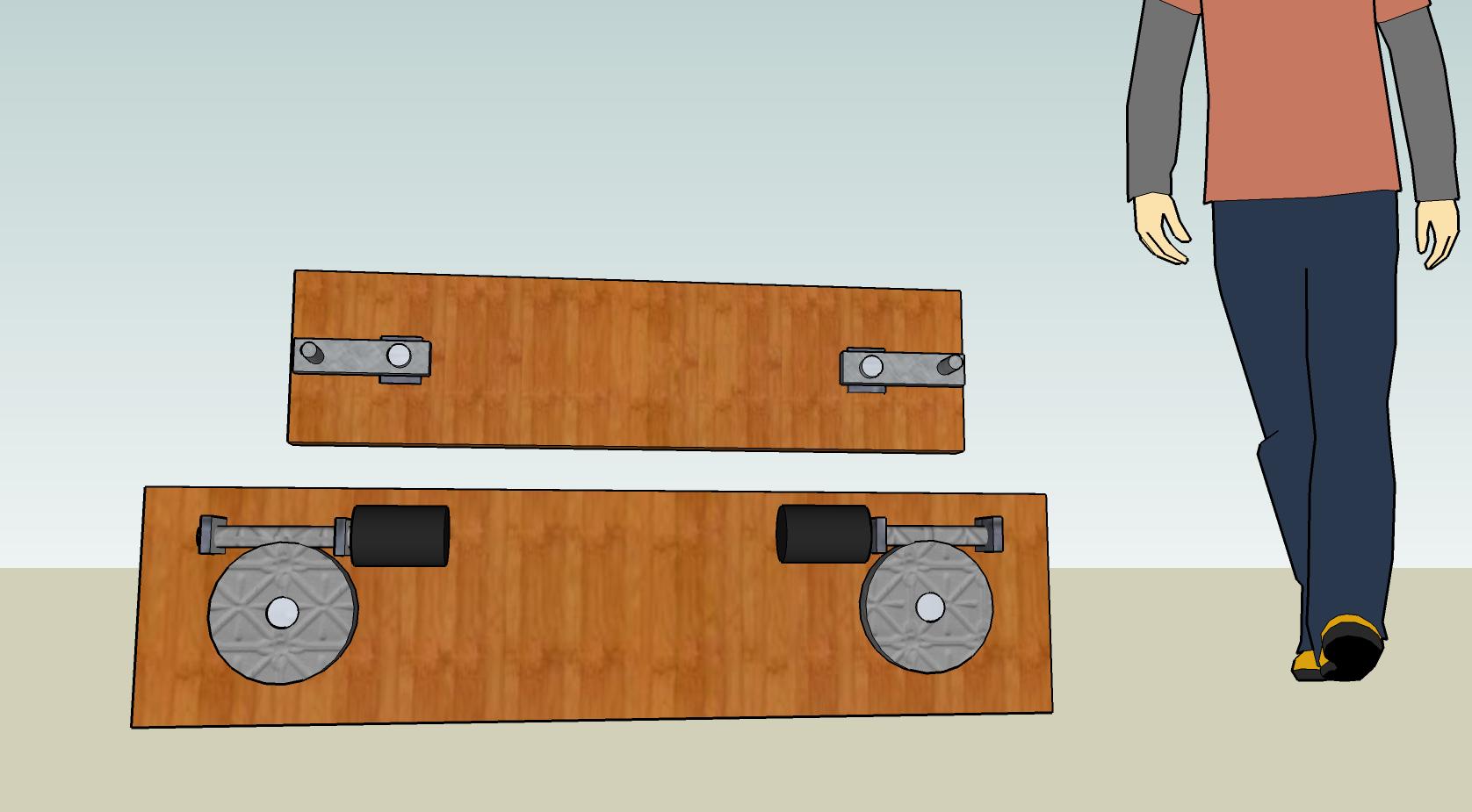

  7. yobuddy
    5,375
    50,304Coins
    +5,149 / 18 / -0
    Just for fun-

  10. egoexpress
    Dec 13, 2006
    3,839
    421Coins
    +10 / 1 / -0
    @yobuddy
    I like its simlicity much! I hope we can get rid of the freewheel issue in your concept.
    Regards
    Christian

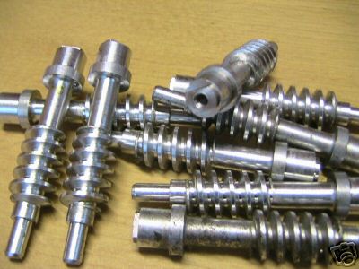

  13. yobuddy
    5,375
    50,304Coins
    +5,149 / 18 / -0
    Here is another possible solution.
    Anyone know where we could get heavy duty worm gears?

  14. tronicgr
    tronicgr
    Hi Yobuddy,
    I don't think that such open worm heads will work. At least not for long before they start to wear as they will lack lubrication!!!
    As I said to Evan, I will develop an analog decoder for optical encoders. Its easy to add an ADC input on those to calibrate the encoder in center position when its powered up. But Evan's idea to use limit switches for the calibration is also attractive idea...
    Keep up this great CAD drawings! They are cool!
    Regards, Thanos

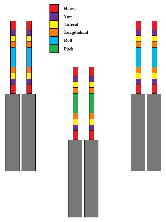

  18. yobuddy
    5,375
    50,304Coins
    +5,149 / 18 / -0
    I’m trying to figure out how the actuators would get assigned for a six degree simulator.
    Currently we have two methods:
    Normal – one axis per degree of freedom.
    FREX like – two motors that work together – both motors are restricted to ½ of the available movement. (½ for Roll, ½ for pitch)
    6DOF - ?
    While I know my bad picture is NOT right, I just wanted to show my dilemma.
    Viewing from behind sim
    If anyone can be of some help, it would be greatly appreciated.
  19. tronicgr
    tronicgr
    Hi Yobuddy,
    No your thinking is wrong. Same applies to the schematic you have draw...
    Just take for example the simple pitch - roll motions... To produce a roll motion all motors must cooperate together to lean on one side without resulting changing the pitch of the platform. Same thing happens to the pitch... When you want to pitch forward, all motors must cooperate to produce the pitch action without resulting in unwanted roll motion...!
    Same applies to the heave effect! All motors must also cooperate to uplift on down lift the platform while keeping it level! Now consider this... Say that you have the platform rolled to 45 degrees to one side, and you want to perform heave motion... Guess what! The half motors are in up position and other half in down position with no space left for heave motion. So in this case the only thing you can do is to limit the pitch - roll motion to, say, 25degrees and have the rest motor travel, free for the heave motion that must be done in cooperated motion of the motors to keep the original 25 degree bank!!!
    The motion is getting more complex when you want to perform also yaw motion since it will also need some of motor travel reserved, so the final pitch-roll motion limitation can go down to 15-20degrees!!!!
    And there are also other motions that can be performed in certain situations that can end up extending only one of the motors!!! I that case you can have strange positioning effect that can be used for example when you want to simulate the drifting of the rear end of a car!
    The best you can do is to make a small (hand moved) platform to see that effect have various positions of the platform to the motors-actuators extending. This is called inverse - kinematics!
    Regards, Thanos

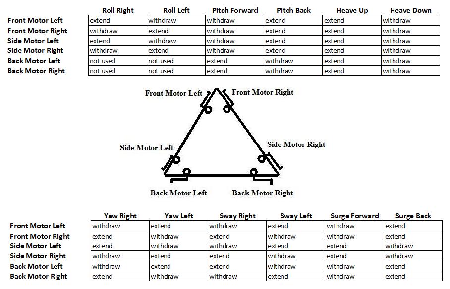

  20. yobuddy
    5,375
    50,304Coins
    +5,149 / 18 / -0
    Ok, so I finally got some time to play with this a bit. I have put together a truth table for a 6dof simulator. I would check my finding again but my wife thru away my cardboard, plastic drinking straw and toothpick model thinking it was trash. :uups:
    The conclusion I make from the data collected is that a 6dof simulator with modest specification, like the ones listed below, would need at least a 325mm arm (lever) for all of the forces to be able to max out.
    Roll 150mm (+- 75mm)
    Pitch 150mm (+- 75mm)
    Heave 125mm (+- 62.5mm)
    Yaw 75mm (+- 37.5mm)
    Sway 75mm (+- 37.5mm)
    Surge 75mm (+- 37.5mm)
    = (650mm total travel needed)
