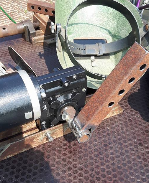

    The motors are china stuff, got a deal through alibaba.com for 100$ per motor (i have some other projects where i need the same motor also). I have attached the datasheet to this reply.
    Here are the motors with the levers which should be sufficient for a prototype i hope:
    upload_2016-7-27_10-53-23.png [​IMG]

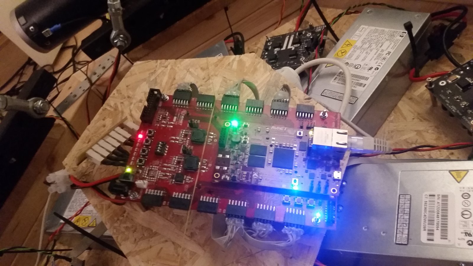

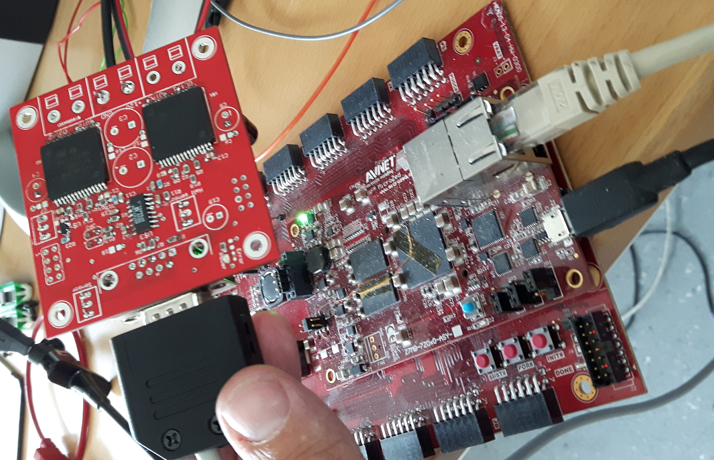

    All digital tests are done on the motor controller board, and now its time for load and thermal testing. Mounting the position sensor is bugging me.......
    Here are the first version of the motor controller (32$ for 15 PCB´s using 3pcb.com and components are bougth from farnell, total cost per board is around 20$ (not including the time it takes to solder it ;). Below the motor controller are the main processing unit which controls all the motor drivers and interfaces to the PC using ethernet.

    What are the specs of the motor controller and main processing unit? It would be really interesting for the community (for me for sure!) to know if you will share the design or maybe do some at a price for members interested in doing 6dof units.

    I will share all files and design files once i get to a point where it is "finished".

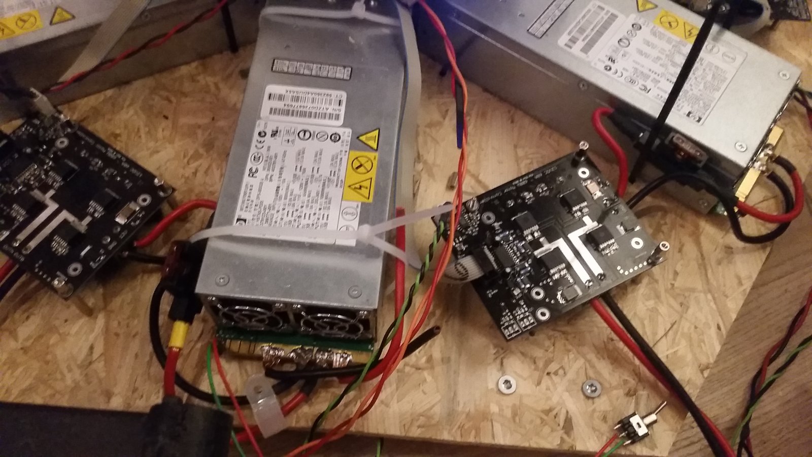

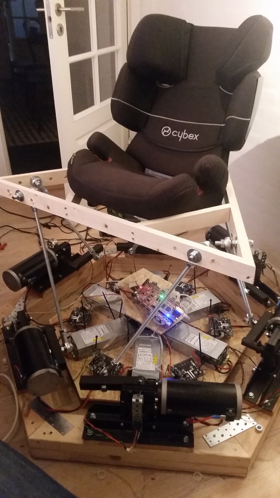

    soooooooooo, long time since last update. I finally allocated some more time for this project and so far i have assembled most of the machine and setup the 6 axis settings in Simtools. I still need to tweak the settings as well as the speed of the motor control. I scared off my son (3 years old) when he tried to sit in his childseat and i was moving the platform around :) And i still need to make a decent platform, but thats gona be the project for the next month.
    I dropped the integrated motorcontroller used by MM 'vnh2sp30', and made my own h-bridge with some good FETs handling 180A contionous and +800A peak currents ( IPB180N04S4-H0), so far they are doing well. I have a small issue where the regenerative power from the motor is pushing the supply voltage too high. To solve this i will first try to add a 33mF cap or else i have to go with a braking resistor solution.

    [QUOTE="How much did they cost you to make ?[/QUOTE]
    I havent got the total cost per board yet, the FETs where 1,5£ each (4 on each board) and the HIP4081 was the most expensive at 3£ each (1 on each board). The PCB itself i got from 3pcb.com to about 2£ each with extra copper. But that is nothing compared to the time spent soldering and making all the wirering ;)
