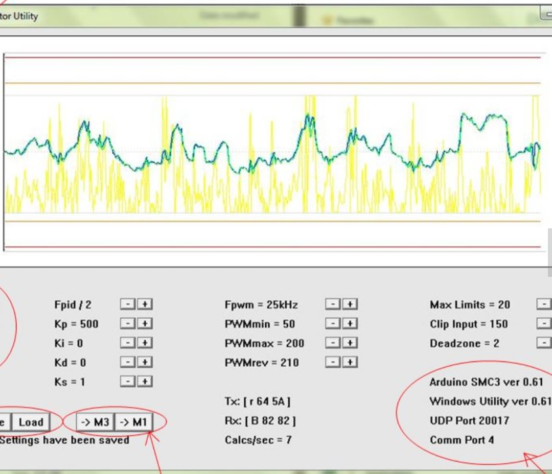

    Hi what that is mean when yellow signal on smc3 is spiky even when motor not moving?

    You have electrical interference or an unstable supply voltage. What potentiometers do you use ?

    Yes I just want to confirm my predictions. That was power supply thanks
