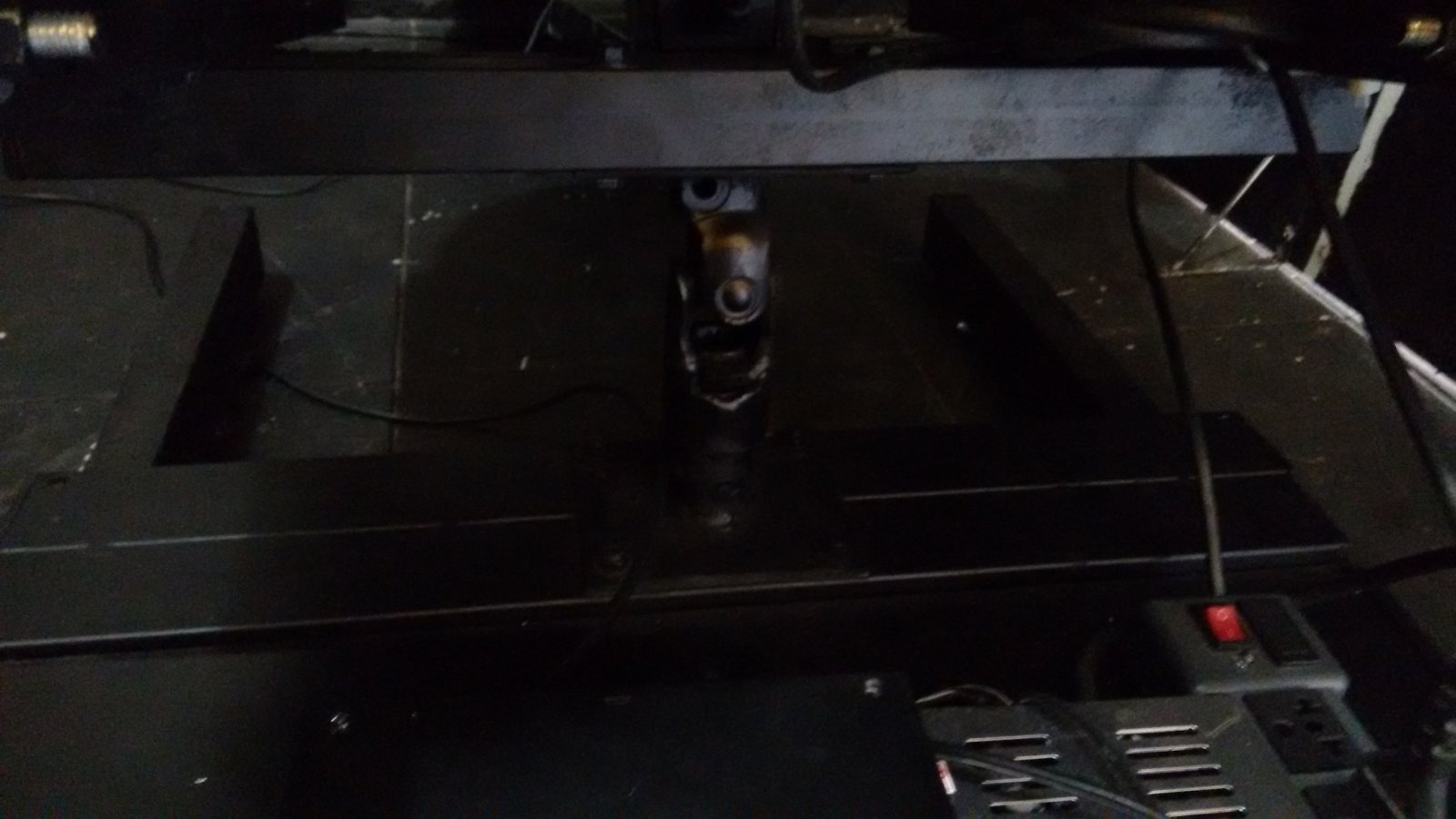

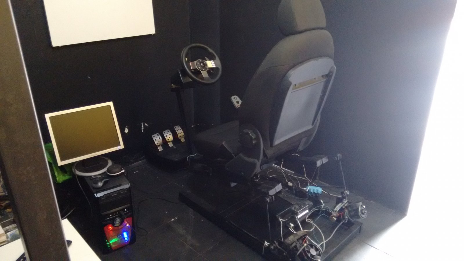

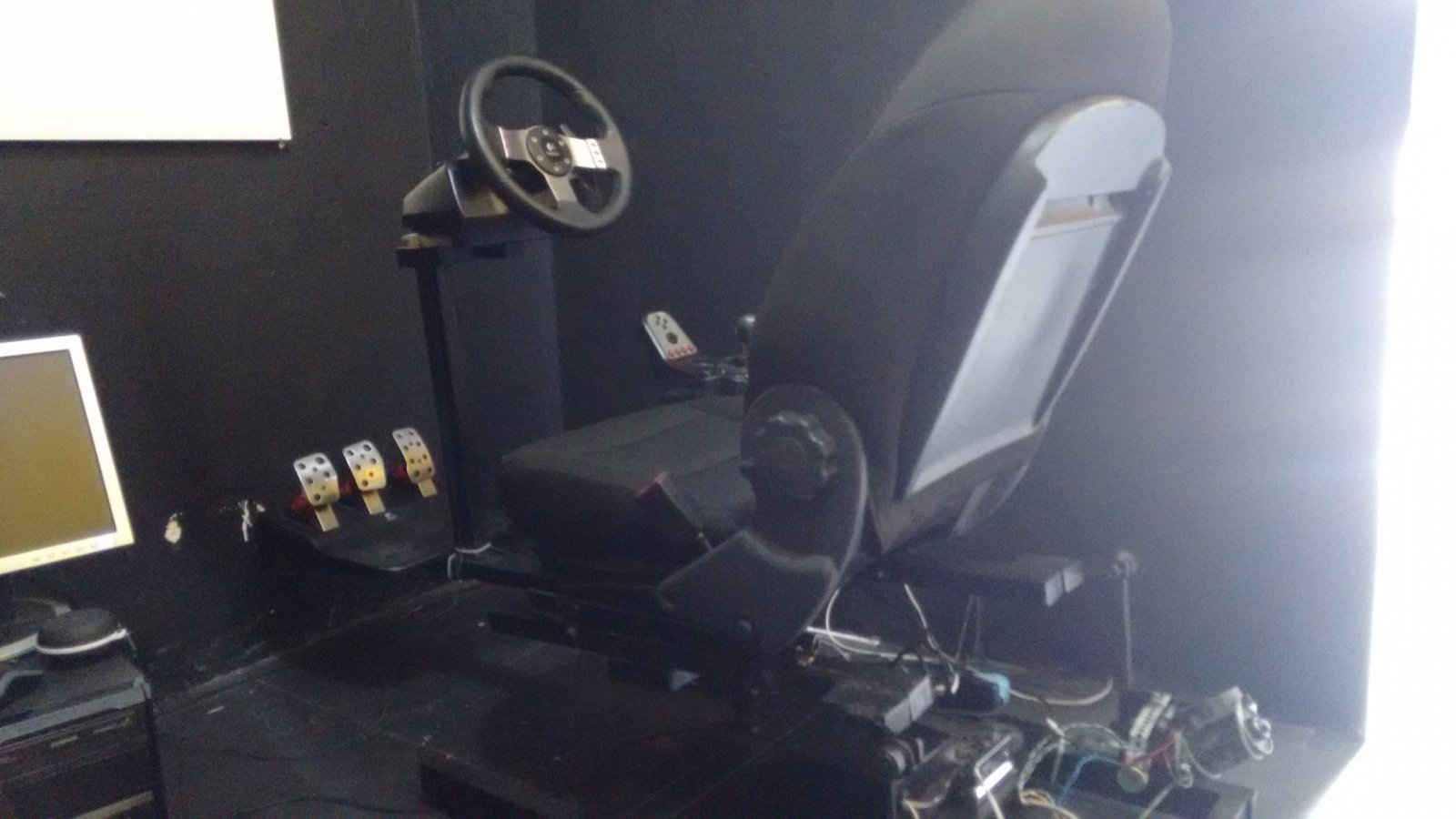

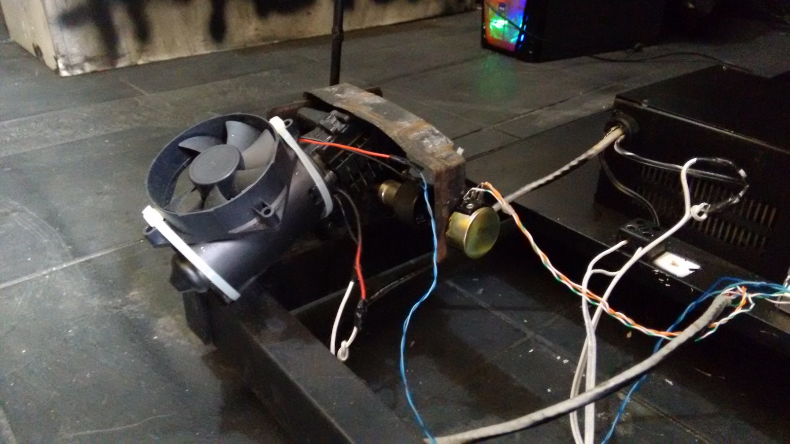

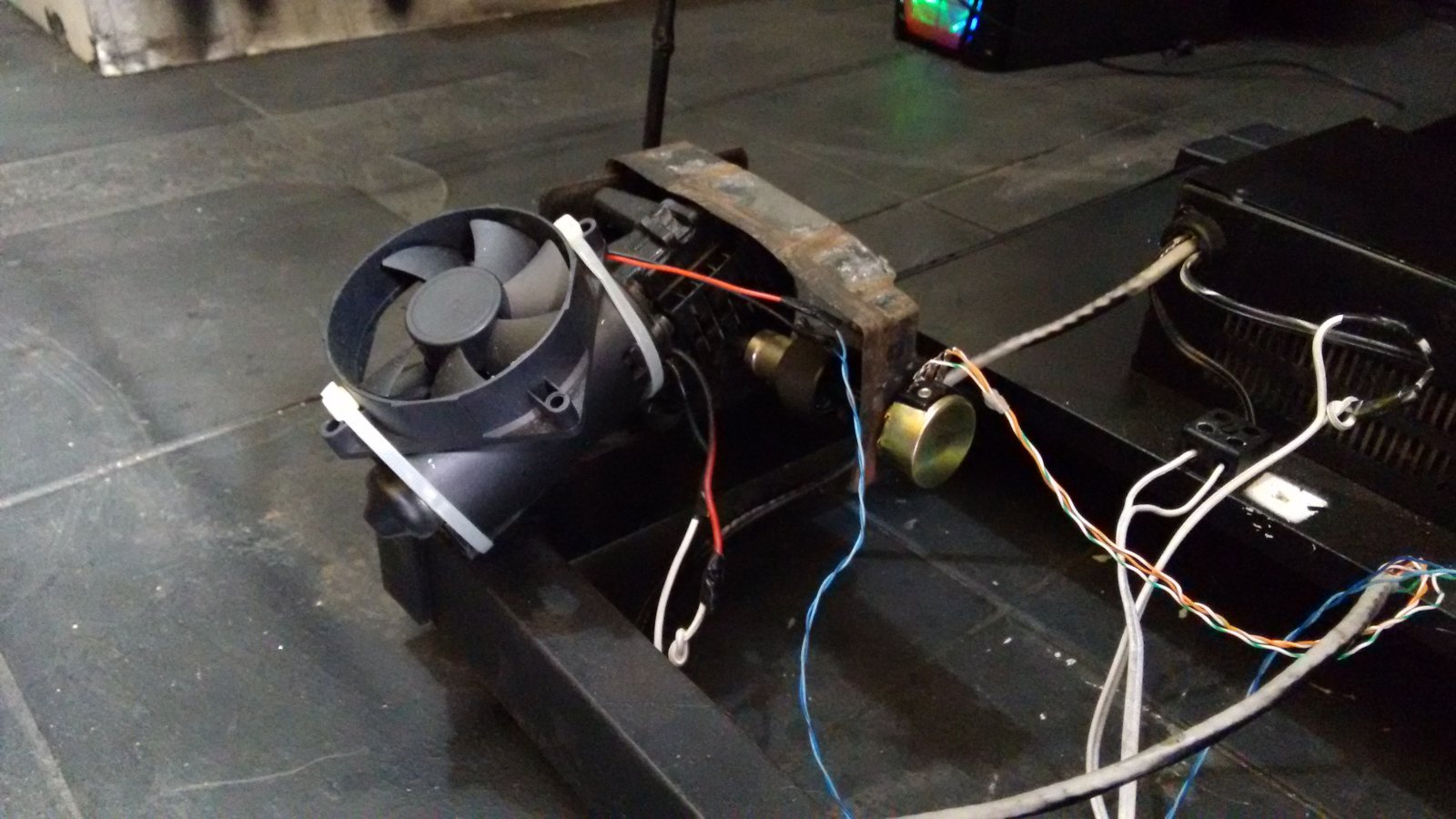

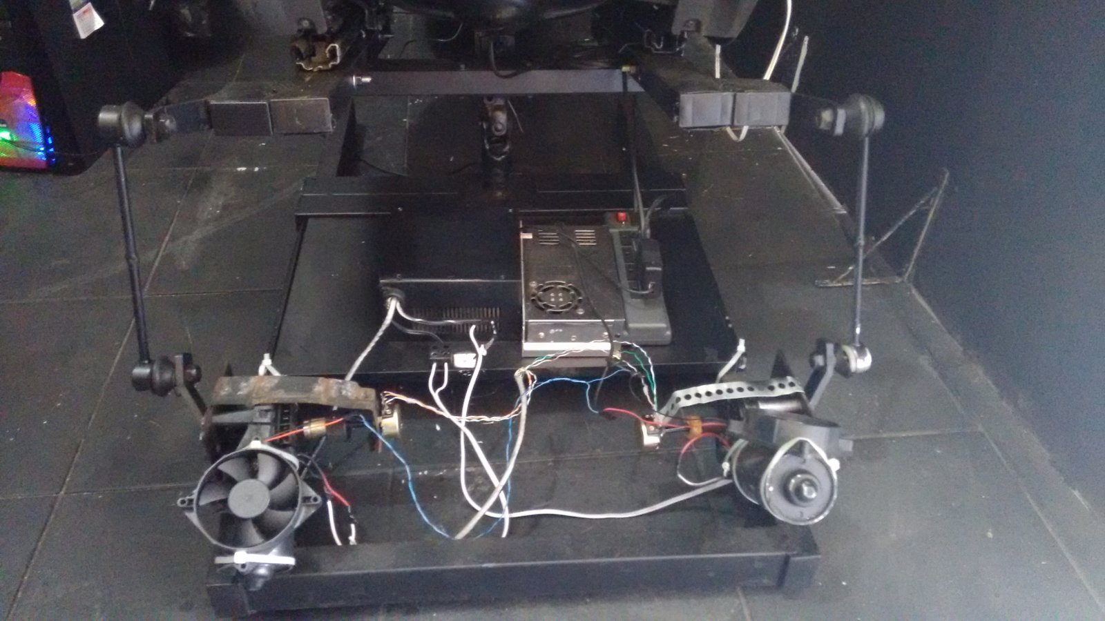

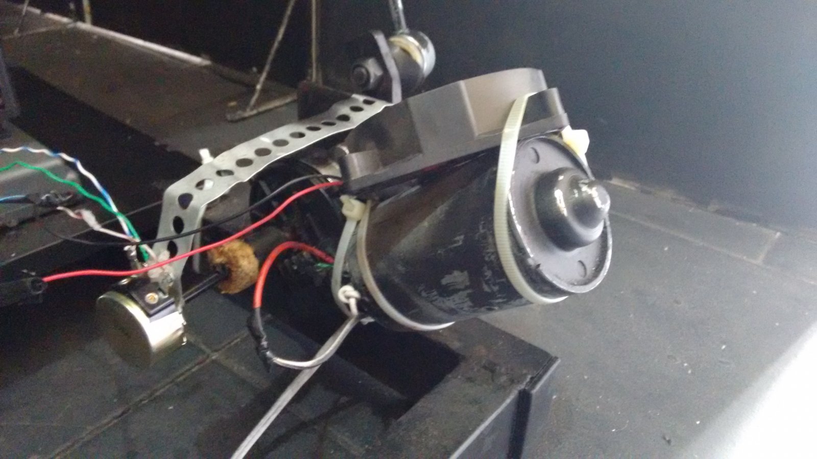

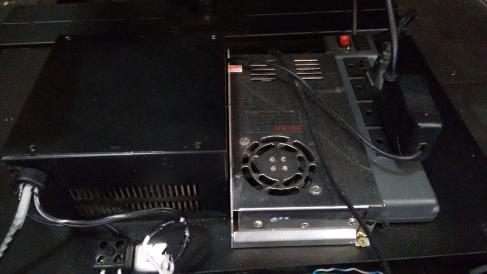

    Young, good afternoon. see if you guys can help me, I also built my simulator and I am with the following problem:
    Everything works fine until I connect my g27, then the computer stops sending data to the Arduino simulator. I'm using SimTools software and a single computer. Already checked the doors and no conflict. Someone had a problem like that?
    Thank you very much in advance !!
