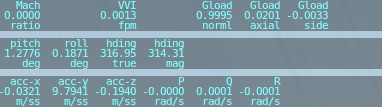

  2. value1
    Jan 9, 2011
    2,184
    Zug, Switzerland
    14,506Coins
    +3,319 / 11 / -1
    It's not that difficult. You can use Gload from the upload_2019-7-13_21-40-41.png dataset or acc- from the upload_2019-7-13_21-41-57.png dataset.
    The data is the same but the UoM is "g" for the first set and "m/s²" for the second. The plugin V2.0.2.0 uses Gloads
    (Gloadₙₒᵣₘₗ and acc-y have a funny +1 g added to simulate earth gravity:think)
  3. hexpod
    hexpod http://heXpod.xyz
    Apr 18, 2016
    1,094
    berlin
    7,099Coins
    +337 / 5 / -0
    DC motor, 6DOF
    Small precision:
    To my understanding the data is not same as it is supposed to use an approximation of the center of rotation.
    Using motion data stats you might have a different mix of forces especially with airliners as Austin is moving the CoR to the cockpit between two seats 1 meter above the cockpit floor.

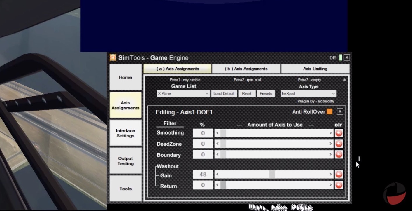

  11. Psionic001
    Psionic001 Active Member Gold Contributor
    Mar 5, 2017
    138
    Sydney
    1,002Coins
    +59 / 1 / -0
    Motion platform, 6DOF
    I have updated to 2.4. But just in case, how do I verify it was a full success?

  13. hexpod
    Apr 18, 2016
    1,094
    berlin
    7,099Coins
    +337 / 5 / -0
    DC motor, 6DOF
    I believe you should see this :
  14. Psionic001
    Mar 5, 2017
    138
    Sydney
    1,002Coins
    +59 / 1 / -0
    Oh woah, ok I'm not seeing that, but my app actually says it's 2.4!!
    My washout return and gain are over 2 seperate lines like in my video...
    I'll do a clean install and see how that goes.

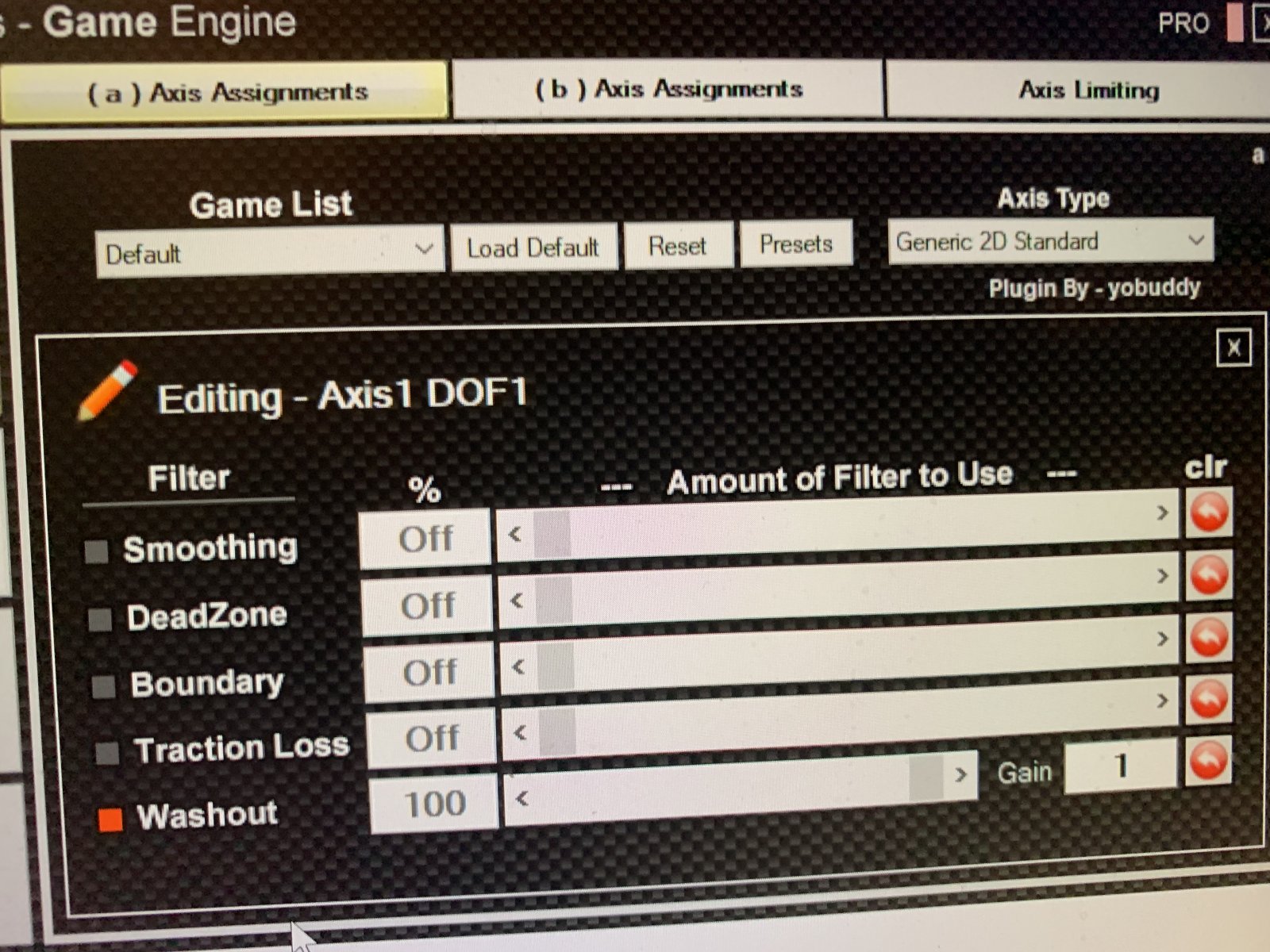

  15. hexpod
    Apr 18, 2016
    1,094
    berlin
    7,099Coins
    +337 / 5 / -0
    DC motor, 6DOF
    Oh I think I see.
    Don’t use heXpod assignment. Go for standard or advanced.
  16. Psionic001
    Mar 5, 2017
    138
    Sydney
    1,002Coins
    +59 / 1 / -0
    Ok so with 2.4 we no longer use the HexPod assignment? Is there an update or do we simply use standard and advanced now?
  17. Psionic001
    Mar 5, 2017
    138
    Sydney
    1,002Coins
    +59 / 1 / -0
    OK. Using "standard" as axis type, I now get the correct interface for washout.

  19. John458
    John458 Member
    Dec 8, 2014
    68
    Retail
    Brisbane
    390Coins
    +25 / 0 / -0
    Hi @value1 and @hexpod
    Just getting Xplane to do its thing... having real trouble with the heave movement.. when the plane is static on the ground.. heave (under virtual axis) shows it sits way to the right as its starting position... how do I get it back into the centre of the axis?
    Any ideas would be much appreciated. Im running simtools 2.4 and standard xplane plugin
  20. hexpod
    Apr 18, 2016
    1,094
    berlin
    7,099Coins
    +337 / 5 / -0
    DC motor, 6DOF
    Apply 100 percent washout on heave.
