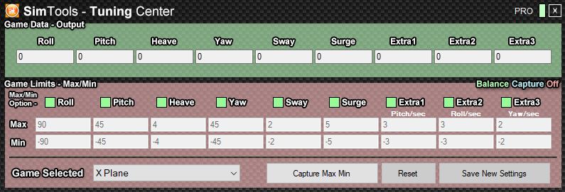

  11. IntrudR
    IntrudR New Member Gold Contributor
    Jun 13, 2018
    9
    123Coins
    Try this profile and set the Tuning Center same to my values. You should notice heave and surge. It is for 3DOF systems like H3/P3 from dofreality.com
    You can unzip it and save under C:\Users\<yourUser>\AppData\Local\SimTools\GameEngine\AxisAssignmentsPresets\Generic2DStandard_Presets\
    Then load the preset under Axis Assignments in Game Engine Tool.
    As lower the values as harder the effect.
    BR
    Fabian

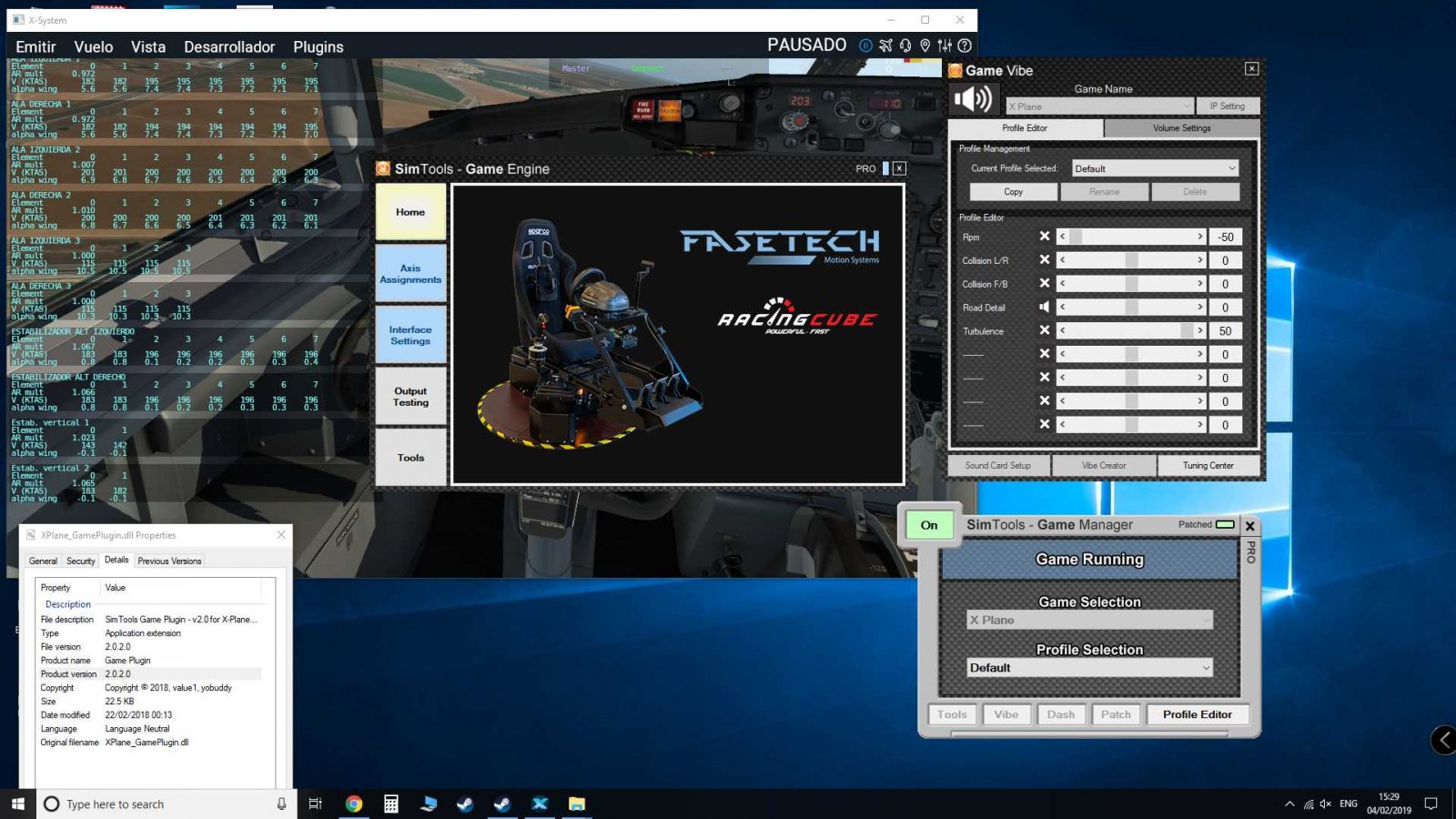

    Hi all
    Im new in the forum and using a 4DOF rig sim from Fasetech since last June.
    Last week I had a look to the Game Vibe addon, I read all the posts, I installed the addon and yesterday I got it running, but I can not get the output in the Profile Editor section of the Game Vibe for the following effects announced here
    https://www.xsimulator.net/community/marketplace/simtools-v2-game-vibe.201/update?update=657
    Missing when trying the Xplane 11 with the latest published plugin the following ones (see snap attached),
    - New Vibe Type: Flaps
    - New Vibe Type: Landing Gear
    - New Vibe Type: Weapons 1 & 2
    Could be that possible cause maybe the latest Xplane plugin has not been modified to reflect these ones? If that would be the case, I would kindly request to @value1 having a look at it :) Pleaseeeeeee hehe
    Thanks in advance!
    Sete
  15. noorbeast
    20,539
    145,052Coins
    +10,776 / 52 / -2
    Thus far only the War Thunder plugin has the upgraded Game Vibe effects implemented. It will just be a question of time for X-Plane, depending on how hectic @value1's life is at the moment.

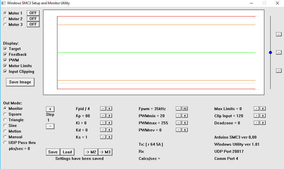

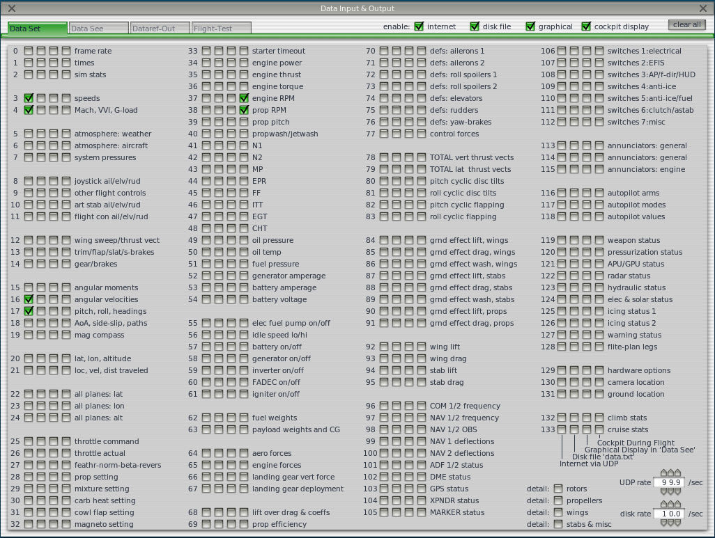

    Hi all,
    I have a 3dof motion platform with a dual computer setup driven by an Arduino Uno board with SMC3. It works FLAWLESSLY with different car simulator programs like Assetto Corsa, Project Cars, etc...
    I perfectly understand how axis assignments, filters or tuning center setup works.
    Still, I have a strange, very "jerky" washout-like behaviour of X-Plane plugin both in X-Plane 10 and 11: I try to setup Pitch and roll (or extra1 and extra2, or even sway and surge) for the motion platform, but the Virtual Axes in Game Engine (Axis1a, Axis2a, Axis3a in the lower, purple area) are constantly trying to go back to zero automatically. They does not align Pitch or Roll (or extra1 and extra2, or sway and surge) Virtual Axes (in the upper, green area in Game Engine's Virtual Axis page)
    A short example for better understanding:
    When I roll the airplane for a turn, let's say 40 degrees to the left, then the "roll" slider in the green area of Virtual Axis page is also moving to the left and stays there until I keep the plane tilted by 40 degrees.
    In the meantime, the corresponding axes in the purple area are also starting to move to the left, but they are coming back to the middle automatically within one second...
    It does the same for pitch.
    The closer the plane to zero degrees roll/pitch attitude the more jerky its movement, but there are no apparent jumps or spikes in the incoming pitch/roll values.
    I HAVE NOT set ANY WASHOUT filter in Axis Assignments menu. Data sending/receiving, SMC3's PID filter setup and Tuning Center values are all seems to be correct.
    Do you guys have any idea???
  18. noorbeast
    20,539
    145,052Coins
    +10,776 / 52 / -2
  19. Greg Meszaros
    Greg Meszaros New Member
    Jan 14, 2019
    6Coins
    I cannot reproduce the above described "washout-like behaviour", so please ignore that part of my previous post!
    I do not have any problem with axis assignments or Tuning Center setup, I can map every needed DOFs to my phisical motor axes very easily and the platform heaves/tilts just like the way I want!
    Except that it does every single move with a random jerky movement in X-Plane 10 and 11. The motors randomly jumps up and down 10-20 % of their movement range, every 1-2 seconds or sometimes more frequently, even if Virtual Axes does not apparently move at all!
    Also tried axis smoothing, but it did not helped on jerkiness at all even on 100%.
    Jumpiness persists even if I set ridiculously large values in Tuning Center in order to make the platform less sensitive to inputs.
    This jumpiness is definetly not an oscillation due to improper PID filter setup. I tried to set Arduino's Proportional Filter in SMC3 utility to some really low values but the only thing it changed that my platform become very weak and sluggish. :)
    Not even a faulty or noisy feedback potentiometer, they are all well-filtered and working precisely without any "crosstalk" noise from motors.
    I tried something tricky with washout filter to achieve the smoothest axis movement I can get:
    I deleted all my previous axis assigments then I only assigned 50% of "roll" to "axis1" and 50% of "roll" to "axis3" as those axes represents my left and right DC motors. I also set their washout filters to 100% gain and 100% return.
    Also set +40 and -40 degrees of roll as a Min/Max values in Tuning Center.
    I started a flight, rolled the airplane 40 degrees to the left, my motion platform also tilted to the left instantaneously as it should, the virtual axis of "roll" (in Game Engine/Virtual Axis page/green area) also moved to its leftmost position and naturaly, axes 1 and 3 (in Game Engine/Virtual Axis page/purple area) also moved left/right to their -50% / +50% position. Everything seems all right until this moment.
    Then I suddenly paused the simulation, and watched as washout filter slowly and veeery smoothly started to move axes 1 and 3 back to zero from their left/right position.
    Guess what happend: the motion platform followed this movement slowly but with big jumps, sometimes jumped to the left, sometimes to the right randomly....
    Since simulation was paused, it simply could not caused by any surge of input values due to the fact that washout filter is a purely mathematical algorithm that provides the smoothest transition between the original left/right position and zero position of axes.
    The platform works very precisely and smoothly with any other simulator program I use. I am perfectly clueless. Maybe is it some kind of communication / baud rate related issue between Game Engine and Arduino?
    I hope my description is understandable since I am not a native English speaker...
