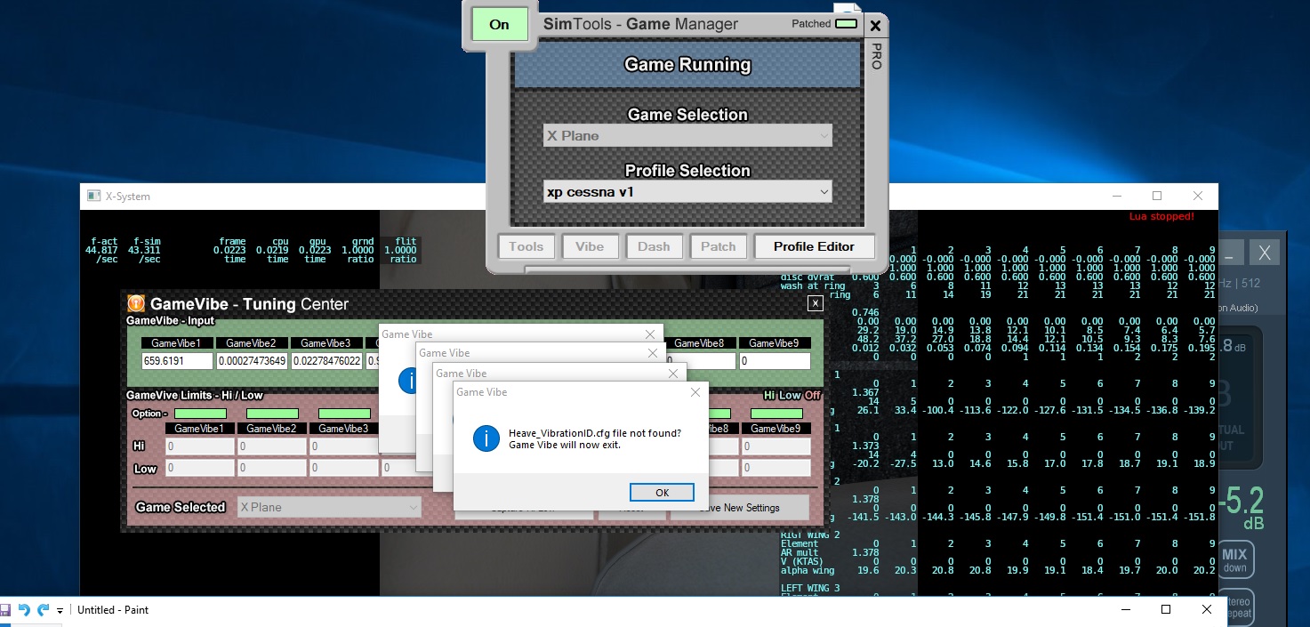

    I am getting the attached error in Xplane 11 when using Game Vibe. It appears as soon as I click the Game Vibe icon to configure when the game is running. The error is Heave_VibrationID.cfg file not found. Game Vibe will now exit. Game vibe exits and every time I restart I get the same error. There is however some RPM sound coming through the bass shaker so appears to be running in the back ground just cannot configure it at all. I have tried re installing the plugin and movement itself is working fine. Thanks

    Can anyone confirm they have Game Vibe working with Xplane 11? It would help to see if the error above is a plugin issue or a config error on my end as I cannot get it to work so far. Thanks.

    I'll 'check. There's maybe a flaw in the plugin.

    I will try tonight and let you know outcome. Thanks @value1
  17. Lol4
    Lol4 Member
    Aug 28, 2017
    83
    Australia
    - 115Coins
    +54 / 0 / -0

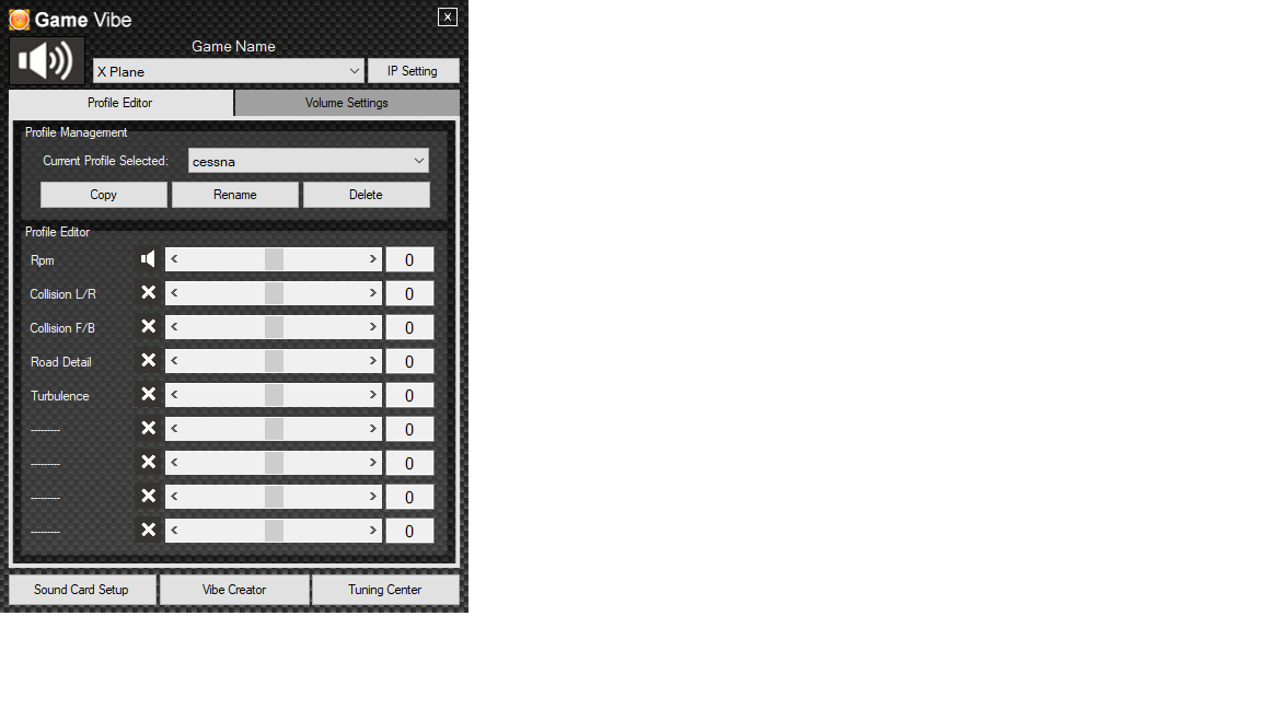

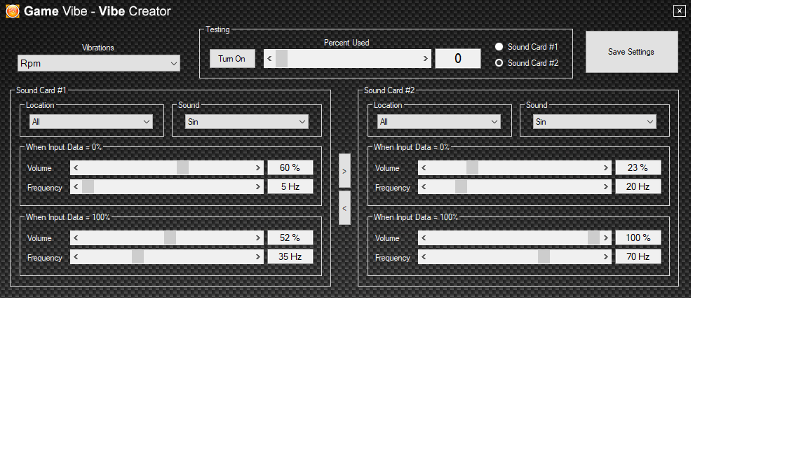

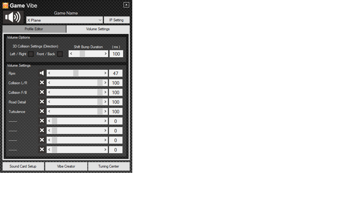

    Working perfectly with two sound cards. Awesome work. Thanks.
    My settings mainly for the cessna in XP11.
