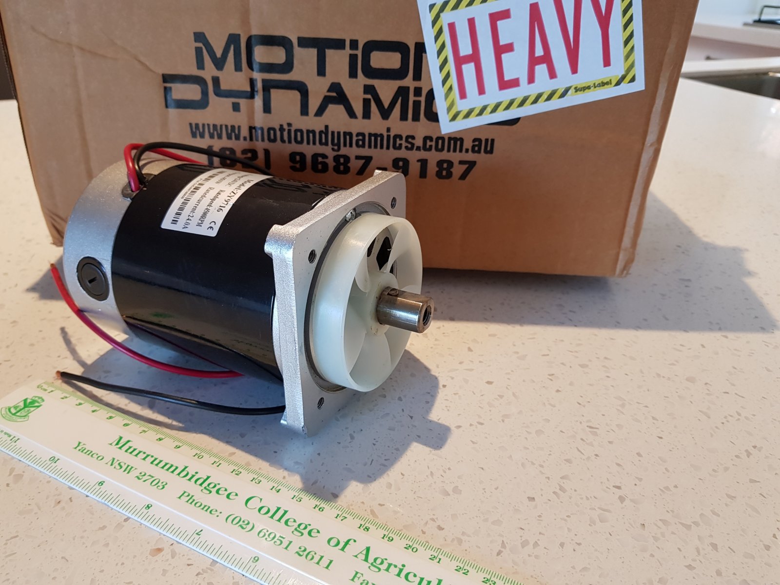

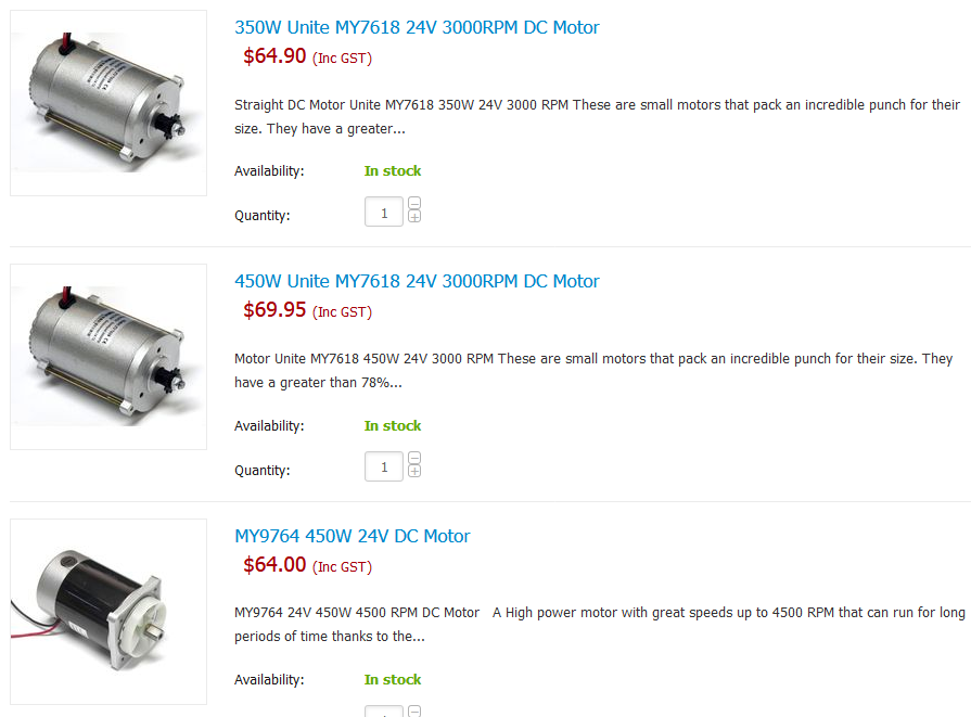

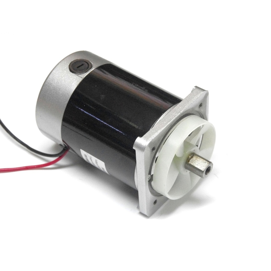

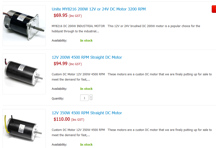

    OK first fork in the road. I have been clear in my mind up until now to use 12V DC motors between 3000-4000rpm and 200-350W. @SilentChill said in Pierre's build that if he had the time over he would use 24V motors because they use less current.
    I am going to get my motors from Motion Dynamics in NSW to keep the postage low and they have a quite a few candidates that would suit the platform:
    What would you recommend?
  3. SilentChill
    2,645
    20,593Coins
    +3,570 / 34 / -0

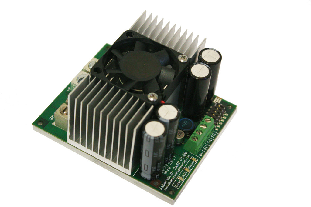

    The 450w 24v motors will be upto the job if you want to go that route they care slightly slower at 3000rpm however @Grigory built a 6dof here using that speed motor which works well and seems to be able to cope with lifting a pretty heavy platform.
    As for controllers I have no experience with thanos @SeatTime used one for a bit maybe he has some input.
    Using 3 arduinos are nearly as good, cheaper and a lot of people using them here there is a lot more in the way of support with simtoools.

    Thanks @SilentChill, I value your advice and experience.
    Tomorrow I will order:
    6 x MY9764
    3 x Sabertooth 2x60
    3 x Arduino Uno
    I only have few days left of my holiday and I want to get the orders off as there is a long lead time to Aus. When they arrive, I will take a photo of the packages - that seems to be the tradition :p

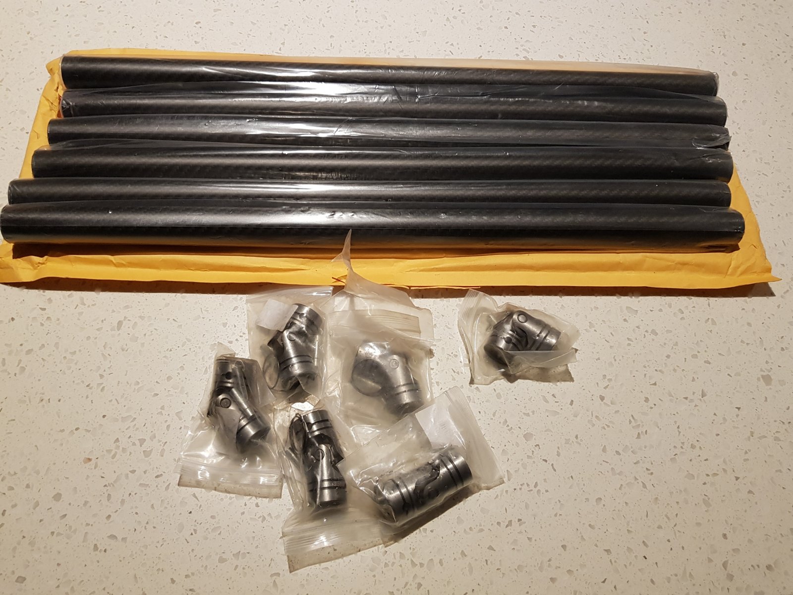

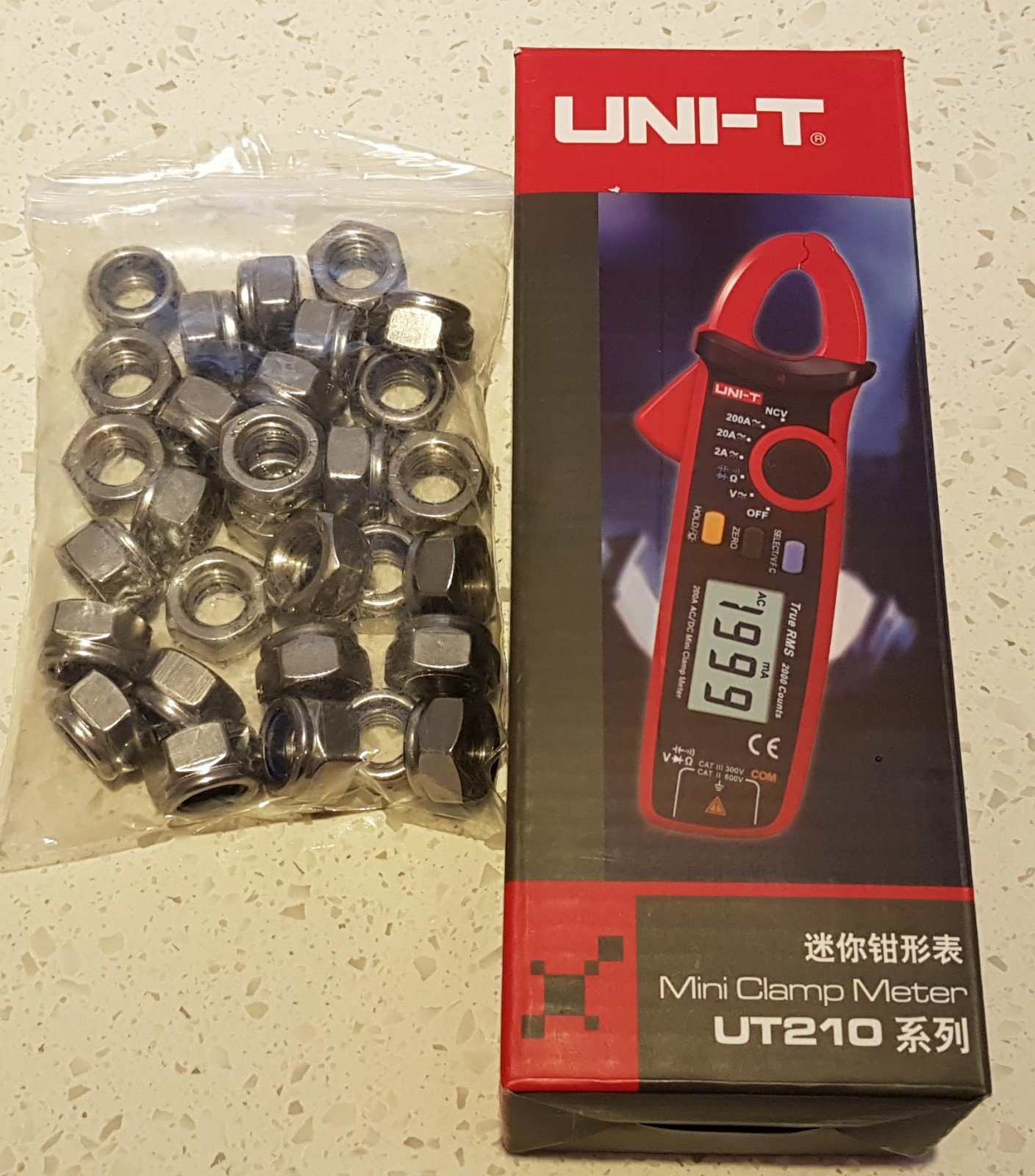

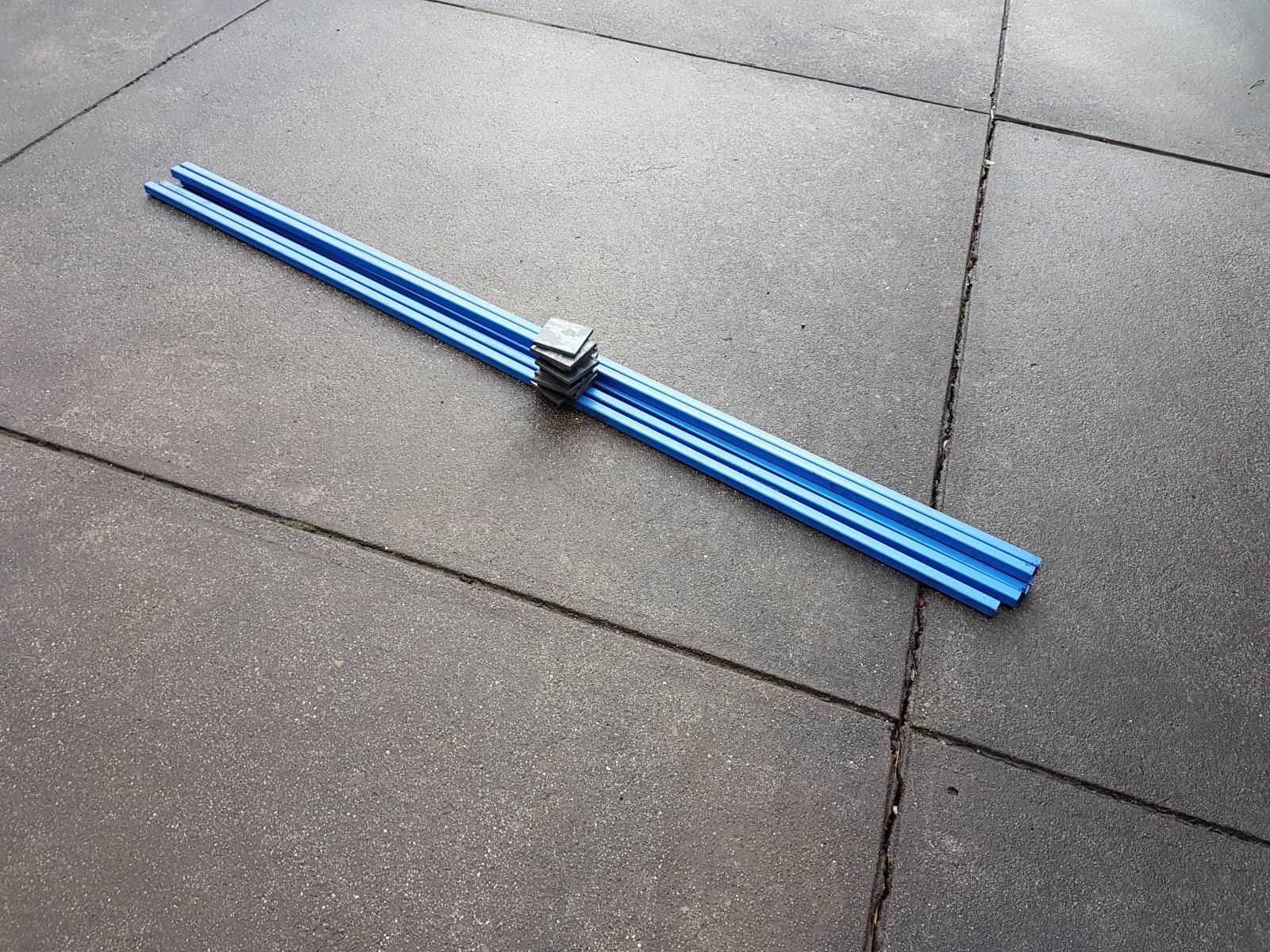

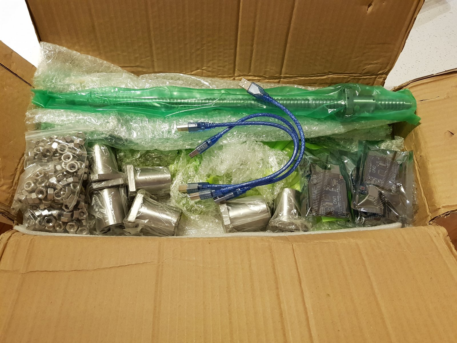

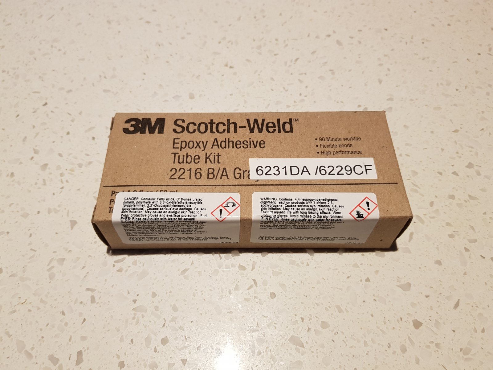

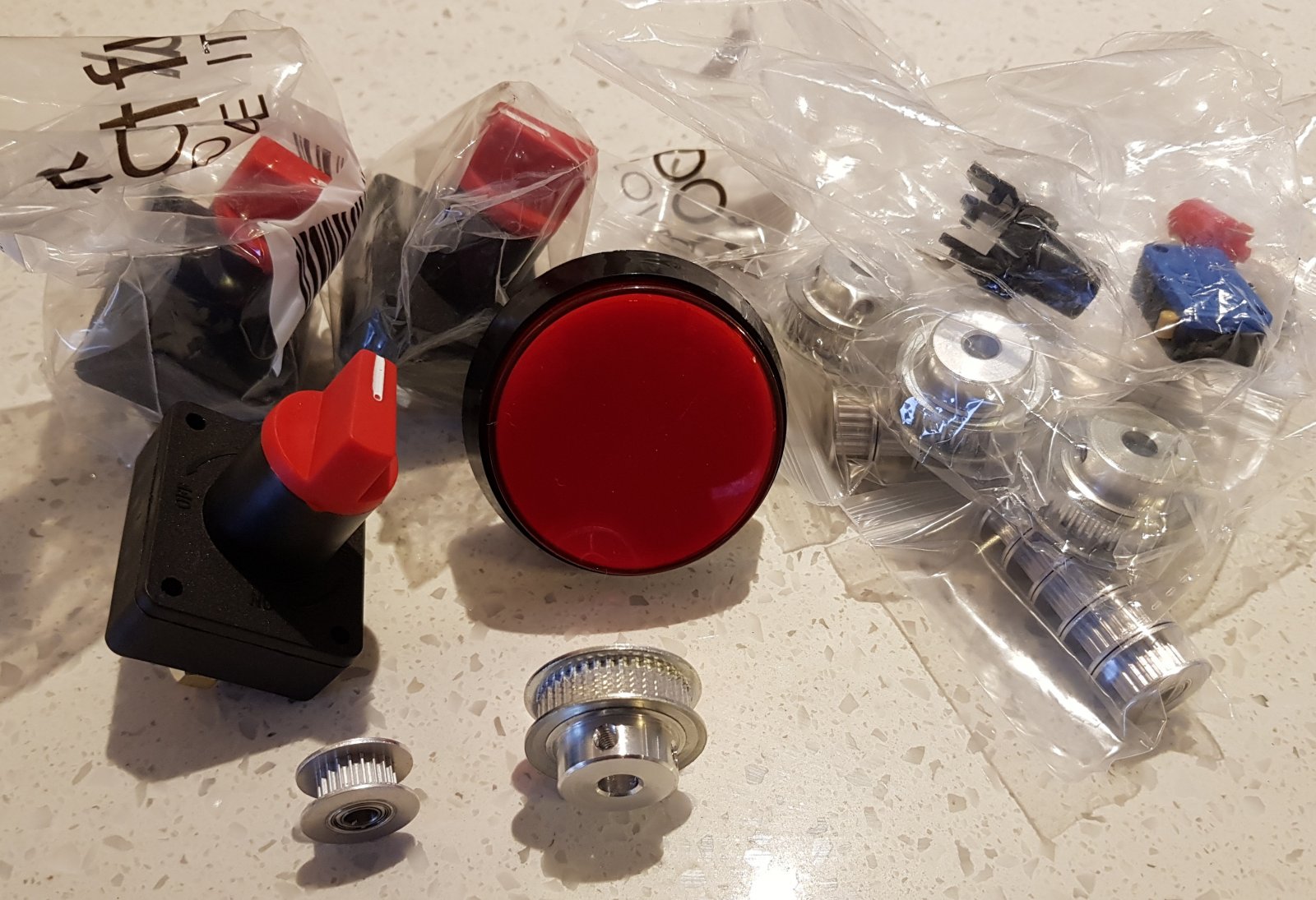

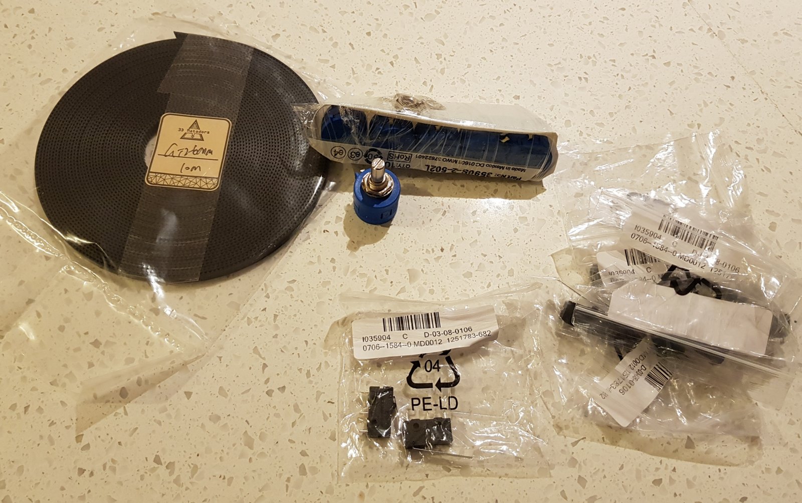

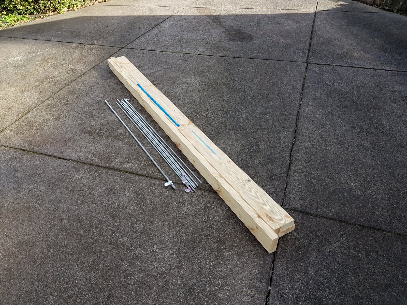

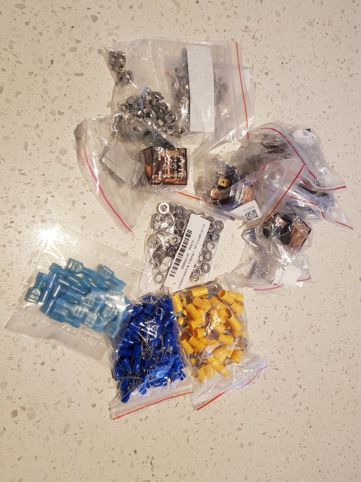

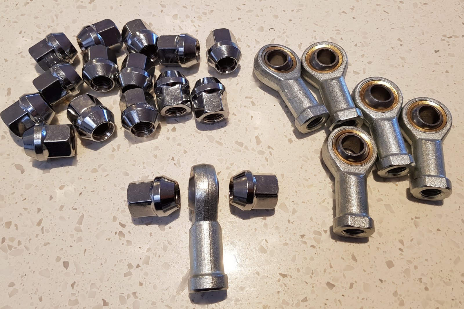

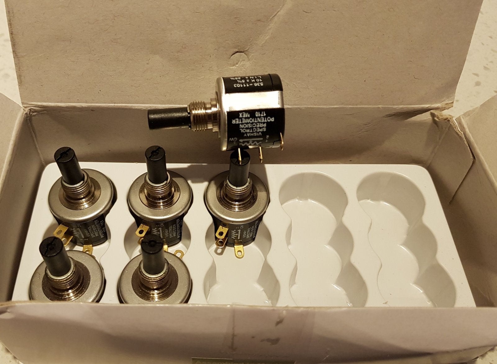

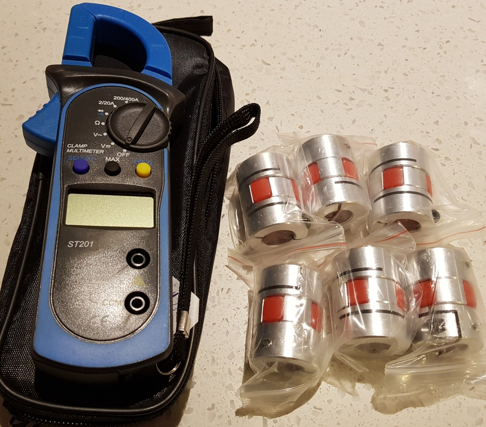

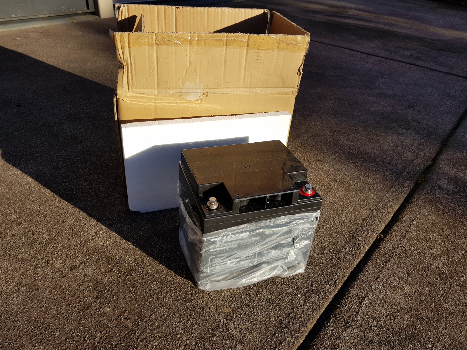

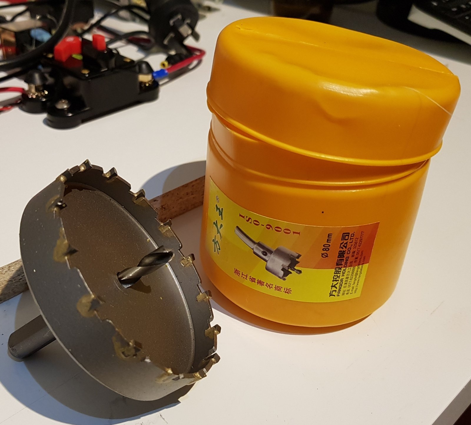

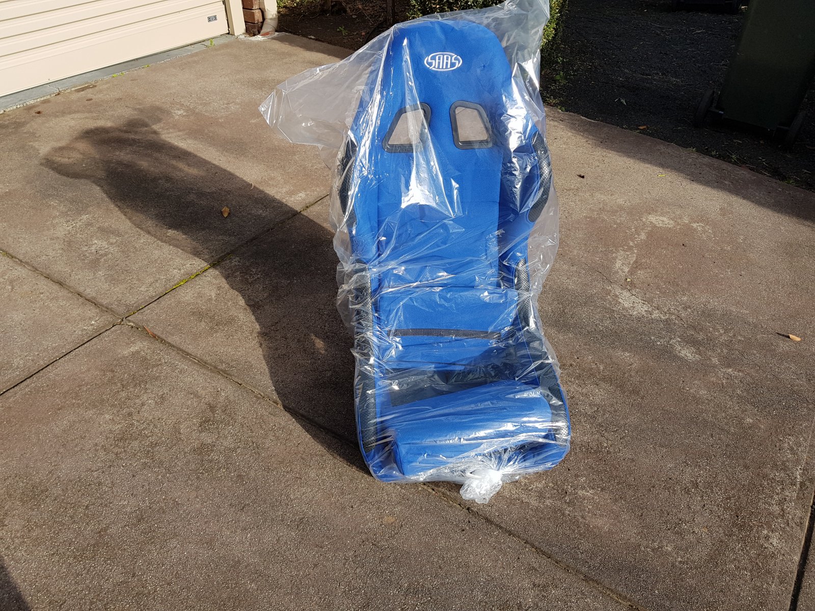

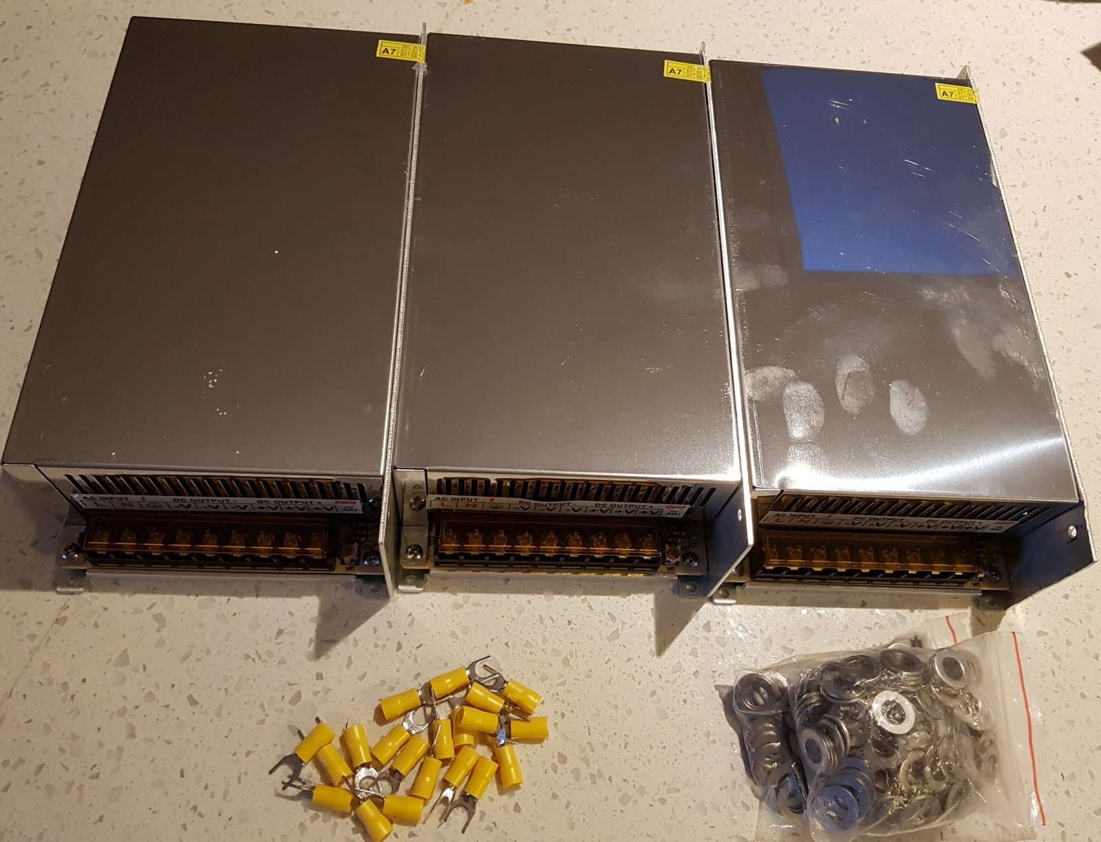

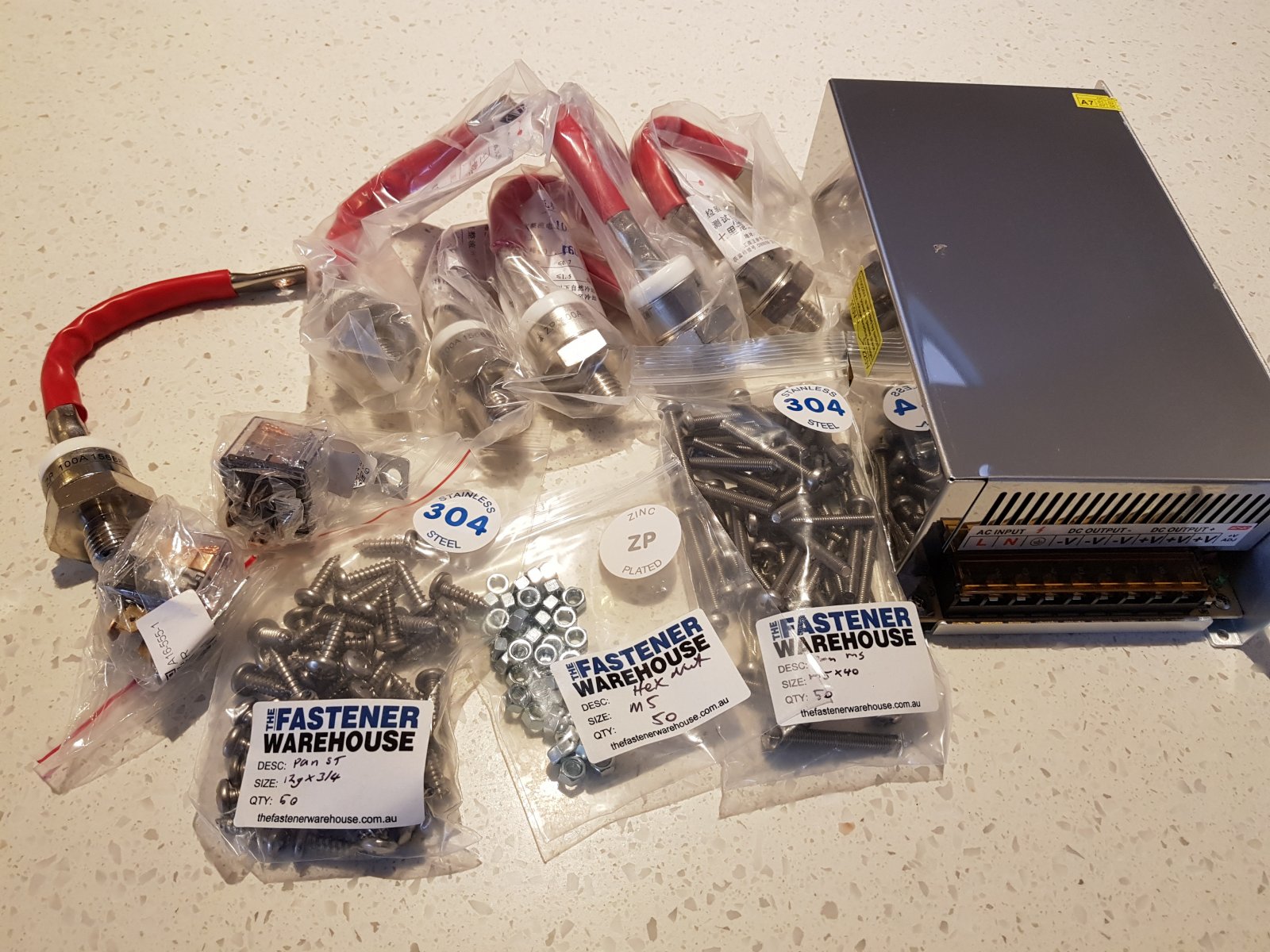

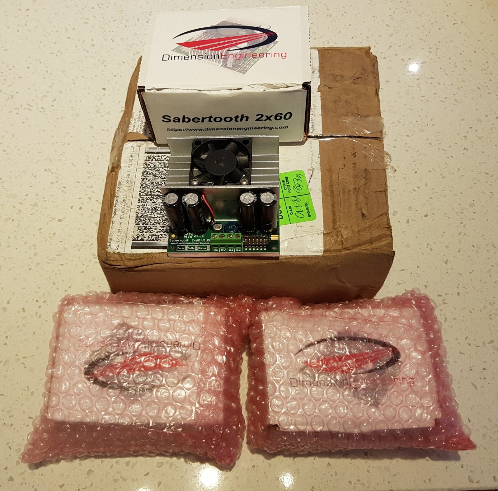

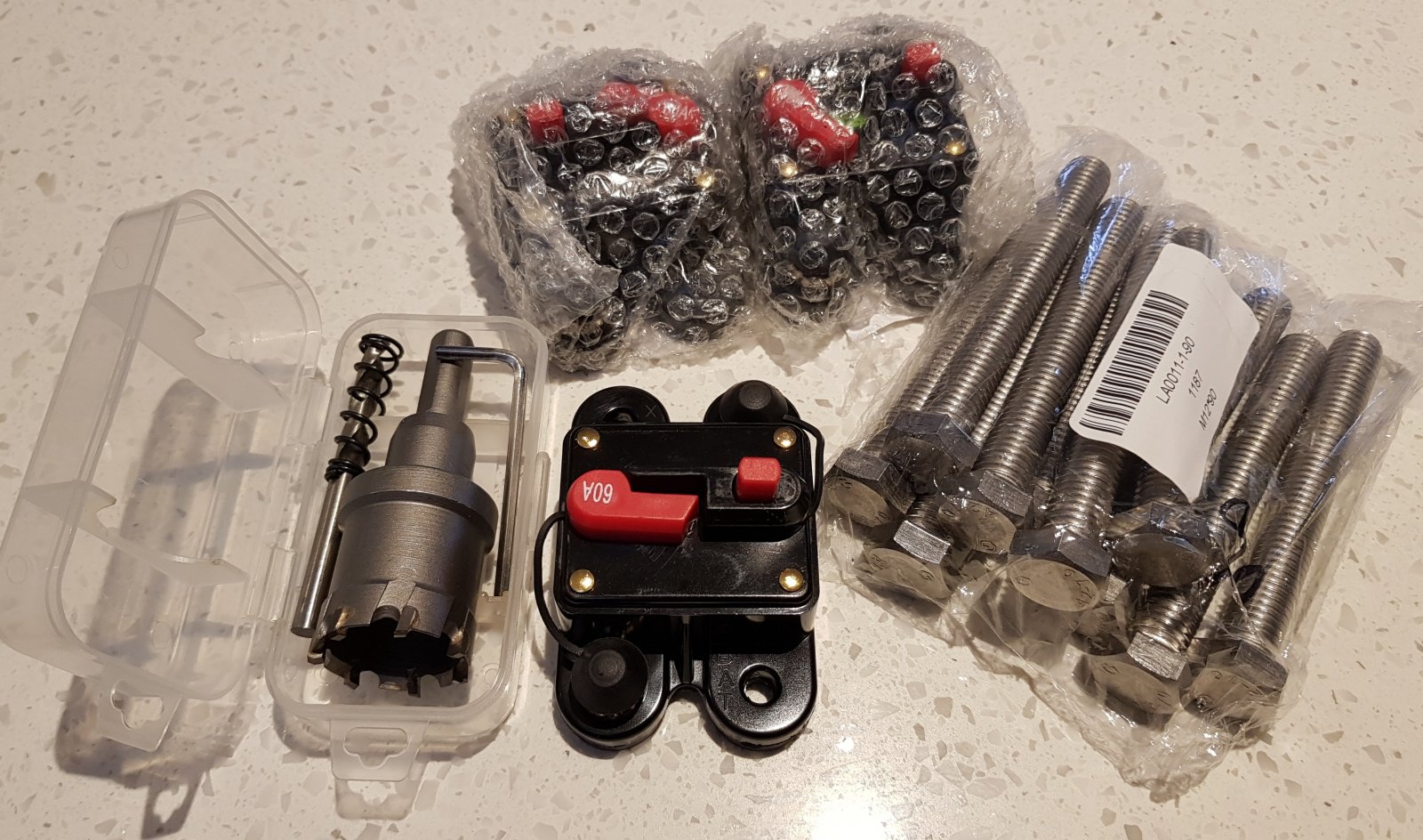

    Just spent up big.
    6 x Power supplies 24V 30A
    3 x Sabertooth 2x60
    6 x DC Motors 24V DC 450W 4500RPM 1.0Nm
    3 x UNO r3
    2 x POWGE 3pcs GT2 Timing Pulley 40 teeth Bore 6.35mm
    3 x POWGE 5pcs 20 Teeth 2GT Idler Pulley Bore 3/4/5mm 20Teeth Passive Pulley 20T 20 Geer GT2 Idle Pulley For Width 6mm GT2 Belt
    1 x 3D Printer accessories 10meter 10M GT2-6mm open timing belt width 6mm GT2 2GT-6MM For reprap Prusa i3 Kossel Mendel Rostock
    3 x 2pcs 3K Pure Carbon Fiber Tubes OD 25mm X ID 22mm X Length 500mm 25 x 22 x 500mm Tube Matte for Multicopter Quadcopter RC Arms
    6 x 2 Pcs Micro Limit Switch Long Lever Arm Subminiature SPDT Snap Action WS
    6 x 12mm Dia Shaft Coupling Motor Connector DIY Steering Steel Universal Joint
    6 x 3590S-2-502L 5K Ohm BOURNS Rotary Wirewound Precision Potentiometer Pot 10 Turn
    6 x V-Slot 1000mm x 20mm x 60mm
    6 x SFU1605 500mm BK12/BF12 machined
    6 x BK12 BF12 Ball Screw and support
    6 x LMK25 LMK25UU
    1 x Digital Clamp Multimeter OHM Meter AC/DC Current Voltage Resistance Tester D9R2
    1 x eSUN 3D Printer Filament 1.75mm PETG 1kg Spool
    7x T-Handle M3-6 Chuck Tap Drill Bit + M3x0.5 M4x0.7 M5x0.8 M6X1 M8x1.2 Thread
    100pc M3/M4/M5/M6/M8/M10 Stainless Steel Metric Flat Washers Repair Tool Kit NEW
    50/100 Hammer Head T Nut M4 M5 M6 20 30 40 Series European Profile Extrusion
    M4 x 8mm Button HEAD SOCKET CAP SCREWS ALLEN BOLTS ALLOY STEEL GRADE 10.9 BLACK
    Steel tubing and plate
    0.5-6.0mm² Ratchet Crimp Pliers Crimper Tool AWG22-10 Hand Crimping Tool Blue
    2216 B/A GRAY - EPOXY, 2 PART, HIGH PEEL/SHEER
    SAAS Mach II Blue Fixed Back Sports Race Seat ADR Approved
    Bunnings - 4x2400x90x35mm structural pine, 7xM8 1200mm threaded rods, 1xM12 threaded rod, 50x8G 50mm screws
    6 x ZP-100A Power Supplies Stud Mounted Rectifier Diode 100Amperes 1600Volts
    Auto Car Waterproof 12/24V 100A 4Pin Control Device Relay Transparent Harness
    60mm LED Light Big Round Arcade Video Game Player Push Button Switch Lamp GT
    12V 33Ah AGM General Purpose lead-acid batteries
    Car Boat 100A Battery Master Disconnect Rotary Cut Off Isolator Switch Black
    12V-24V AUTO Car Marine Bike Stereo Audio Circuit Breaker Reset Fuse Inverter BD
    Astrotek-AU-Power-Board-6-Socket-Outlet-with-6-Seperate-Switches-1-5m-Cable-Blk
    Waterproof Metal 16mm Push Button Momentary ON OFF Horn Switch Start High Flush
    M12 Female Rose Joint Bearing Right Thread Bronze Liner Rod End
    NEW High torque 8-22MM CNC Flexible Plum Coupling Shaft Coupler Connect D40 L45
    Machine Screw M5 5mm Pan Head Stainless Steel 304
    M6x35mm Full Thread Phillips Flat Head Countersunk Bolts Screws
    16pcs M12 x 1.5 Hex Lug Wheel Nuts Alloy For Ford Focus Fiesta Kuga Mondeo Puma
    10 PACK STAINLESS NYLOC NYLOCK LOCK NUTS M2 M2.5 M3 M4 M5 M6 M8 M10 M12
    15-55mm Hole Saw Carbide Tip Tool Stainless Steel Drill Bit Metal Cutter Kit
    Pan Phillip Self Tapping 12g (5.4mm) Screw Tapper Stainless G304
    Pan Head Phillip Machine M5 (5mm) Metric Coarse Screw Stainless G304
    Hex Standard Full Nut M5 (5mm) Metric Coarse High Tensile Class 8 Zinc Plated
    Alloy Cutter 10mm Shank Twist Drill Bit 80mm Diameter Hole Saw Cutting Tool
    10PCS Hex Head Cap Screws M12 20-150mm Hexagonal Bolts Building Fasteners Parts
    UNO Proto Shield Prototype Expansion SYB-170 Mini Bread Board Based For Arduino
    UNI-T UT210E Digital Clamp Meter Multimeter Handheld RMS AC/DC Mini Resistance
    Tungsten hand tap M12x1.75, 12mm, Intermediate, RH. Metric. New
    536-1-1-103 - VISHAY WIREWOUND POTENTIOMETER, 10KOHM, 5%, 2W
    edit: I have just uploaded the Fusion 360 native files so you can modify / combine them. The rod holder assembly should be one solid piece and should be at least 1-2mm narrower than the ones I will upload so it doesn't rub on the V-slot. So consider them prototypes. I would suggest printing them at 10% to see what they are like then modify them to suit your own actuator.

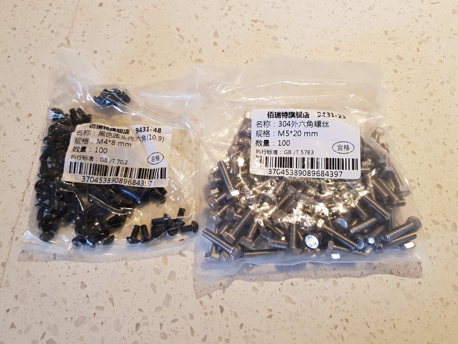

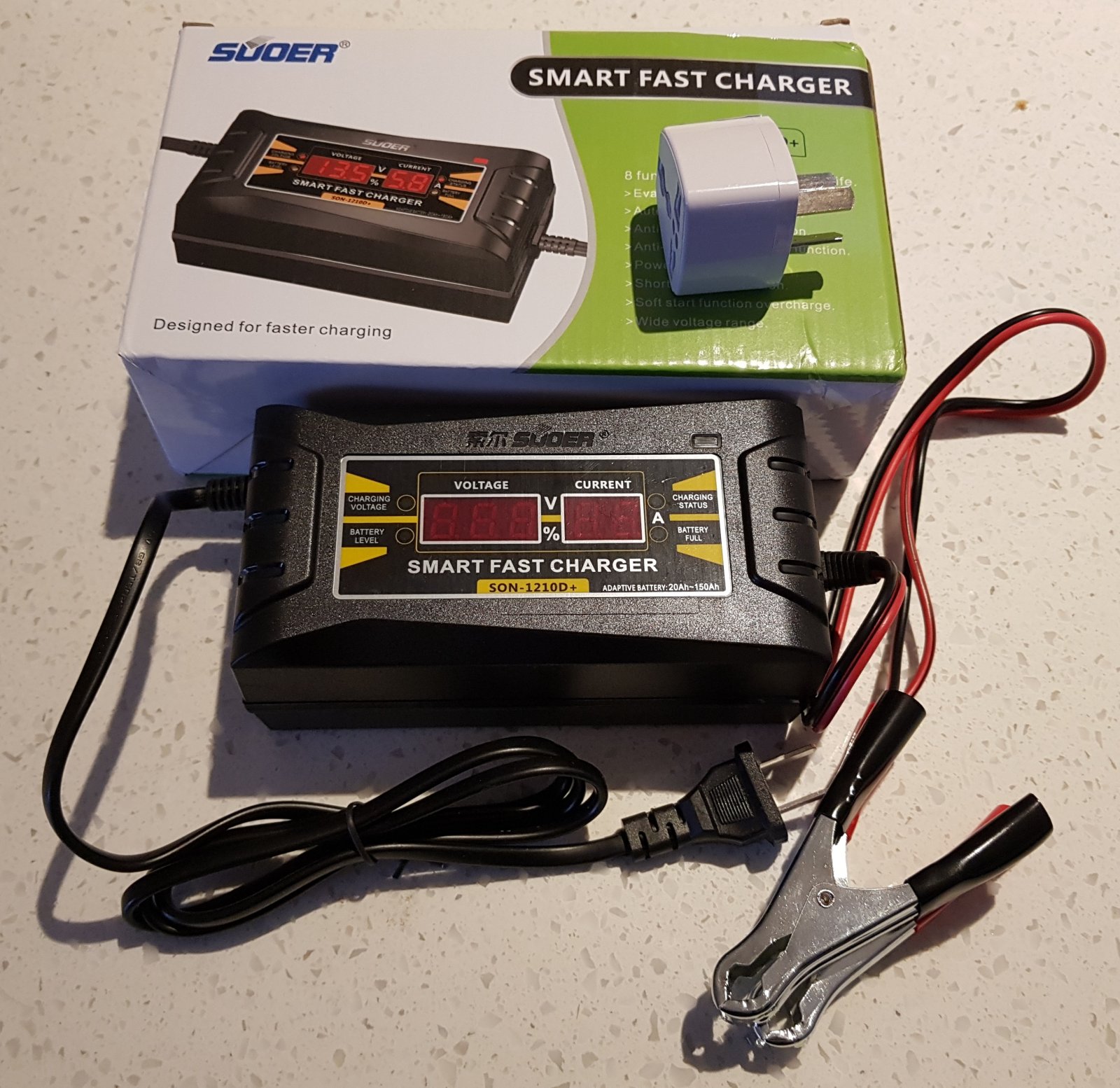

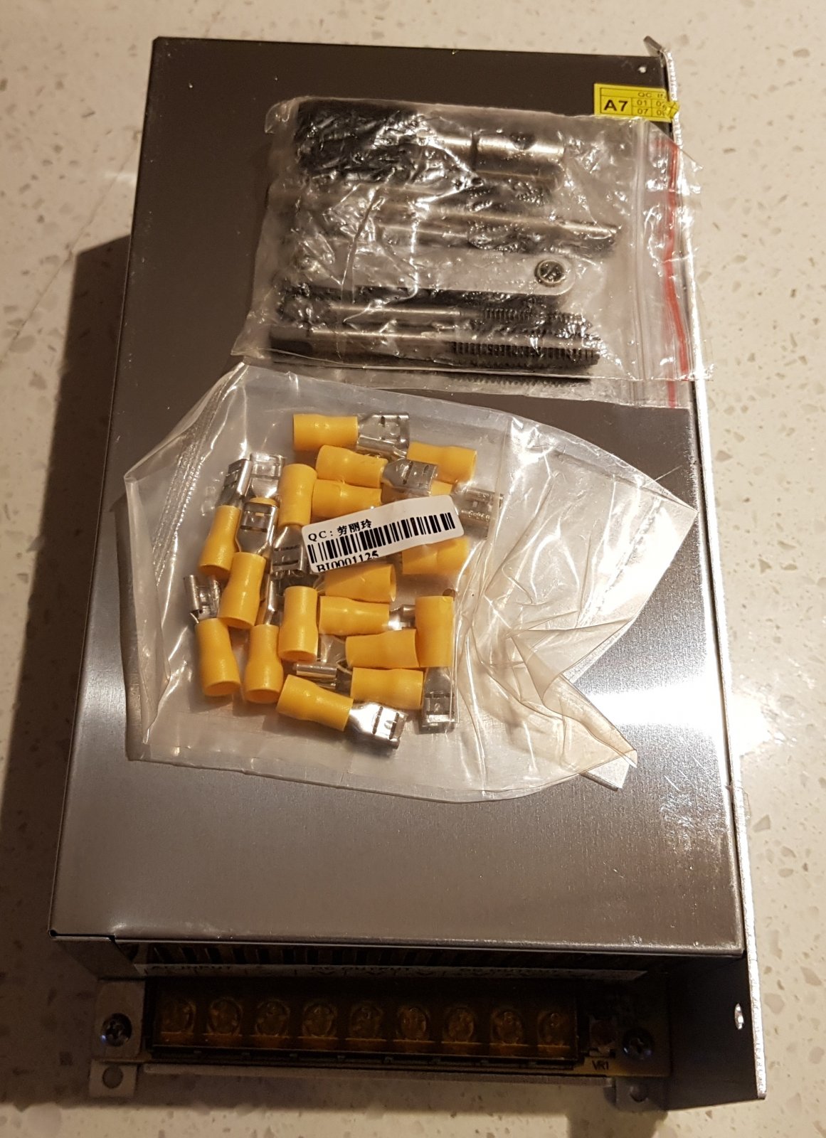

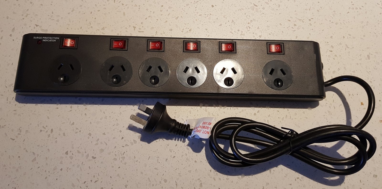

  7. SilentChill
    2,645
    20,593Coins
    +3,570 / 34 / -0
    Links under each of the pictures would be awesome if you can ;) it would help others and stop people asking where ya bought stuff............. actually they still ask but it helps :D

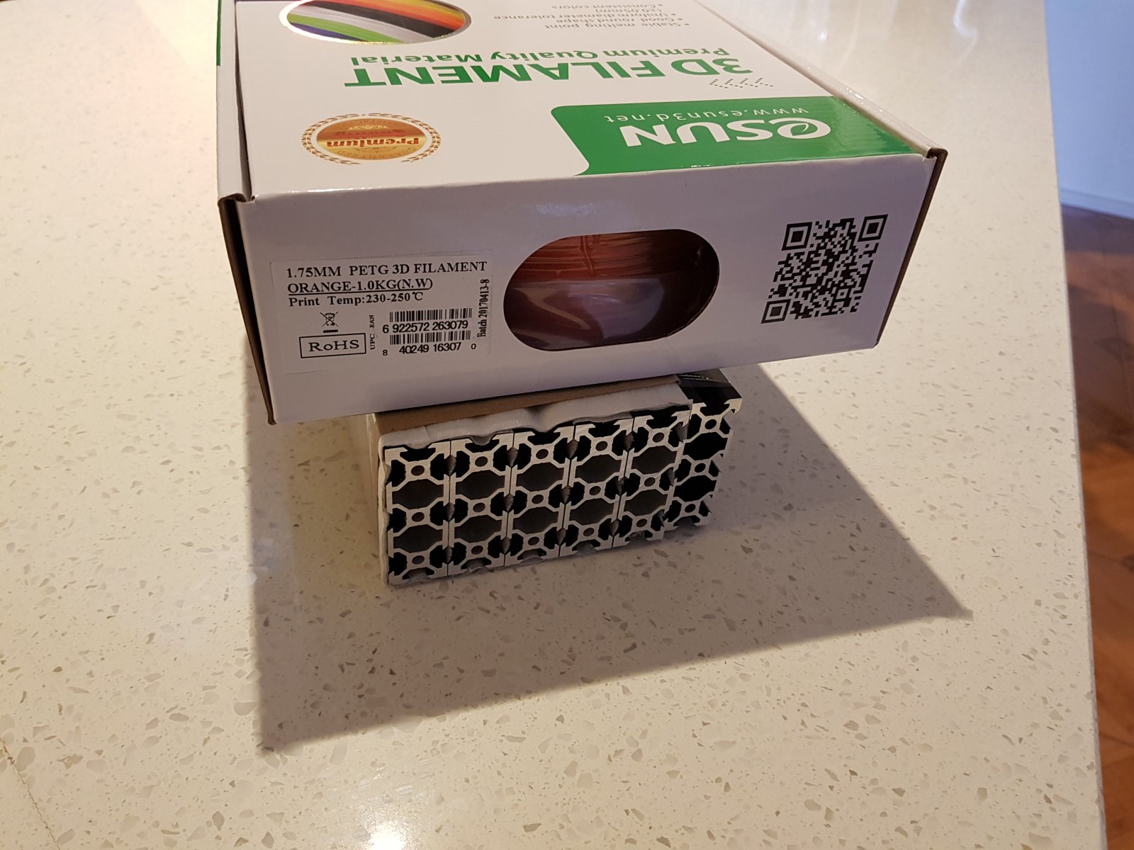

    I thought I would add into this post my Design Considerations and edit it as I go along. Beginning with the 'provolutionary' design of @SeatTime and the child instances that followed, I would like to sincerely thank him for opening the door for us noob DIYers. After reading through the very enjoyable children of @SeatTime - the journeys of @SilentChill and @wannabeaflyer2 I have benefited from their successes and well, not so successful endeavours. This has saved me both time and money and I am sure many others will benefit as time goes on.
    Motors
    I wanted to minimize my work with mains AC - simply for safety sake - therefore it had to be DC. This also fits in with the intention of using Sabertooth motor drivers. I had originally considered 12V but @SilentChill said that if he had the chance to start again he would use 24V simply because they used less current. In fact, the ones I eventually ordered from Motion Dynamics were considerably cheaper and better than the 12V ones. The model I got also had a built in fan and ventilation at the back - so I won't need to drill holes ;)They had to be 4000RPM or more after reading @Grigory experience with motion sickness. I reasoned that the nausea was due to the platform not following his vestibule accurately enough. They couldn't be too fast as there was some concern about the Ball Screw flying apart. @SeatTime children proved that 4000-5000RPM worked fine from experience. The motors need enough torque to lift the platform therefore at least 250W. In practice, @wannabeaflyer2 found the actual current drawn was way less than the motor's spec at full load. Finally, the power couldn't be too high as one house outlet is limited in Aus to 2400W. Although I would consider getting a sparky to install a 15A outlet and separate circuit breaker, or run three motors from one circuit, there was always the option of simply finding another outlet on another breaker so the current is split across two circuits. Edit: the motor must have brushes to work with Sabertooths. Edit2: the downside of choosing this particular motor is the need to cut an 80mm hole for the fan.
    Motor Drivers
    After reading @SilentChill negative experiences with Monster Moto and other cheaper drivers and the success he had with Sabertooth, in addition to the successes of @wannabeaflyer2, the decision to go with Sabertooth 2x64 was straightforward. I could have chosen the cheaper 2x32 but with the higher wattage Motion Dynamic motors I eventually ordered, and the postage time from the USA, the decision almost was made for me. The only reservation I have at the moment is the battery required for regenerative currents and how to hook it up if the power supplies are connected in parallel with diodes etc. Edit: I am now going with three 'sets' of power supplies for the motors. That is, two psu's in parallel with blocking diodes and a small deep cycle battery for each Sabertooth and a pair of motors. These will be positioned as closed to each pair of actuators as possible to keep the wiring short. The only downside to this approach is I am going to need 6 batteries (24V) around 33Ah :eek: That will be expensive. Might need to reconsider the @SilentChill all in parallel approach with one big battery.
    Carbon rod top end
    There are lots of options for attaching the Rose to the end of the carbon fiber tube. I don't have the skill of @SeatTime to work with carbon fiber tape/sheet/mouldings. I am going to try a fluted 3D printed insert using PETG with an M12 thread. This will be bonded with the rod with 3M 2216 B/A gray two part epoxy. The printed insert will be fluted to increase the surface area in contact with the epoxy. Edit: rather than fluting the sleeve I make it about 1.5mm smaller than the inner diameter of the rod and relied on the epoxy to do its job
    Top bearing
    I purchased LMK25 LMK25UU for 25mm shaft linear bearing square flange ball bearing bush for the top of the actuator. At this point I am finding it hard to justify the cost of the Igus bearings.
    Software
    While I haven't ruled out Thanos' board, I will use three Arduino Unos and the SMC3 software together with SimTools. I have had a lot of success with Arduinos in small robotic projects and I feel more confident using them. In addition, there is a wealth of information on this forum on how to use them. Edit: there is a lot to read to set SimTools up correctly and it takes some considerable time to understand how it works and tweak it to get the best out of the motion platform.
    Motor base/end/top plate
    These will be made with 18mm Merbau, a hard wood, rather than plywood. I will 3D print the end plate that the top bearing sits on. Edit: a colleague offered me 6mm aluminium plate which I readily accepted - he even cut it for me into 130mm squares (18 of them!) and six 90mm plates for the top bearing.
    Top and bottom frame
    The top frame will be made with 20x20x1.6mm steel tube and the bottom frame from radiata pine. The corners will be strengthened with corner braces following @wannabeaflyer2 design. His beautifully detailed drawings make this an easy design decision. I noticed that @wannabeaflyer2 ended up moving his rose mount points on the upper frame in further from the end points of the triangle - looks like about 100mm. Edit: I ended up making the frame slight smaller and welding the triangle using 50mm x 50mm x 4mm steel angle. In hindsight I should have used 30mm square steel and welded corner braces. While the 20mm is light and easy to work with, it flexes easily and I ended up having to use bolts and corner braces.
    Position Potentiometers
    I originally purchased Bournes 10T pots but they are very poor quality. After some advice I ended up buying quality Vishay pots for $18AUS each posted.
    Limit switches and Panic consideration
    There are 2 micro-switches per actuator - one near the top and one near the bottom. They are in the normally closed NC position. All limit switches and the panic button are wired in series forming one continuous circuit. If there is a break in any wire or any of the switches are pressed it disengages a 'self-latching' relay which switches the power off to all the relays in series with the motor negative leads. Simple, cheap and effective. After testing, the position of the limit switches was moved towards the middle of the actuator to account for inertia / gravity to prevent the ball screw from hitting either the top or the bottom of the actuator.
