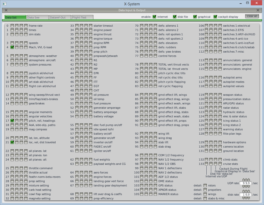

    Hi @cpvasconcelos
    X-Plane 10.30 working confirmed.
    Now please be aware that during patching the plugin overwrites all the Data Set settings with these:
    In order to run the plugin properly you can't enable any other/additional "Internet" values below 22.
    Values above 21 are fine, as well as any disk file/graphical/cockpit display values

    thank you very much. I did try to install a certain iPad app (x-mapper lite) that used those values, and everything got messed up concerning motion...
    do you have any plans in the future to capture motion data from other sources? from the little understanding I have, people told me to the best way to capture data would be to check índex for each data set in the array....
    anyway, not critical, I assume you have other priorities and all is well here if I don't run certain apps...
