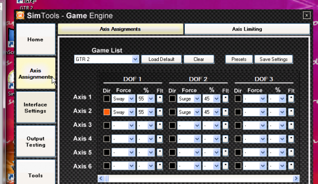

    Hallo everyone!
    Can anyone help me?
    Perhaps I might have missed something, but my sim moves opposite.
    When I acceletarte than my seat moves forward, and moves backward at braking. Everything else works well. The side movements are in good directions.
    What can I do with this problem? I'm so confused...

    When you add a force in your profile, there is a box near that force which you can click to reverse effect, it will become orange color or yellow, I forgot now. Maybe someone can put a screenshot, I'm answering from mobile.

    downloadfile-1.png try the box "Dir"
    if you dont know wich axe is left or right of you scn5 do try and error and you ll get right movement.
    best regards

    Thx guys! It works :) Just did not understand that settings
    I love it, works awesome :)

    this setting is just simple.
    you create your axis assignment and axis 1 is scn5 1 and axis 2 is scn5 2, you do not know wich scn5 (1 or 2) is left or right on your rig!
    and if you now set your force, in your case surge i think, you still do not know wich one of your scn5 is right or left on you rig.
    you drive and notice, with acc rig move forward and braking rig move backward, now by marking the "dir" box oragne, you reverse this wrong effect into right.
    just easy :)
    i had the same prob while set up my scn5´s.
    hope you understand it better now.
    best regards
    seppel

    Thx your kindness, Seppel
    I ticked both of Dir on Surge (axis1 and axis2) to orange and they works well.
    Next step to tune them :)
    thx for the quick help
