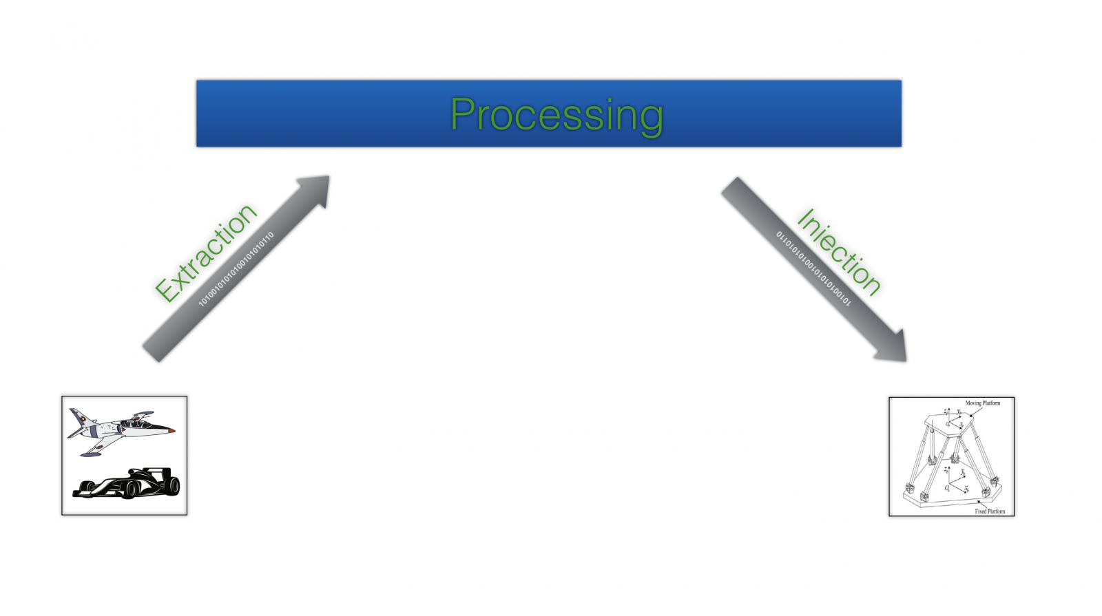

    So, what even is a motion cueing software? Well,… actually the software is only one link in the „motion simulation chain“. To get the big picture:
    Basically three steps here:
    1. Extraction: Get the data out of your sim into the motion-cueing-software.
    2. Processing: Crank it through some black voodoo math-magic
    3. Injection: Whatever comes out on the other side will need to be injected into a motion system to drive the actuators
    I will go into more detail on the extraction and injection at a later time, because I think the processing is probably the most interesting part.

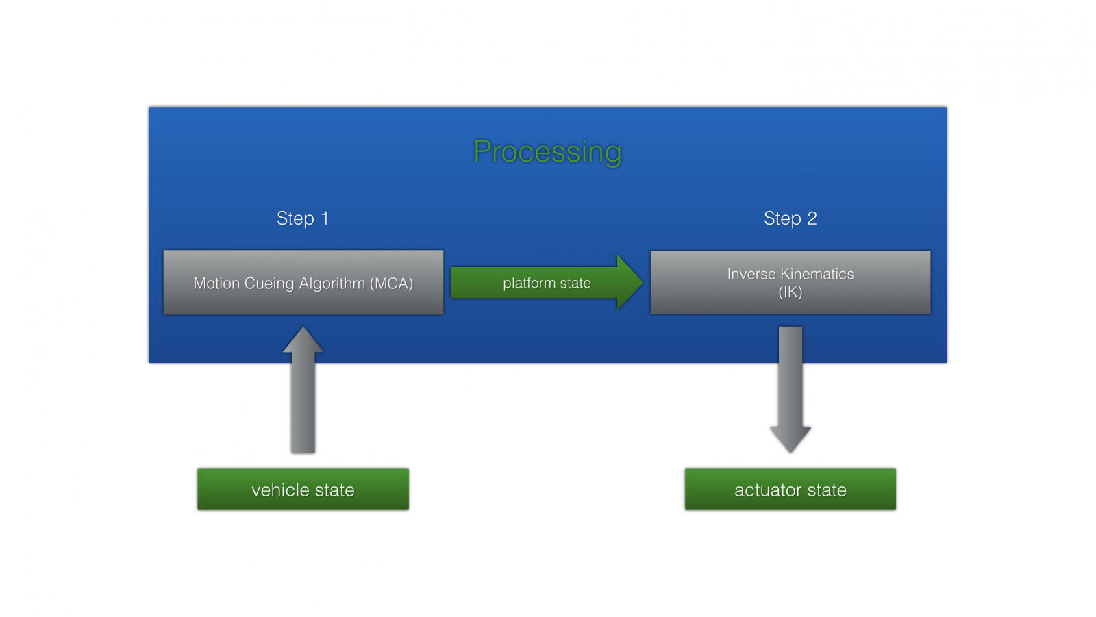

    I do the processing in two major modules:
    The first is the motion cueing algorithm which takes the vehicle state as exported by the simulator and turns it into a platform state.
    The second module then uses inverse kinematics to turn the platform state into the 6 actuator states.

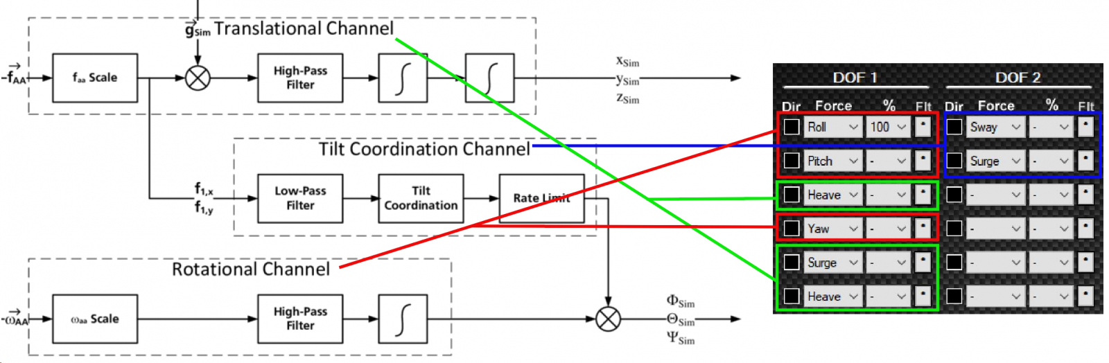

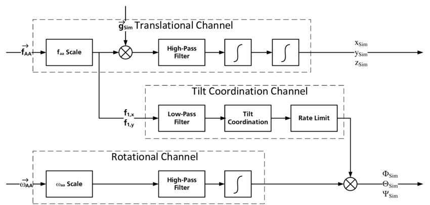

    Of these two modules, the motion cueing algorithm (MCA) appeared to be the most challenging to implement. I mean, initially I didn’t have the faintest idea of how to implement anything really in code, but in all other areas I was somewhat confident that I could understand the problem, follow tutorials, find documents or come up with something myself. It wasn’t until I fully understood how to implement the MCA, that I started the actual coding.
    Btw, there is no such thing as THE motion cueing algorithm. The „One to rule them all“. There are a variety of ways to create the illusion of motion to an occupant and essentially each is the solution to a single, very well defined use case. And it is always a compromise between different, sometimes contradicting, requirements. However, you can define certain properties you want your MCA to have and in one form or another all MCA designers will have made considerations to what extent they want these properties implemented.
    A (non exhaustive) list of what I wanted in my MCA:
    • Driver-in-the-loop system
    • Real time (no pre-processing)
    • No look-ahead functionality
    • No predictive cueing (…yet! But possible later)
    • No adaptive cueing (…yet! But possible later)
    • Filter based approach (washout through HighPass-LowPass combination)
    • Tilt coordination (Pitch-Surge and Roll-Sway)
    This is what I could come up with just now off the top of my head. I’m sure there are more and I will add them as they pop up. Btw, it’s not like I invented those. I gathered them from (unfortunately very few) research papers I found online. The Wikipedia page on Motion Simulation provides some great resources as well. Especially the section on false cues is worth reading and understanding.

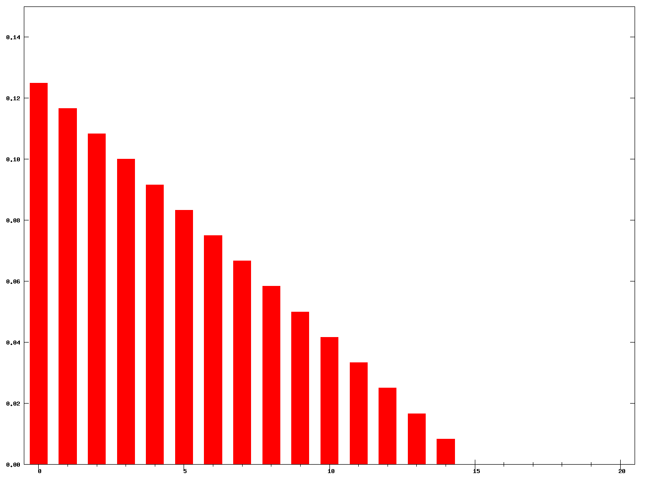

    Low Pass Filters:
    Probably the simplest low pass filter would be a simple moving average filter (SMA). In a nutshell: It outputs the average of a certain number of previous inputs. The higher that number, the more that filter will act as a low pass filter. The more high frequency content is being filtered out.
    A weighted moving average filter (WMA) is the same thing, just that newer values are being „weighted“ more than older ones.

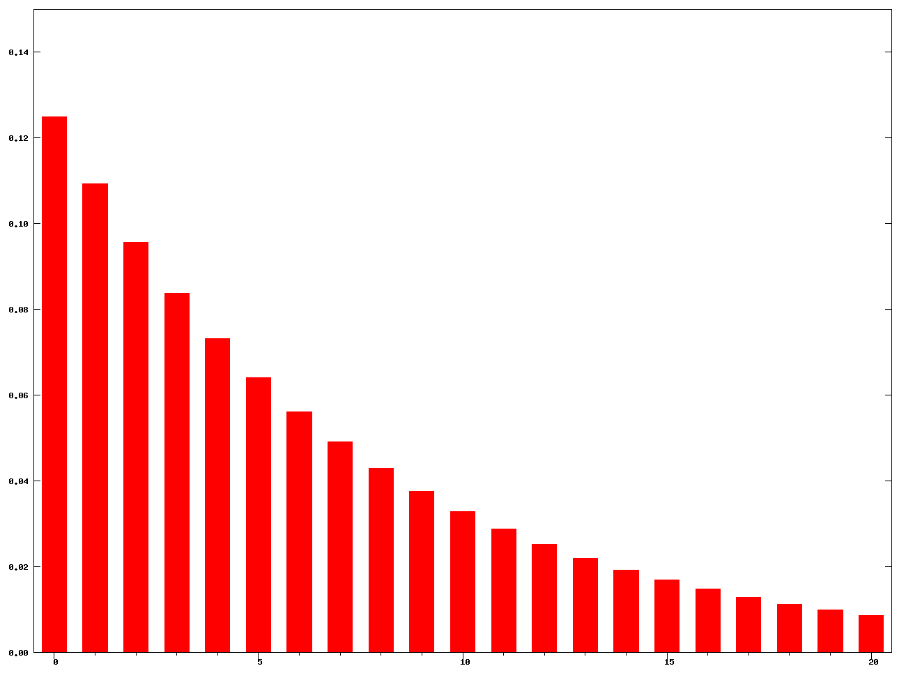

    An exponential moving average filter (EMA) is kinda similar to a WMA, but the values are depreciated by a defined factor after each new value arrives. Old values never ever go out of scope, but are just depreciated into oblivion. Sounds more complicated, but isn’t. This one has less delay between the input and output and is also easiest to implement because it does not even need to keep track of more than a single history value.
    My filter of choice is mostly a double exponential moving average filter (DEMA) because it has even less delay at similar smoothing properties than the EMA. Also relatively easy to implement. It does overshoot slightly though (It’s underdamped).

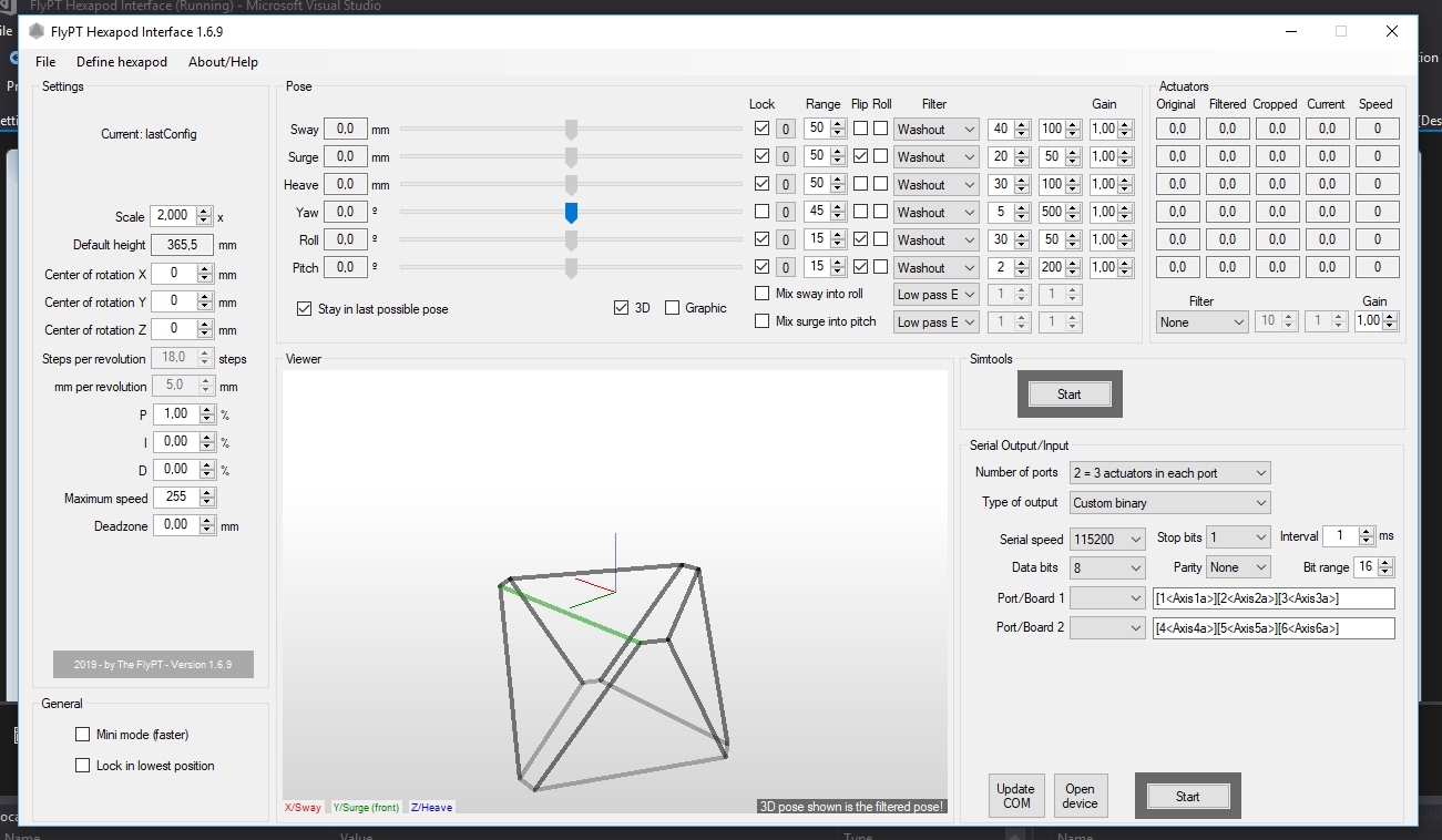

    I decided to use the filters, as I have, and made an interface like this:
    Relative to current version, washout was modified and we can now mix sway and surge in roll and pitch.
    Might have to much filter options, but we can play as we want...
    I have EMA DEMA TEMA filters and combine them for washout.
    I use mainly EMA, don't think DEMA is necessary.
    I use low pass as integrator.
    Now I have Washout=LowPass(High Pass(value))
    High pass is: High pass= value - Low Pass(value)
    In the image, we specify the number of samples used in the EMA filters,
    At left, for low pass or lower cut off on band filters
    At right the number of samples for high pass or upper cut off on band filters.
    Those two number of samples are also used in the washout high and low pass filters
    It's pretty fast calculation.
    Slow is to show and store the graphics.

    Well, in my program, you can change the center of rotation, so in a car you can somehow simulate what you would feel if you where seated in the back seat.
    The problem here is that you are not sure of what info you receive from sims.
    While in aircraft they are more serious about it, in racing games, you are not sure of what you receive.
    Is info related to car CG, driving position, center of traction or any other?
    Imagine that in a game, instead of car info, you got the memory address of the antena vibrating... (exaggeration)
    We have no idea and can't be sure of what they say, even with memory maps.
    In my program, if the data is relative to the seated driver position, center of rotation should be adjusted to be on your seat position.
    If I want to know what I would feel in the back seat, a good approximation was to move center of rotation to the front, around 70 cm.
    So, it's all an approximation. To be perfect, we need full support from game studios and there we have info to reach near professional sims.
    I don't know if it's worth to calculate forces on a new position when we don't even know what we receive. But I'm probably wrong.
    The advantage would be to use the rig limits in a better way with motion cueing.
    My next step is to make the program work without errors and that everyone understands how to use it.

    DC motor, 6DOF
    Correct me if I am wrong but since we have the 6-dof IK plugins, this kind of "classic washout" could have always been constructed from scratch in x-sim or simtools using simple axis mapping with simple LPF and HPF.
    Although it's very cool to have it AFTER the kinematic side I think, there is a big benefit being able to build those BEFORE mapping them on the degrees of freedom, which would give us in some cases more flexibility while mixing different effects.
    @yobuddy For sure, it would be very useful to develop inside Sim-Tools more advanced filtering options and tweak the limits of the existing ones.
    A good example is the telemetry coming from X-Plane. Besides the rotational positions, we have access to rotational accelerations which is very interesting to mix with the positions.
    Applying the filters on the effects directly (SimTools or X-Sim side) and not on degrees of freedom (inside the plugin) could give the user more control of motion filtering on what goes where and with which kind and amount of filtering.
    Best

  17. Dirty
    Oct 15, 2017
    746
    All the way up front.
    7,964Coins
    +884 / 3 / -0
    That sounds interesting. I think that could approximate an actual motion cueing algorithm to a certain degree.
    I second that!
    It's certainly not that you couldn't get anything moving with SimTools as is. It's just that I was looking for more freedom to explore options. The down side if it would be, that it would probably require a much deeper understanding from the user to setup and tune.
    Since I'm pretty sure that this wasn't gonna be what the majority of people were going to be interested in, I was happy to start on my own path :)

    Motion components
    Trying to think of „motion“ as a whole is pretty complicated, at least for me. Just too much going on at the same time to be able to do anything useful with it. But we could break the motion stream apart into its components.
    Probably trivial to most, but I’d like to mention it none the less for the sake of completeness: Any motion is just a combination of translations and rotations. Any changes in motion (aka accelerations) are just a combination of changes to translation-rates and rotation-rates.
    So instead of looking to find an algorithm to process all of the possible motions a vehicle can perform, we just need to find a way to process translations, rotations, accelerations and angular accelerations. That sounds a lot more accessible than „motion“ as a whole to me.
    In the end we will then send commands to the platform to display all processed motion components simultaneously (in superposition) which will be interpreted by our brains as actual motion :)
    Translations are movements along the vehicle x/y/z axis. Rotations are rotations around the vehicle x/y/z axis. (Unless I indicate otherwise, I’m talking about motion in the vehicle reference system).
    These axis are perpendicular to one another, so for translation one axis does not influence any of the other axis. The order in which we execute those motions does NOT matter.
    Rotations unfortunately are not quite as straight forward. Here the order DOES matter.

  19. hexpod
    hexpod http://heXpod.xyz
    Apr 18, 2016
    1,209
    berlin
    7,782Coins
    +375 / 5 / -0
    DC motor, 6DOF
    “Translations are movements along the vehicle x/y/z axis. Rotations are rotations around the vehicle x/y/z axis.”
    Yes, and basically, You have to map the vehicle xyz positions to 6DOF plug-in rotations, and vehicle xyz accelerations to the translations.
    As the Stewart platform has a very limited workspace, additionally, you may want to map the longitudinal and lateral accelerations to the Pitch and Roll and mix them with your already existing positions in order to use gravity and cheat your velstbular system so you get a feeling of sustained braking and acceleting effect.
    The issue with the yaw is, that most of the games offers only rotational positions, rarely you can get the angular accelerations. In this case, the plugin wrighter has to do some math to convert the absolute yaw to local yaw to avoid the kick 359 deg. - 0 deg.
    SimTools washout feature needs also to be adapted so it can properly recenter the axis. @yobuddy promised couple of months ago that this will be done in upcoming release.
    If you want more technical precisions about how to deal with yaw, talk to @value1
    As he wrote a lot of game telemetry plugins, he will for sure be able to provide detailed info in that matter.
