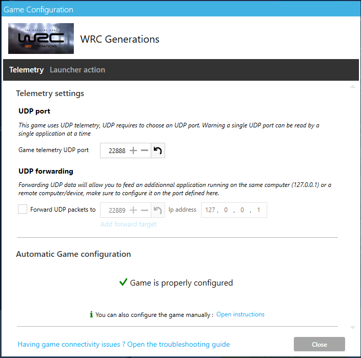

    I see simhub is supporting WRC Gen with no work around just udp which is awesome news :thumbs

  11. yobuddy
    5,162
    48,172Coins
    +5,037 / 16 / -0
    @Hamreus
    I can try to roll a plugin, but I need to know the process name for WRC Generations?
    (So SimTools can detect it, it's usually the exe name, but not always.)
    I think its "WCRG.exe"?
    And can you show me the file found at:
    "C:\Users\(user name)\Documents\My Games\WRCG\UserSetting.cfg"
    So I can fix the patching for the game.
    Thanks!

    Yes it is WRCG.exe and here is the user settings file...

    Thanks @yobuddy
    The WRCG plugin for Simhub is now working

  15. yobuddy
    5,162
    48,172Coins
    +5,037 / 16 / -0
    The game should not be running while you install the plugin.
    Roll and pitch output seem not quite right but the plugin is confirmed working.
    Take care!
