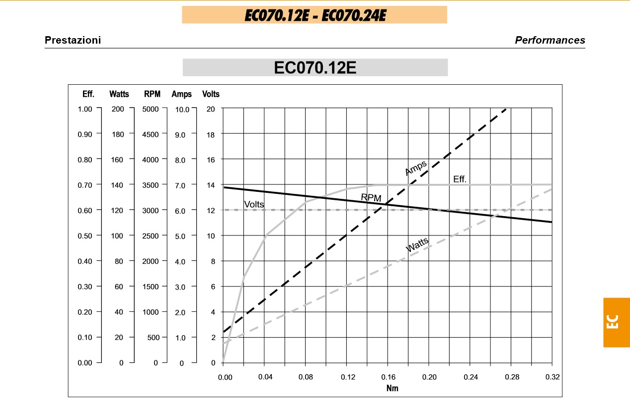

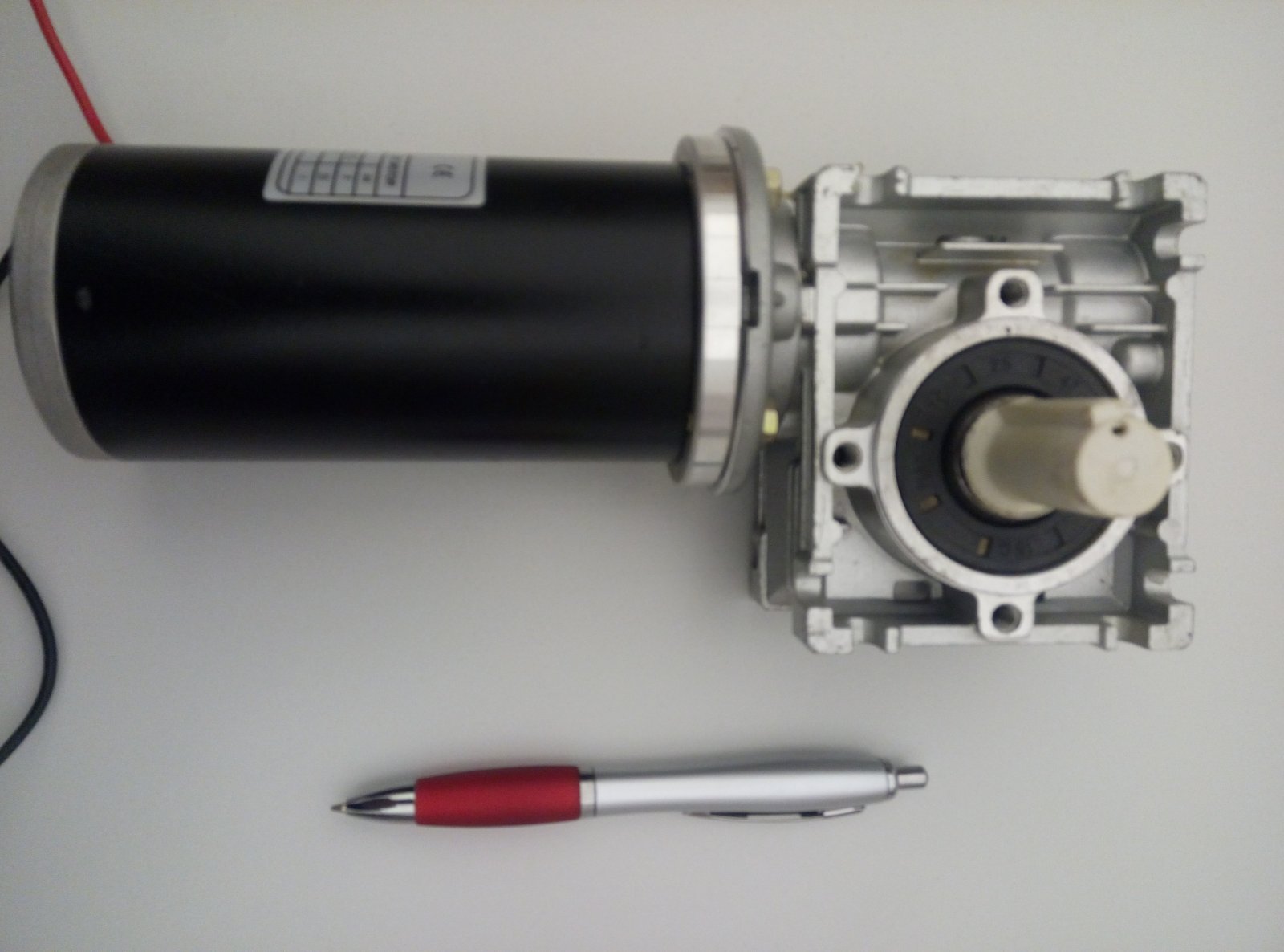

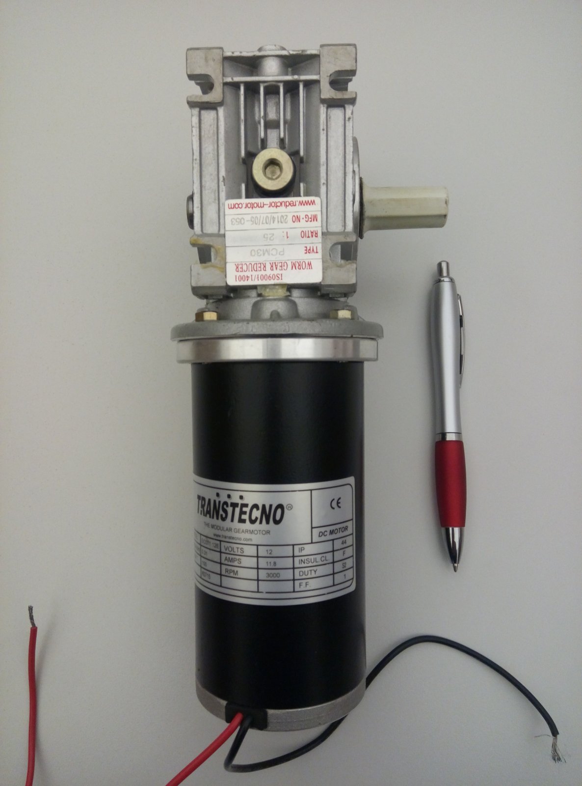

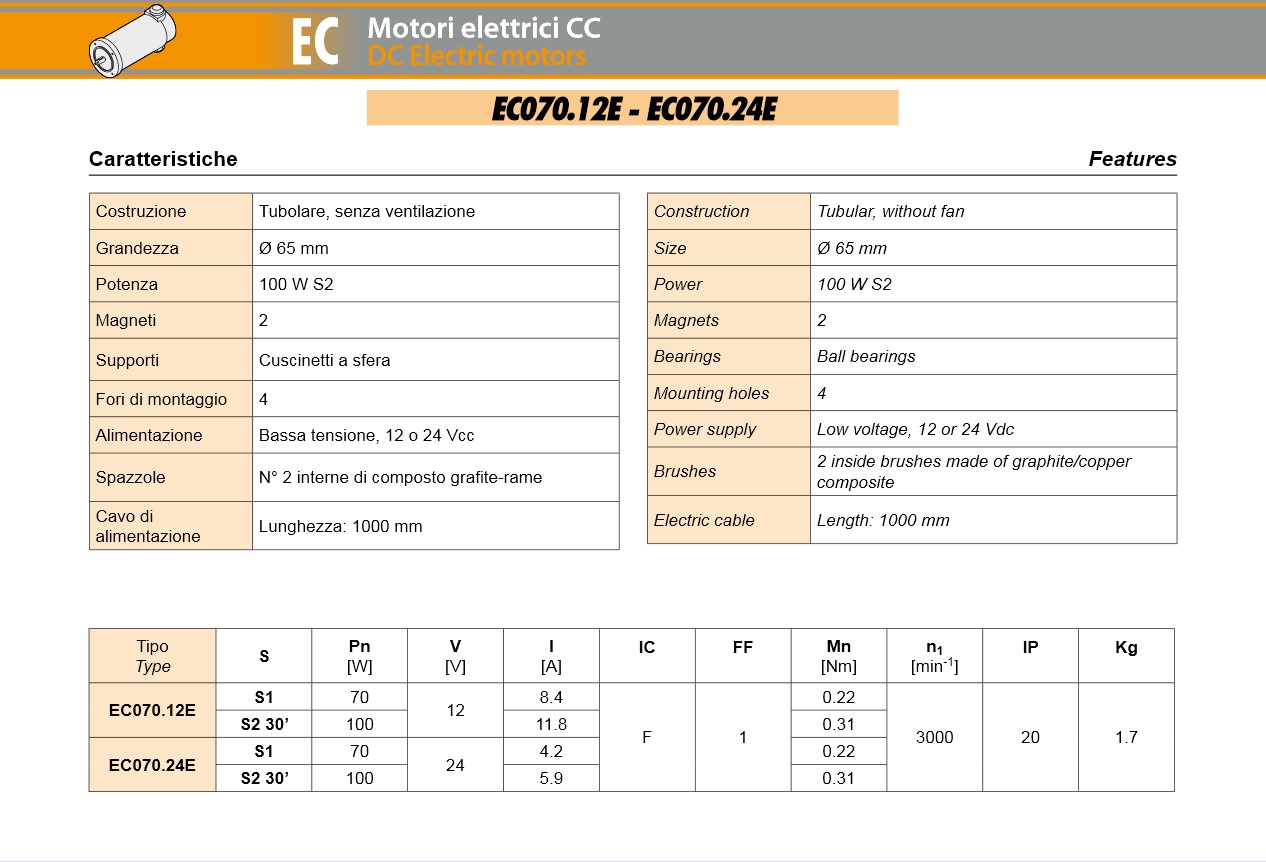

    I have a question to you guys, I read the forum about the motors that are recommended and their specs.
    • Motors with the following specs :
    • Gearboxes : CM 30 U 25 56B14 , ratio 25 : 1 , aluminium case and metal gears.

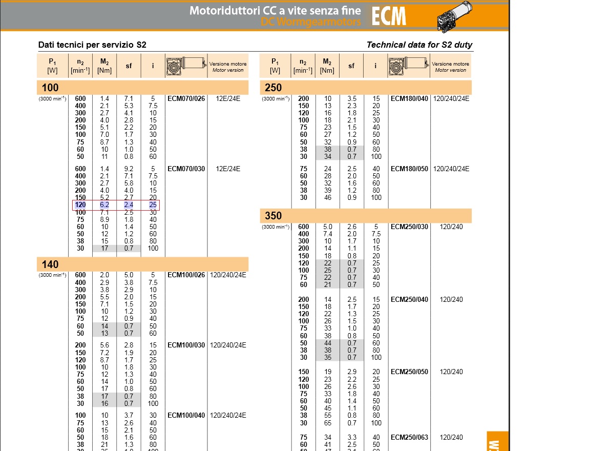

    Now, the motor is rated to 3000 rpm at 11.8 amps maximum, at a gearbox of 25:1 results an output of 120 rpm.
    The issue is that in this combination the output torque is only 6.2 N.
    Bellow is the table attached : values in red square.
    Knowing that I will use this combination on a seat mover shoulder mount sim, with a lever between 50-60 mm, do you think I will have issues ?
    If I want to achieve a 20N output torque with the same gearbox and ratio I must change my motors to the 250W motor which will not allow me to run my JRK`s because they need 30 amps .

    I have no clue about the durability of aluminum gearboxes. Personally I would suggest going for what is known to work.
    You could wait for the Pgsaw 25:1s to come back into stock, or you could use their 50:1 motors, you can contact them for shipping advice: http://www.ebay.com/itm/GEAR-MOTOR-...483?pt=LH_DefaultDomain_0&hash=item51bed470a3
    The 50:1s give you a bit of flexibility regarding extra load carrying capavity and hence possible design variation. Given you are 112kg the 50:1s are well worth considering and are available at a reasonable cost, plus they will work well with JRKs.
    Similarly you could order from Motion Dynamics in Australia, though shipping may be an issue: https://www.motiondynamics.com.au/worm-drive-motor-12v-24v-200w-180-rpm-20nm-torque.html
    Or consider the alternatives, such as winches: http://www.xsimulator.net/community...-wip-surge_sway-table.5276/page-12#post-79142
    Or electric jack motors: http://www.xsimulator.net/community/faq/modify-electric-jack-motors-for-sim-use.212/
  3. bsft
    @PetiCovaci , those motors at a 100 watts may be a bit off. Can you use the 140 watt motors?
    Not sure about the gearboxes on them. Maybe buy them and thrash them to see how good they are.
    Heck, I did that introducing the 200w 12v 25:1 motors in the first place. You may find what you get is more than adequate.
    The JRKS will run 30 amps continuous all day with 40-45 amp spikes, which yes, does equate to a 200 watt motor. the extra 50 watts may be pushing it. Dunno, you might have to give it a try. You will not burn out the JRKS, they will simply shut down and go into error mode trying to throw big current.

    The problem is that I already received today the motors and gearboxes so I cant order something else but I can exchange them to something that`s better.
    If it is so important that the motor with gearbox must have a rated output of 20 Nm then I must change my motor to a higher power one.
    With double the cost I can buy the EC180. 120 / 240 with 12V or 24v input, 250 W load power .
    This motor has a max load I (A) = 30 ampere at 12 V and 15 ampere at 24 volts. These are nominal rated current draws.
    In a gearbox combination we can achieve the following :
    25:1 – 16 Nm – 120 rpm
    30:1 – 18 Nm – 100 rpm
    40:1 – 22 Nm – 75 rpm
    My intention was to use the Pololu JRK 12v12 x3 for my racing sim but I see that even if they are capable to give morte than 12 A , torturing them above 30A is not viable.
    The other solution is to use the 24V motors with half of current, 15 ampere which sound more appealing to me. The only issue is that I know that Simtools and even XSim is working great with JRKs and now I must find another controller and driver.

    Generally it is wise to ask for advice before you order.
    The motors you have will work, but being 112kg in my view they are not ideal. But you have them and with a shoulder mount the design at least has good inherent leverage.
    Personally I consider the 250W are a better option and as @bsft advised the JRKs can handle 30amps continuously with spikes to 45amps. They make take a little more tweaking with the PID and motor settings.
    24V has its own complications like PSUs and more limited control board options, so do plenty of research before deciding to go down that path so you know exactly what you need.

    @PetiCovaci I would go for 30:1 – 18 Nm – 100 rpm, also I don't think you need 5cm levers for a shoulder mount config.
    As @bsft already told you, JRKs works fine at 30amps all day no prob with good ventilation. Also, I don't have experience with JRKs but at least in the settings app for arduino (SMC3), I can set how much power my motors draw and I'm almost sure you can do that also in the JRK settings app. I weight the same as you I have 120watts motors in a foot mount config. and I don't have any probs running my motors at 11V for example.

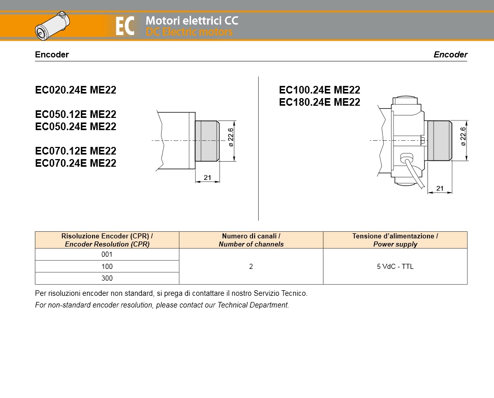

    I have an option to use an encoder with a 300 resolution but I must mount it ant the motor and not after the gearbox, so I will need to input the ratio in Simtools. Is it possible to use this kind of encoder instead of potentiometer ?
    Bellow are the encoder specs.
    Ty,
    Peter.
