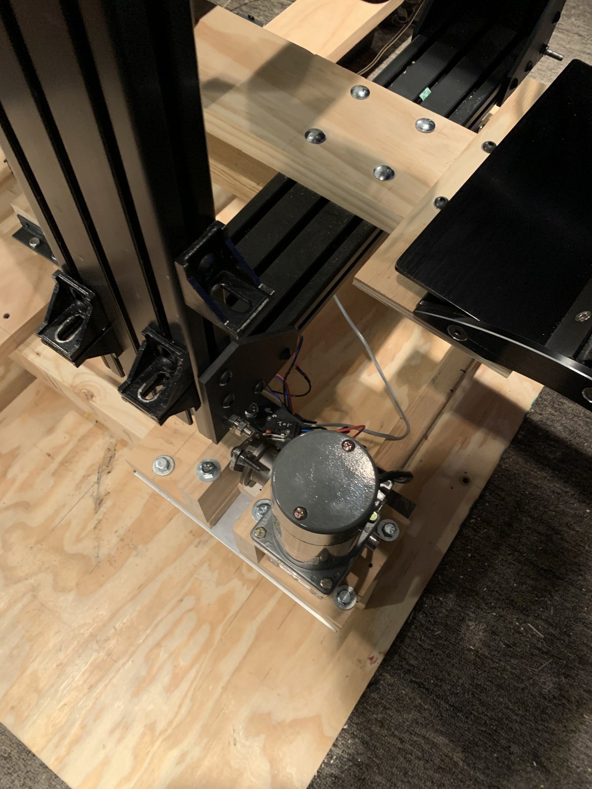

    On the moving carriage I have added a steel plate between the U joint and the wood centerpiece. This allows the bolts to be further apart on the center frame. The base is different and relies on steel braces rather than through bolts. This allows some adjustment to make the frame level overall and adds strength.
    The main reason I started over was that the motors I selected were pretty much destroyed. I knew from the beginning that they were marginal but I didn’t realize that the strength of the gearbox was going to be the limiting factor. I was concerned about the 8nM of torque and that was barely enough. Their biggest advantage was that they were only $80.
    I spent several months investigating lead screws as an alternative to motor levers. I decided that for a lot less time and money I could build a 2D lever rig with better motors and enjoy it. I did build a test leadscrew axis which I intend to use as a traction loss axis in version 2.1.
    In my motor search at that time I was intrigued by the RLV40 gearbox. This features a 14mm keyed hollow shaft and a variety of mounting options. The motor itself is removable and can be repurposed for a future 4 axis lead screw rig.

    Here is the entire drive unit:
    On the bench from with both drives:
    Top view on the rig:

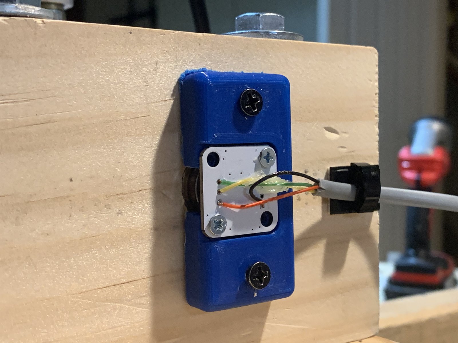

    Hall Effect position sensor in 3D printed fixture:
    This fixture holds the sensor exactly in the middle of the shaft. Another fixture is used to exactly center the magnet. If there is misalignment the Hall Effect response is not linear. I modified the code so that the 512 position on the sensor is done in software with a #define offset. Precise rotation of the hall sensor is difficult and imprecise.
    NOTE: This hall sensor uses I2C by default. This is a problem because the access time is an order of magnitude longer than accessing an analog input. Removing the resister puts the device in PWM output mode. This PWM output can be read by the analog input after passing through a simple low pass filter (one resister one capacitor).

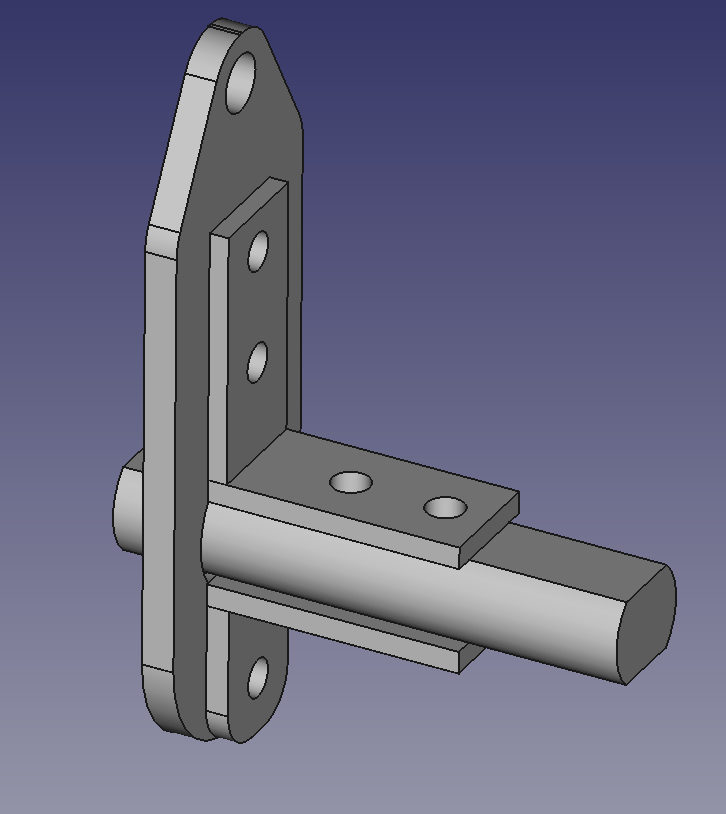

    An inherent problem with the lever drive is the “slack” in the drive. This is due things like the Heim/lever mechanism having flex in order to work and various other sources that might be correctable. The first is the connection between the motor and the shaft. This is a hollow shaft motor but it is keyed with a 6mm key. I noted that there was a tiny bit of play between the key, shaft and the motor. This play led to more “slack” in the drive. The oversize keys from McMaster Carr (6.03mm to fit in a 6mm key) greatly reduced that problem. At first I was concerned about disassembly but things pull apart easily with a pry bar or a slide hammer. OK, maybe not easily but also not a big issue with the right tools.
    A bigger concern was the play between the lever arm and the shaft. I used a keyed bushing but even with the oversized keys there was a lot of slack. I added a clevis pin through a hole which helped but was not ideal. The up side was that it was easy to try different lever arm lengths.
    So I decided to impose on a friend to mill flats on both sides of the shaft so I could assemble it this way:
    This worked fine and there is ZERO play between the shaft and the lever. The problem is that the milling took a long time. In retrospect it would have been less time to weld the lever arm to the shaft. Welding should work if you are sure about the lever length.
