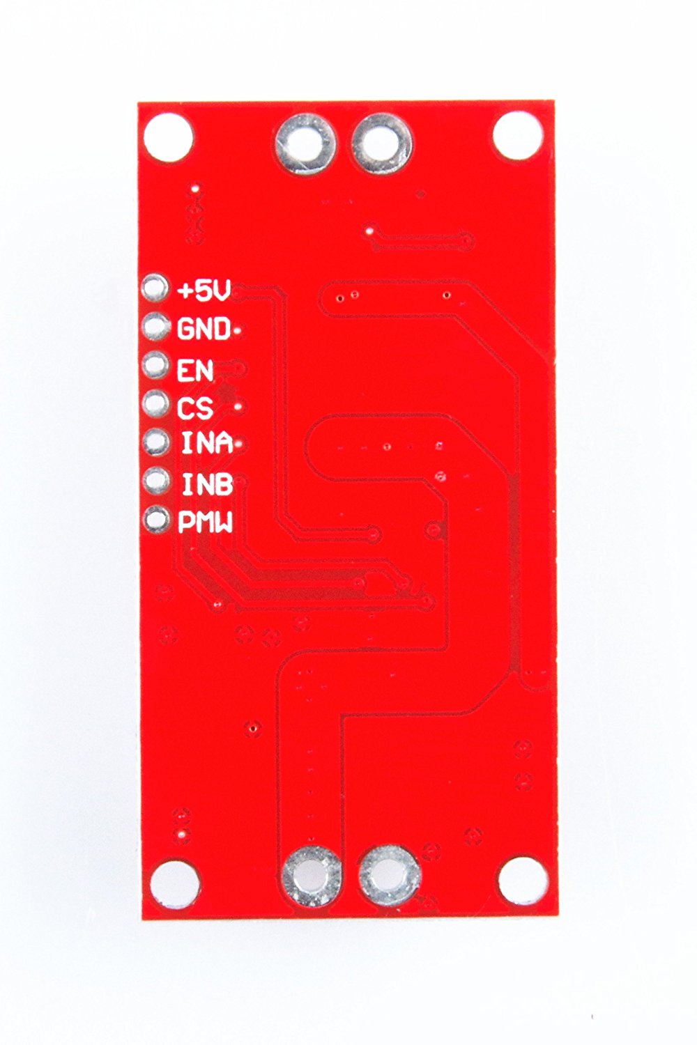

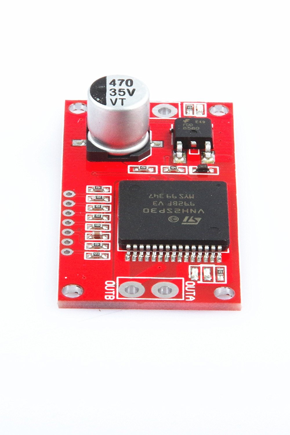

    HERE is some of the info on what the pins are but I really don't want to try it w.o knowing what they are for.
    VNH2SP30 pin definitions
    xxx[0] controls '1' outputs
    xxx[1] controls '2' outputs */
    int inApin[2] = {7, 4}; // INA: Clockwise input
    int inBpin[2] = {8, 9}; // INB: Counter-clockwise input
    int pwmpin[2] = {5, 6}; // PWM input
    int cspin[2] = {2, 3}; // CS: Current sense ANALOG input
    int enpin[2] = {0, 1}; // EN: Status of switches output (Analog pin)

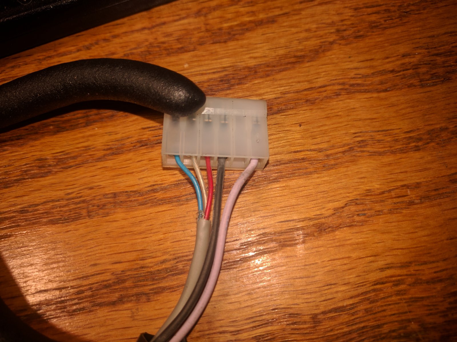

    that worked for the smc3utility ( i downloaded the .exe file the first time not the .zip) . Thank you. I figured out that it is my motor. It is an dc18v servo motor that runs fine on my psu set at 14v which is 2v under max for the vnh2sp30 chipset . it has a hall effect sensor that I was wondering if that can replace the potentiometer since that's the object of the the potentiometer. I know purple is V+ and black is V- its the order of the other 3 that i don't know. I'm assuming it's something like this but don't know how to get it to work.
    Plug: IMG_20170806_132249.jpg
    The last thing I am wondering. I checked the continuity from V+ to V-, and I have continuity. I was wondering if that would cause an issue with the driver. I can connect the motor to the PSU and it runs just fine backwards and forward.
