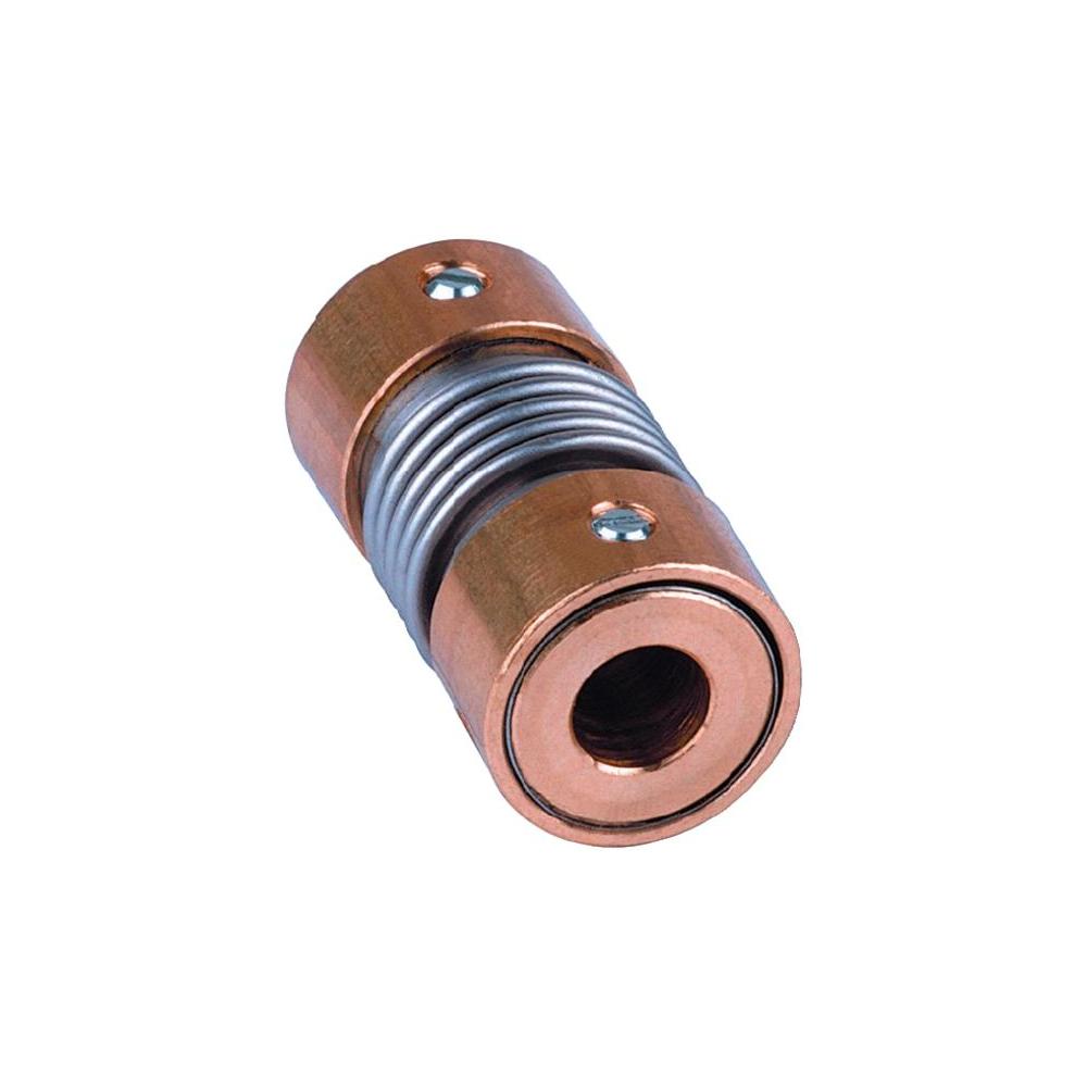

    Honestly a flexible coupling is a simple way to connect and protect a po and they come in all different sizes to fit almost any shaft: http://www.xsimulator.net/community/attachments/pit-jpg.14097/

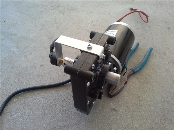

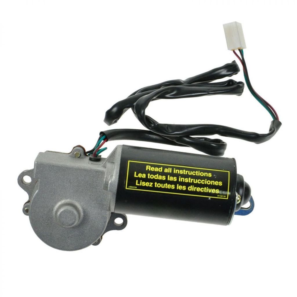

    @noorbeast hmmm how can I explean what I mean haha, ok in this first picture you can see the shaft where your rod would be attached to and on the opposite side you can see where they mounted the POT. Now in this second picture you can see that on the reverse side of a typical wiper motor it does not have an opening to the shaft, so how do you mount to POT there?
    image 1
    image 2
    I hope this makes more sense and you can see what im trying to say..

    There are a number of options then, though keep in mind the lever should not rotate 360 degrees in the first place unless something is seriously wrong.
    You could use gears to offset the pot and that is a good option if using a traditional pot, as it will add precision. Or you could make the bracket big enough that it clears whatever length lever you plan on using.
    My advice is to study all the available information and follow it, check everything carefully and be conservative with initial testing. That way a 360 rotating lever should be a non issue.

    wait I think I am just over complicating this in my head... Please correct me if I am wrong @noorbeast , the POT does it just monitor the angle of the shaft coming out of the wiper motor? if so then all I would need to do is flip that bracket around and set my motor in a way that I get the desired angle for my POT and then mount it correct?
    sorry this all very new to me but I am very eager to learn.

    Yes that is correct, and there is nothing wrong with asking questions. There is a lot to get your head around but also a good deal of existing documentation, FAQs and existing member builds to use as resources.
    Keep in mind we tend to use the term pot loosely here to refer to both traditional potentiometers and hall sensors. Like many others I use hall sensors as they are simple to direct mount, are very accurate without gearing and won't break if over rotated.

    how would one go about mounting a hall sensor? or even If you could point me to a thread that would be great.
    21,498
    150,608Coins
    +11,017 / 55 / -2
    A hall sensor looks like a normal pot and is mounted the same way, on a bracket attached to the motor, preferably with a flexible coupling to the motor shaft. That is a hall sensor in the picture of my 60:1 setup you posted earlier: http://www.xsimulator.net/community/threads/wiper-motor-selection-and-pot-mounting.6985/#post-80207
    This is how I mounted the same hall sensors on 25:1 gearboxes, which conveniently had 2 spare holes at the back of the gearbox to which I bolted the simple aluminum brackets: http://www.xsimulator.net/community/threads/dx-racer-compact-simulator.5866/page-5#post-65728
    I used 25x2mm thick aluminum for making the brackets, they just need to position the pot not be super rigid.
