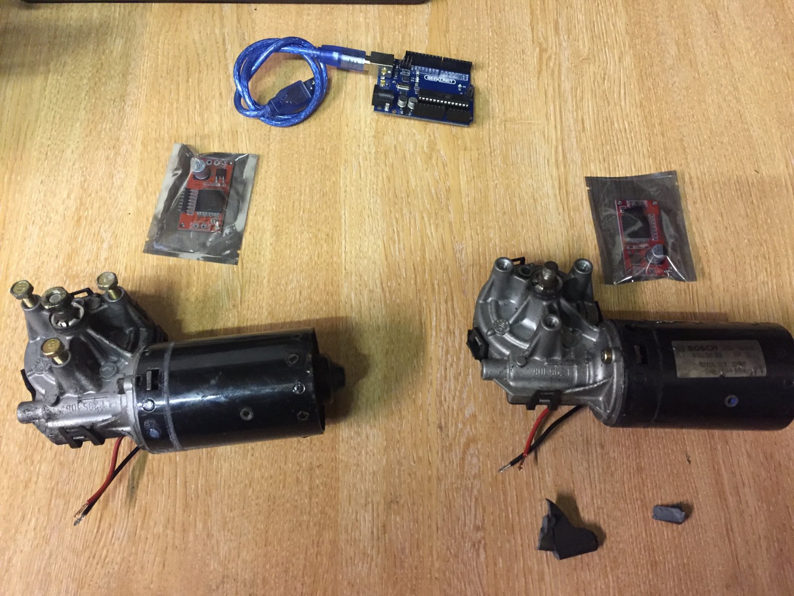

    Just starting my build and have purchased some used wiper motors from eBay.
    Bosch 0 390 241 358, from a Rover 75/ZT, so whilst not a truck or very large car its a reasonable sized saloon and I thought Bosch might be a reasonable build quality.
    Anyway when modding the ground isolation, it became apparent that the magnets on the stator of one of the motors were basically shattered into about 6 pieces. I have removed the loose pieces (see photo) and the motor does still run but it is noisy and I guess will make less power or speed, so needs replacing.
    I also noticed that the helical gear in these motors are plastic, (not sure if that is important) and the output shaft has a fine spline which isn't ideal to interface with for something homebuilt.
    So before I go and buy a replacement of the same type, I was wondering if anyone has a go to list for a model of specify wiper motor or a specific car (sold in the UK preferably), that uses good wiper motors.
    Andrew

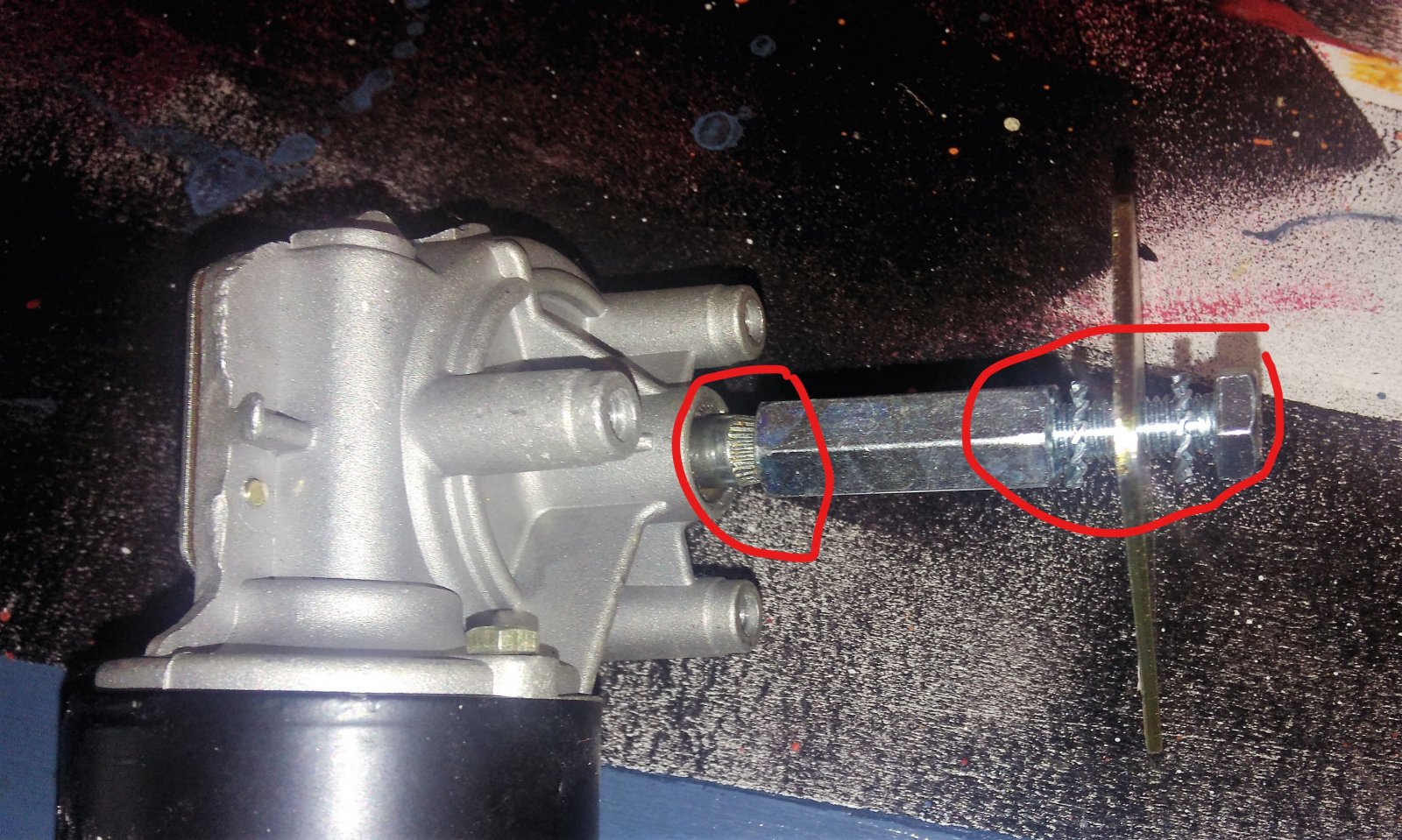

  8. Blame73
    Blame73 Well-Known Member
    Nov 6, 2014
    1,210
    8,255Coins
    +1,105 / 2 / -0
    This is how I'm making my shafts, and where I put glue for metals

  12. ajbrass
    ajbrass New Member
    Nov 8, 2016
    6
    Burntwood
    206Coins
    I guess you mean thread lock when you say glue. Something like Loctite 272 can hold 17ftlb of torque. I think the wiper motors do about 13ftlb on high speed, 17 on low speed, so with some tightening onto the shoulder on the shaft I can see how it would hold. Think i might put a flat on the shaft also though.

  15. Sinan Keskin
    Sinan Keskin Sinan Keskin
    Aug 24, 2016
    12
    journalist
    Turkey
    171Coins
    2DOF, DC motor, SimAxe, Arduino, Motion platform
    this is my wiper motors, 12v and big one 24volt
