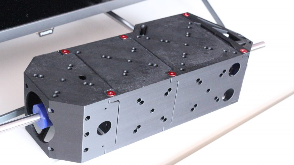

    Hey ! I developped a 3D printed H pattern gearbox that is the best gearbox of the world :
    PRESENTATION:
    The best gearbox in the world:
    • 6-speed H-box + reverse gear
    • Sequential (we go from one to the other in 3 seconds)
    • Clutch mode (optional): if you don’t press the clutch pedal, the gearbox stays locked (only in H mode)
    • Multiple attachment points (from underneath and from the side)
    • Adjustable front-rear and left-right feeling
    • Adapter to mount a hand brake (P1)
    • Possibility to connect pedals to it
    • For about 140€.
    All the documentation is available on the website !

    Do you know a gearbox that offer so many points of attachement ?

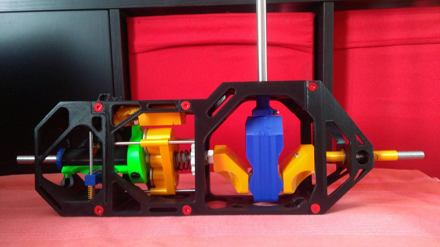

    Fastener integration is now complete. A few points may be added as we go along, but as it stands, the possibilities are numerous.
    The movement is smoother than before thanks to the use of round axes instead of threaded rods. There is still too much friction on the forward and backward movements for the sequential mode to be satisfying.
    So we will have to rework the front-rear tracks and probably the large triangular part.
    It is also necessary to develop the wedges in order to be able to assemble the mechanics precisely.
