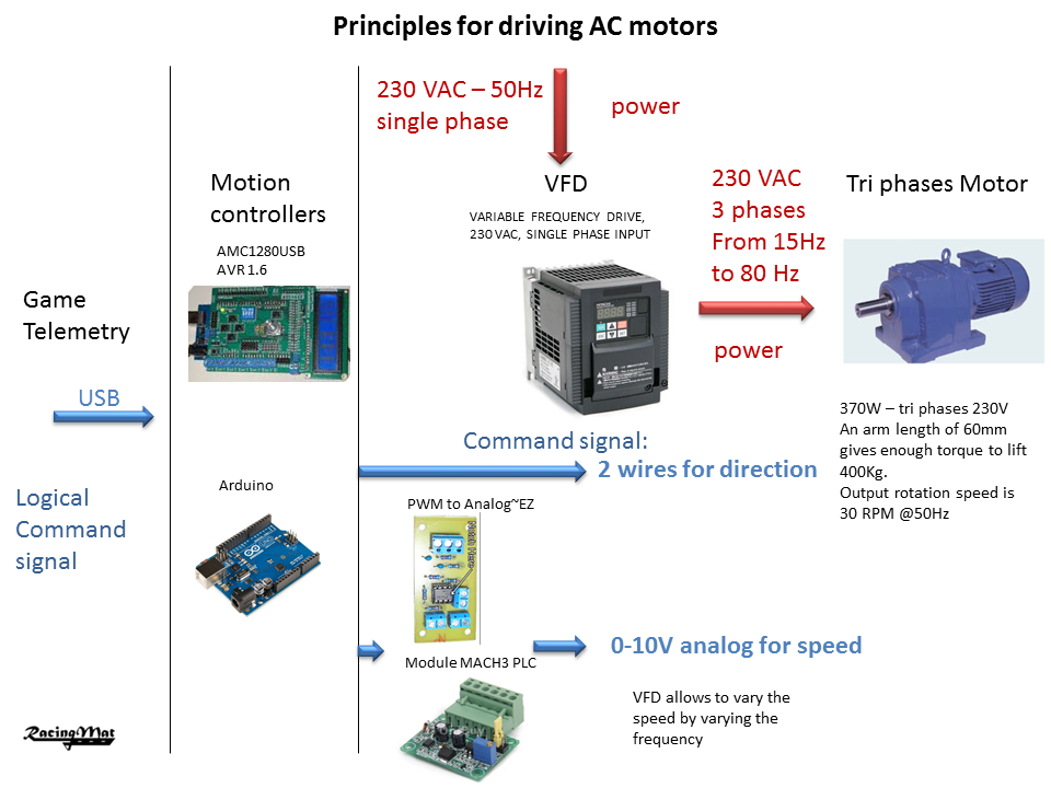

    Hello!
    I'm wondering if I could go the AC route?... So I gathered some information that I'm sharing here:
    First, the posts from @speedy as a reference:
    Second, the principles:
    Third, hardware to convert PWM signal to analog signal required by the inverter
    see the FAQ pwm-to-analog-signal-to-drive-vfd

    Hi folks,
    It took me over a year to source my 3 - 1hp Motors (MicroMax) and Boston Gearheads - 60:1, and they are built like a tank.
    My cost on these units were about 325.00 per Motor/Gearhead...............which is at least 1000.00 less per motor/gearhead if I bought them all new.
    PLEASE NOTE: Not any 3 phase motor will do............they MUST be INVERTER DUTY motors to be able to stand up to the constant forward/reverse functions required.
    An inverter duty motor is heavier built and has higher heat dissipation than ordinary motors.

    Historiker,
    From all I understand and have been told, all 3-phase motors are reversible.
    The catch - Continuous can be reversed.............but when we simmers are asking for a massive amounts of forward/reverse, it just beats the hell out of a continuous motor and the heat then becomes
    a real issue.
    - My manufacturer of my motors and VFD's state that you must use an inverter duty as well as many other threads that I have visited. It sure makes sense as my motors are very
    heavy and has a large fan on the rear to dissipate heat................must mean something.
