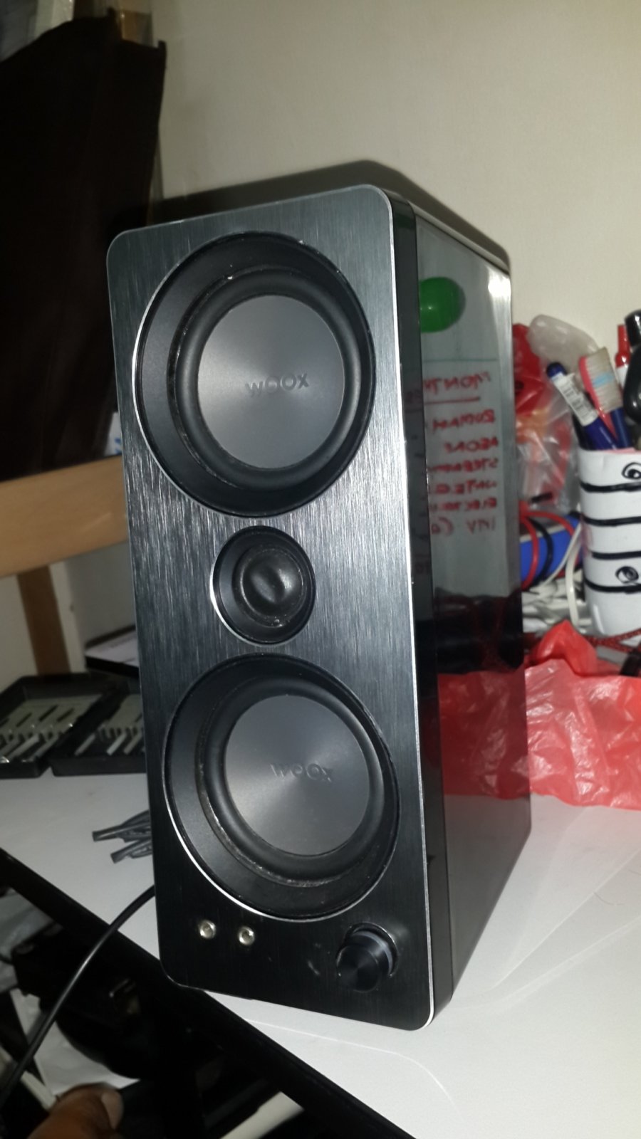

    1) used philips SPA8210 multimedia speakers (which will act as my amplifier)

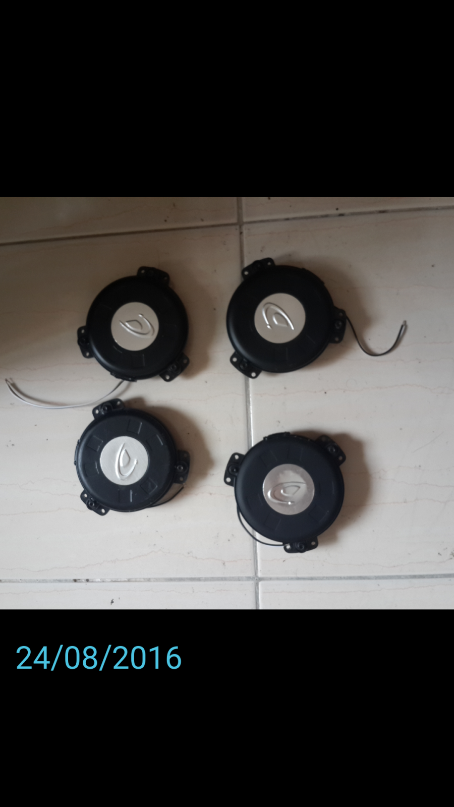

    2) 4x Dayton TT25-8 Puck tactile transducer mini bass shaker (im using 8ohm)

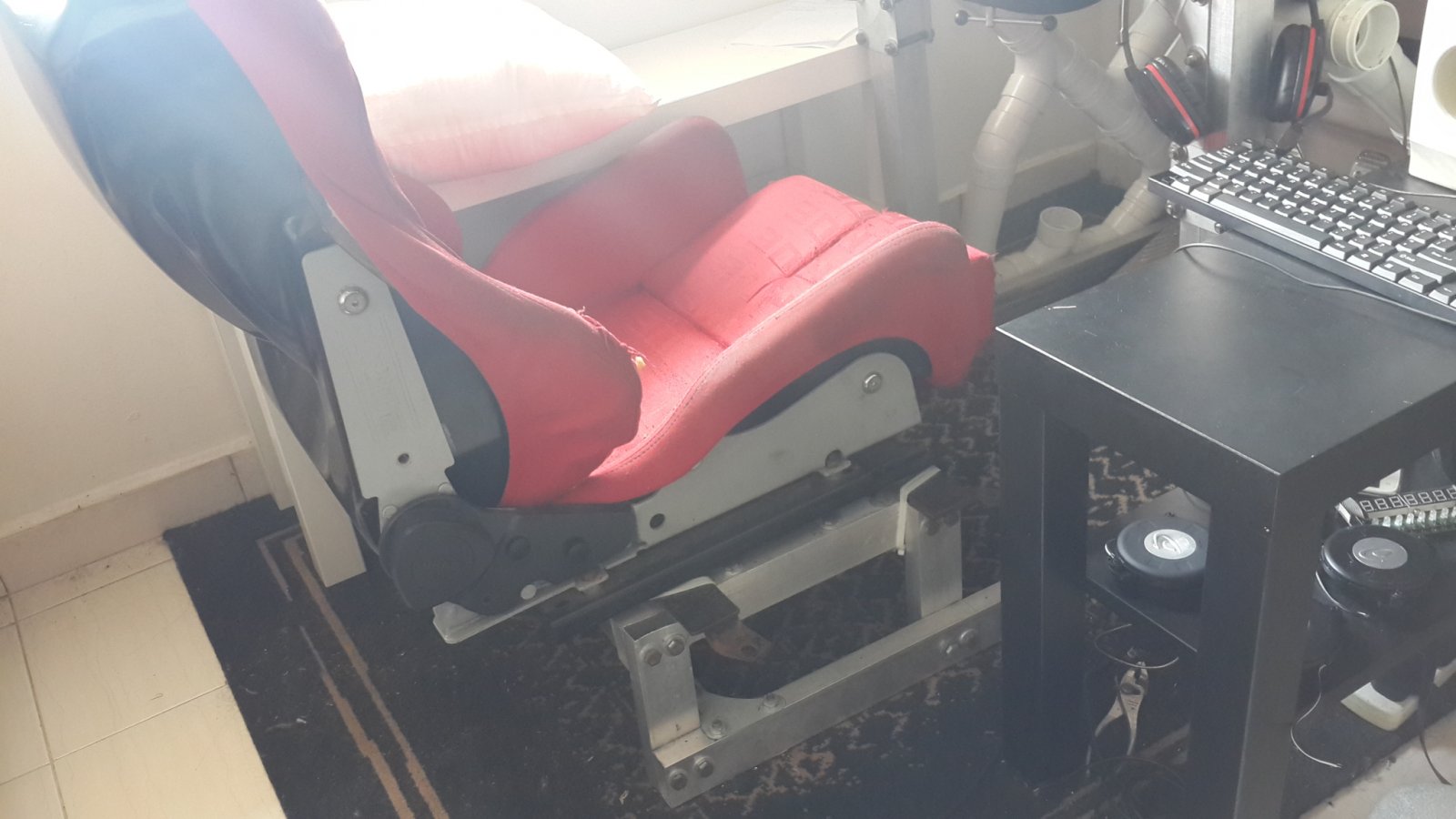

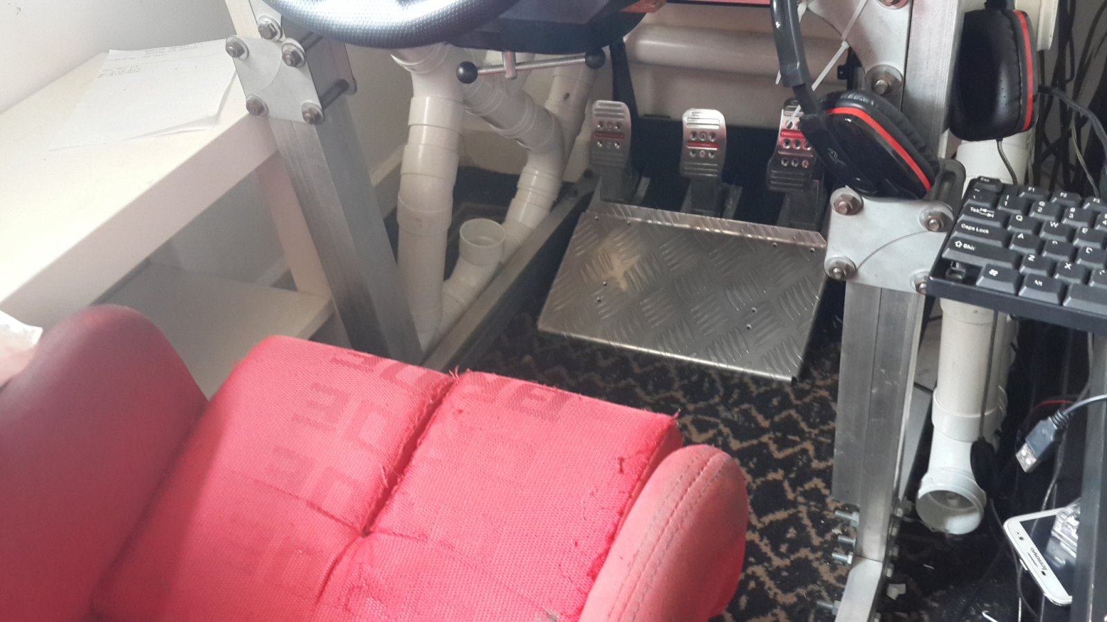

    im going to place it 2unit at my pedal set...and 2unit below my bucket seat..this is my roughly idea of placement..will do some experiment with it

    i disassemble my philips multimedia speaker and mod to support as a amplifier for my 4pcs dayton puck transducer..so the specification for the transducer is 15watt/16ohm per unit. and my multimedia speaker provide 20watt/8ohm per channel (having 2 channel left & right)...my plan is to use 2pcs of transducer per channel so the 2pcs of transducer to be wired parallel to get 30watt/8ohm to match with my out amplifier..yes it getting insufficient power about 10watt less..but still it will run (and also thats the only amplifier i have now..duh)

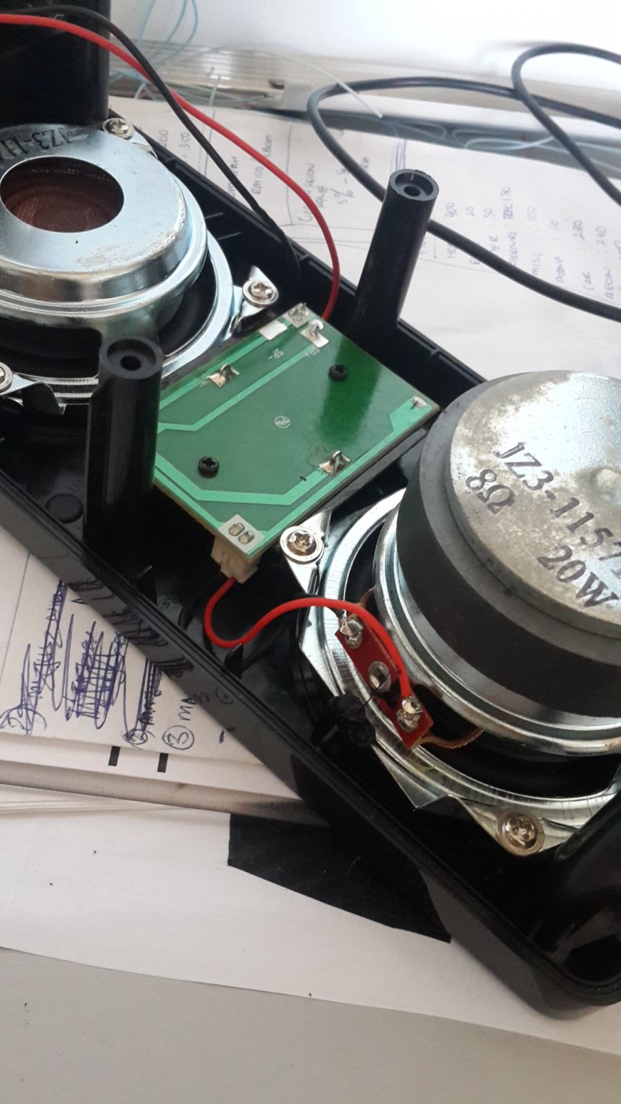

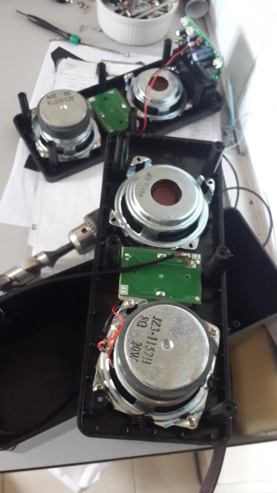

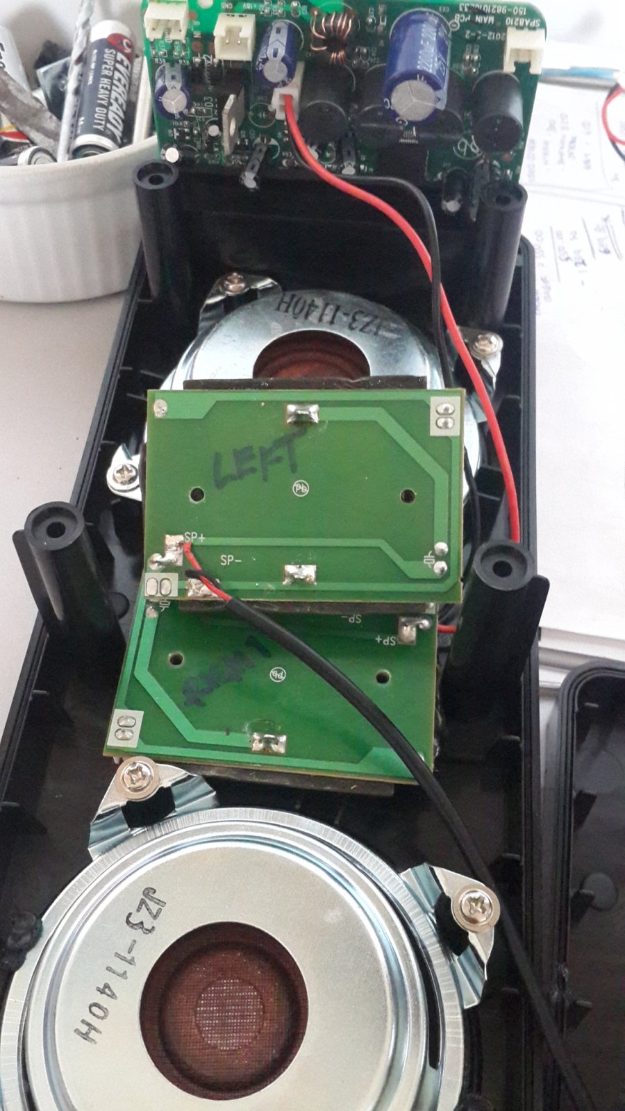

    the inside of the philips multimedia speaker...i was shock that 1 of the speaker is dummy!!...theres no wire and magnet!!..how could they do this just to impress the outer of the product..
    next to get rid of all the speaker and remain the dummy speaker there to cover the speaker whole...
    and owh yeah...this is the main speaker with volume and power supply with inside the RIGHT SPEAKER BOX
    cut or unsolder the wire connected to the speaker cus we will need the speaker wire..
    there!...dummy speaker inserted!!...i wonder how the sound will feel..duhhh

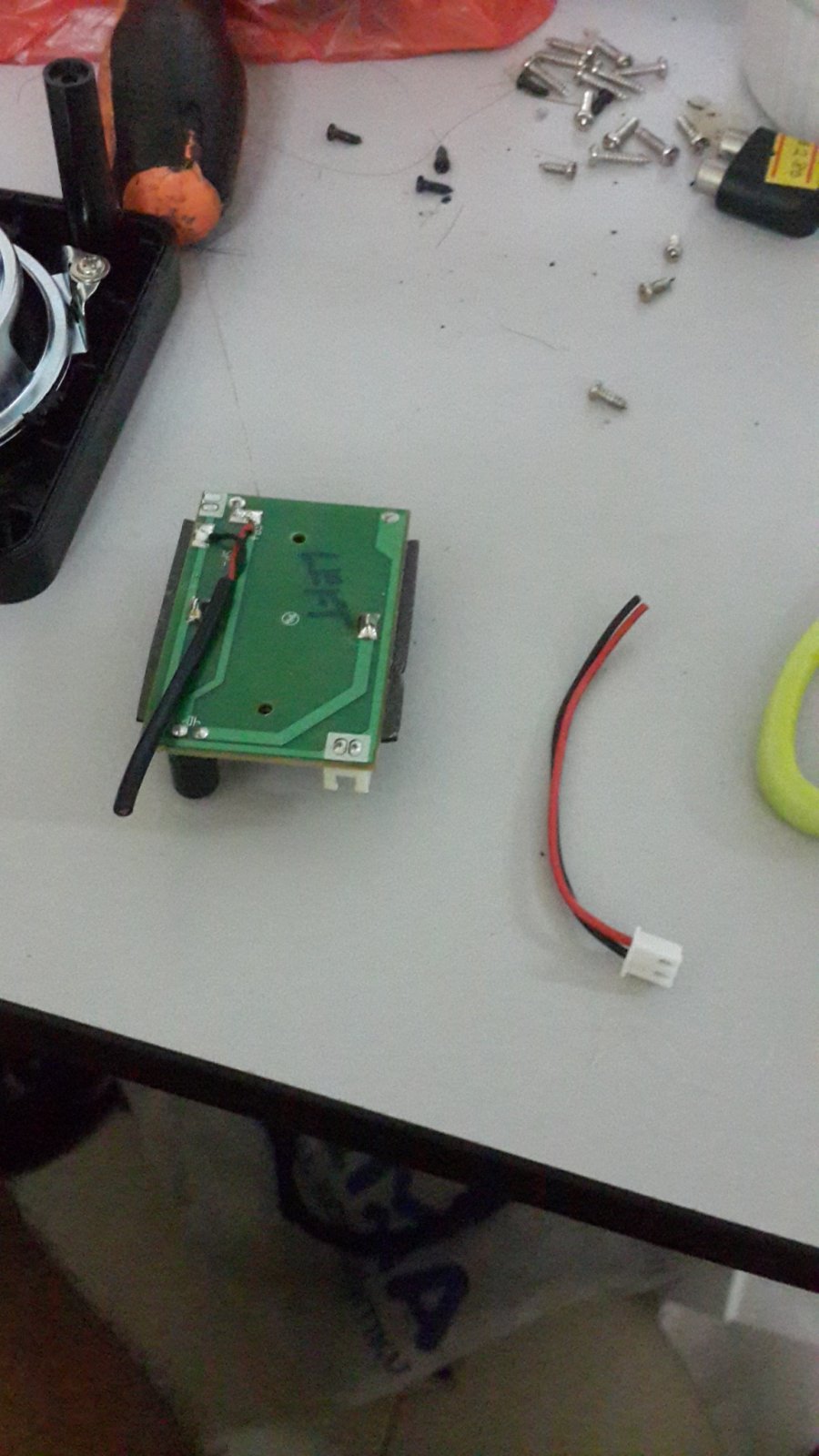

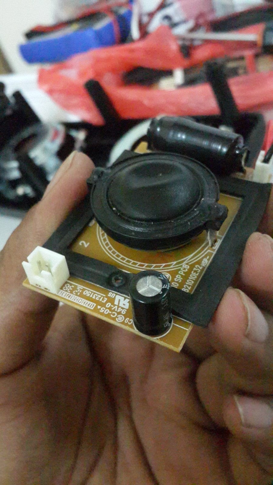

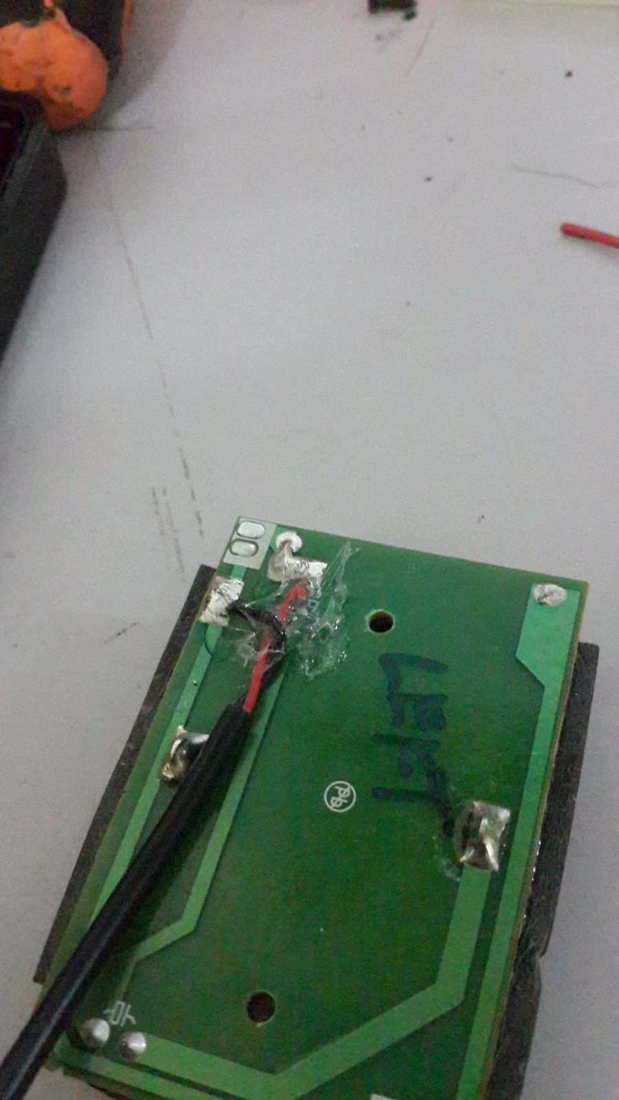

    so you need to take out the green board at the LEFT speaker...just cut the wire like in the picture below...
    and also remove the small capacitor on BOTH LEFT and RIGHT green board to disable the small tweeter speaker
    20160824_195330.jpg dont forget to take out the speaker wire on the LEFT speaker too
    Small capacitor that need to be remove on both board

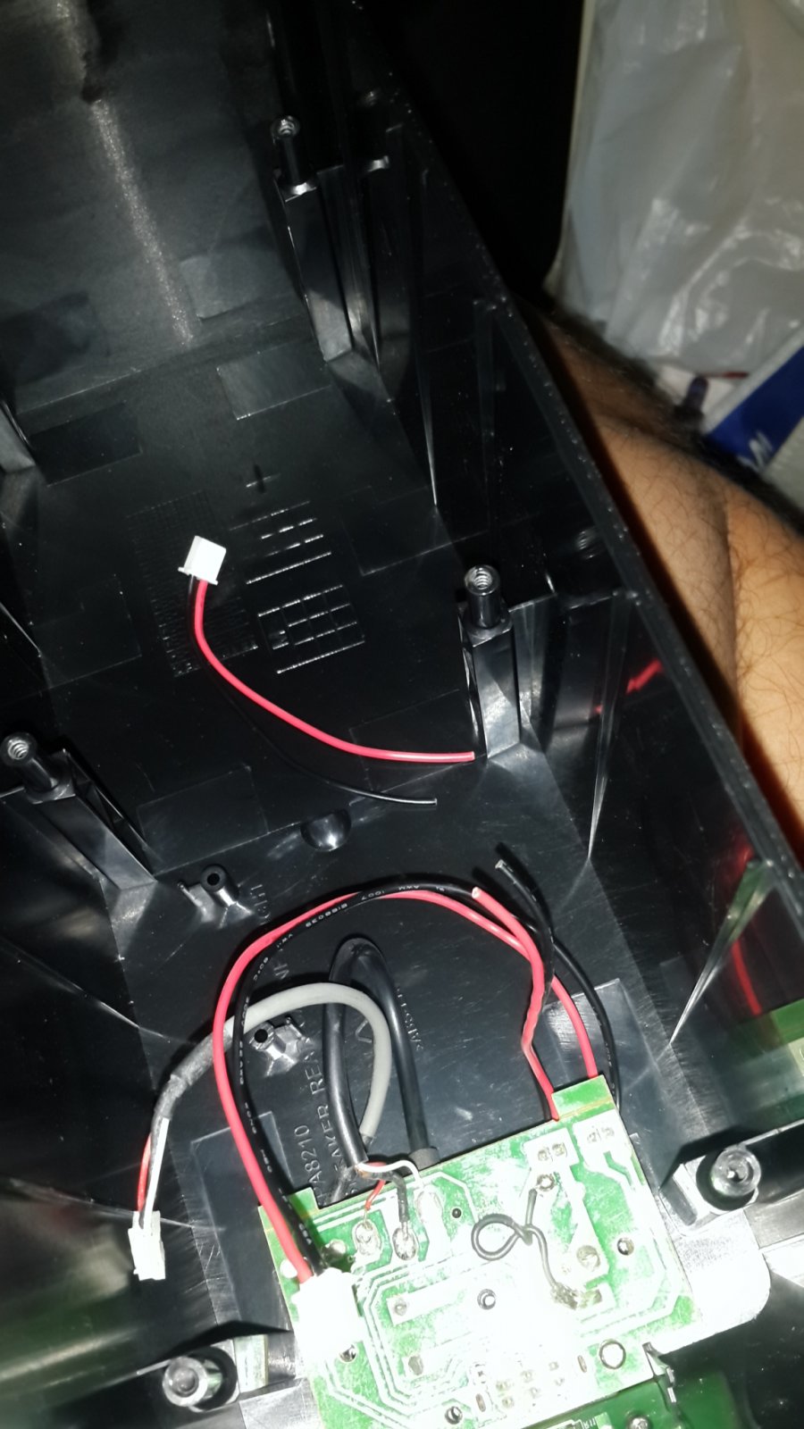

    Next is to cut the red and black wire in the right side of the power supply board ON THE RIGTH SPEAKER BOX
    as u see here..it has 4 wire...cut the rightest..not the 2nd wire from the right..i mistakenly cut the wrong wire..LOL..we going to need the connector only..
    take the connector Then join to the wire you cut at the LEFT board wire earlier
    after joining it together..connect the connector to the RIGHTEST PORT (above SPA8210 label)

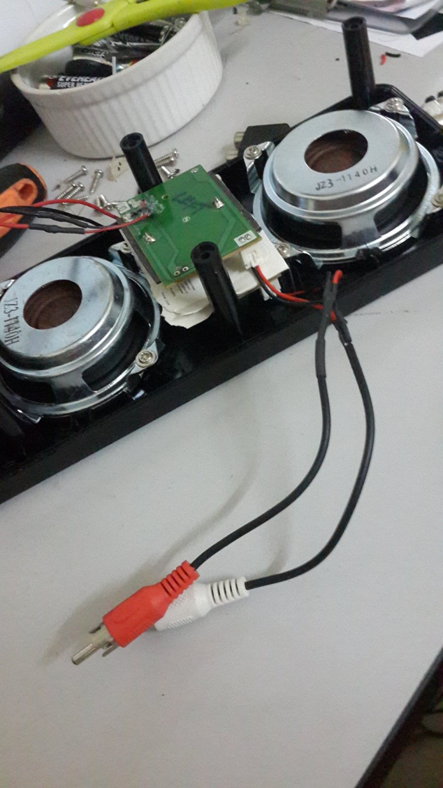

    Stack both green board together with glue..

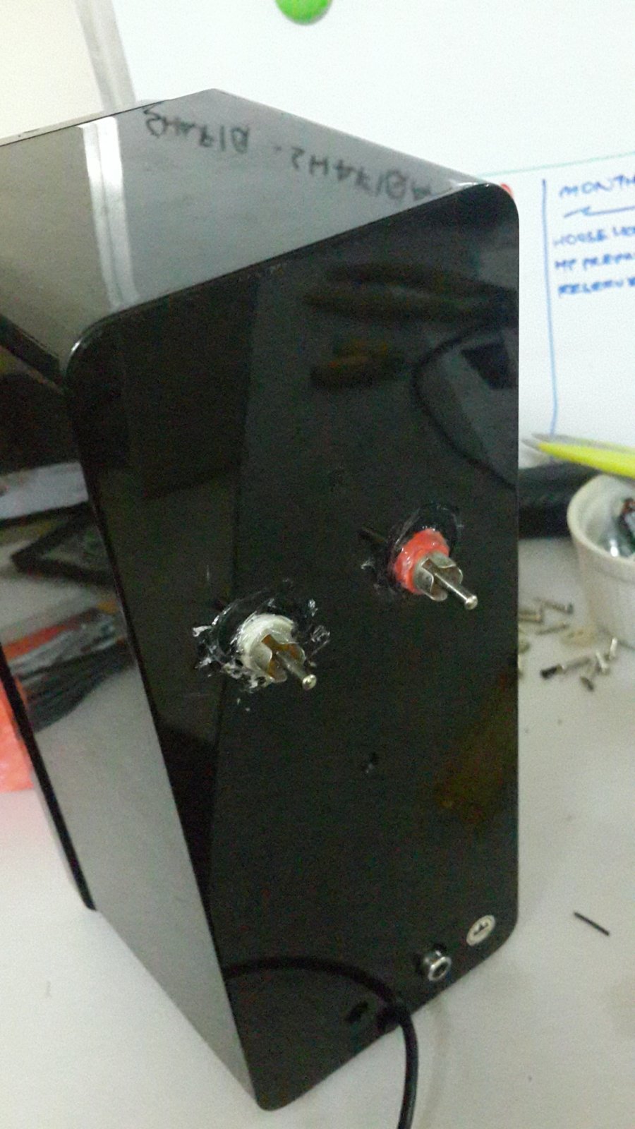

    take the FEMALE UNUSED RCA HEAD (im using male head because i dont have female head) and wire/solder the together with the speaker wire you cut earlier...after that connect the connector to the green board like in the photo

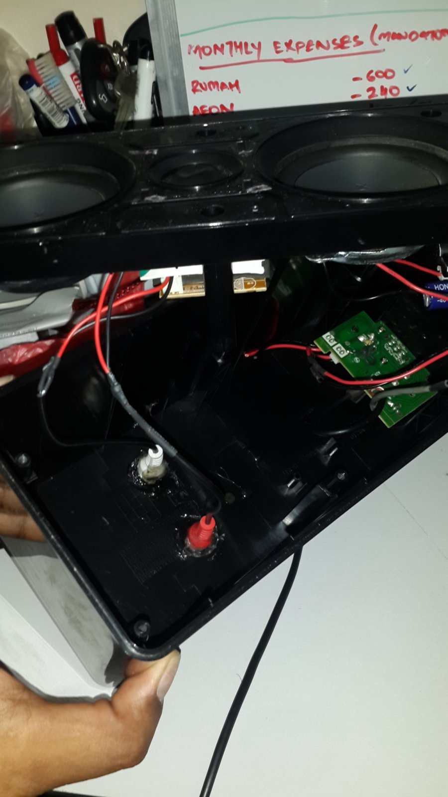

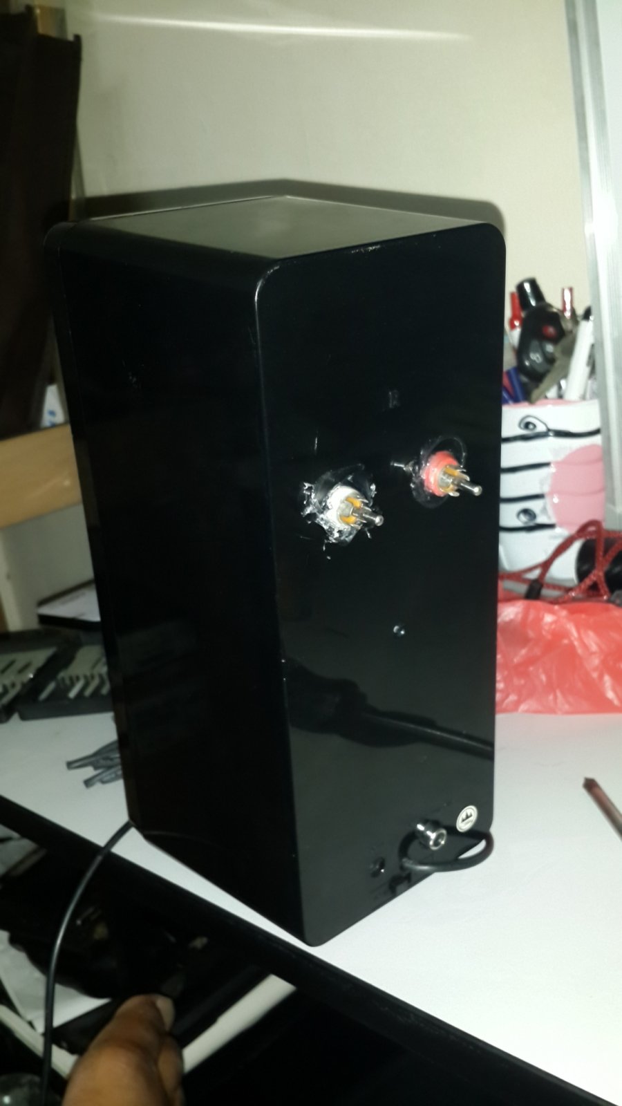

    Drill the hole and put the RCA head there
    Assemble everthing together and now you have ur DIY amplifier for transducer
    The LEFT & RIGHT RCA output will be connected to ur transducer...2 transducer per channel..REMEMBER THAT
