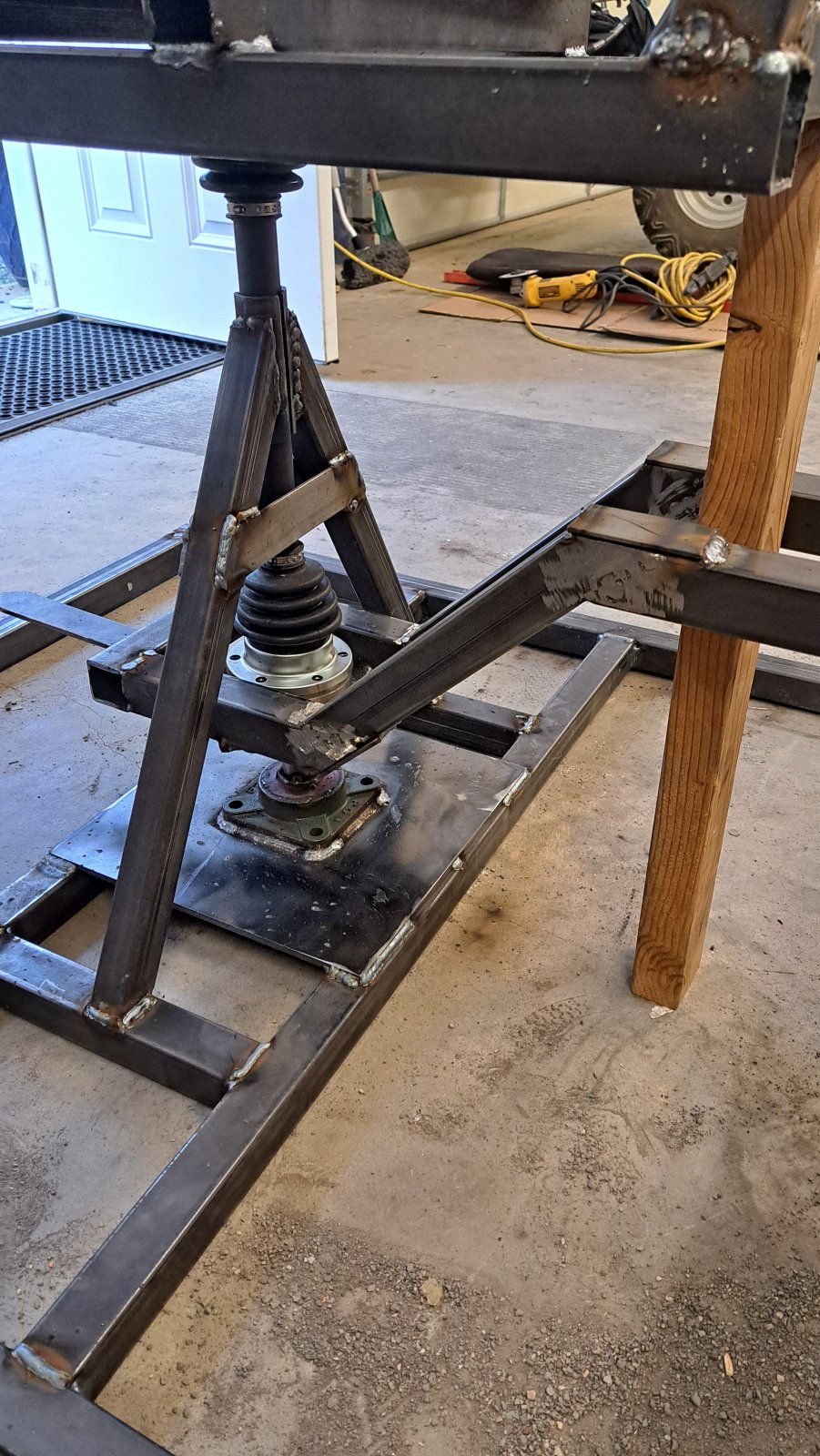

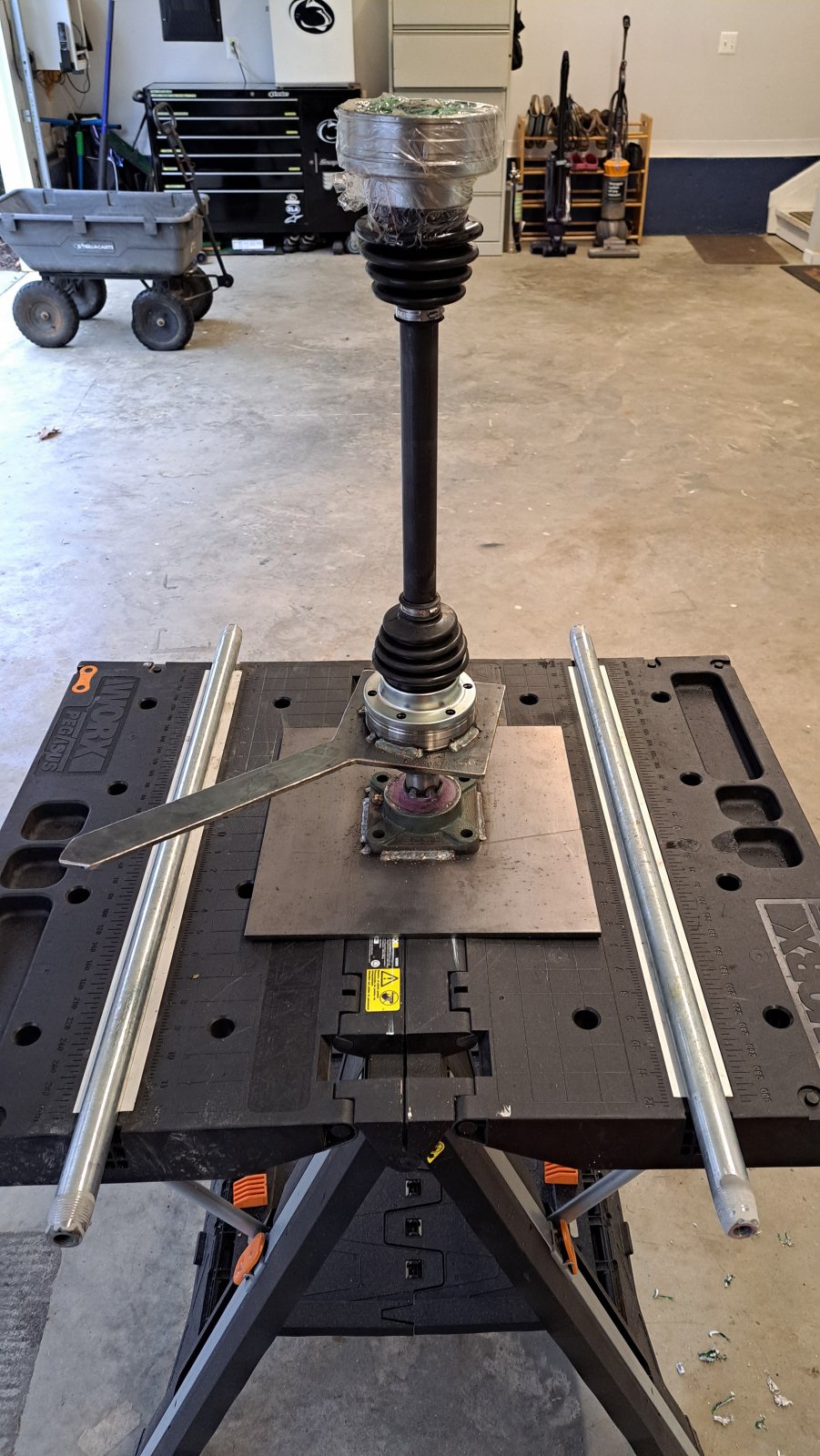

    Pressed bushing (1-1/4" diameter) into the 2 block bearings. Cut the yaw arm out of the 1/4" steel plate with cutting wheel. Welded them all up this afternoon along with the CV axle and it swings nice and smooth. Finishing up my pitch and roll rods as well. Brought the seat (X Rocker Nemesis and seat plate up to the garage a few minutes ago. Still have some last checks of measurements and will weld that up on top of the CV axle. Probably won't work on it anymore this weekend, my mixed gas bottle is running very low. Will exchange that on Monday after work and hopefully have a seat frame to show off as well.

    https://photos.app.goo.gl/f3JRy7RCCRK5iLxs6
    Here's the latest progress. Took some close ups of my center of gravity yaw lever system to clarify how this is going together. Now, the bottom frame cross sections are not welded in, neither is the bottom plate to the cross sections. It's all just propped up on there. Here's some questions to pick your brains. My pitch and roll rods are 30" in length (rod ends not attached). Having said, would mounting them halfway up the seat back be a suitable point? If not, I could always raise the motors by building platforms for them, but I'd rather not if not necessary. Also, I've noticed a majority of shoulder mounted rod setups have around roughly 5 degrees of angle. My next step is permanently welding the base cross sections in and I'd like to get some input to get me in the ballpark so I can get these motors mounted, pinned to the seat back, and start the pedal/monitor frame. If y'all have any questions for me, fire away.
    21,497
    150,602Coins
    +11,017 / 55 / -2
    You can use tools like SimCalc to help get your head around the tradeoffs in design Vs physics: https://www.xsimulator.net/communit...e-linear-speed-and-forces-of-your-design.270/
    Or Motion Visulizer: https://www.xsimulator.net/community/faq/motion-visualizer.389/
    I gather from the photos this is designed to have a yaw rotation, if so how do you plan ensuring the rear motor rods don't bind, and manage the geometry change? Are the rear motors going to be mounted in some manner so they are unaffected by yaw?

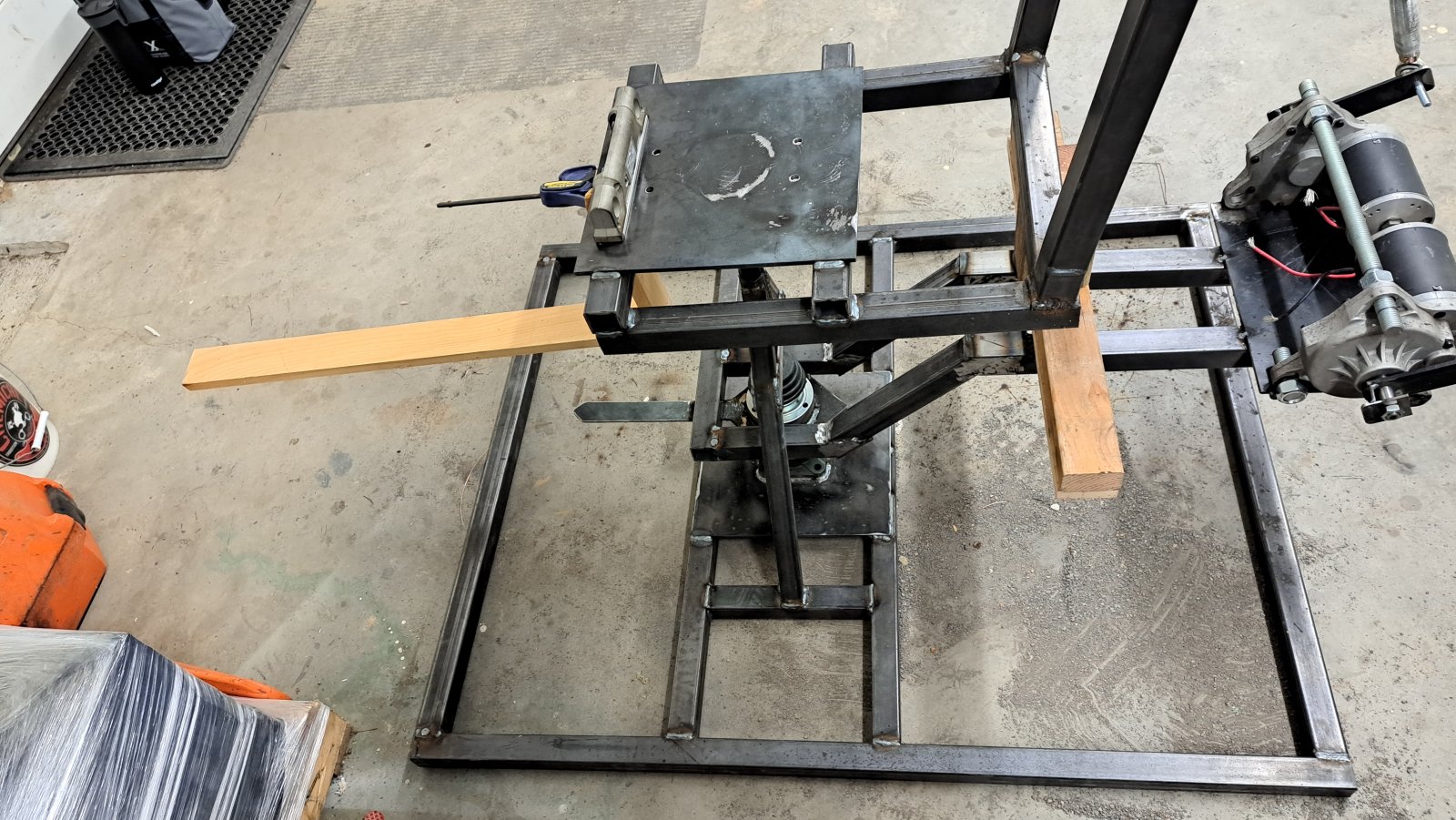

    https://photos.app.goo.gl/64rvvAiP1kqo1bQC9
    I've given that some thot. I pressed bushings into my rod ends to allow extra throw for the rods. I figured that way if I had to have the rod ends at the shortest position, it would still allow the full 22° of bearing travel. One thing I haven't looked into yet is setting the yaw motor travel distance. To be honest, I don't intend to have it swing more than a few degrees. Just a lil more than enough to feel the rotation. So if simtools pro (already purchased, never used) allows to set travel limits, things should work out well.
    21,497
    150,602Coins
    +11,017 / 55 / -2
    You can add spacers to give Heim joints a bit more travel clearance.
    But there is also the question of yaw messing with the geometry of the rear motors.

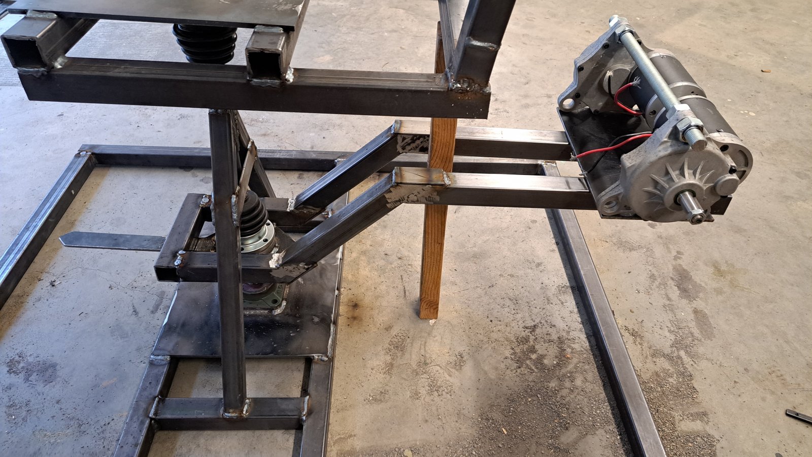

    I think I understand your concern with motor geometry. Are you speaking of the rods/ends locking out? If so, all I have done so far was make 2 marks on each seat back rail, tilted through full range of of motion, and held in place while manually swinging yaw lever. I was pretty surprised how little "sway" there was as I eyeballed the marks on the seat back rails. If youean something other than that, please let me know. Thanks again!
    21,497
    150,602Coins
    +11,017 / 55 / -2
    What I mean is that if the back motors are mounted to the bottom frame and the rods to the seat, when yaw rotates it will in effect lengthen the distance of one rear rod and shorten the other, introducing false motion cues.

    Loud and clear. I think I will be ok there. My process is going to involve pinning the seat frame at the farthest point of travel in pitch and roll, then manually yaw to see just how far the bearings allow the rod ends to rotate through and/or around the bearing bolts before rod length becomes affected. I'll be doing this at both full fwd and left, the full aft and right.
  13. noorbeast
    21,497
    150,602Coins
    +11,017 / 55 / -2
    Any amount of yaw would have some impact on rear motor geometry, introducing false motion cues.
    The other alternative is a mid fame mounting the rear motors, which would be unaffected by yaw.

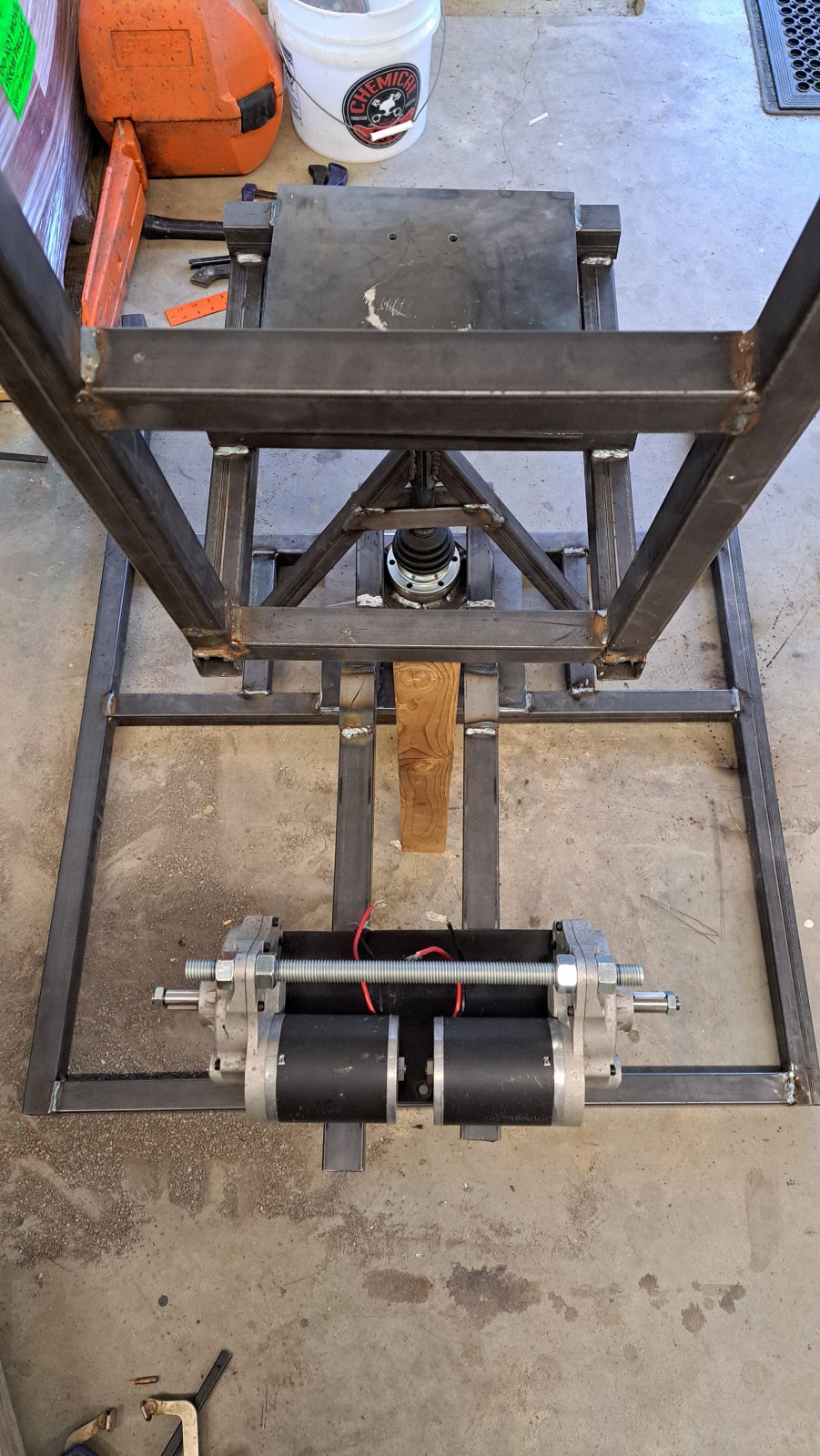

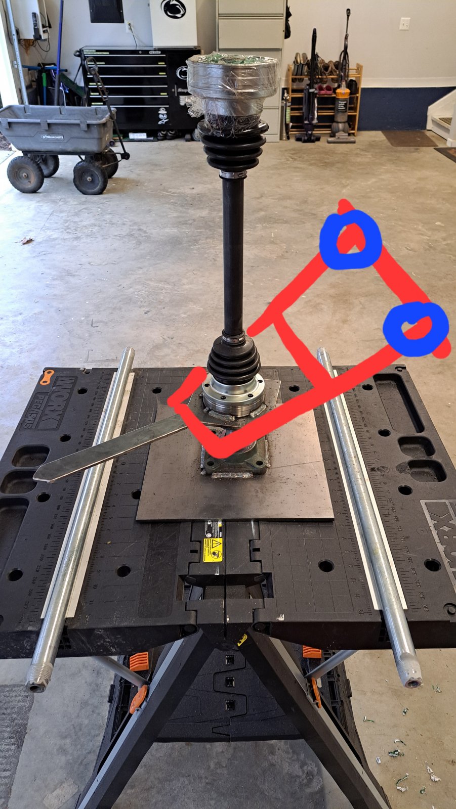

    I should have listened to your first post and provided a sketch. Yes, there will be a mid frame attached to the yaw plate dedicated solely to the 2 rear motors so they swing with the seat frame. I got so tunnel visioned about asking advice for rod angles/motor height I completely lost sight of that. I'm at work now, and I understand 100% what you would like to see. I'll draw up the yaw plate/motor mount design on next break and post it.
  15. Buj818
    Buj818 Member
    Jan 15, 2024
    51
    282Coins
    +12 / 0 / -0
    Motion platform
    Here's a quick photo edit of the motor frame that's going to be welded to the mid plate. The blue circles rep the motors. Being the mid plate is only 6-1/4" above floor level, the motor frame will be slightly angled upwards to allow full pitch up clearance and not slam the motors into the ground. They are already cut at 36" in length, which will be plenty long to achieve pitch and roll rod angles, it's just the angle degree itself that is confusing to me. Aside from the 5° I commonly see here, another recommendation I see here often is to just make sure the motor lever and control rod form a 90° at center. I guess I can start by combining them both, having 5° on the rods as well as a 90° at the connection. Thoughts?

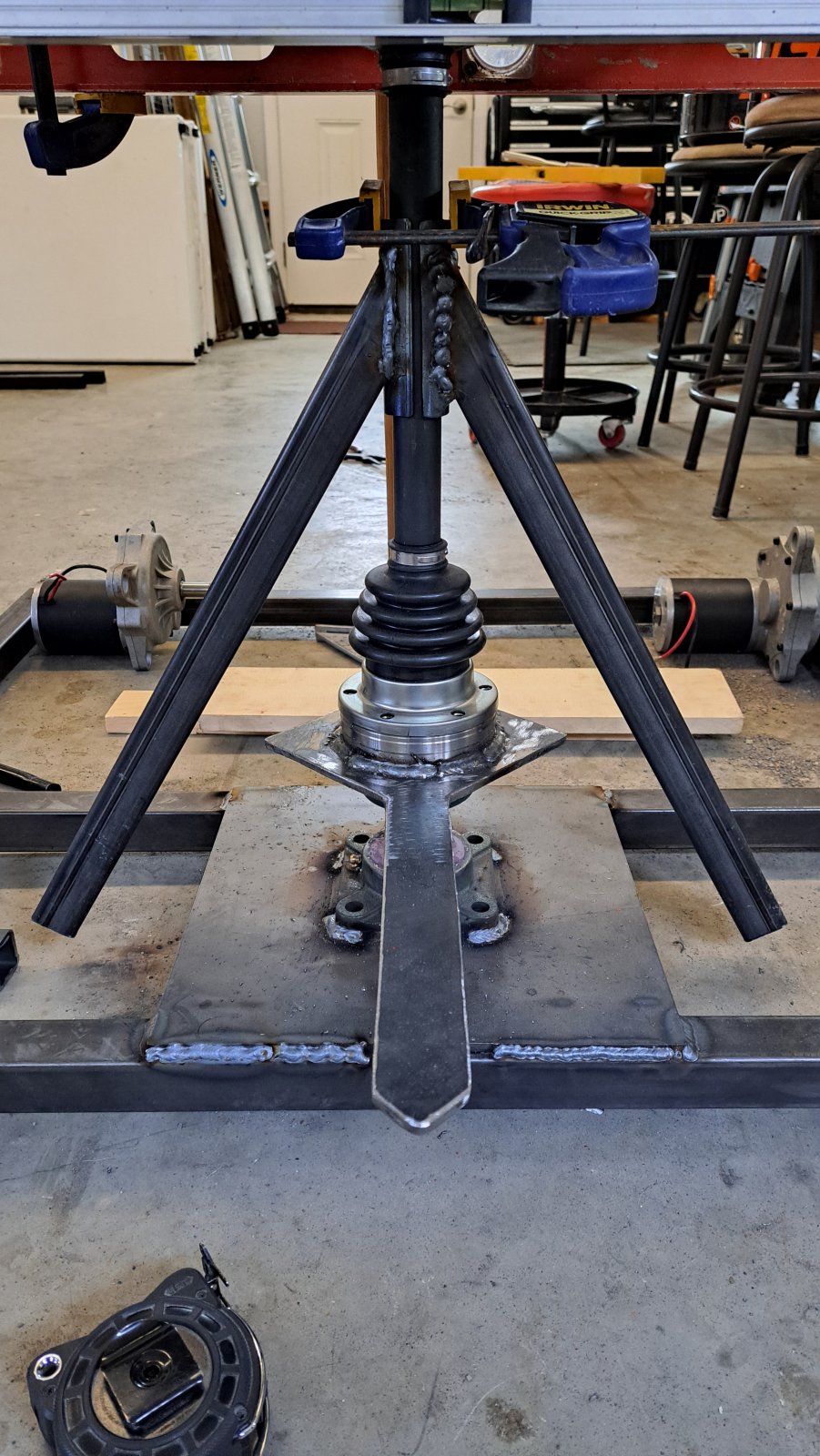

    Here's today's work. Braced the axle, added some supports, and attached the motor mount frame. Going to add 3 cross braces to it, but nonetheless it is already extremely solid. The upper frame gets the full 22.5 degrees of travel in all directions. Mount plate is not permanent yet, gotta put on rod mounts and get angles first. Left plenty of length on the mount frame so I can slide plate back if need be. 20240219_172356.jpg 20240219_172341.jpg 20240219_172326.jpg I tilted the seat back and stood on the motor mount frame and bounced a few times. Not a single squeak. Very happy about that. I didn't measure the yaw travel yet, but I can already tell it swings a lot more than I plan to set it at. Finished fab'ing for today, but I'ma grab something to eat and maybe I'll start figuring out where/how I'm going to mount that yaw motor.

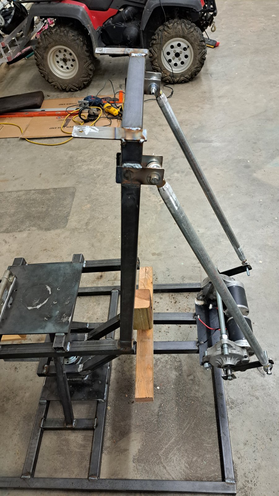

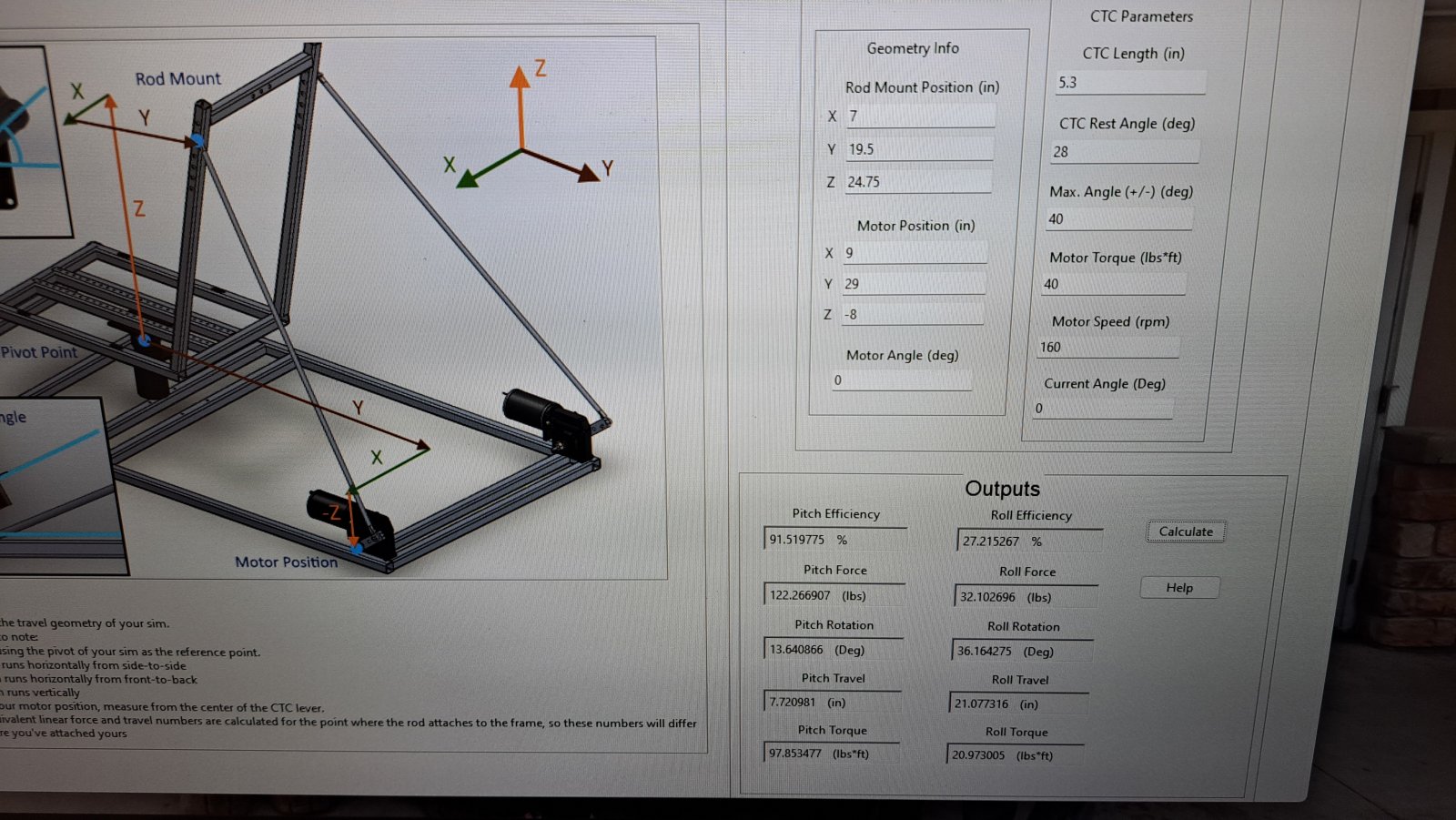

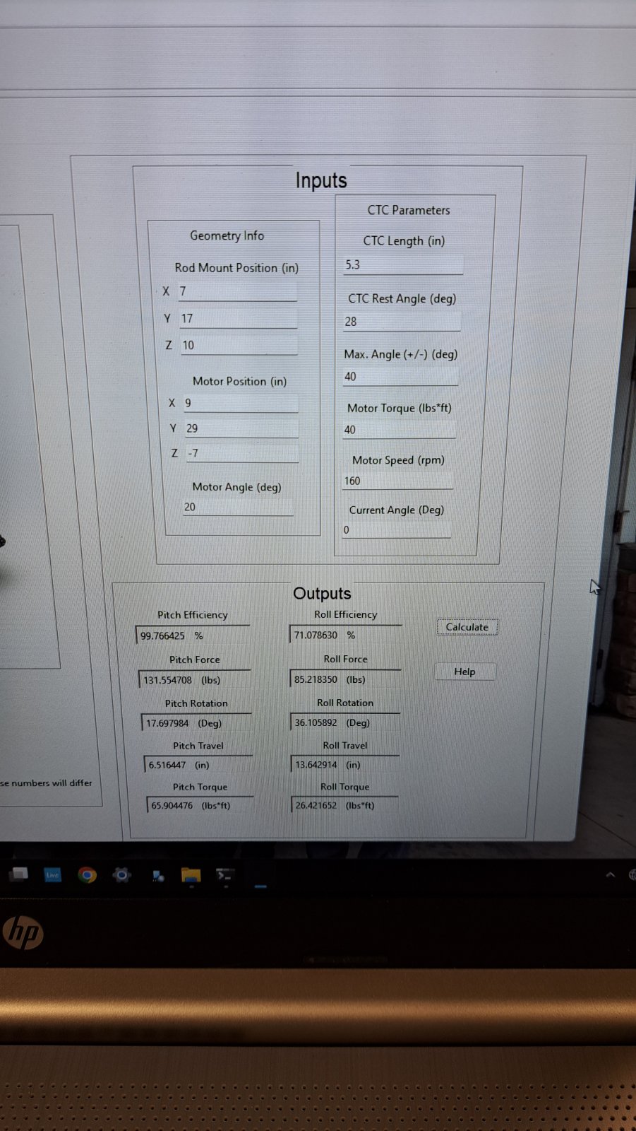

    Been a few days, got the motors and rods hard mounted. Took measurements and ran simcalc. According to the help section, everything is ok as it sits, however, I would like more pitch available as I do 99.9% flight sims. Playing around with simcalc, I can cut my rods down to shorten the Z axis and angle my motors to really increase the roll efficiency while also greatly improving the pitch travel. Are there any drawbacks to cutting the rods and going from a shoulder mount to a "mid-back" mount? The numbers seem to look good, but I'd really like to hear your feedback. Pics included. Thanks 20240222_051619.jpg 20240222_051642.jpg 20240222_062016.jpg 20240222_063431.jpg
  19. Buj818
    Buj818 Member
    Jan 15, 2024
    51
    282Coins
    +12 / 0 / -0
    Motion platform
    Running motion visualizer along side simcalc and having issues. After applying the same values, the results are drastically different. Yes, i know the respective programs have their X Y and Zs labeled differently, but motion visualizer will not change pitch value results after shortening the pushrod Y axis and recalculating. When changing Z axis in simcalc, the pitch changes what i believe to be accordingly. Is MV still buggy? Should I just trust and stick with simcalc?
  20. Buj818
    Buj818 Member
    Jan 15, 2024
    51
    282Coins
    +12 / 0 / -0
    Motion platform
    Wired up the 3 potentiometers and IBT2s last night. Spent about 2 hours this afternoon on simcalc. Afraid to go any further due to being unsure of the simcalc/motion visualizer differences. Hoping someone can school me on my last post here about it being ok to cut rods down and mount them half way up the back instead of shoulder mounted without losing a ton of leverage. In the meantime, Ill start measuring/cutting/assembling the pedal/monitor frame.
