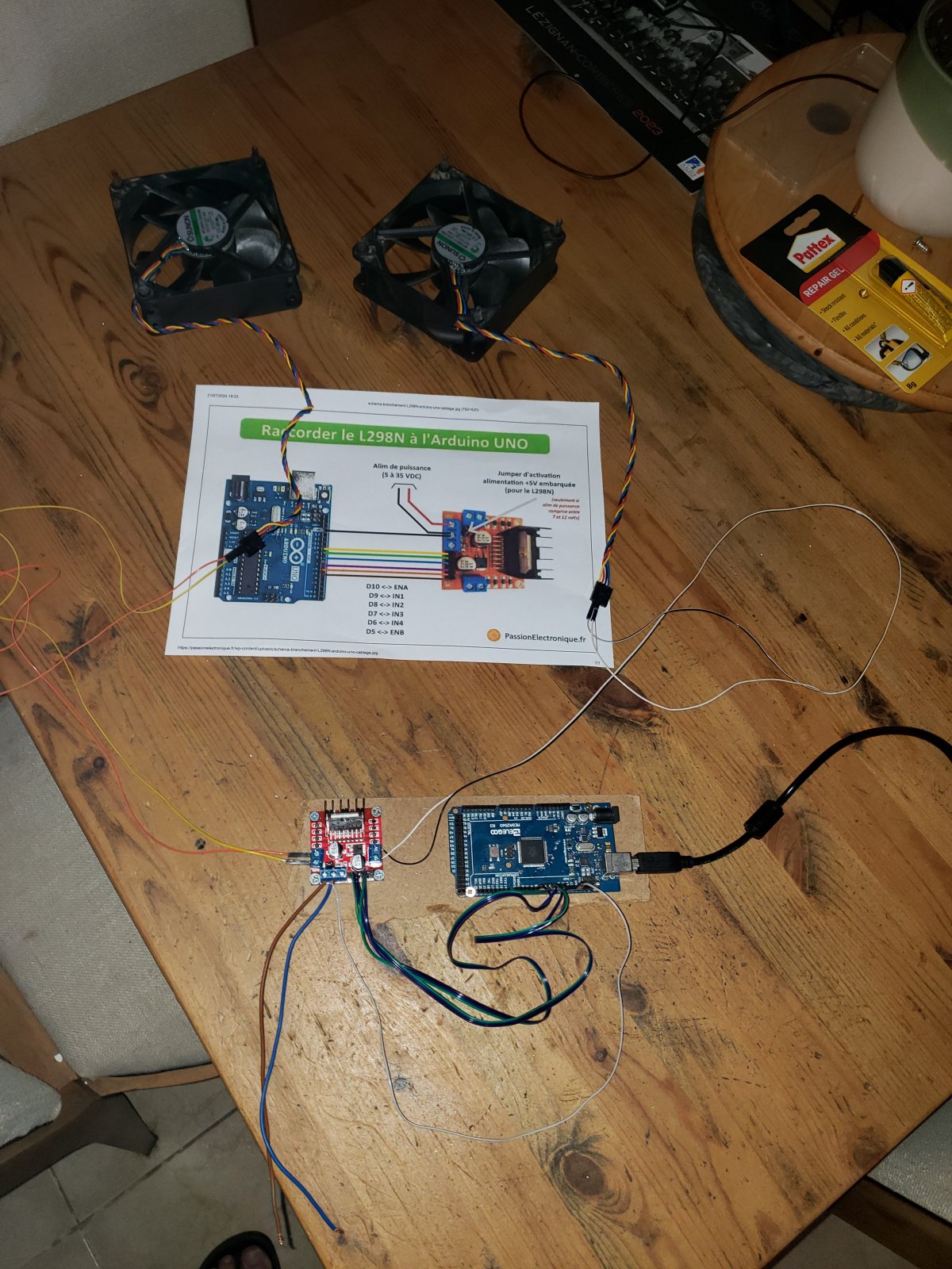

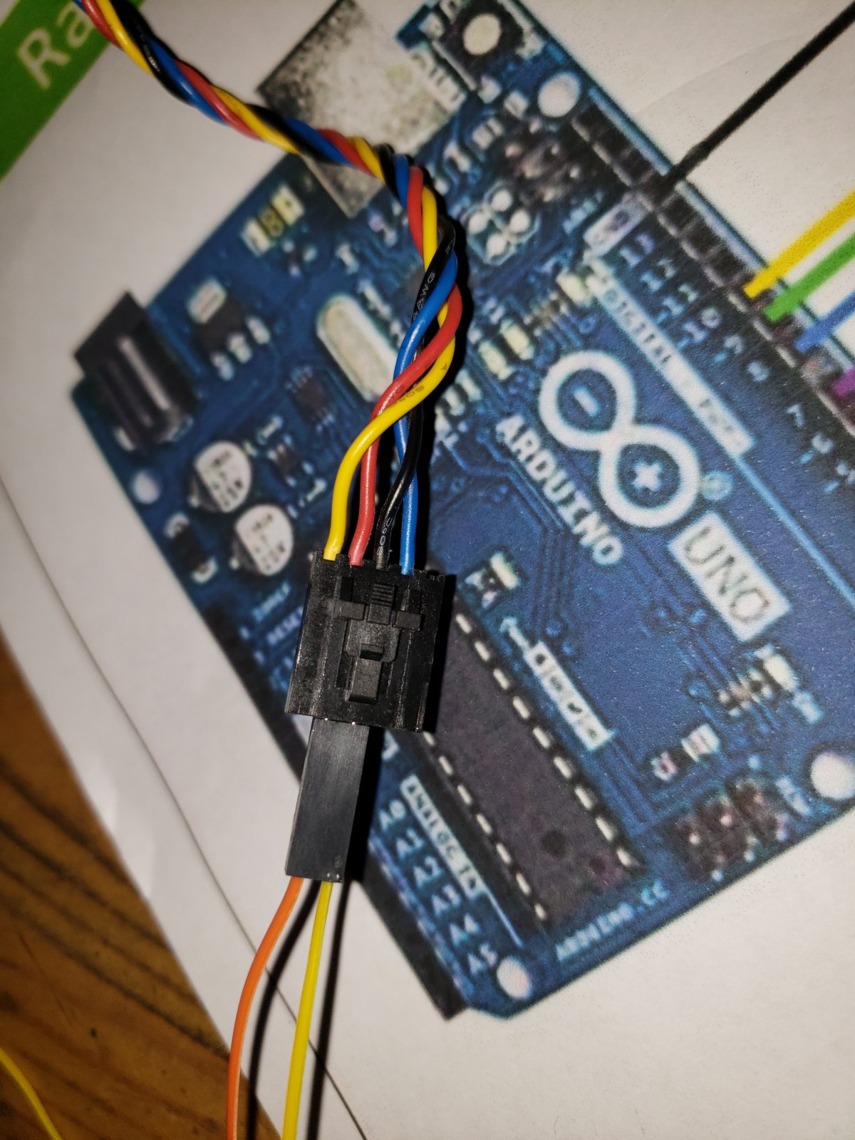

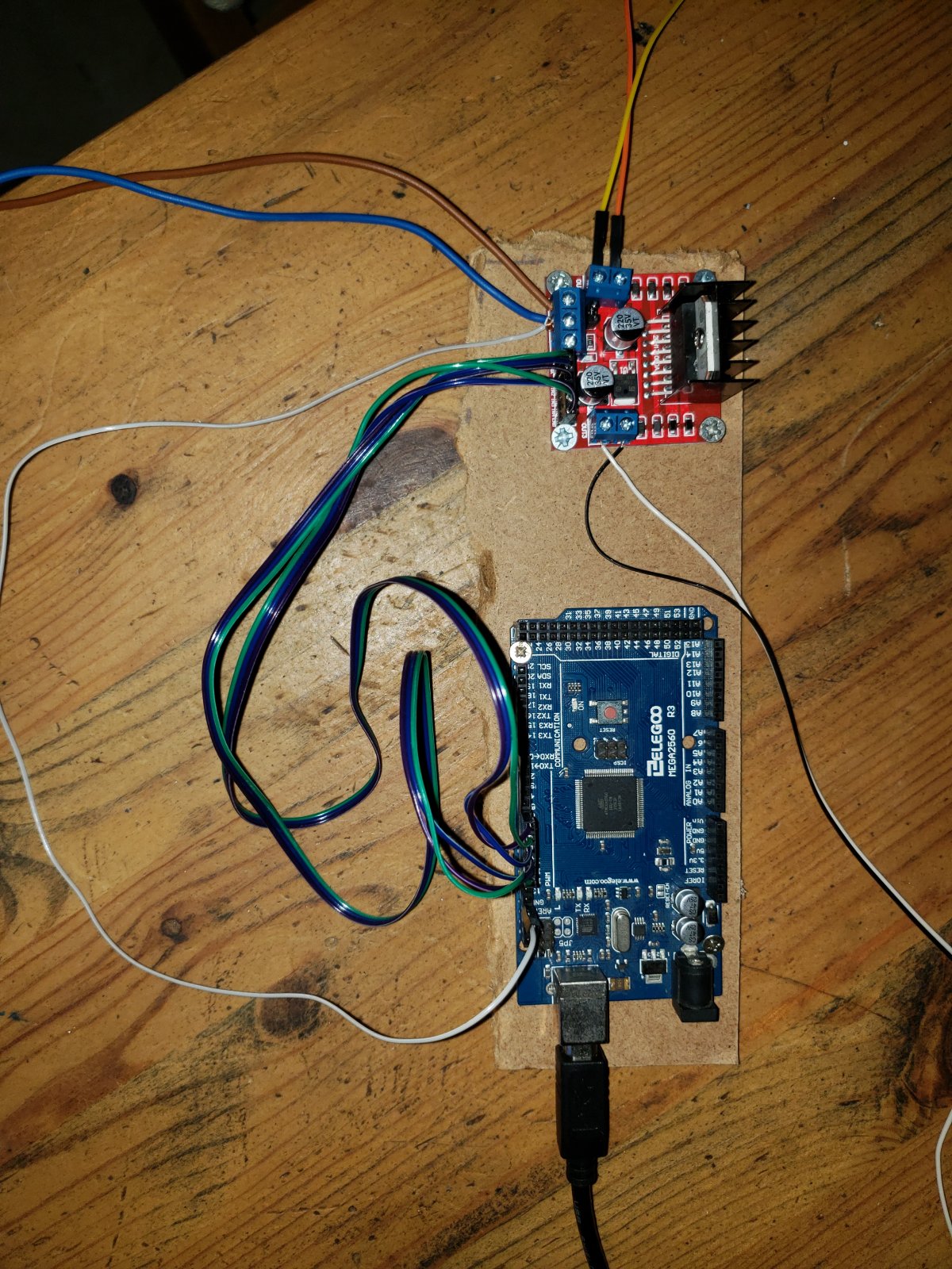

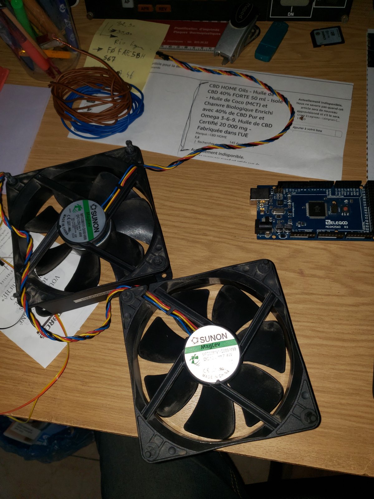

    Hello, after some research, here is where I am to create a wind simulator with 2 PC fans:
    2 SUNION DC 12 V 7.4 W PC fans - taken from an old xenon PC
    1 ELEGOO MEGA 2560 R3 arduino board - given by a friend who didn't use it
    I asked ChatGPT for an arduino code to control 2 PC fans for FLyPT Mover and here is the code in question, if anyone has the knowledge to check but it seems pretty good to me!!

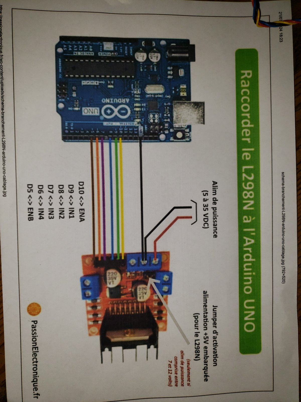

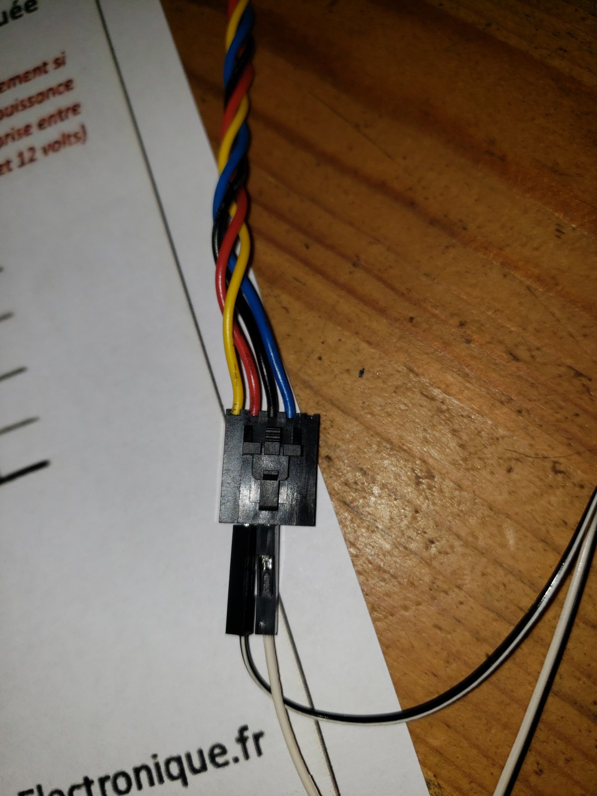

    I'm waiting for my dual motor controller to manage my 12 V fans with my arduino card.
    For the moment we have this, if anyone has a better designed arduino code, I'm interested, I will receive the material on Sunday, I could test if it already works with the code proposed by ChatGPT.

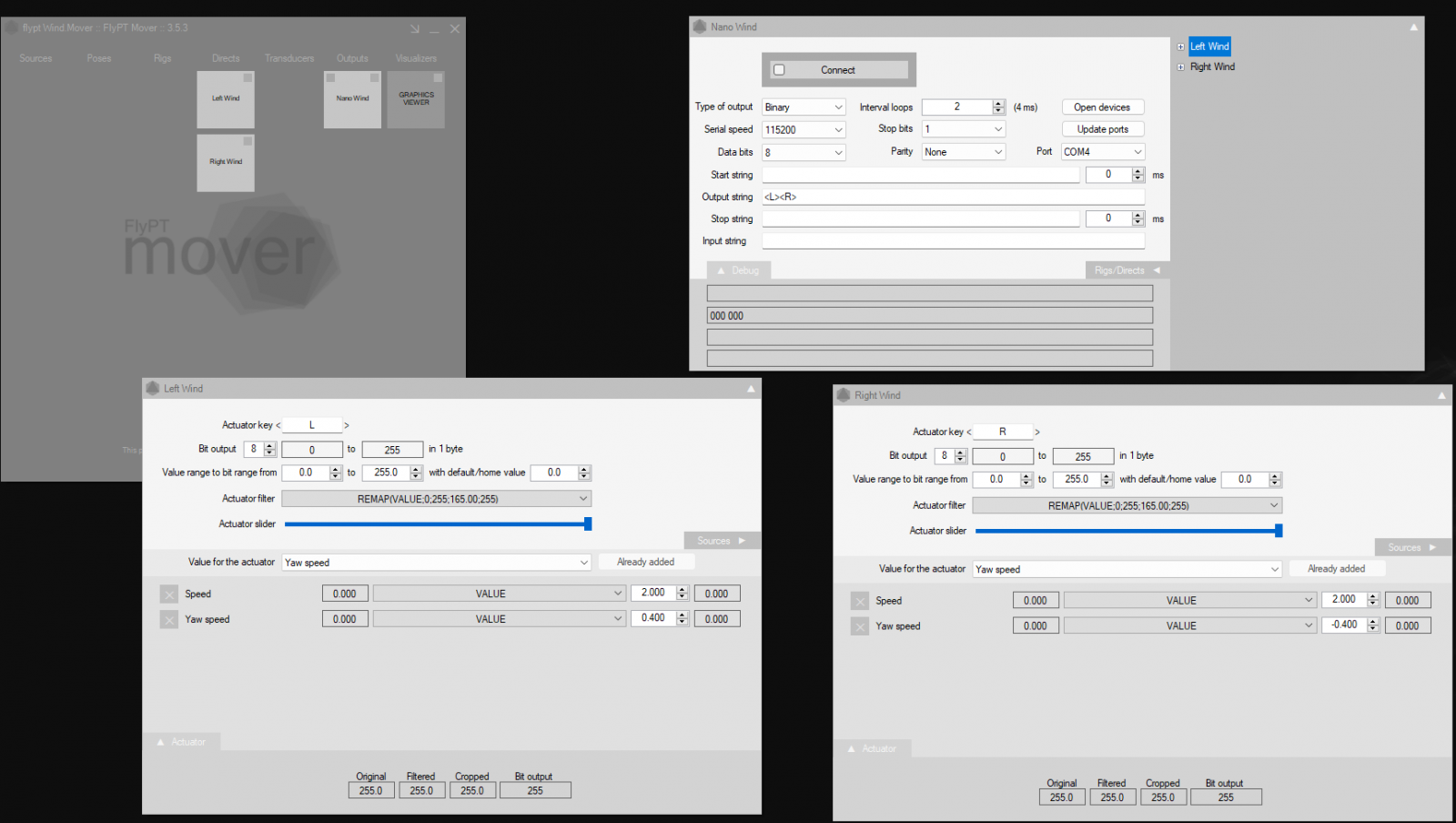

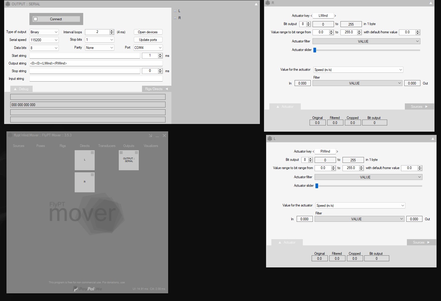

    Another code that works when I send the data to the arduino monitor: 000 255, motor 2 is running, 255 000, the right motor is running and if I put 255 255 both are working.
    Problem I put <L> and <R> with an output which gives me 000 000 under flyPT mover nothing seems to come out, as if arduino did not understand the sending of FlyPT ???? ?
    Help ! I don't see what is wrong, the code works very well under arduino with the monitor, why does it not work with FlyPT???

    That's it !
    I found the right code for my fans with the right data to send with FlyPT Mover!
    So below is the code (with the good trick which avoids a REMAP of the data, you have to put the sync at 31 Khz with the line TCCR3B = TCCR3B & B11111000 | B00000001;
    TCCR2B = TCCR2B & B11111000 | B00000001; this is blah operating frequency of the fans in reality):
    And the photo of FlyPT mover to send the right data!

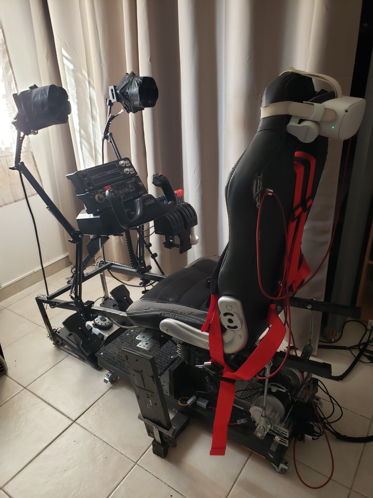

  9. michel123
    michel123 Member
    Jan 12, 2024
    77
    cadre sncf
    lezignan-corbieres
    188Coins
    +34 / 0 / -0

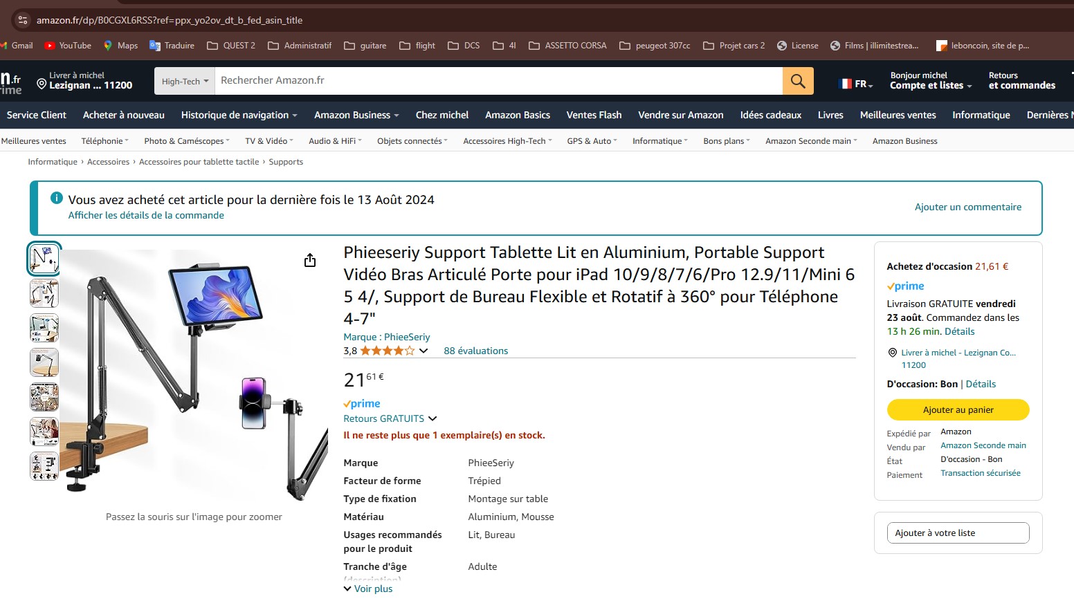

    The armchair with 2 articulated arms found on Amazon for €15 per arm!
    Armchair currently finished, with Flypt mover you can start the fans as you want!
    Wind, canopy and RPM settings to manage all of this!
    21,487
    150,542Coins
    +11,017 / 55 / -2
    The articulated arms for wind sim fans is a great idea, do you have a brand and product page link for what you used?

    I don't understand, my link to Amazon doesn't appear???
    I leave you here the full name to type in Amazon to find the article: "
    Phieeseriy Support Tablette Lit en Aluminium, Portable Support Vidéo Bras Articulé Porte pour iPad 10/9/8/7/6/Pro 12.9/11/Mini 6 5 4/, Support de Bureau Flexible et Rotatif à 360° pour Téléphone 4-7""

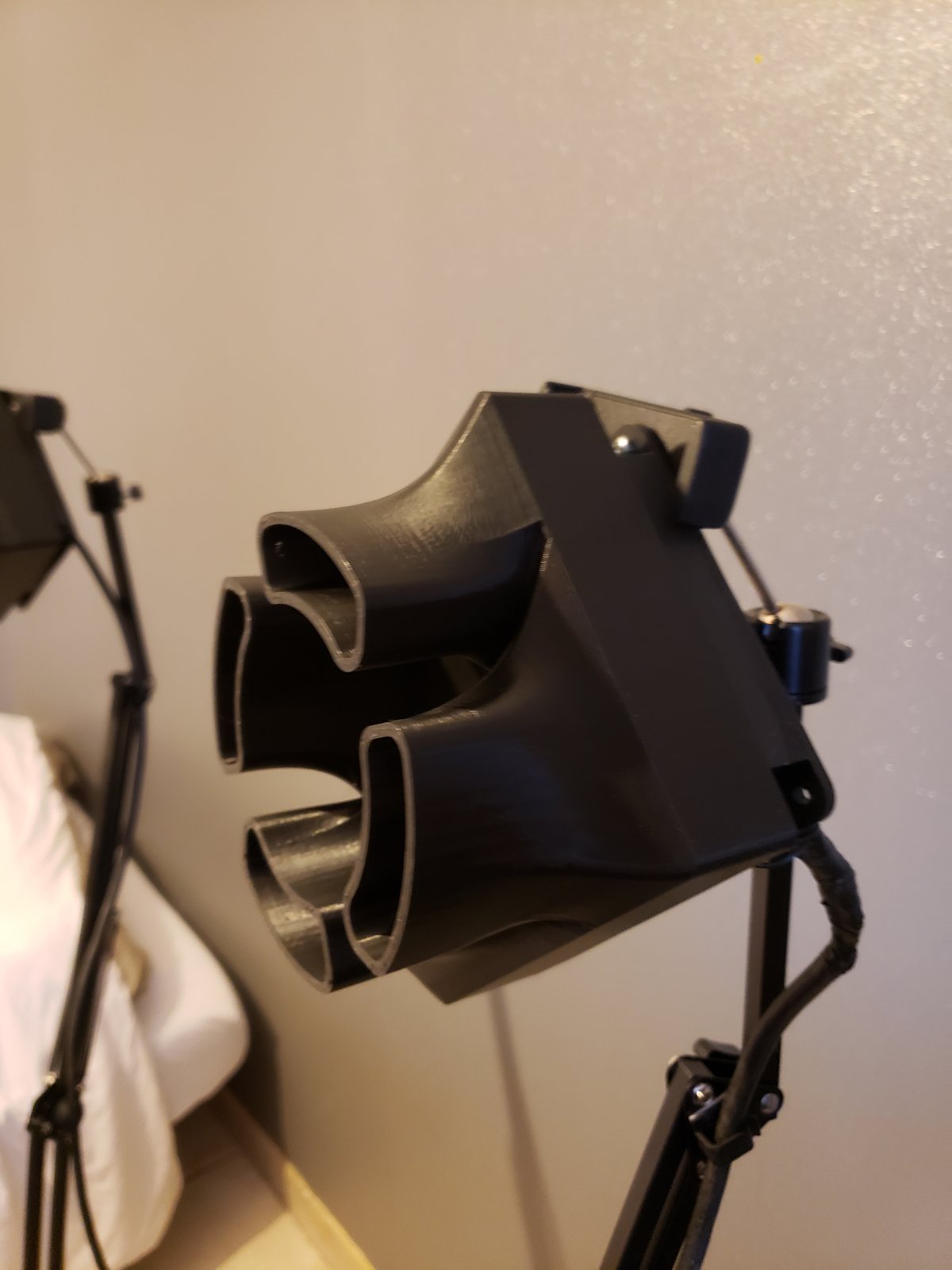

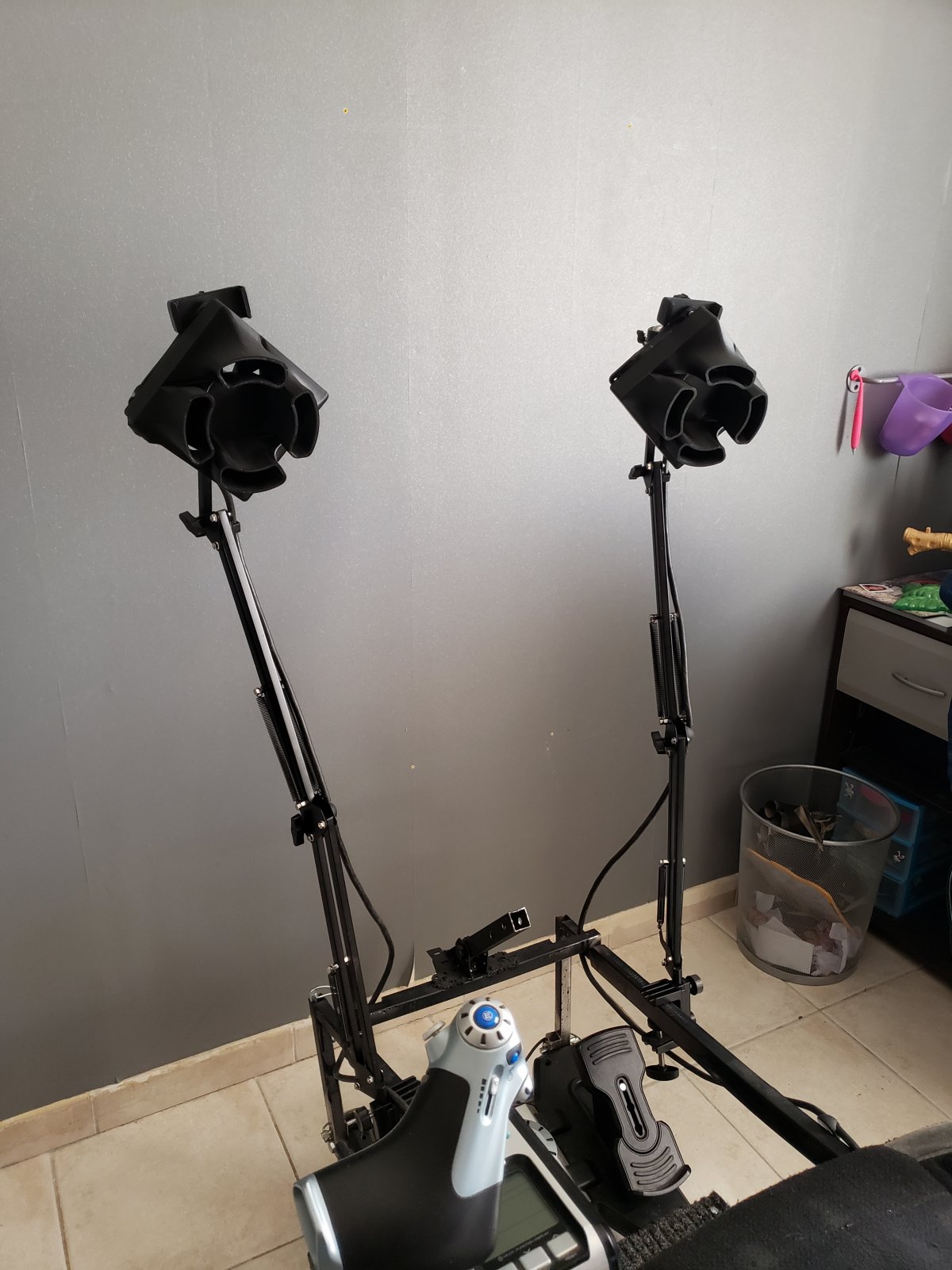

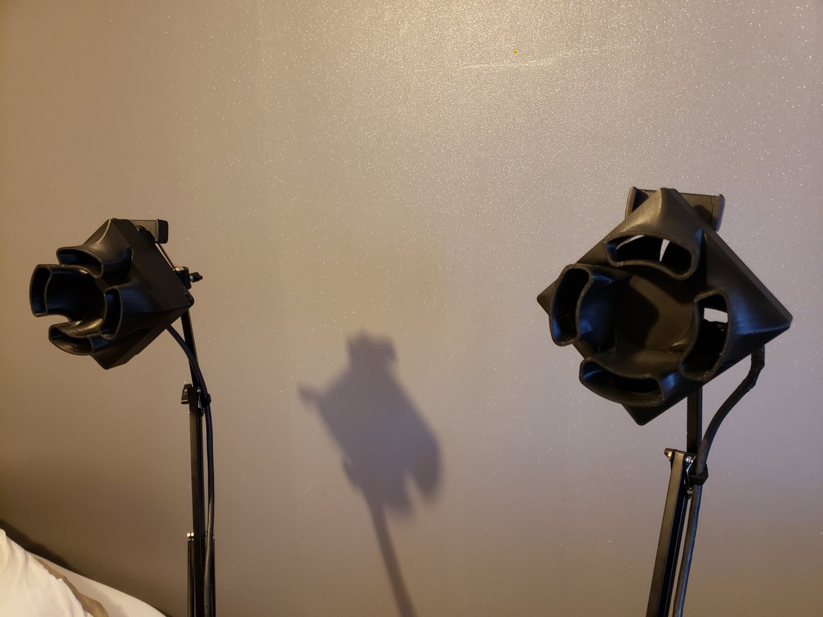

  14. michel123
    michel123 Member
    Jan 12, 2024
    77
    cadre sncf
    lezignan-corbieres
    188Coins
    +34 / 0 / -0

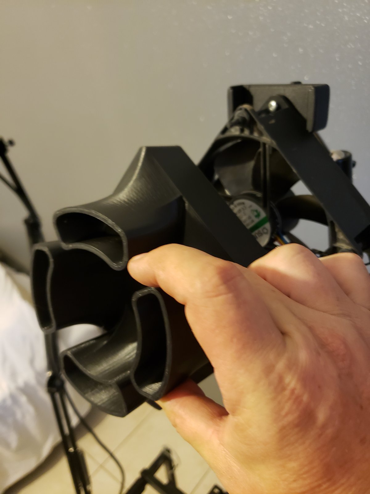

    And so now, with the covers made by my brother on his 3D printer (model easily found on intent and scaled for 12 cm venilos). 10 euros of plastic and 22 hours of printing to make both! Works perfectly ;)
    20240825_112638.jpg 20240825_192935.jpg 20240825_192942.jpg 20240825_193040.jpg
