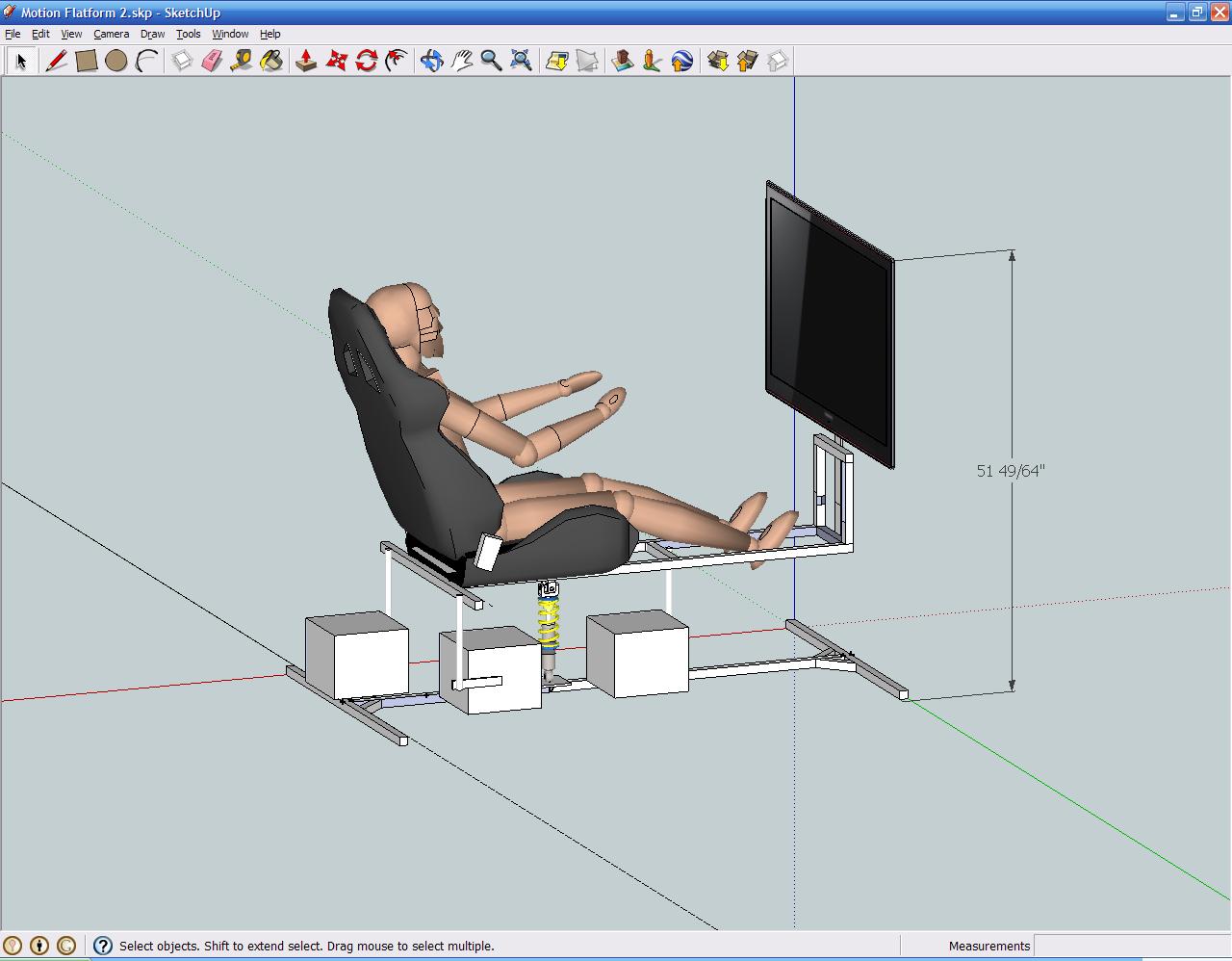

    Curious what folks have to say about a few low cost winches I've found on Amazon. I'm looking at a 2/3 dof platform, potentially similar to AldoZ http://www.x-simulator.de/forum/my-3dof-project-is-born-t3096.html
    Thanks!

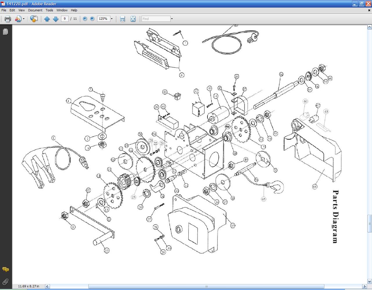

    AldoZ,
    I'm looking at this one from Northern Ind. Looks like you can get parts for it too if needed.
    http://www.northerntool.com/shop/tools/product_200381758_200381758
    Exploded view towards end of manual:
    http://www.northerntool.com/downloads/manuals/141220.pdf
    Does this appear to use the one way plate?
    Would the platform be driven off of the hand crank arm ?
    Is it possible to use the winch with the plastic case installed? As long as you have a way to drive the pot (thinking safety/kids and to keep debris out of the gearbox)

    @boosted-lt1:
    I don't know.. you can obtain this information from the winch manual. It's hard to find this information in the internet sites.
    My platform use 3 ONE WAY WINCHES so these 3 winches are already narrow well so when I have to edit manually the position I have to move with my hand the gear where the pot is mounted.
    In my situation NOT. I heavly custom my winches and I can't to use the original plastic box. I am trying to build 3 new boxes to put inside the winches to reduce the noises and dangers too! :)

    Hello AldoZ, bsft, and all,
    Here is an exploded view of the winch I'm looking at. Does this look like a good candidate? I see it uses 2 friction plates on the main gear, a manual knob to adjust clutch friction, and a locking claw. I believe it is a one way design, but not 100% clear.
    Thank you!
  9. bsft
    It looks like the one similar to Aldoz and Eaorobbies motors. Chaps, please advise.
