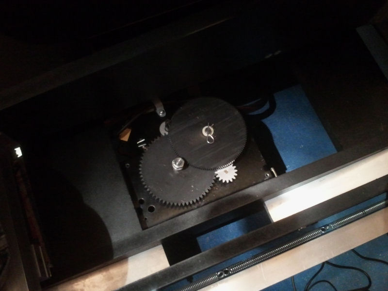

  2. eaorobbie
    20,400Coins
    +1,683 / 23 / -2
    ok mate the cog came from a hobbie radio control shop, about $9.(heli spinal gear)
    In relation to position it is driven from the gear off the main spidle as in pic it allows you to track position alot better i use a 5 turn pot.

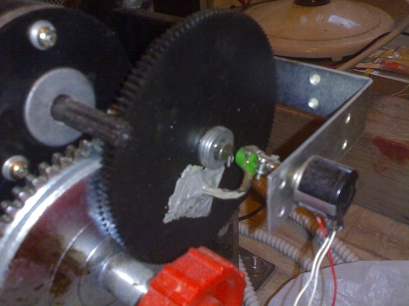

  8. AldoZ
    AldoZ Member

    Hi dudes, here the pic showing you how I put my pot in my winch.
    The main difficulty is to make right measurement to obtain the center of rotation of the pot perfectly coincident with the center of the winch gear.
    If you don't do a perfect precision you can get the pot effort on his turnable part and you can get damage inside the pot in the wire spiral (1 pot damaged before obtain good precision..)
    I weld a steel lattice in the winch body, I mount the pot in one side of this lattice and I use iron glue to weld the steel support that have to mantain the cap. This cap is blocked in the pot turning part so the game is done! :)

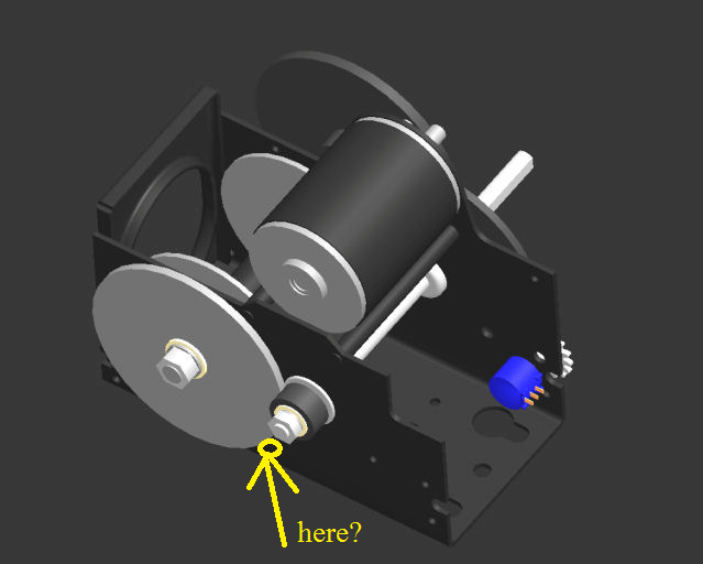

    I drilled a hole in the steel frame of my winch and installed a 10x turn 50 kΩ potensiometer with a home made 16 tooth aluminum gear on it. It can be adjusted so that there is no backlash what so ever. Gears can be bought from sdp-si.com if you can't make them yourself. They need to be module 2.0 gears. The closer the feedback potensiometer is to the output gear, the better, I would think.

    thanks very much for all the resposne.
    Why dont you connect the Pot directly to the cog that the arm is connected to?
    (ie see picture)

  14. tahustvedt
    tahustvedt Member
    Nov 23, 2011
    201
    62Coins
    +8 / 0 / -0
    Because that won't give enough turns to achieve a good resolution. 1/2 turn of the output shaft with my configuration gives 9,69 turns of the potensiometer.
