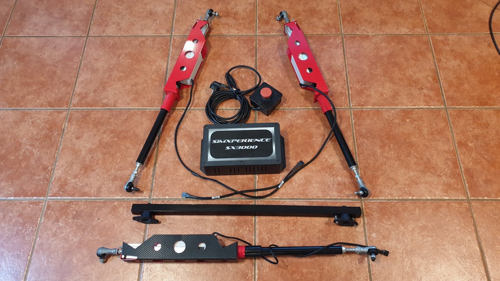

    I am considering utilizing an SCN5 for a traction loss setup, and I've arrived at a roadblock in the form of mounting an SCN5.
    The typical SCN5 setups involve rod-ends at the front and rear, like this: [​IMG]
    The setup I am considering is limited by the available space, and so I've thought of utilizing foot-mount angle-brackets to rigidly mount the SCN5 to a piece of 8020 extruded aluminum profile. The shaft will have a rod-end screwed onto it.
    Here is a picture of the foot-mount angle bracket (attached to the SCN5): [​IMG]
    My question is this: As long as I maintain parallel motion with the shaft, as well as ensuring that rotation only occurs around its one free axis, will a single rod-end be sufficient to avoid over-stressing the SCN5?

    I've now realized there is a functional difference between a rod-end (or heim joint) and a ball joint (which is found in the first photo). My original intention was to use a heim joint, but I've now decided to use a ball joint instead. However, the basis of the question remains the same: would a single ball joint provide enough flexibility to avoid over-stressing a rigidly mounted SCN5?
    I'd think that it would be okay, but I'm unfamiliar with engineering terms & principles (exhibit A: my rod-end, ball joint mix-up, haha), and am seeking some reassurance to ease my mind.

    Other members have used SCNs for traction loss, use the Enhanced Google Search box on the recent page to find and check them out.
    A tie rod end should be fine, as it can rotate freely in the plane relative to what it is pushing or pulling.
