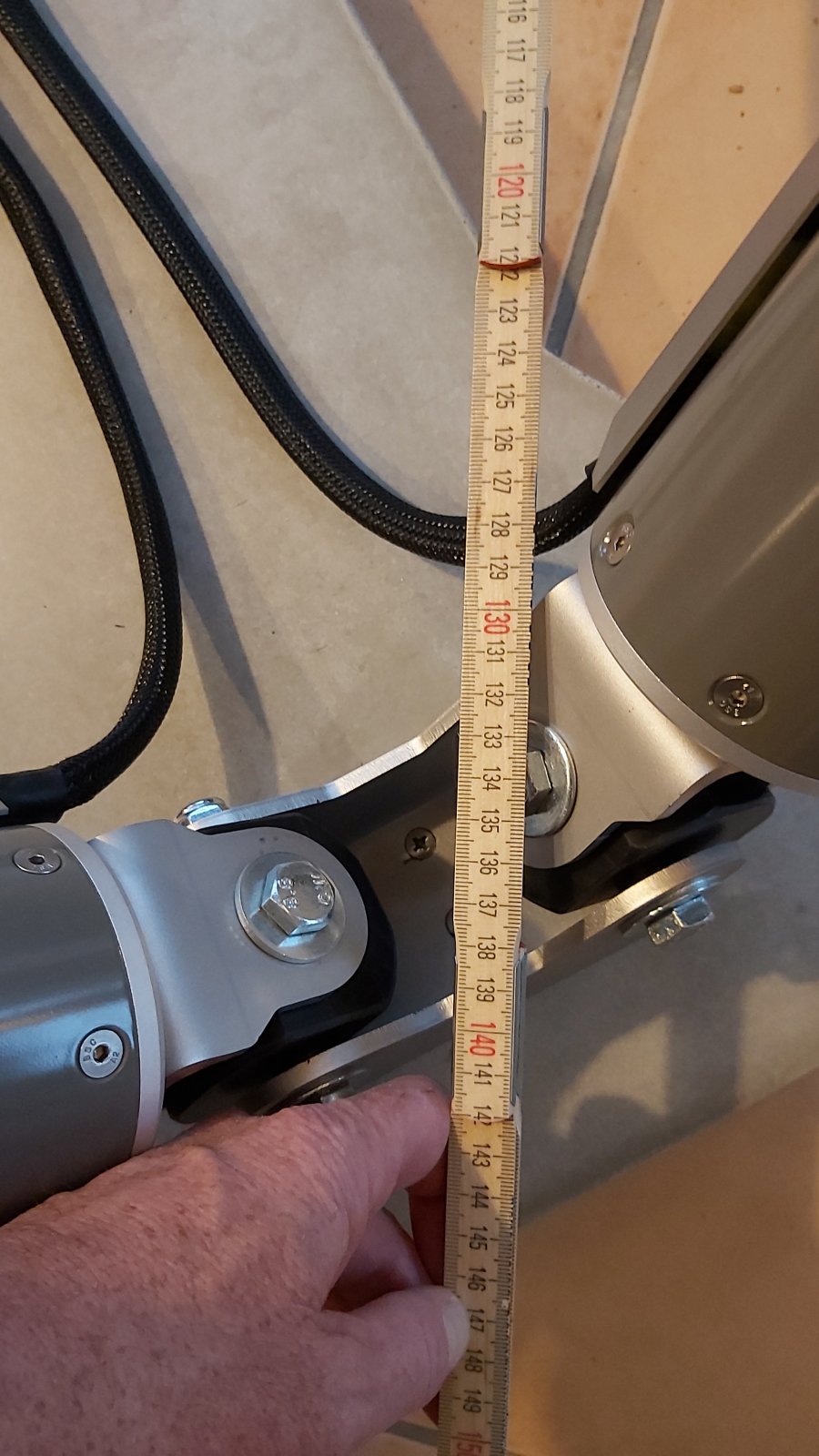

    hi gadtet999

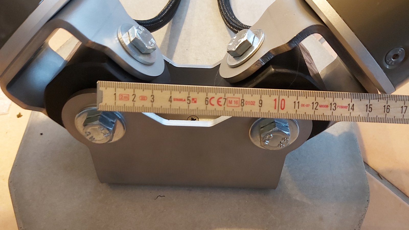

    At the base the cardan joints have a distance of approx. 134 cm (long leg) and approx. 10 cm from joint to joint - see pictures.
    At my current temporary upper platform made of wood the triangle has the same distances.
    However, I am still not 100% sure if I will make the distances of the upper platform a bit smaller.
    A smaller distance means closer pivot points and therefore smaller cylider strokes. This again means quieter running.
    I still think about.........
    Wickie

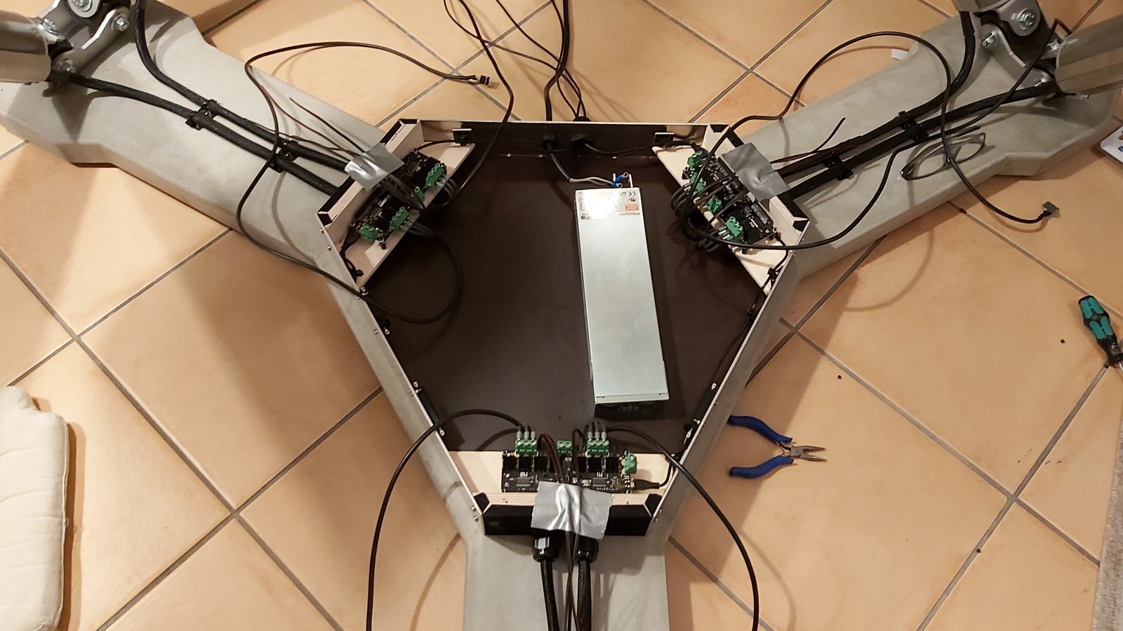

    Hello together
    time for a short status of my project.

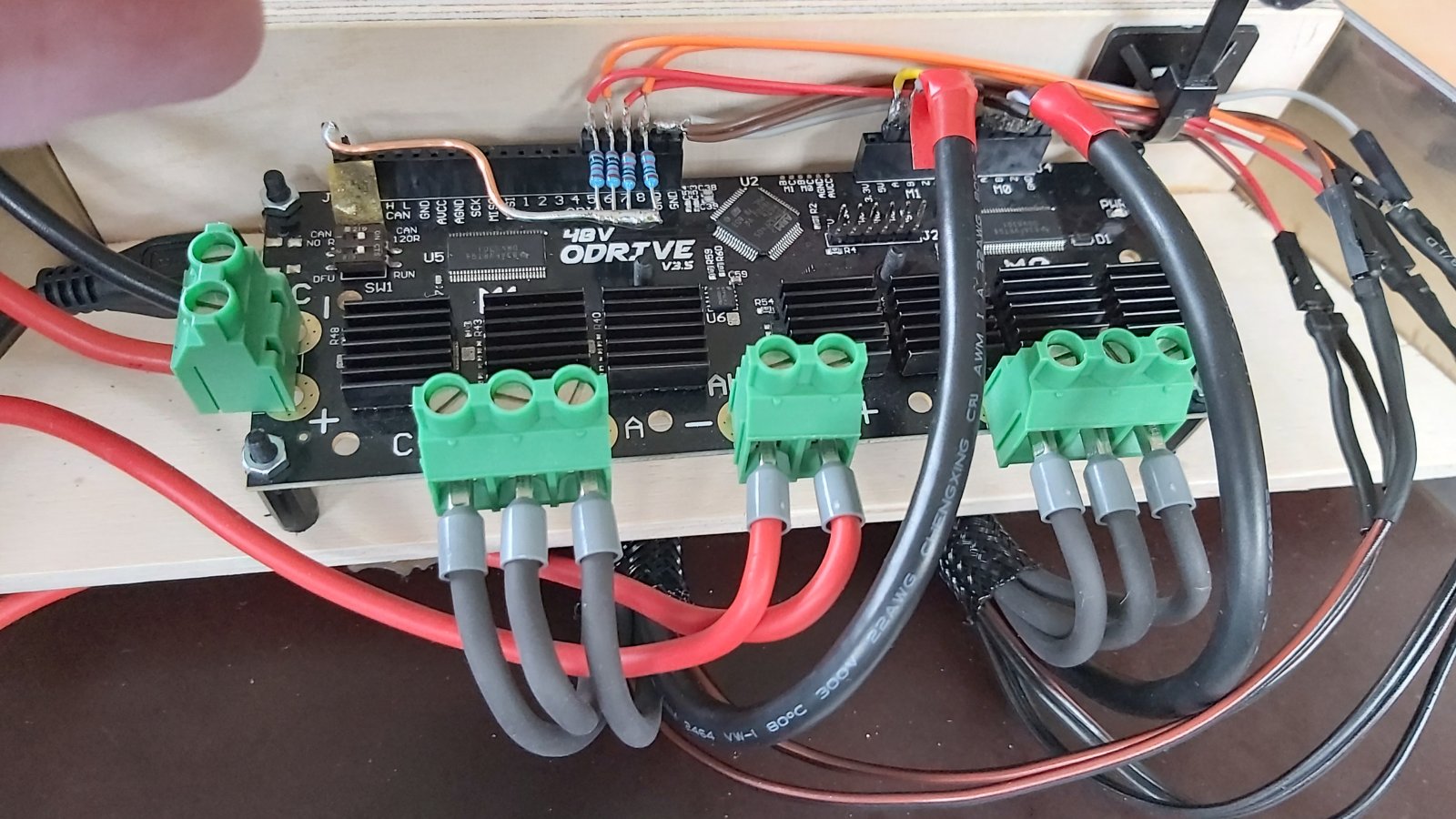

    The last time I was busy with the construction of the electronic box and wiring up the system and the motor controls. It was much more work than expected, but had some good moments ofsuccess - thats what we need.
    Yesterday I was able to operate two of my actuators with the FlyPT Mover interface for the first time. It's going quite well already - but I still have a lot to learn!

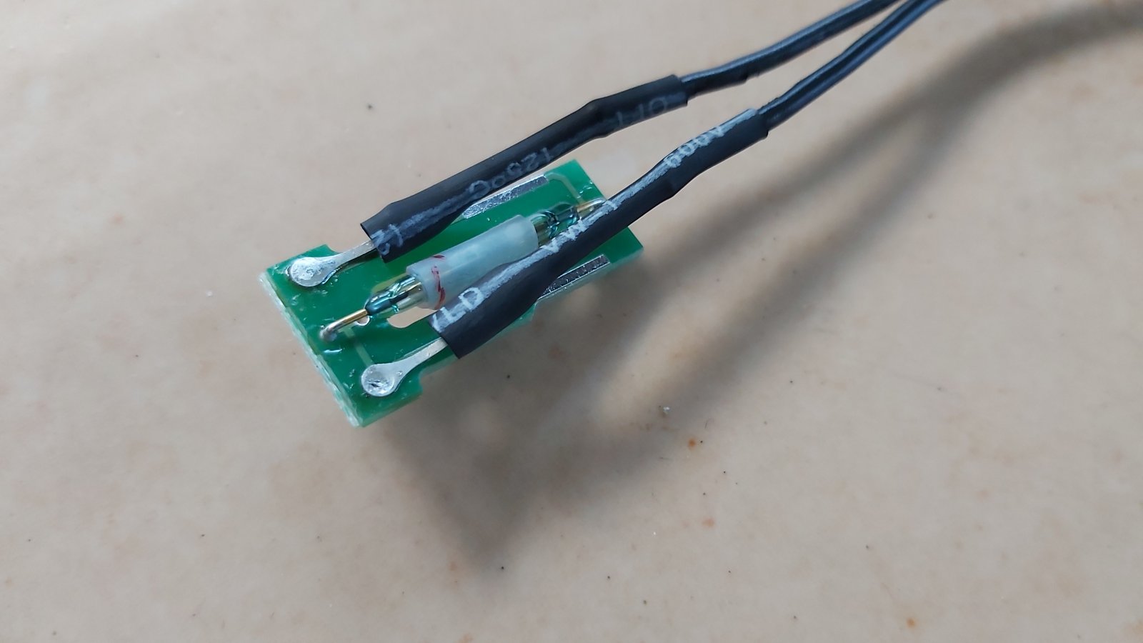

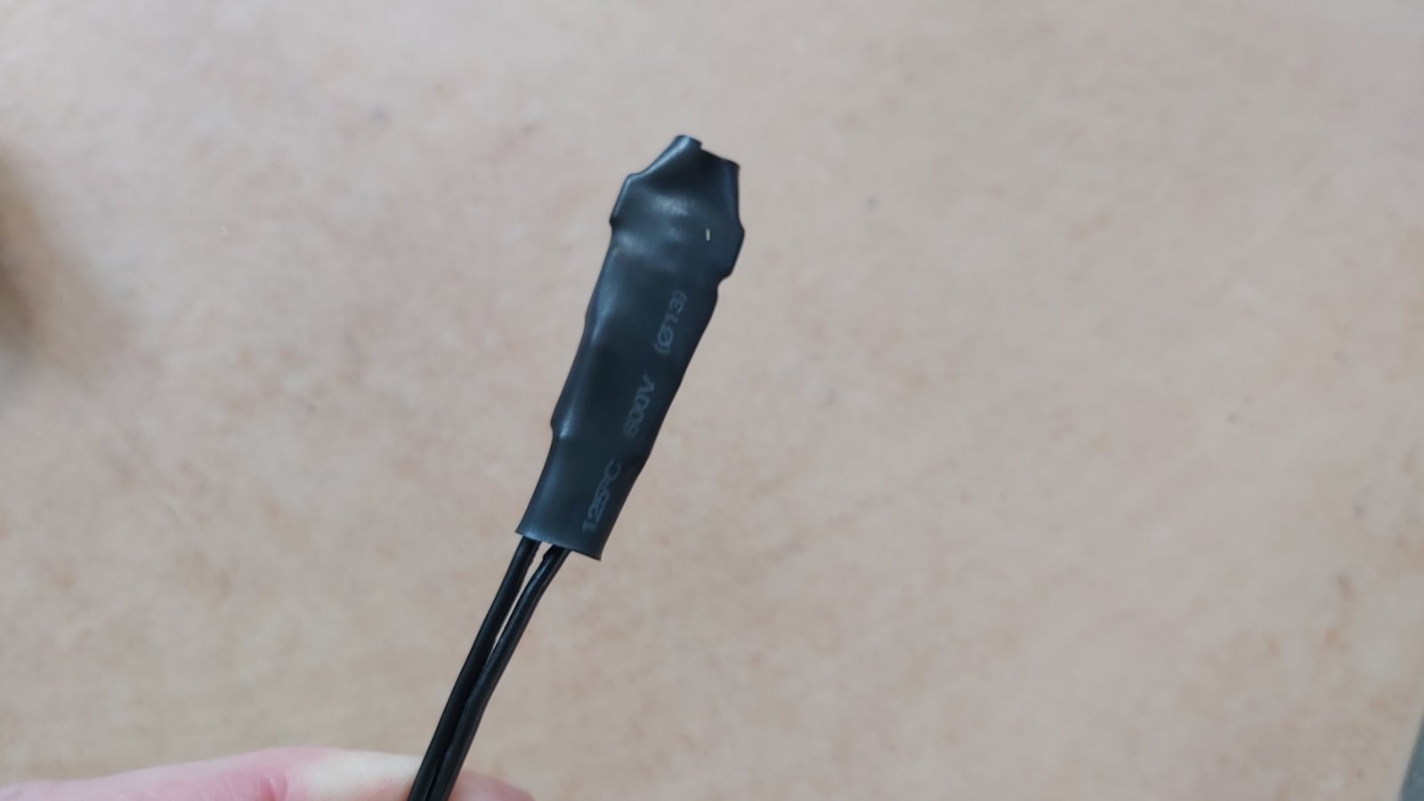

    What unfortunately worked very badly were my reed limit switches (see pictures). I've been searching for errors for three long evenings/nights now and found out that the reed switches are crap. So I bought 12new ones today. They work quite well now. But as it is, with every problem solved two new ones appear. It still seems that the two limit switch circuits influence each other. Sometimes an actuator just doesn't get through the calibration sequence :mad:
    Next days I have to fokus more on my Christmas presents ....so a few days break with my sim :)
    (Edit: The noise of the high quality ballscrews is not as low as expected but is ok. Seems it isnt worth to spend so much money.......I'll make up my mind when everything's ready.)
    Wickie

    I thought to use the batteries as a kind of buffer for my Meanwell RSP1600W Power supyly. The Idea is somehow only halve baked and seemed to be the last hope reaction to get a suitable supply....
    During my tests the last days I saw, that even a high quality1600W PSU cant manage to drive alone two BLDCs that I use with Odrive at high speed.
    This was before I saw the 6000W power supply mentioned by SilentChill......
    Now the money is spent and I will try the batteries. To avoid unequal loading I could use a banancer/equalizer...

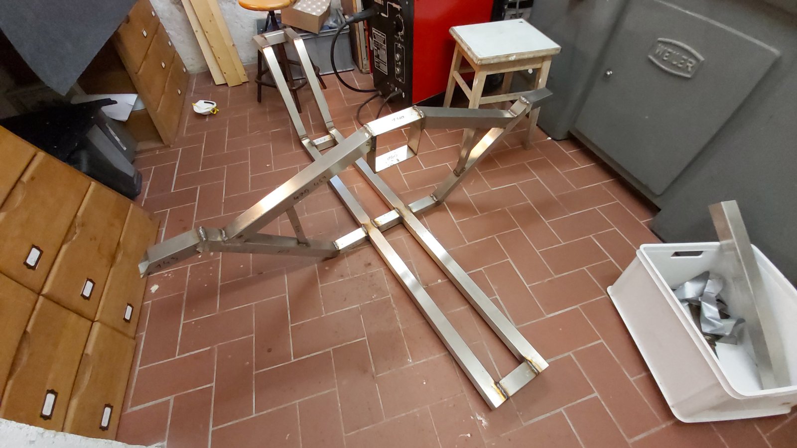

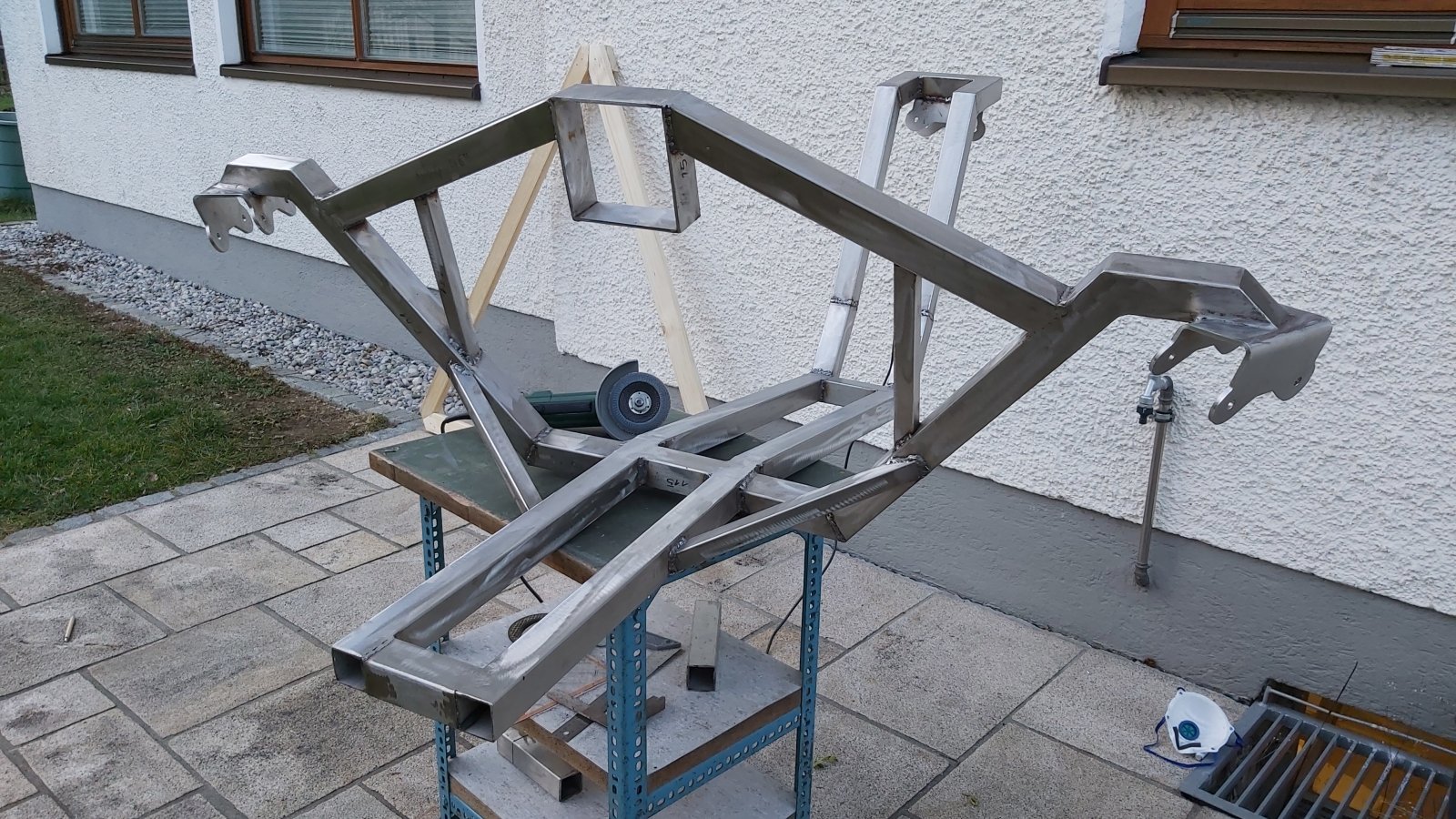

    Hi all,
    after some days vacation I am back to my workshop - yessss :grin

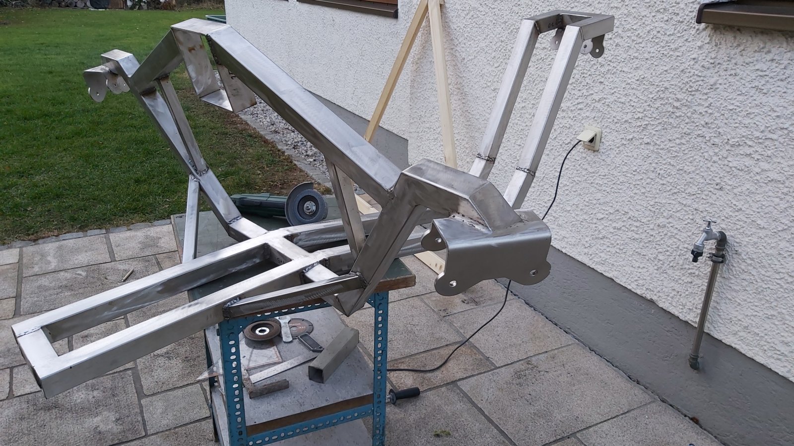

    So the last two days I started to build my upper platform. I am using stainless steel sqare pipes 45x45x2mm (aprox. 8m)
    There are still some reinforcements and brackets missing, but the main shape is visible....
    Now I hope my bucket-seat will arrive soon to check the dimensions and make a "test drive"
    Wickie

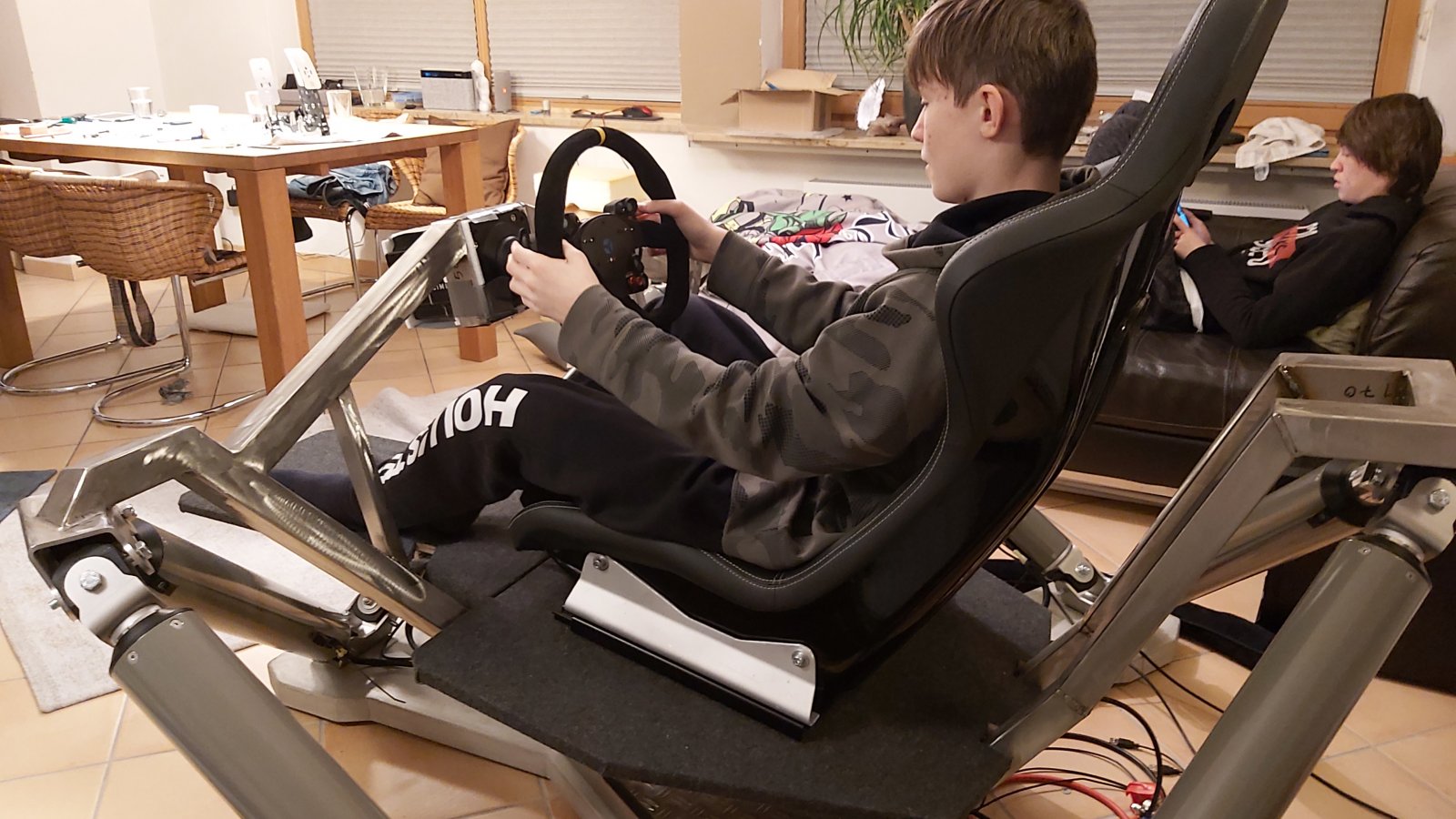

    Hi all,
    some little updade....
    Nearly finished my upper platform.
    I had to make some minor changes because my bucket seat is a little different than it was in the CAD model...

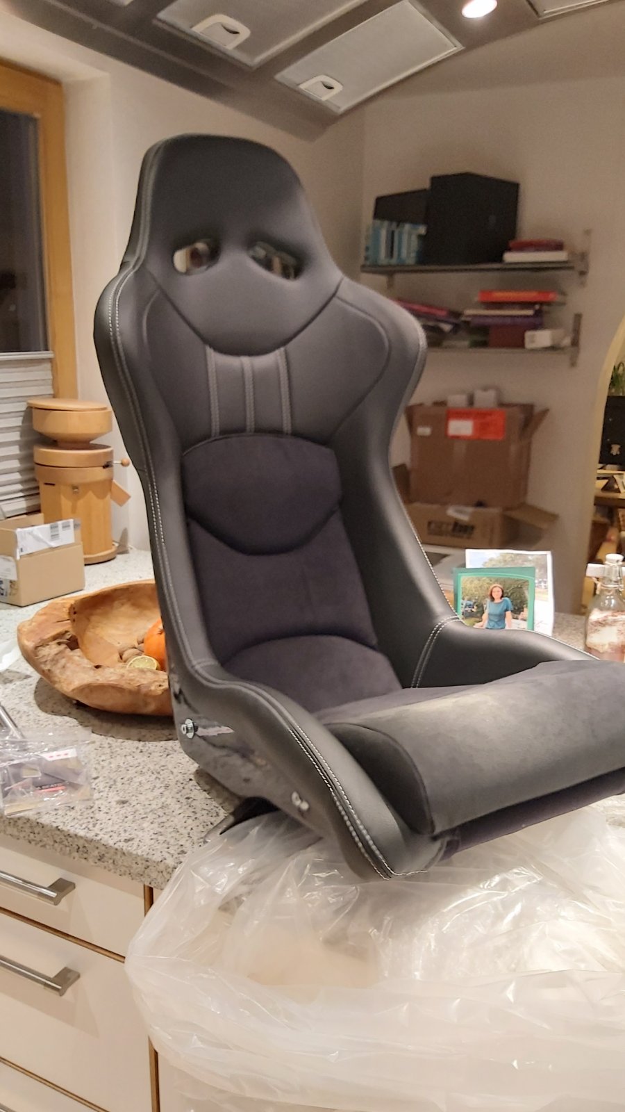

    Ah...and tis is my bucket seat... a Cobra Nogaro from England.
    It was love from the fist moment..

    Covering the woden platform floor with carpet was easier than expected, so we have been able to fix the bucket seat and the wheel today for first tests.....its sooooo comfortable :).
