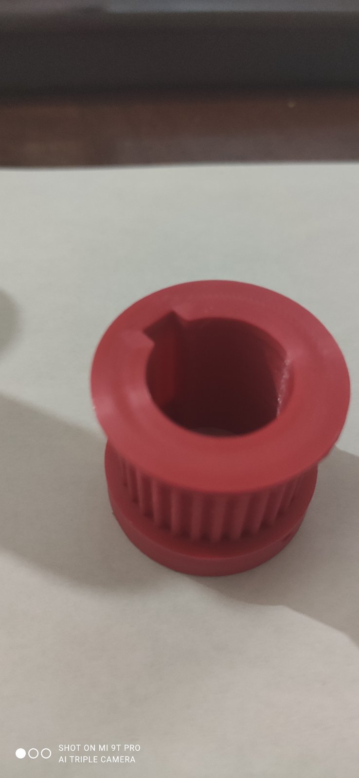

    Hi! Thanks for your reply. I try to print in 3d this htd 5m pulley with keeway. bore 19. see the photo. When I decide wich pulley ....htd,gt,gt2 I will print in pteg. It should be ok for motor.
    Honestly, I still have to think about how to avoid slipping of the pulley on the 1605 screw. Probably the solution could be to make a groove in the 1605 screw on which to insert a keeway and obviously make a pulley like this. but I don't think it is very easy to work the 1605 screw, difficult to drill difficult to mill, perhaps with the flexible you can create a chamfer. probably home tools are not enough to perform correct work, but you need a professional drill and someone who knows how to use it. But I don't see it as an impossible problem to solve anyway. I haven't read rowans gseat threads but i will do it soon. Was he able to solve? Regarding the type of pulley, any suggestions? hdt m5, hdt m3?

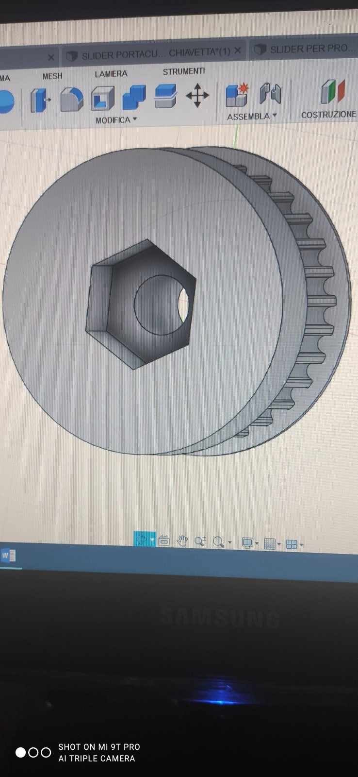

    I got this idea, I don't know if it can work. I designed a pulley HDT 5M 30 TEETH with a 10 mm hole to engage the 1605 screw but also with a hexagonal hole that fits into the nut which has an external diameter of 19 "and is used to fix the 1605 screw to the FK12 bearing. If you can staring at that nut even the pulley will be firm and will not slip Stupid idea? What do you think?

    I don't think it matters if you use hdt vs gt2 etc. I think GT2 is more common. You will need a wide belt. There are engineering specs from the companies that make the belts that give torque ratings on the belt widths. Google it.
    I think the nut on the ball screw will slip, for sure.
    You best bet might be talking to a screw manufacturer on alibaba and asking for a screw with a keyway. Some of them are very accomodating. You can also ask for non standard shaft size where the keyway connects so you have enough metal. Keys are the best way but you need to make them precisely or they will have backlash.
    3d printed pulleys are great for a prototype but I think they will break when used with any real torque (but I could be wrong).
