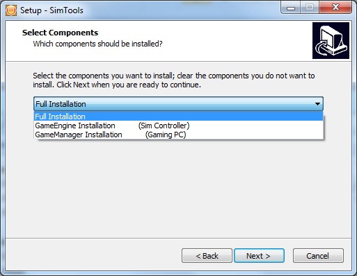

    yes xp professional 32bit.do you ahve this: [​IMG] ?
    Thanks!

    Yes mate thats the one!
