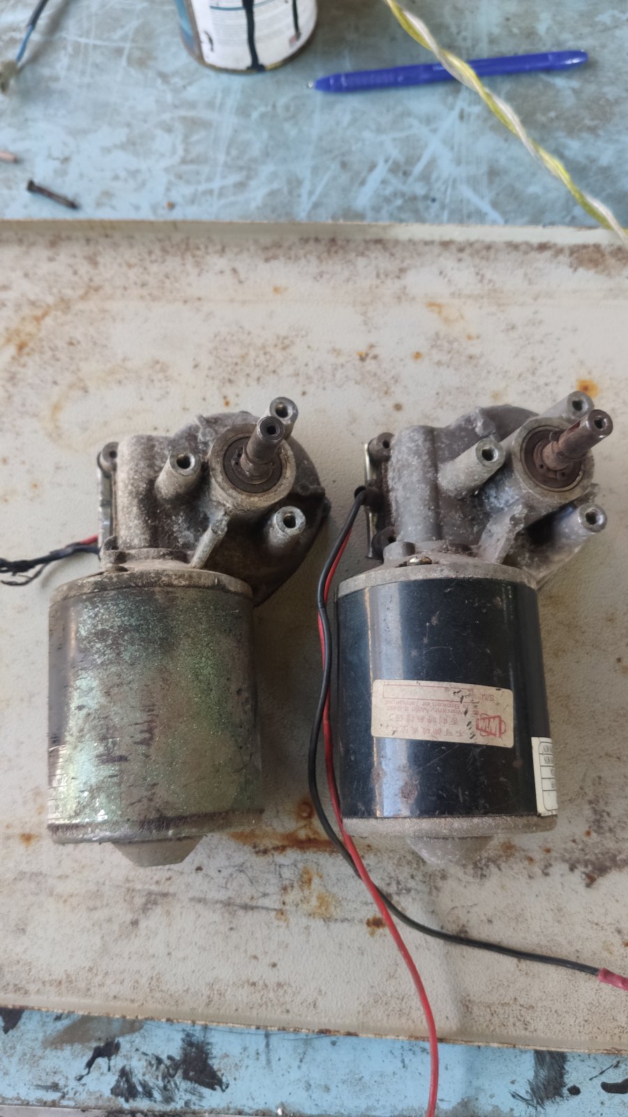

    hello everyone,
    I have built 2 wiper motors but with wiper motors of different specifications and power (big difference in body, and rpm). I took the initiative to look for another dc worm gear motor, finally found a former MIG Las. with specs 150rpm 24v dc. i have installed it in my 2 DOF. but the problem I encountered was that the motor could not self lock like a wiper motor. how do you outsmart it? but for the strength is better than the wiper motor. I'm afraid because motor can't self lock it can damage my BTS . because bts7960 maintains position at a certain angle. Any good suggestions for a worm gear dc motor that won't lock itself?
    Thank you, I hope I get a clue
    Help me sir @noorbeast Thank you.

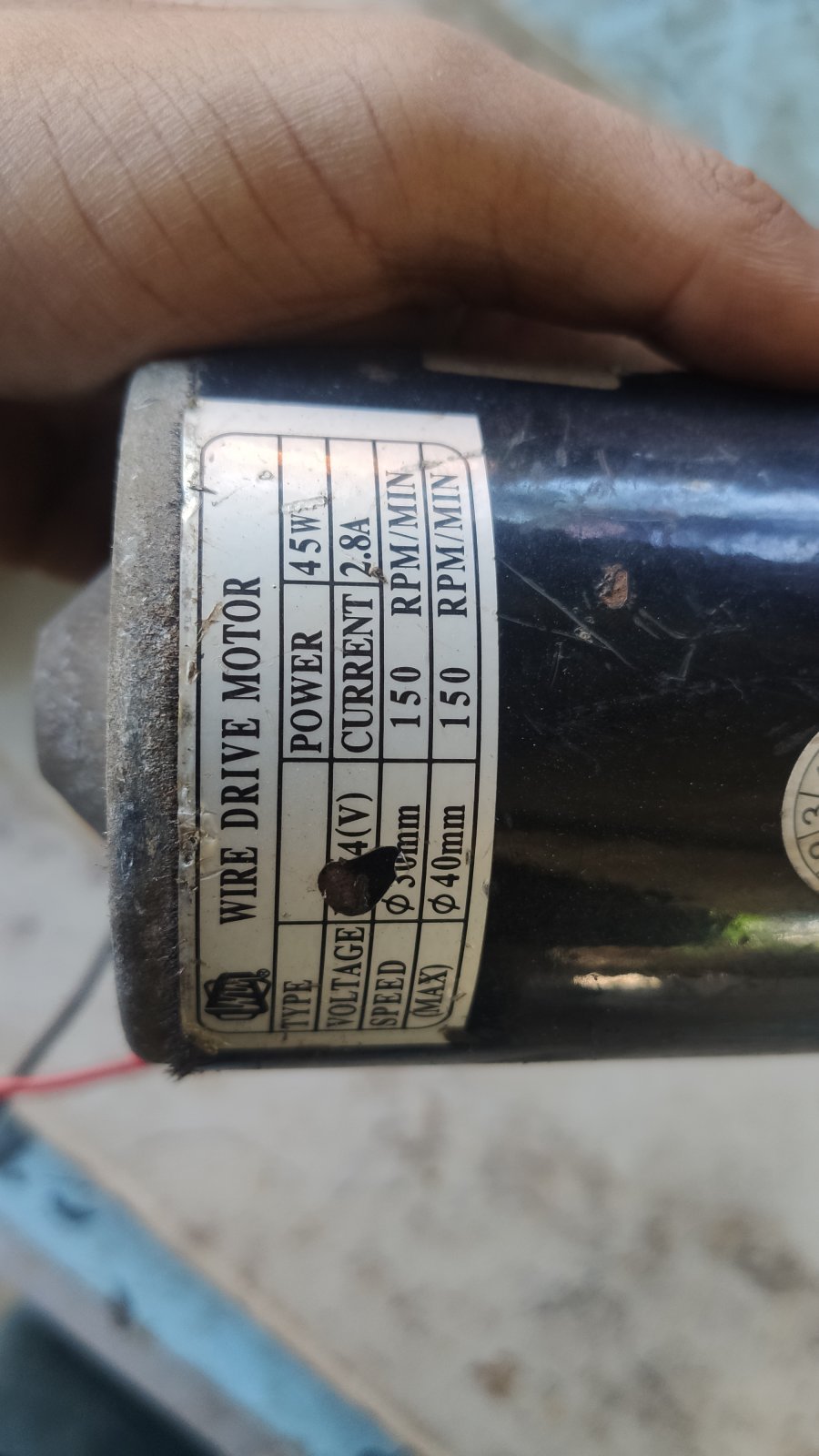

    According to the picture of the motor Voltage = 24 V, Current = 2.8 A . My estimation: max current = 5 - 6 A.
    According to the specification of driver BTS7960: Voltage 6-27 V, max current = 43A. So assume the current 43 A is at voltage = 6 V, then at voltage 24 V still a current max 10.7 A is available.
    So the bts should have no problem, but the weak link is the motor, it will stall when load is too high. Or it will not be able to keep the desired position (because it is not self-locking).
    When your motion system is well balanced, the nominal load on the motor will be minimal. It that case, maybe the motor can be used, but probably the motor will not be strong enough to reach the high speed of 150 RPM.

    I don't think the BTS7960 is the problem, for me it looks like your motor is not strong enough.
    The motor is rated only 45 Watt. The nominal output speed is 150 rpm. This is rather fast, probably the gear ratio is 20:1. That means that the output torque will not be very high. For instance, if you would have the same motor but coupled to a gearbox with ratio 60:1, then this motor would be 3 times slower (50 rpm), but also 3 times stronger (output torque).
