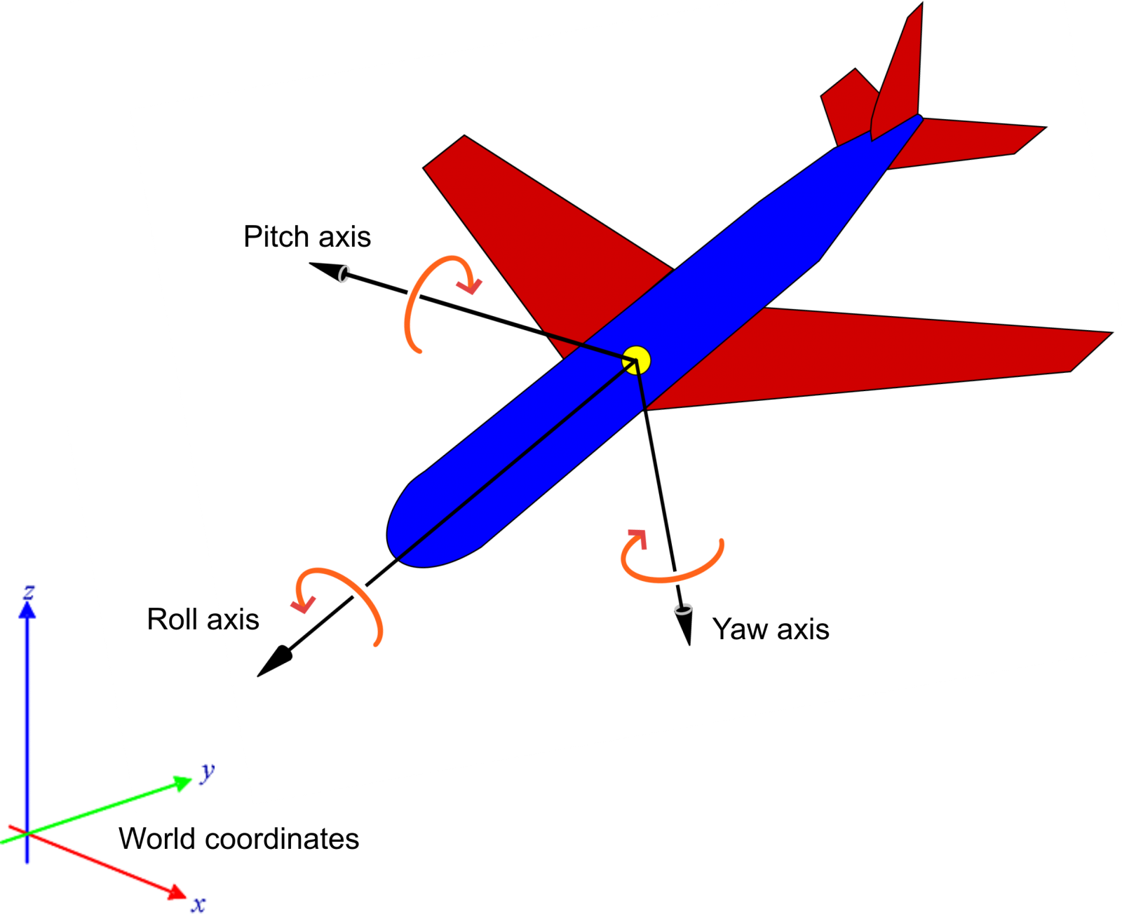

    5 seconds on Google - See https://en.wikipedia.org/wiki/Aircraft_principal_axes . :rolleyes: You can only have 0 to 360 degrees...for pitch, yaw and roll. All angles can be simulated, just depends on your budget:). The actual velocity of the movement as you move from your current position to the new target position is dependent on what you simulation is doing (size of change) and the capability of your hardware to track that change.

    The angles are relative to the local (vehicle) coordinate system. You can calculate the local angles from the transformation matrix. i.e. roll is always around the longitudinal axis of the vehicle, pitch around the lateral axis of the vehicle and yaw around the vertical axis of the vehicle.
