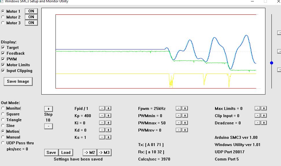

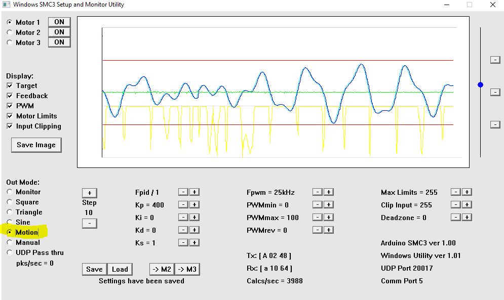

    Hi everyone,
    I am struggling with motor 1, and it is not moving.
    So here's a summary of the situation:
    rig: 2DOF (Motor 1 and 2)
    motor: Wheelchair motor 24v
    Motor 2 works fine, but motor 1:
    - Makes crackling noises when the potentiometer line is brought near the blue line.
    - Then it either moves in a jerky manner or does not move at all.
    - I swapped IBT motor controllers, same issue - both IBTs work fine with motor 2.
    - I reversed the connections, but i have spikes and the motor cuts off.

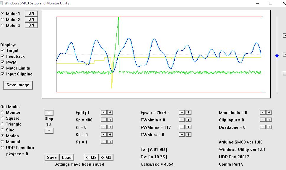

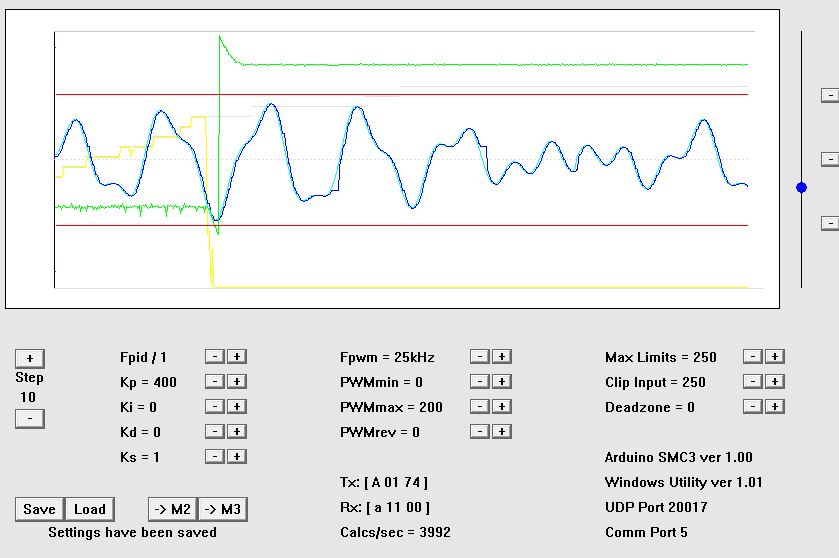

    I am posting a few pictures here, let me know what you think.
    I followed the tutorial, by setting everything to zero and gradually increasing the values, but when i increase pwmax, nothing happens - but when i put on motion, then it makes the jerky movements.
    The motor seems ok, it does move, but the movement is quite erratic. i'm not sure what is happening.
    Thanks for your help.

    The posted settings seem all over the place, for some the pot does not seem centered and for others, such as this, the clip and max limits are not set to 255 for testing, as per the SC3 instructions:
    Please follow the SMC3 setup steps and post a picture:
    8. Set Kp to about 400
    10. Do the above for each motor

    Did some more tests. Still not moving.
    The Green line was moved by turning the POT. <-- So pot seems to be working fine.
    All parameters set to zero and clip limits to 255.
    For the above setup, only wiring to motor 1 and electricals were connected.
    When pwmax is increased, there is no movement.
