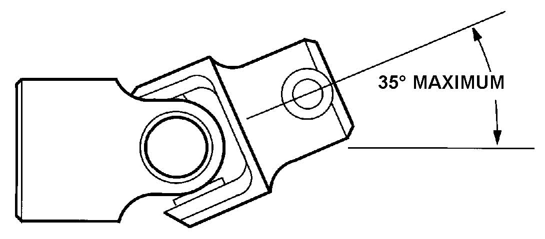

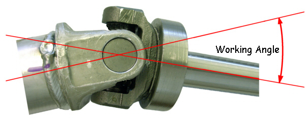

    Thanks! A seat mover definitely looks simpler to build. For a flight sim though, does a seat mover still provide enough pitch and roll for good immersion?

    it will also depend on the working angle of the universal U joint under the seat ... best is 35 degree like this with 70 degree over all angle ...more angle will over load the motors .
  7. bsft
    It would depend on the angle you create from the length levers on the motors, but then again, its amazing what immersion you can get from a seat mover with a short lever and the right profile.
