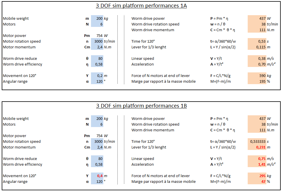

    I finally want to start my new project : 6 DOF for flight simulation (DCS) with Oculus Rift VR HMD.
    I read a lot of topics here but I still have a lot of questions :) it's hard to know where to start !
    How to choose motors ?
    1-I initially started with a 3 DOF Project, with 3 motors.
    For 3g of acceleration, 130kg to move, 0.3m/s of linear speed, I find that I will need 3*620watts motors. With a lever of 10cm I will need reducer to go at 30RPM.
    Are these hypothesis of 130kg to move, 0.3m/s of linear speed are fine ? or do I need other one ?
    2-Can I use these data for 6 DOF project ? with 6 motors ?
    3-Are servomotors like this one :
    http://www.schneider-electric.com/e...ey---20-bit-encoder---w-o-brake-straight-con/
    good for that kind of application ? I see a lot of people using DC motors for platform sim.
    4-Is it hard to connect xsim software to SM Drive ?
    Thanks a lot for your help :)

    It pays to finalise your design and seek feedback on it via your own build thread, prior to deciding on what motors best suit your project in terms of power, availability and cost.
    SimCalc will give you a basic insight into how design influences what power is required for what sort of linear speed: https://www.xsimulator.net/communit...e-linear-speed-and-forces-of-your-design.270/
    There is plenty in the FAQs about design, DC and AC motors, plus control board options.

    Hi
    I think I will go for 6dof finally. Here are my final carac with 200 and 400mm heave.
    Do you think it's good before buying all the hardware ?
    @noorbeast @Thanos
    Thanks a lot
