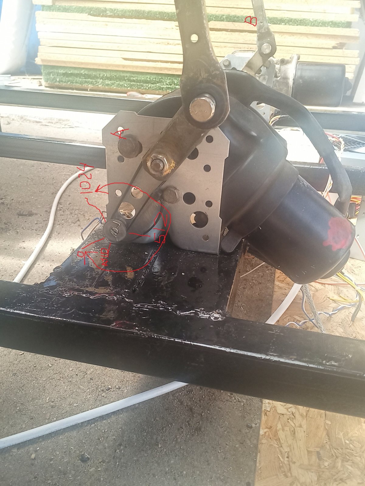

    If com port setting = 10 bit binary it means 2^10=1024 . full move of the motor 0 to 1024 binary A110+B94" = move motor1 to position A=110 motor2 B=96 move to 96.
