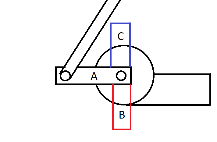

    For now I'm focusing on mouting the 2DOF part of the rig, but I'm stuck into the CTC and Rod angle/position.

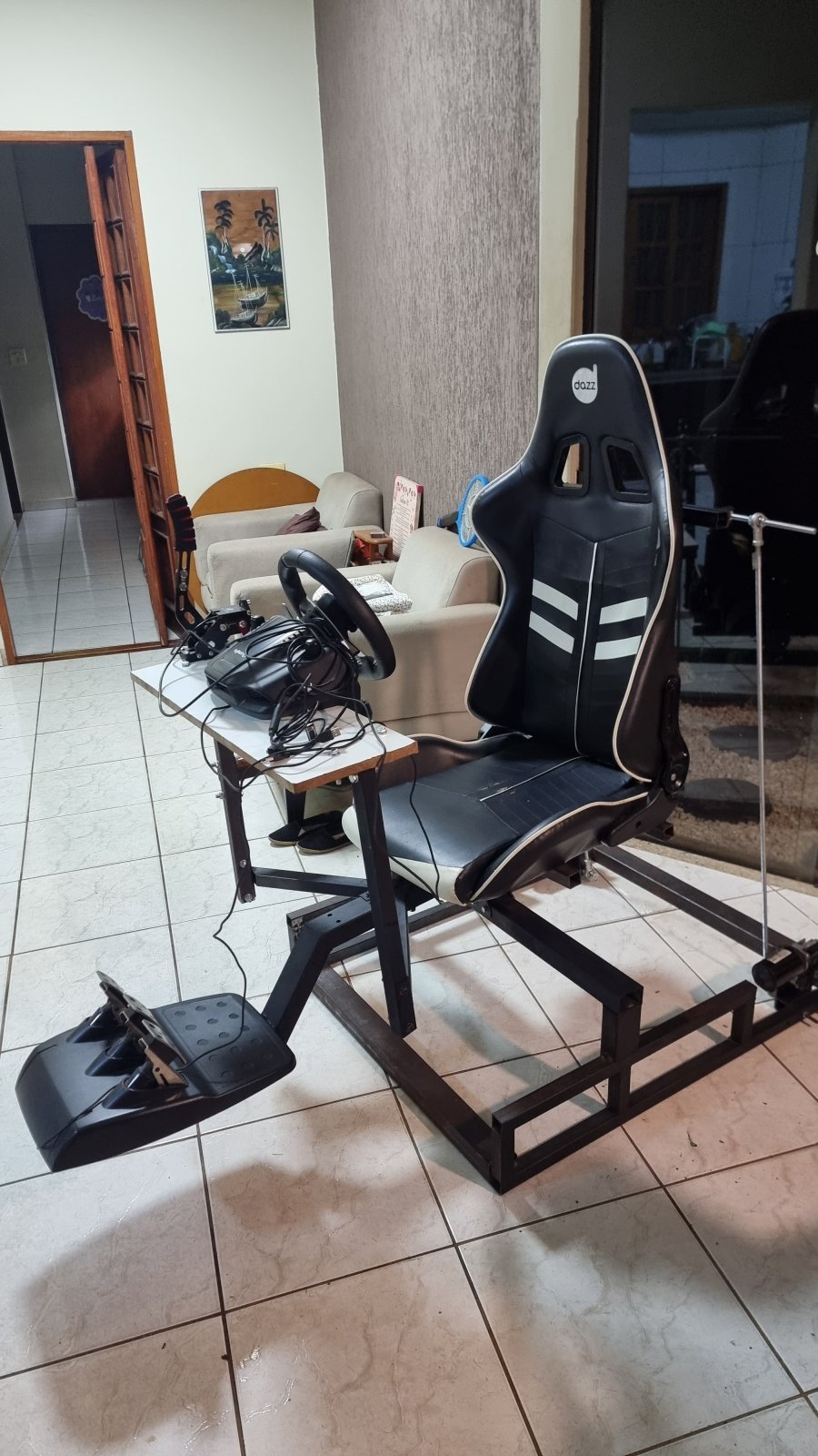

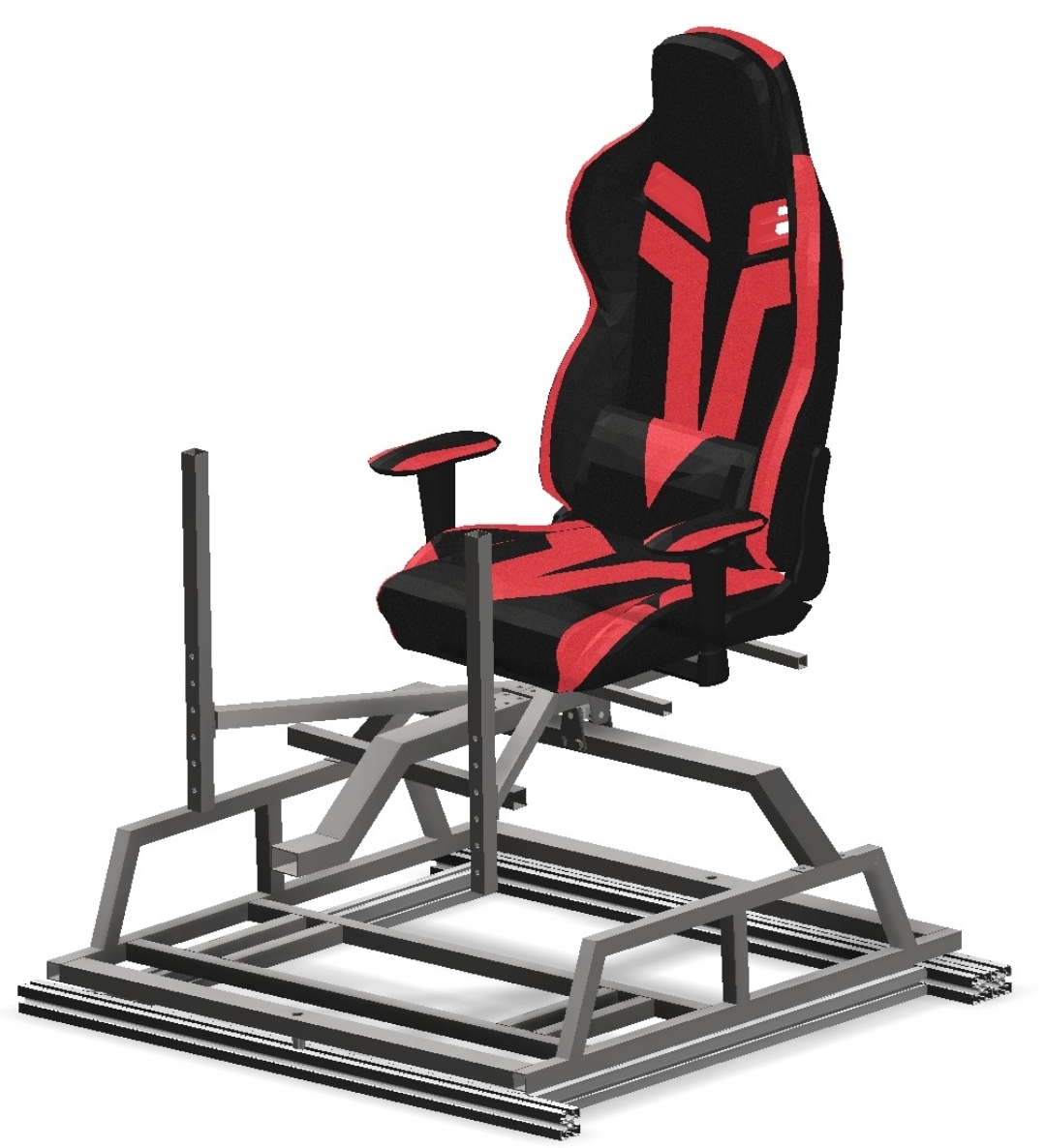

    This was the first projetct design, based on DOFReality 3DOF:

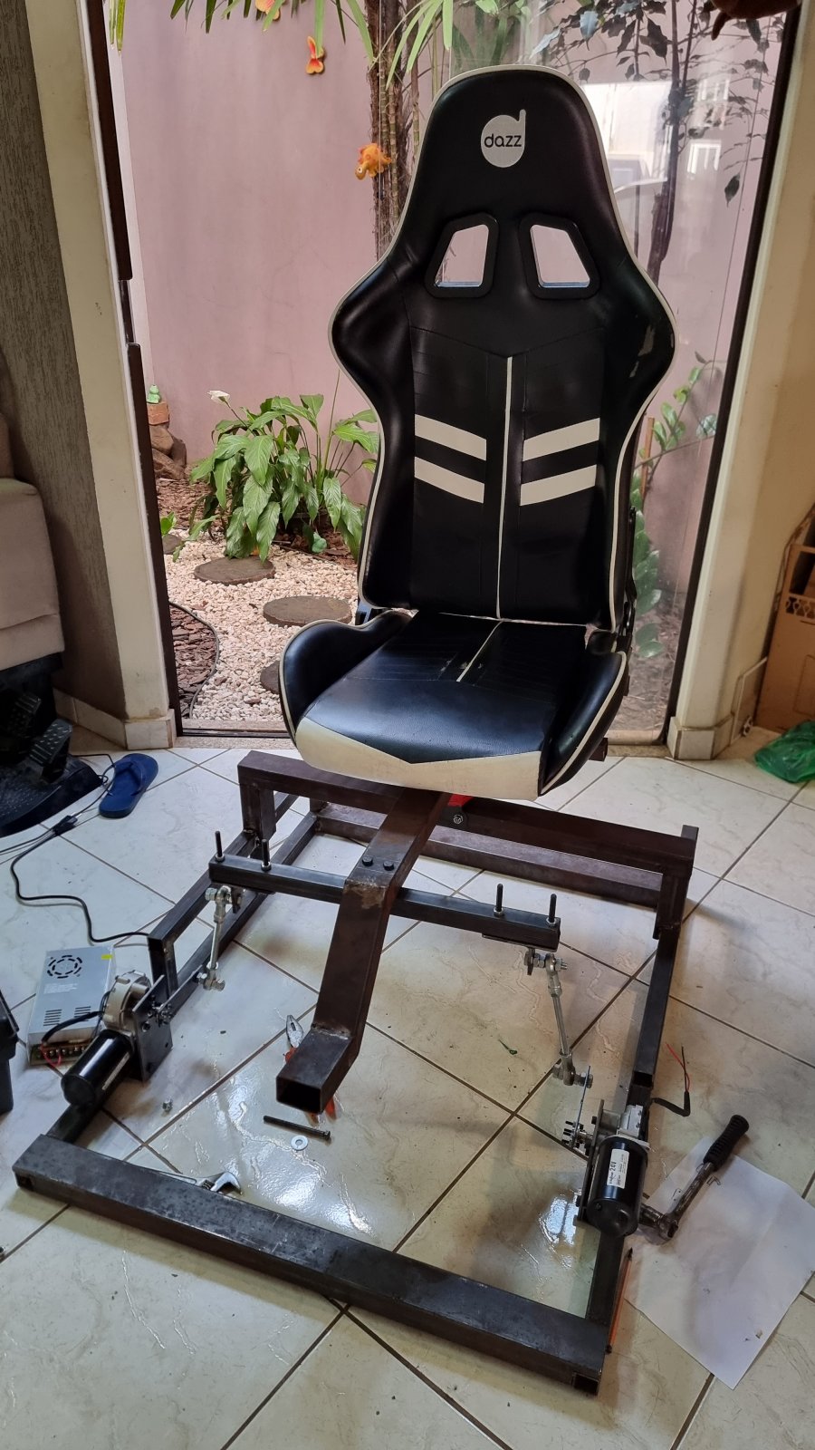

    After building it, it was clear that the motors would'nt handle the forces if mounted in the front.
    So I decided to do the shoulder mount design, and literally just inverted the chair mount.

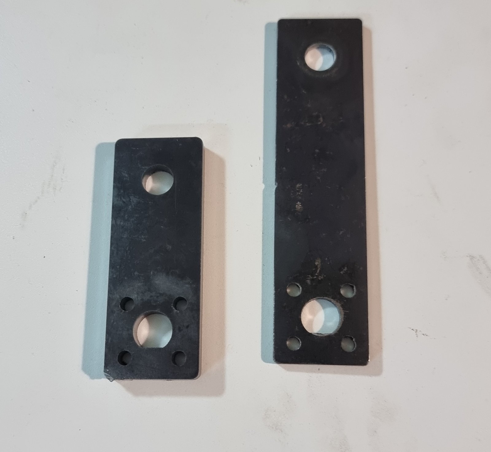

    I did some other small changes, like the size of the CTC lever (it was crazy long, about 100mm)
    But now I am stuck, and here is my question: wich way the it will perform the better (more motion, and less mechanical stress for the motors), option A, B, C, or none of those?
    And in the best scenario, in wich position should I place the seat to cut the rod at the right size? It is at the "zero" of the chair, when it's levelled?
    Hope you guys can help me, thanks!!
    21,511
    150,686Coins
    +11,018 / 55 / -2
    When the chair is level the motor lever should be position so it is at right angles to the rod, as that will place the least strain on the motor in both directions.
    Limit lever movement to about 38 degrees either side of its rest position, as greater than that effective torque utilization drops dramatically, placing additional strain on the motors.
