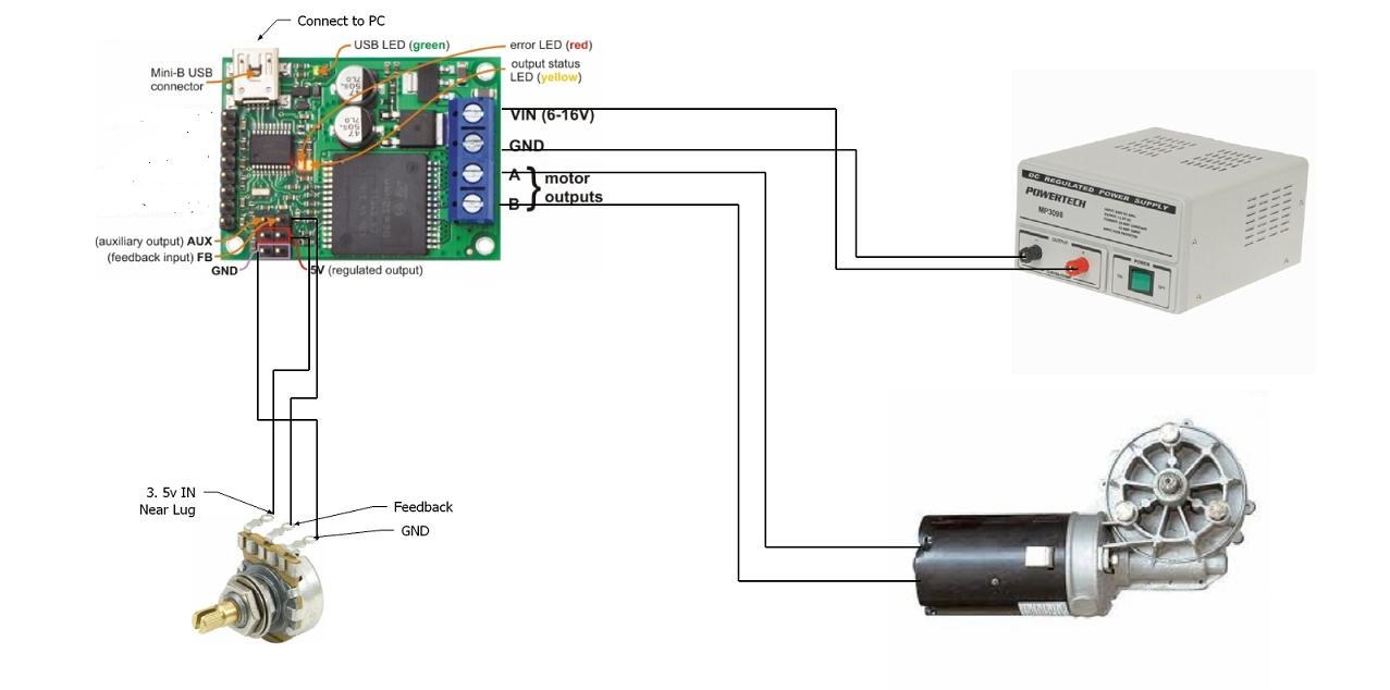

    Hi, im Anton.
    I want to build a 2 Dof simulator and i dont know how to wire and to control the jrk`s.
    Thank you for helping me.

    Hi anton as already in the other thread mentioned before you begin by asking from the very first beginning read the documentation of our users like @bsft or use the search function and then ask.
  3. bsft
    Hello @Anton60400 , I will dig up the wiring diagram for the jrk, but otherwise, as @Pit says, theres a few documents relating to once its wired up for setting PID and motor commands

  5. bsft
    @noorbeast , @Nick Moxley , do either of you guys have the wiring diagram pic for the JRK anywhere. I cannot find in on my PC at the moment
  6. bsft
    Nevermind, found it
    Pot needs to be mounted on the back of the motor , again @noorbeast and @Nick Moxley have some nifty photos they could add

  8. Nick Moxley
    17,056Coins
    +2,506 / 30 / -2
    Flex Coupler's are your Friend and make attaching the pot to a Axle Easy Peezy.
