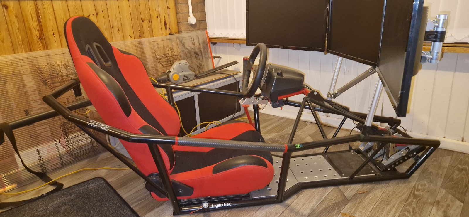

    Here's the rig with the old g25 and minus the cables. Excuse the dodgy conservatory, Id' just move in. Its fabbed from steel tube and made with motion in mind so its very strong with no flex that you can tell. Without the seat and screens, it weighs very little and you can shift it on your own easily. But... it is big. It takes up the room of a single bed very easily.

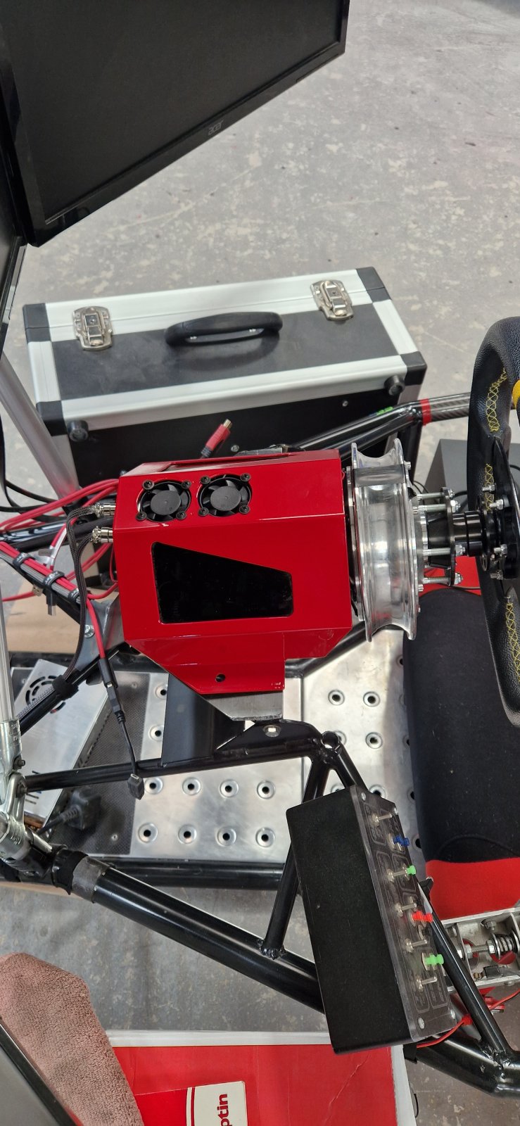

    Here's a few of the Hover board wheel.
    The odrive in this pic died. I dont know why. It worked well for ages then just went all mad. I figured it was the odrive or the encoder so got new of each. I tried the Odesc v4.2 driver first and that has not gone bad yet so happy days.

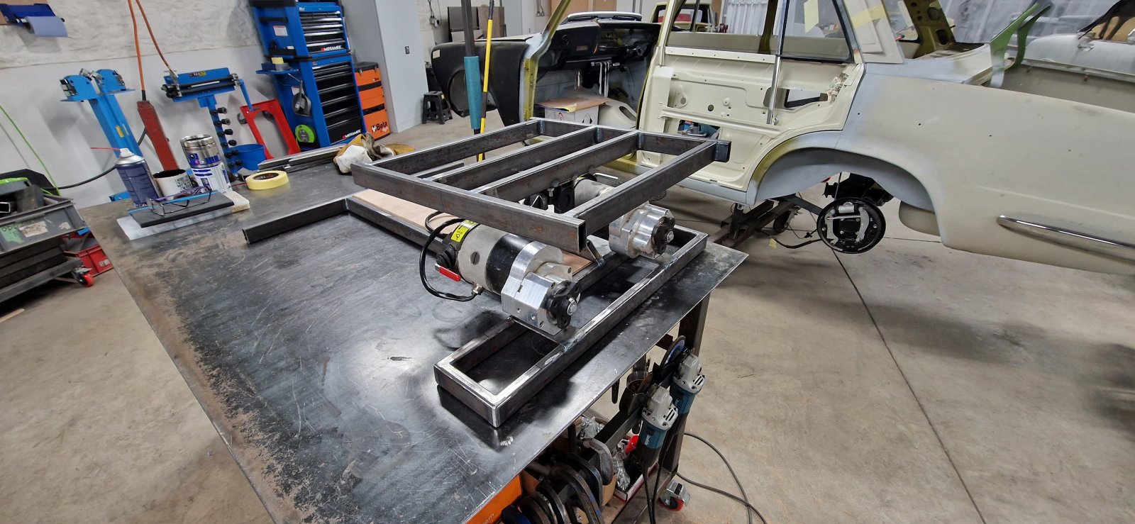

    So, onto the motion side. What could go wrong?

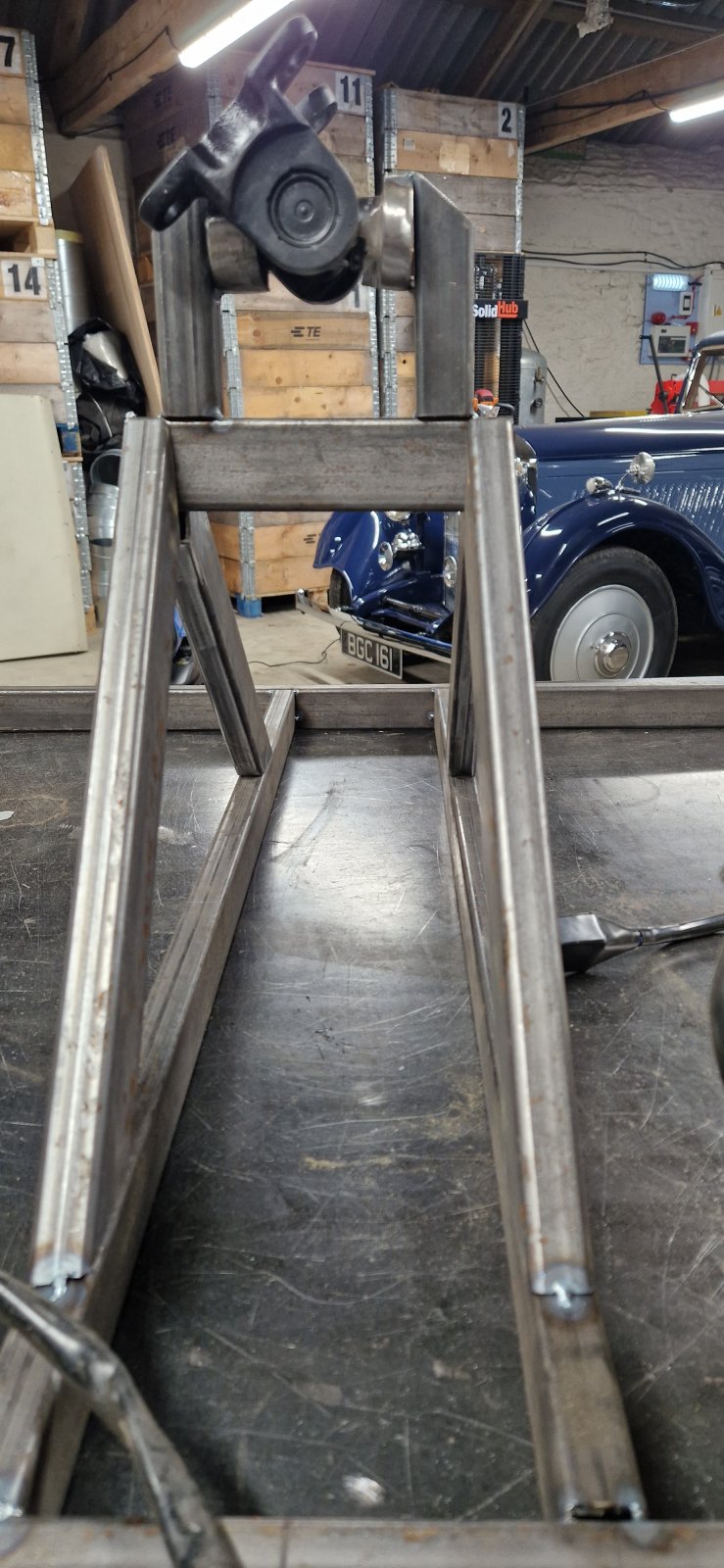

    Well, firstly, the UJ didnt move far enough. I guess it didnt need much angle when driving the Transit but it touched its own 'arms' and locked quite quickly. I didnt have any other options at that time, so i cut the 'muvva' up :) I welded it to some box and plate and now it has a minimum of 45 degrees in all directions. Im sure i wont need that much and it will hit the motors at the moment, but i can sort that with some motor protection bars later.

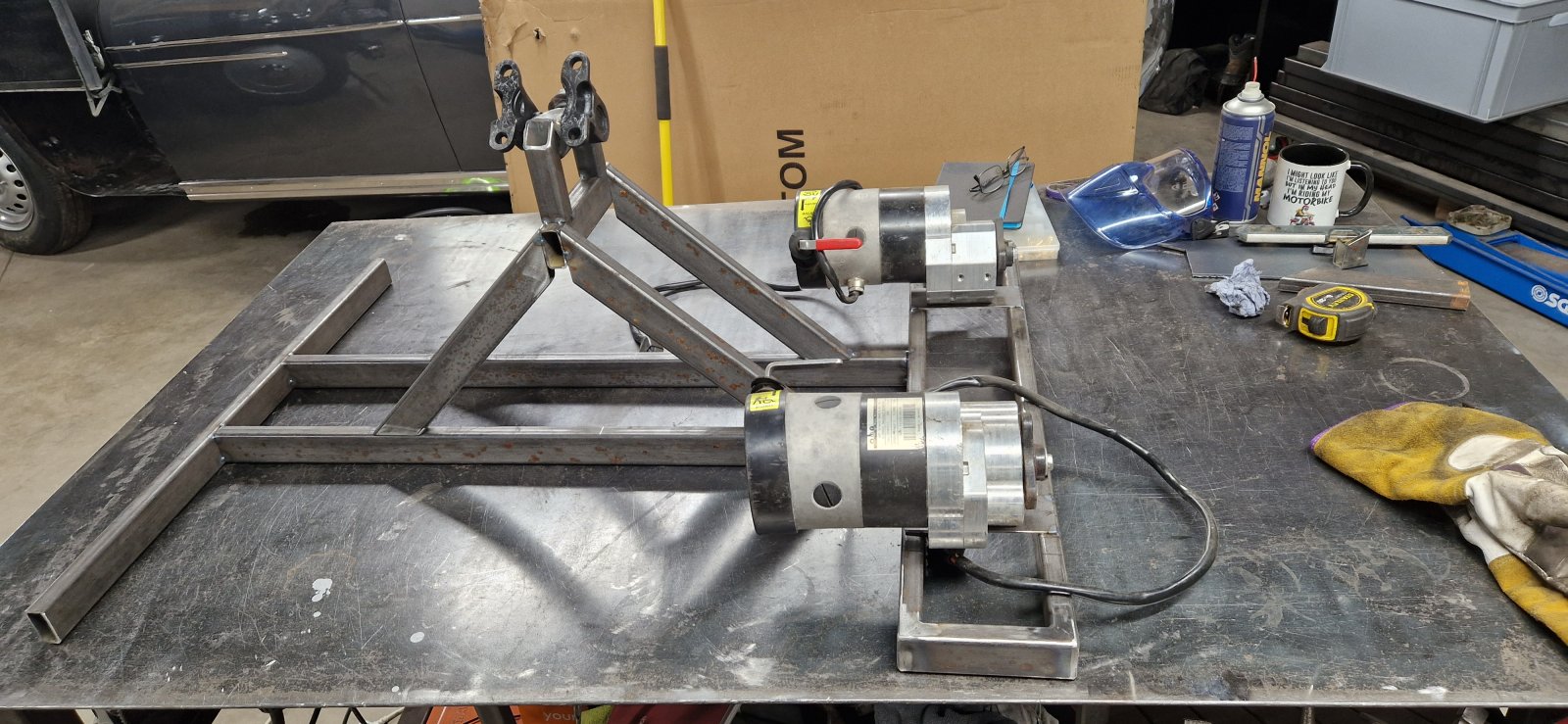

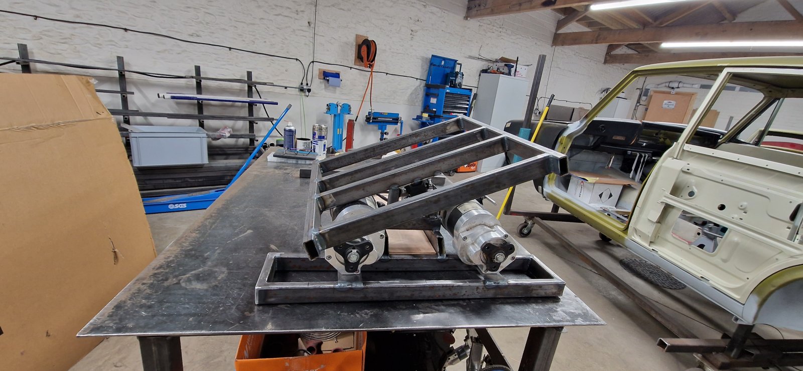

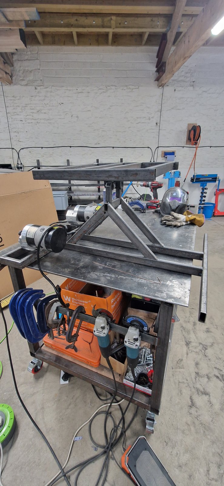

    Next issue, it became apparent that the rig would be far to high and would almost need a step to get in over the side rails of the frame so i had to lower the UJ height.
    I settled on this...
    It was at this point i couldnt help clamping the whole rig together. I marked the balance point and two of us lifted the rig on and clamped. One of the lads got in and i acted as the motors and moved him about.
    "this will be f*%*^n' awsome" was his verdict, lol. For me, i felt it was quite easy to move, even from full dipped 'braking' back up to level. All good.

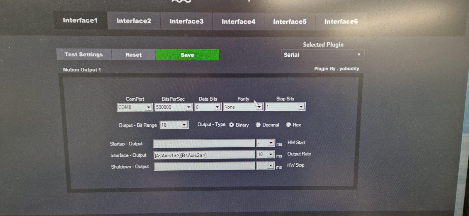

    Since then, ive changed the old Uno to the rev3 copy, redone the smc3 app part and then still failed to get motion from the interface plugin test button/ slider.
    The 500000 bits per second through me as apparently that is not a baud rate? I changed from 115200 to 5000000. Also i tried a few varieties of the Interface Output syntax and hey.... one motor worked with the slider, yay :)
    To check the wireing hadnt fallen out for the 2nd motor, i reloaded the smc3 app and all was good as it should be. . I closed the app and checked it was closed and reopened simtools 3 and..... nothing. Not even the first motor worked without changeing anything so i got fed up and went home.
    Heres the settings, does the syntax look right to make two motors move?

    Before messing with SimTools can you please post your SMC3 settings running the Sine test, as that is the first step.

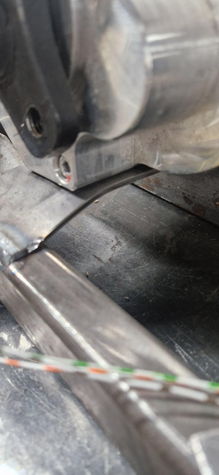

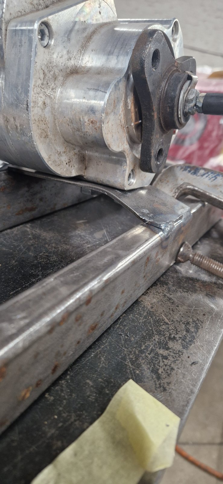

    So today i did a torque and weld test. Unitentionally of coarse. :roll
    Theres a lesson here people, lol. I checked everything still ran as it should and my ghosts seem to have been exocised so after fiddling with the limit values i decided to make the link arms. I have some nice sturdy m10 rose joints that screw into what was the wheel bolts of the wheelchair. I realise i might need some brackets to get move movment but hey, im still working it out as i go, lol.
    Haveing hand tightened a rose joint into each motor i though i should really turn everythig off first.
    Here cometh the lesson..... Do not pull the pc plug out when you meant to pull the motor psu's plug :blush
    The screen went black and the motors decided to spin up. Now, with the rose joints attatched, there was not enough clearence at the mounting bracket. It didnt seem to bother the motors though as they ploughed on and bent the 3mm plates that were holding them. Torque test successfull i'd say.
    You can see where the rose joint first touched at the edge of the bracket. Im quite impressed, if not a little scared of them now, lol.
    I think a little redesign might happen now and also wire up a proper power switch too.
