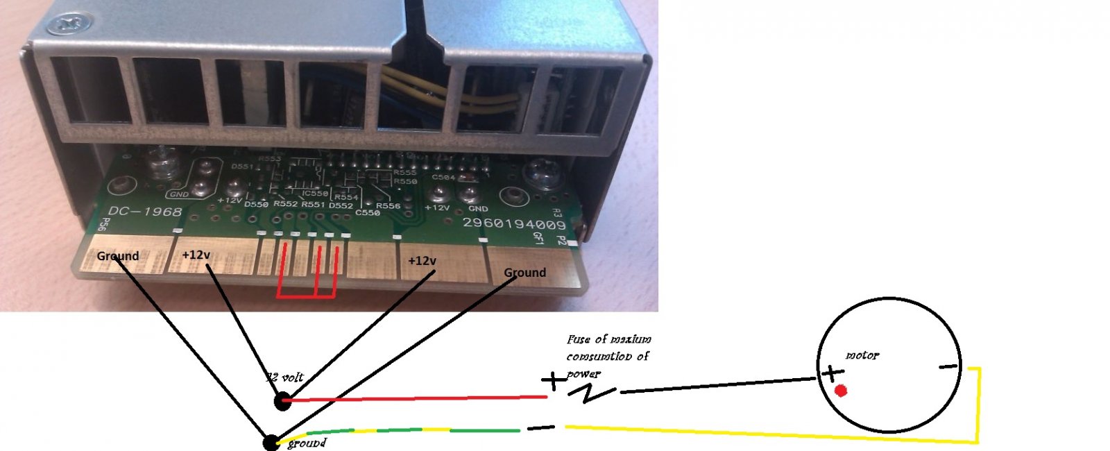

    Could someone give me some advice as to weather these PSU's will be modifiable in the same way the hp dps-600pb are?
    http://www.ebay.co.uk/itm/HP-DPS-70...169999?hash=item4d5302bc4f:g:Kf4AAOSw4A5YocQg

    Thanks for the reply. I've found some tried and tested dps600's for £4 more each so seeing as the electrical side will be my weakness I've gone for them.

    Those 700's also lack internal fans, Not suggested.

    1 - Connect the red contacts.
    2 - connect the 2 grounds. Need to be connected @ high power!
    3 - connect the 2 12 volts. Need to be connected @ high power!
    4 - build custom cooling fans!!!!!! Connect to the 12+ and ground
    5 - done! Use power cabling for power on of!
    They give a lot of power :). Mine work good!
